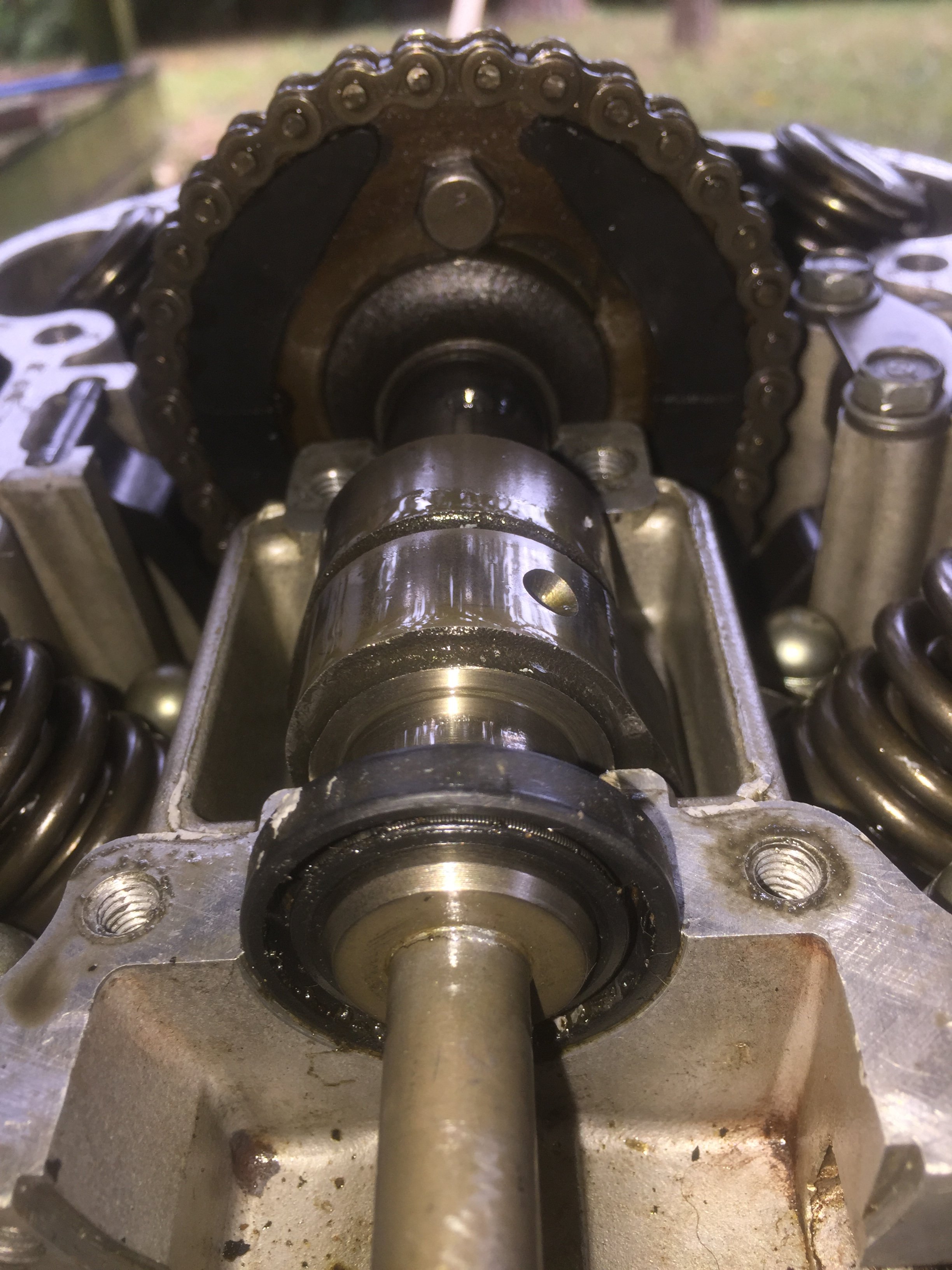

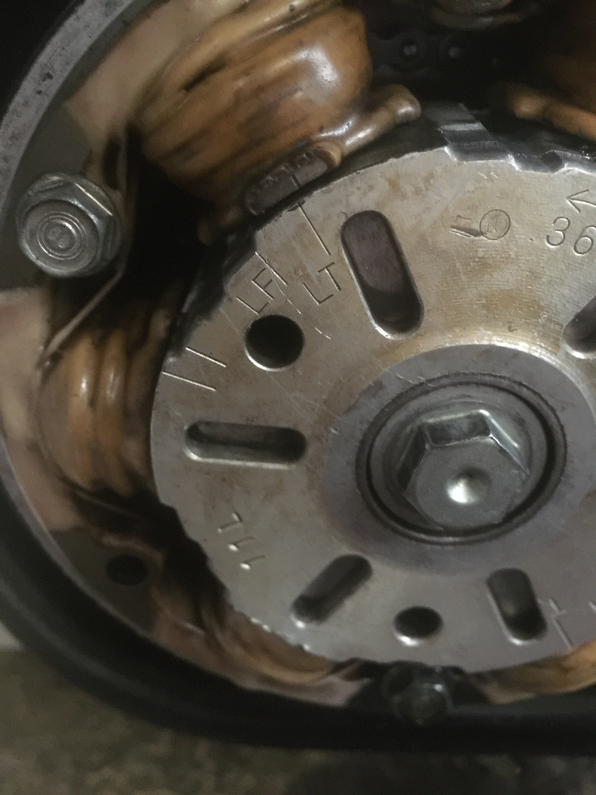

Ok I wanted to update the thread because I've tried the things you guys recommended last time but I'm still having the same issues. Here's what I've done so far:
- I replaced the alternator and starter clutch (the old one did have a bulge in the outer casing and one of the pins was jammed into the slot).
- I verified the alignment of the cam chain on the cam sprocket. The attached pictures show that the cam sprocket aligns with the top of the cylinder head while the rotor has LT aligned with the mark on the stator. I also verified the front of the cam chain is tight and not kinked.
- I've verified the pamco unit timing as best as I can. The unit is aligned exactly how it's shown in the pamco manual and I've gone over the wiring several times. I'm still having problems using my timing light to verify timing since I can't get the bike to start, but based on what I've read I don't think I can be far enough off on timing to prevent the bike from at least firing.
- Also, from what I've read I don't think the cam can be rotated 180 degrees off.  Based on posts I've seen on here and the manual, as long as LT on the alternator is aligned with the mark on the stator and the lines of the cam sprocket are aligned with the top of the cylinder head, the timing is correct.

The cam turns at half engine speed, so it can be 180 degrees out.
Offline furu14
  • Posts: 25
Re: CB360 grinding on startup
« Reply #6 on: Oct 07, 2018, 14:45:45 »
To me it seems that the camshaft is 180 degrees off...
the lobes are on top. if the picture is on cyl 1?

Ok I got the cam turned 180 degrees and reinstalled.  Just to verify, with the left cylinder at TDC on compression stroke the cam lobes are pointing down, the alternator is at LF, and the lines on the sprocket align with the top of the head.  I double checked the wiring and verified spark on both sides.  The timing light is more consistent now and Iím sure itís firing when LF on the alternator is aligned with the firing mark on the stator (with the timing light hooked up to the left spark plug wire).  Itís still making that grinding/wheezing noise and not starting.  Anything else I can check?

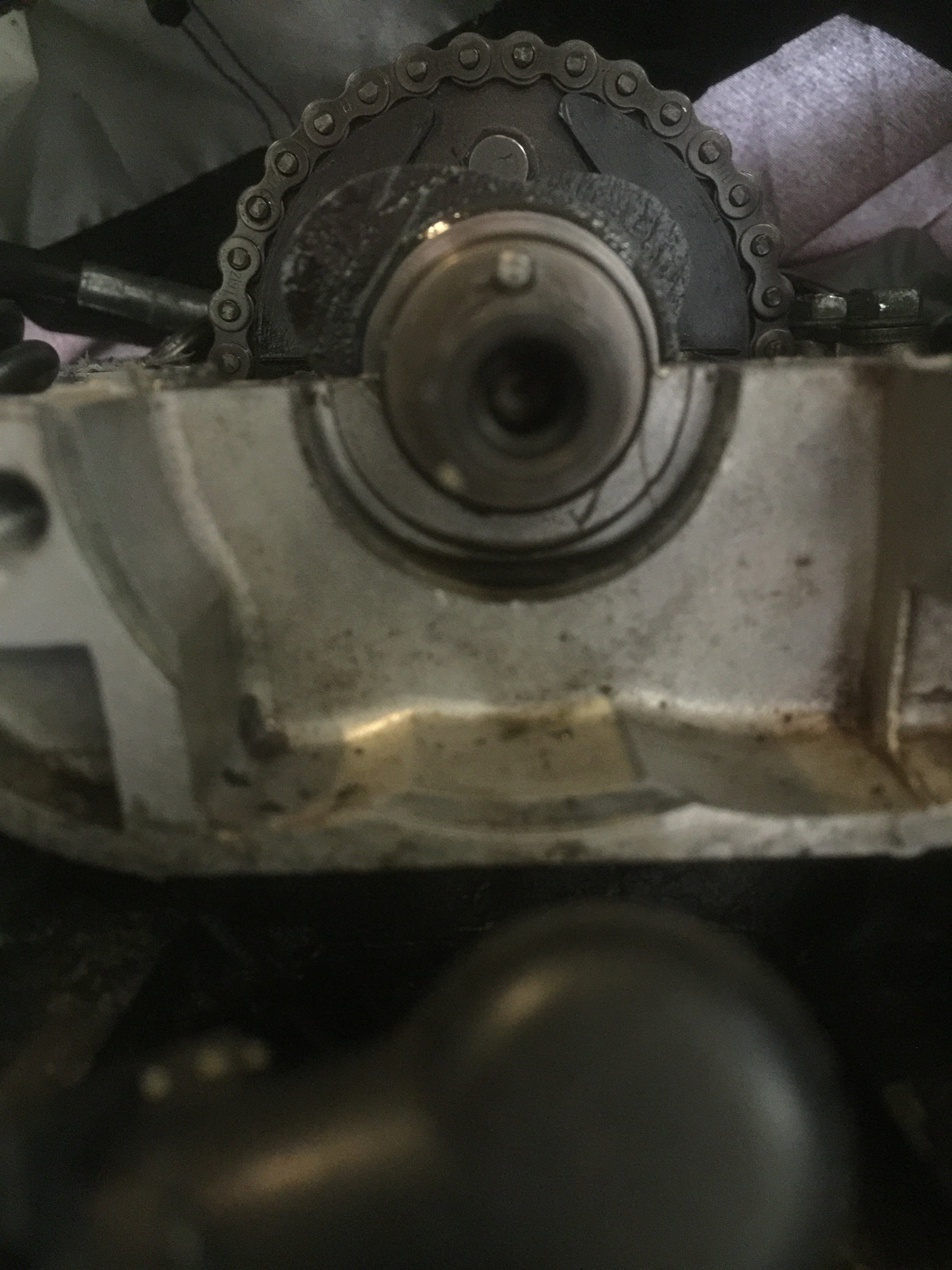

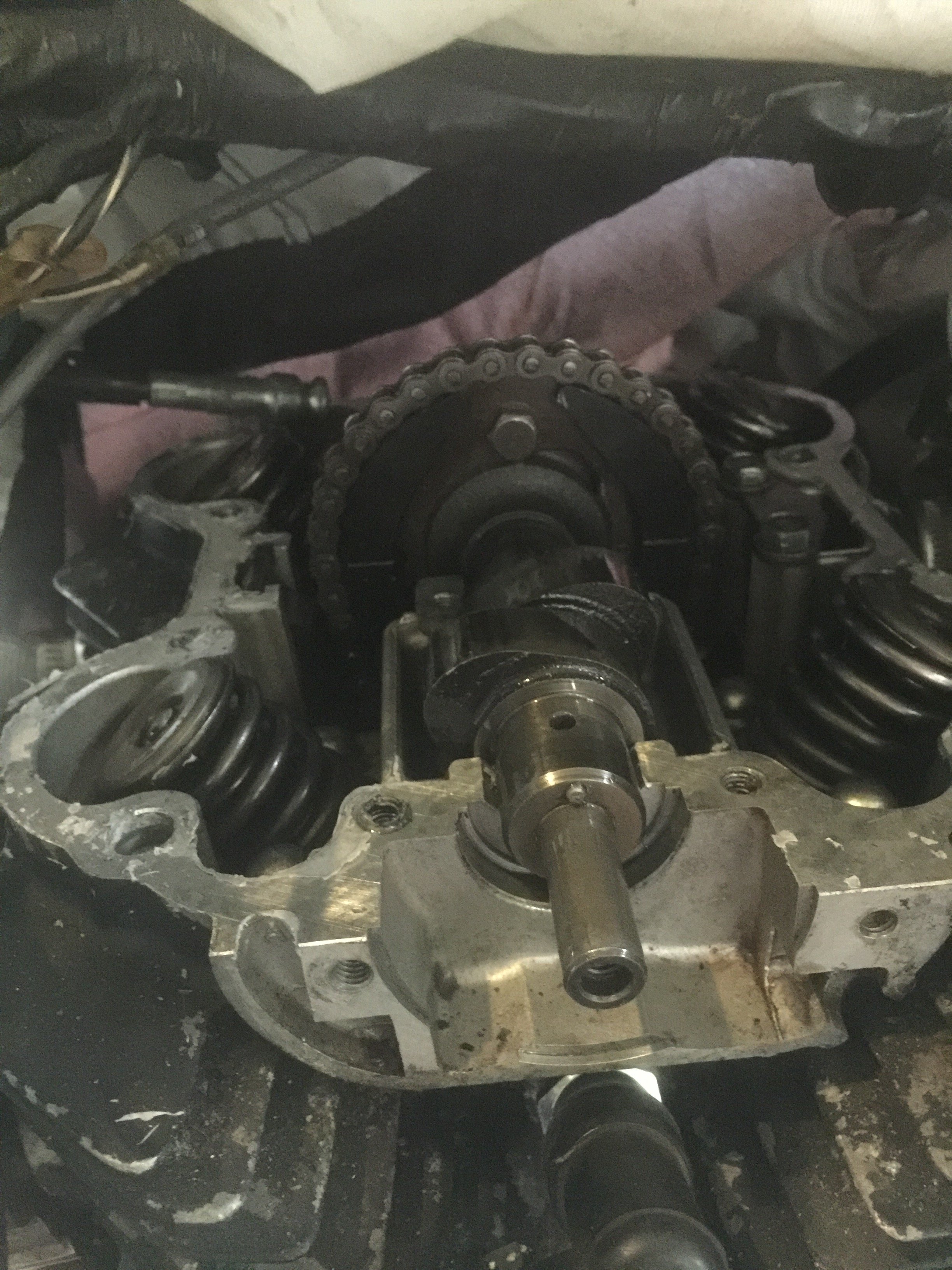

I pulled the cylinder head cover again to verify everything, here's what I see:
Rotor is aligned with LT mark and timing mark on the stator
Left piston is at TDC on compression stroke
Cam sprocket lines are aligned with the top of the cylinder head and left cam journals are pointing down
As far as I can tell, this is the proper alignment for the cam.

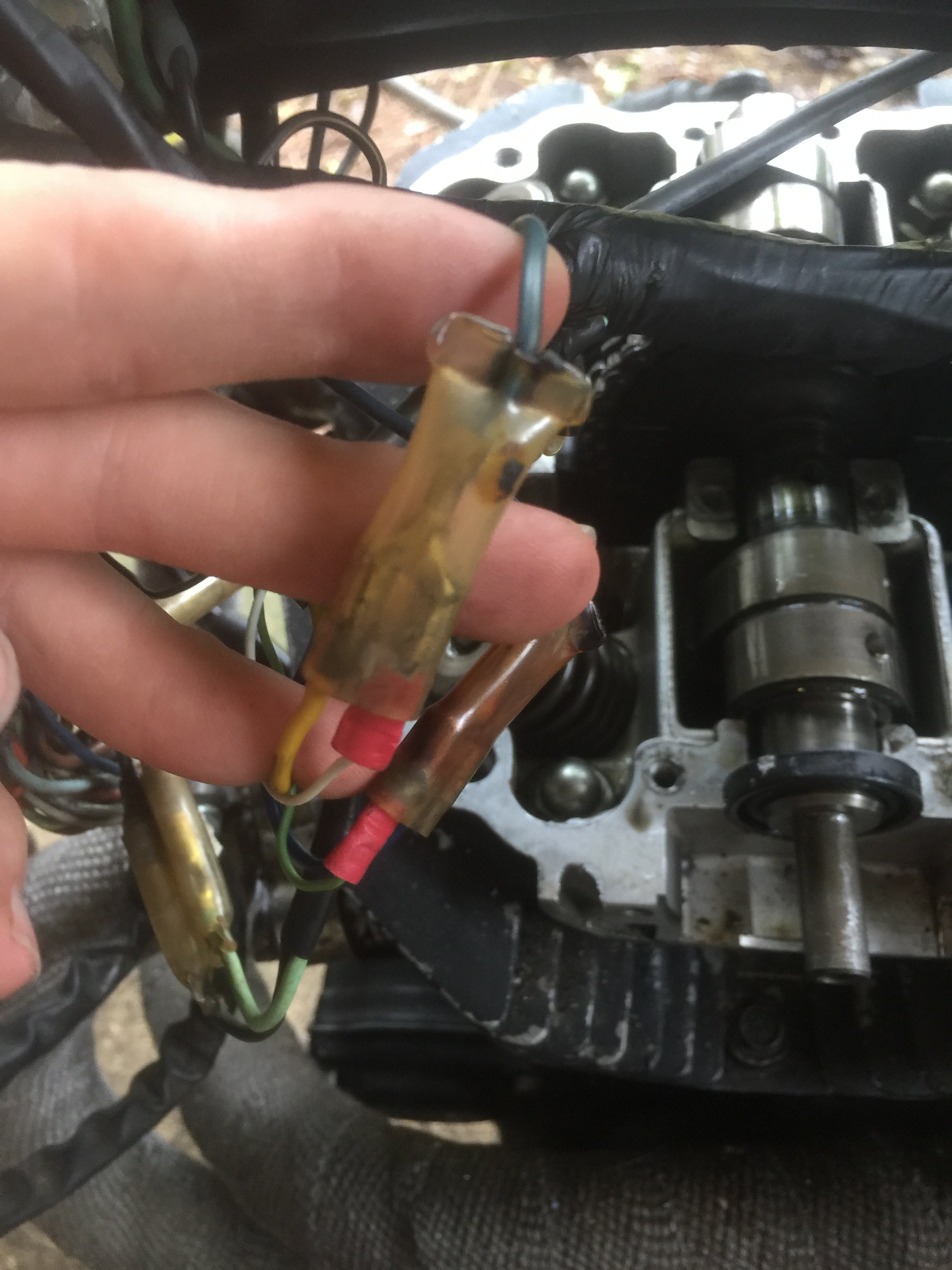

Just verified the wiring, the diagram from pamco shows pamco white to blue wire from left coil + pamco green to yellow wire from right coil.  I've verified that's what I have in the pictures below.
Still getting the same wheezing sound on startup.  Is it possible I've blown a second starter clutch?  I really don't want to have to take off the left side crankcase again unless I absolutely have to.  Thanks to everyone for your help.
