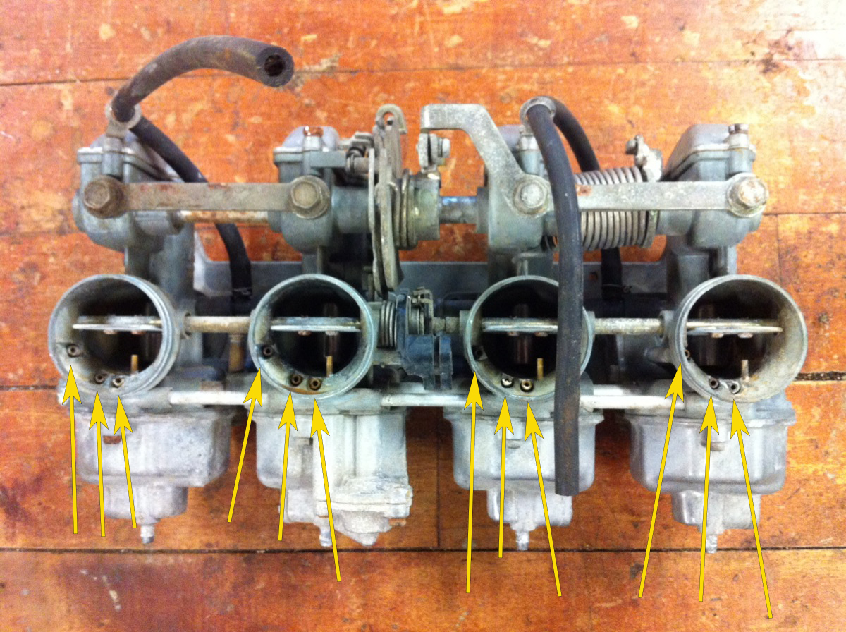

Good chance they could need a bigger jet, but often the case is those style pods are blocking these jets:
Good input! Which pods are recommended? I have a set of Ramair in it's way to me.

Sweet!  Going up on the jet is because of those filters.  Too much air.
