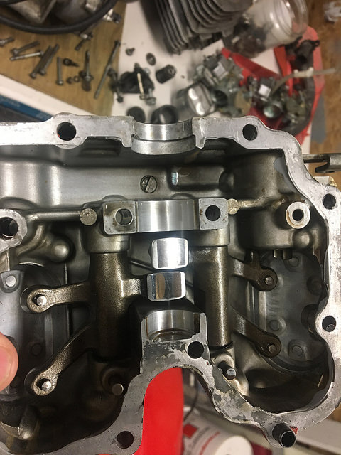

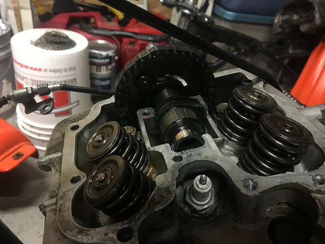

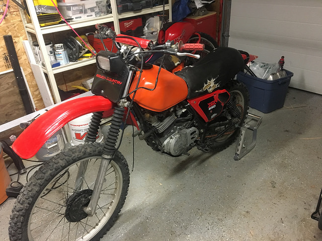

Hey guys. Took a break off the boards, sold my CB378 because I needed cash to finish my trailer sauna, but realized I needed a bike to wrench on. FFWD to last week, I found a 1980 Honda XR250 locally on kijiji and when I went to pick it up, turned out the seller had another bike in pieces. So now I'm a new owner of two 1980 Honda XR250's. One is pretty much complete, with surprisingly clean camshaft journals, but I am still waiting for a new cam chain as the old one is stretched and I figured I'll install a new one before putting it back together.
Not sure how active I'll be here, but I want to get the bike running to hit some trails and dirt/gravel roads. This will not be one of those ave inspiring fabrication masterpiece stories.

Welcome back bud. Looks like a good buy, the inside of that head looks brand spanking new. Carry on.

Welcome back! And that's ok. I for one really enjoy seeing pics of where these bikes take people just as much as seeing the bike being built sometimes! Top end looks great!
