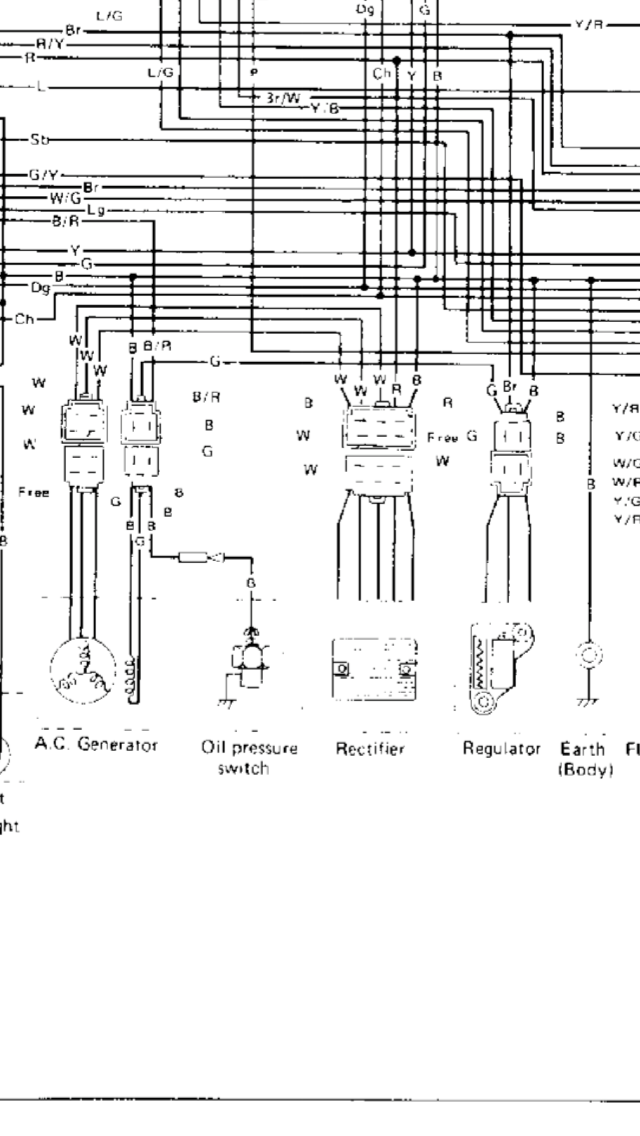

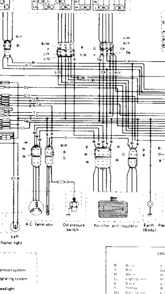

UPDATE
I checked the battery voltage again, after watching the full lot of charging system videos on motorcycle MDs youtube channel and knowing a little more about what I was looking for.
Before starting: 12.7V
Idle: 12.3V
2000RPM 12.2-3V
3000RPM 12.2-3V
All this as per my knowledge means a charging system that is not functioning, correct? Now to trouble shoot the REG/REC, stator wiring and the stator itself.
Any where specific I should start or most likely points of failure?
Thank you again for the replys, I feel as though I am pointed in the right direction and the help is much appreciated!

« Reply #9 on: Sep 04, 2018, 04:19:48 »
The first check to do is take a size 10 ring spanner, hold it to the generator cover and turn on the ignition. It should magnetize the rotor enough to hold the spanner onto the cover. If not - your regulator is not working. If your bike is completely stock all connectors to the charging components should be behind the left hand sidecover. Usually sprayed with battery acid from the battery vent hose. Inspect and clean those first.
