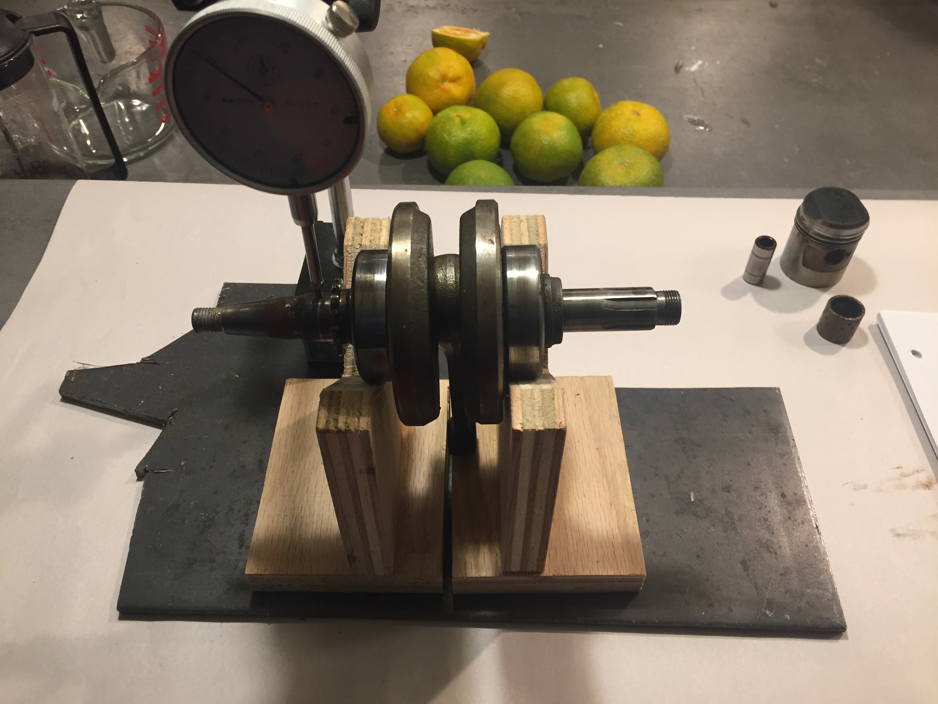

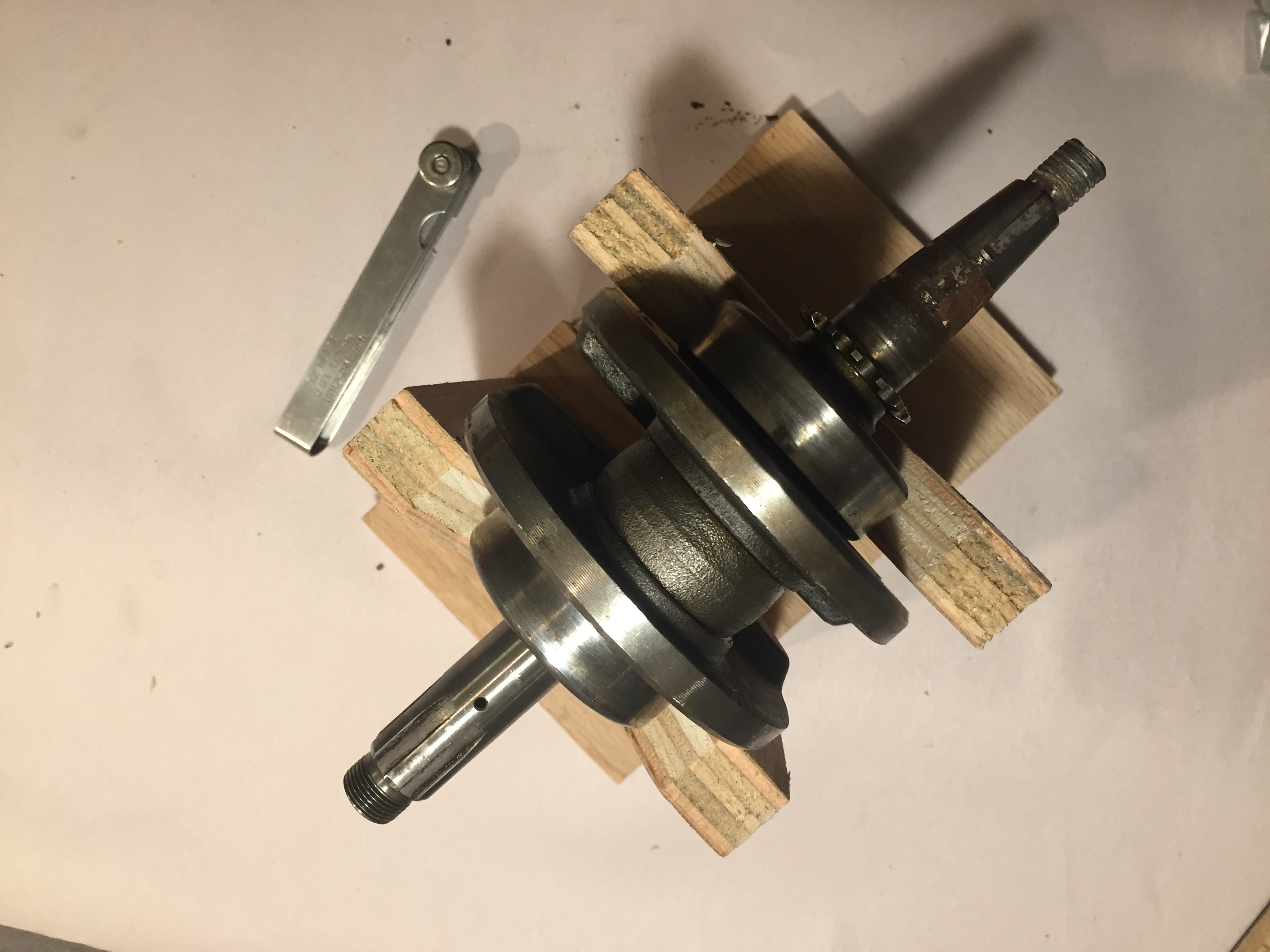

After work last night I made a couple of v-blocks out of some scrap 3/4" birch plywood so I could check the runout on the crankshaft. I set them up on a piece of 1/4" plate so I could use the magnetic attachment on my dial gauge to prevent any movement.
Everything measured within spec so we have a good usable crankshaft to build out from. The clutch side bearing is toast as it was full of dirt and grit from broken case covers, so that'll need to get replaced, but that's not a big deal at all and about a $10 part.
Crankshaft Runout:
(Service Limit: 0.002")
Stator side: 0.000"
Clutch side: 0.0014"
Connecting Rod Side Play:
(Service Limit: 0.0315")
Measured: 0.015"
Connecting Rod Radial Clearance:
Measured: 0.000"
Now that I've confirmed the crankshaft is in spec, I'm going to go ahead and order gaskets, oil seals, a couple bearings and a bunch of random parts like crush washers, nuts, piston rings, and all that good stuff to build up the engine.
