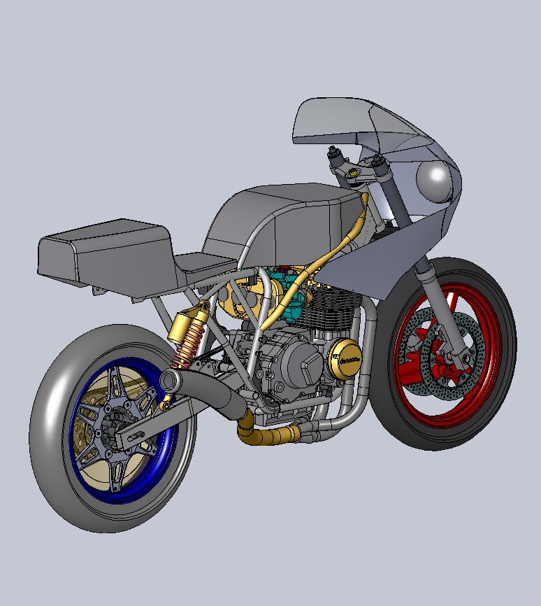

Attached is a photo of the inspiration, and a quick CAD model of my 400F mini replica.

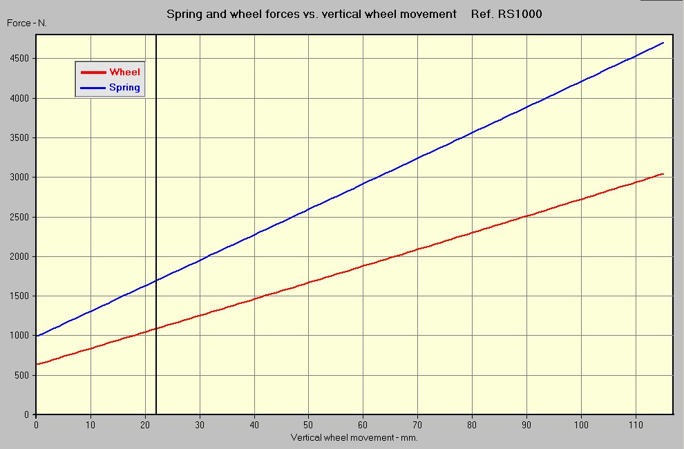

I wanted to laydown the shocks to get that period twin shock race look. Step one was to measure the physical dimensions of the RS1000 and input those parameters into Tony Foale's suspension software. I have a 1/12 Tamiya scale model of the RS1000 and used that in conjunction with photos I was able to gather the dimensions, and estimate a spring rate. This gave me the spring force at the rear wheel and the rising rate curve.
I was then able to transfer that data to locate the shock mountings on the 400F. The spring force on the 400 is a little less than the 1000, but the 400 should be lighter, so I think it's a good starting point.

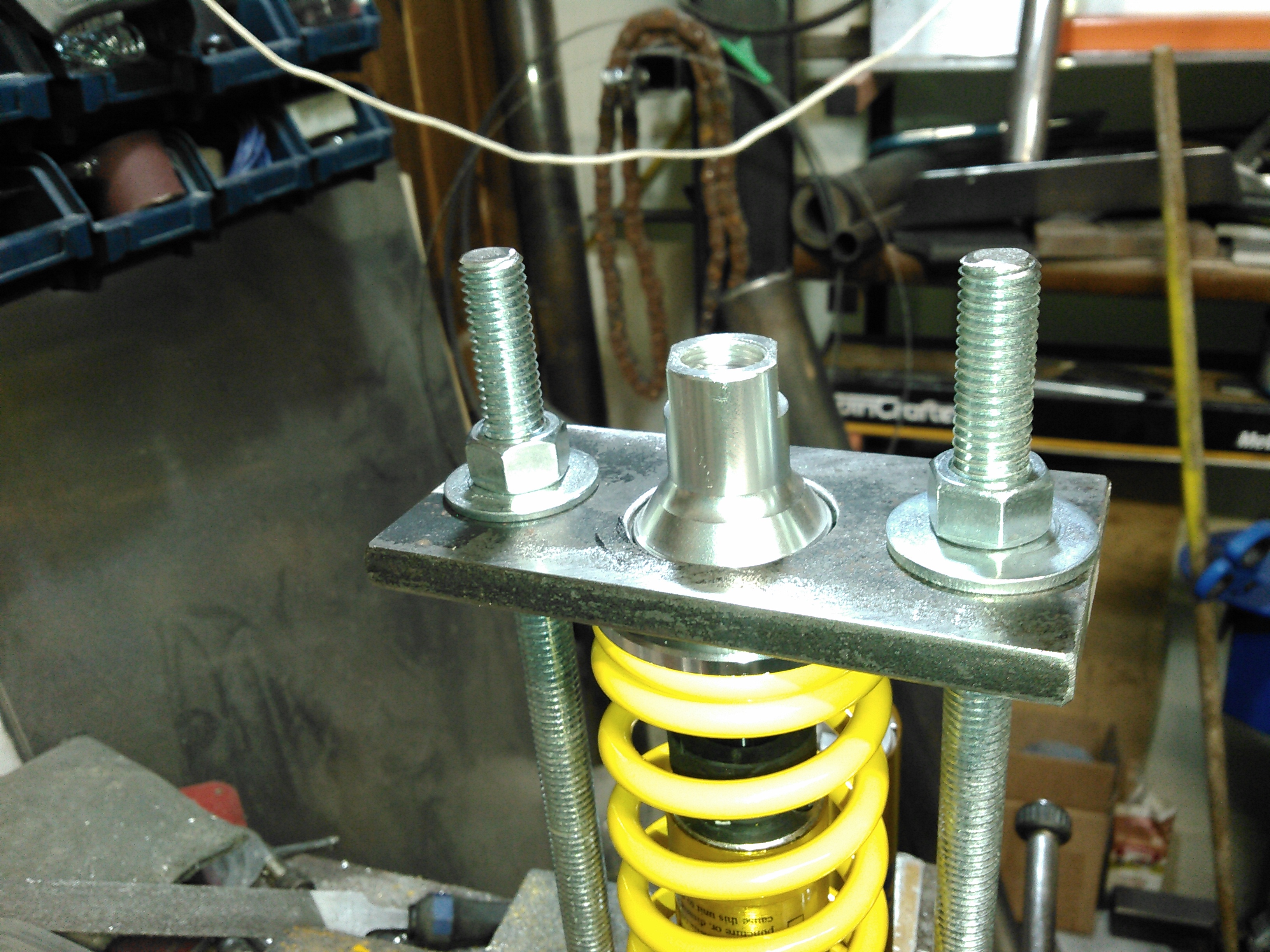

I wanted to disassemble the shocks, check them for assembly issues, and rebuild them with fresh oil. But first, I needed a spring compressor that fit. I have an S&W compressor, but it wouldn't work on these shocks. So, out came some flatbar, nuts,bolts, and threaded rod. Worked like a charm.

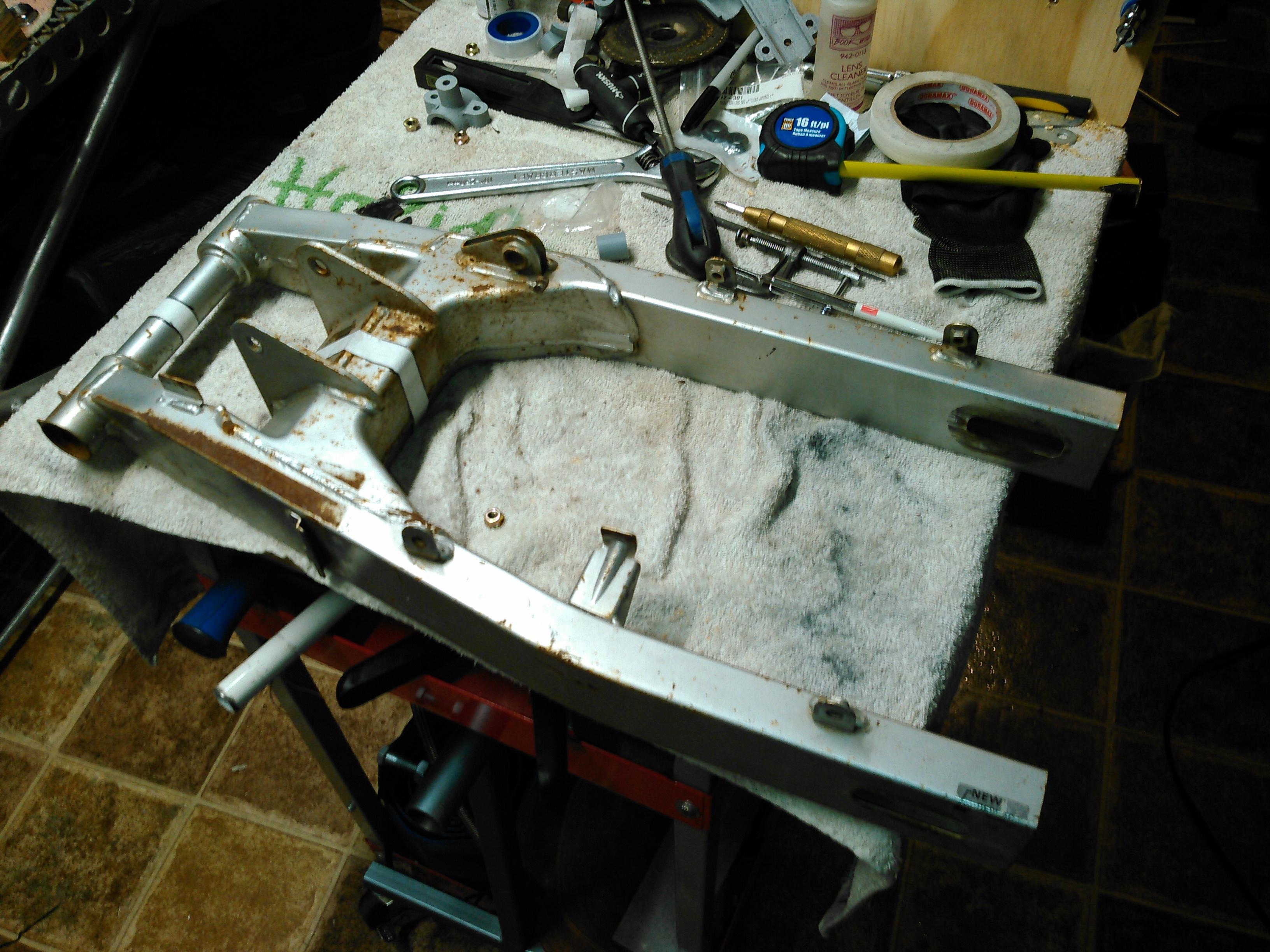

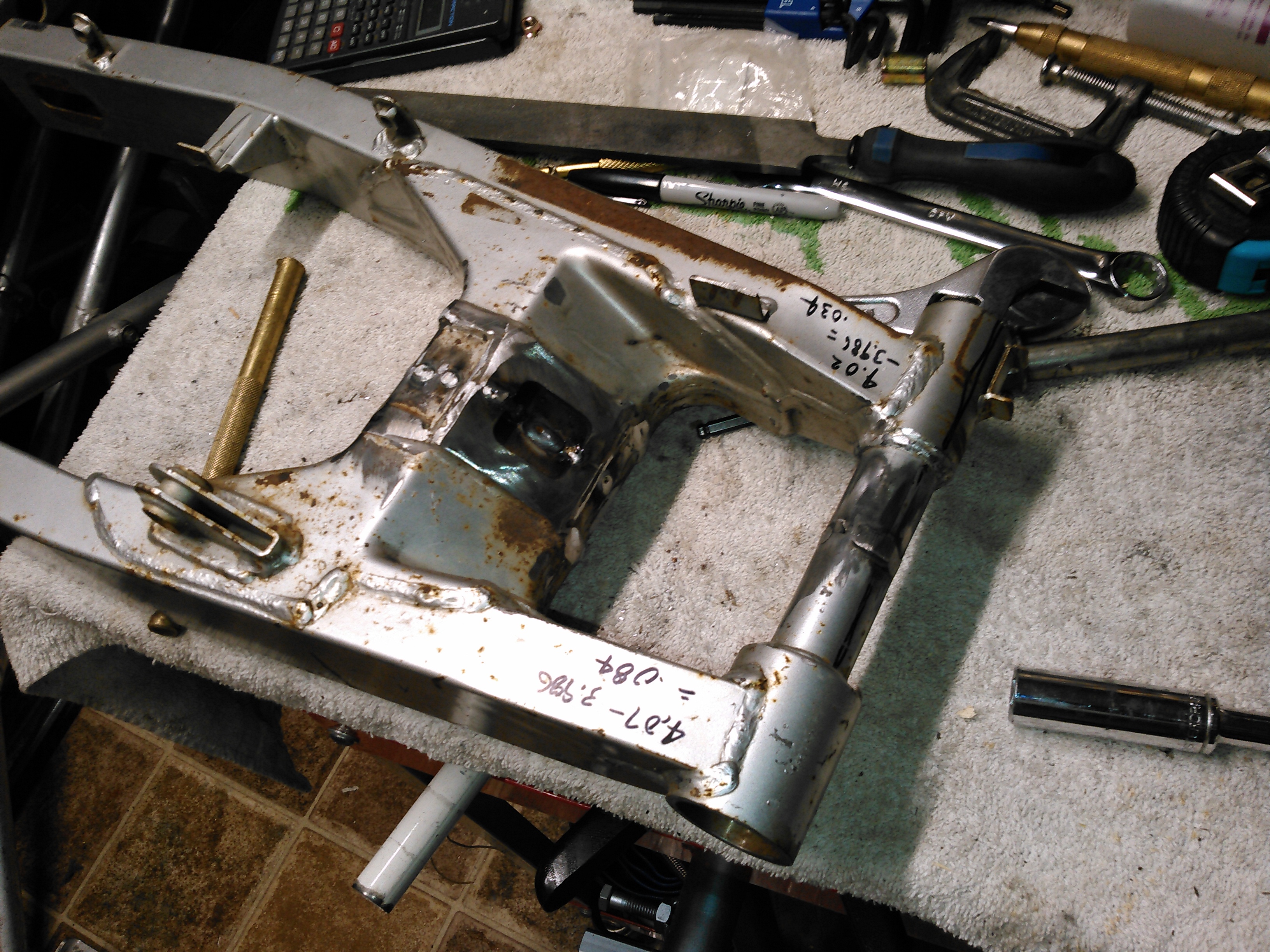

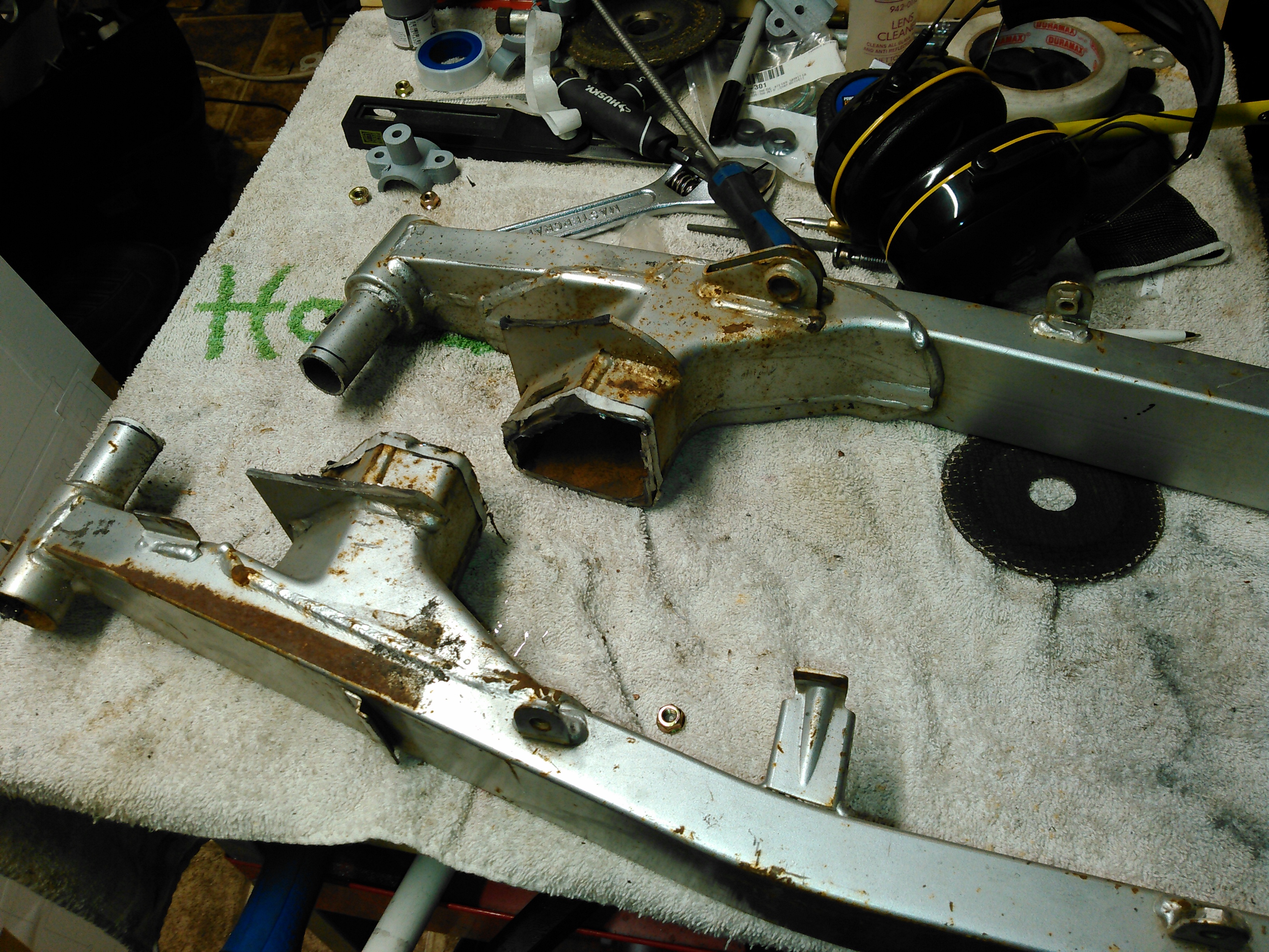

I wanted a better swingarm for this project, something longer, wider, and stronger. I had a CBR600F1 sitting here with all the parts that I need to make it work. Only problem is that it is 20mm too wide to fit in the frame.
Cutting out the 20mm is the easy part. Getting everything lined back up and keeping it straight during welding will be the harder part.

Re: Honda RS1000 Mini Replica
1fasgsxr - Just look at the photo, there isn't 10mm of material available to remove. Plus, by taking it out of the middle I leave all the bearing surfaces undisturbed, which means stock Honda bearings/seals can be used. Just need a shorter bearing spacer in the middle.

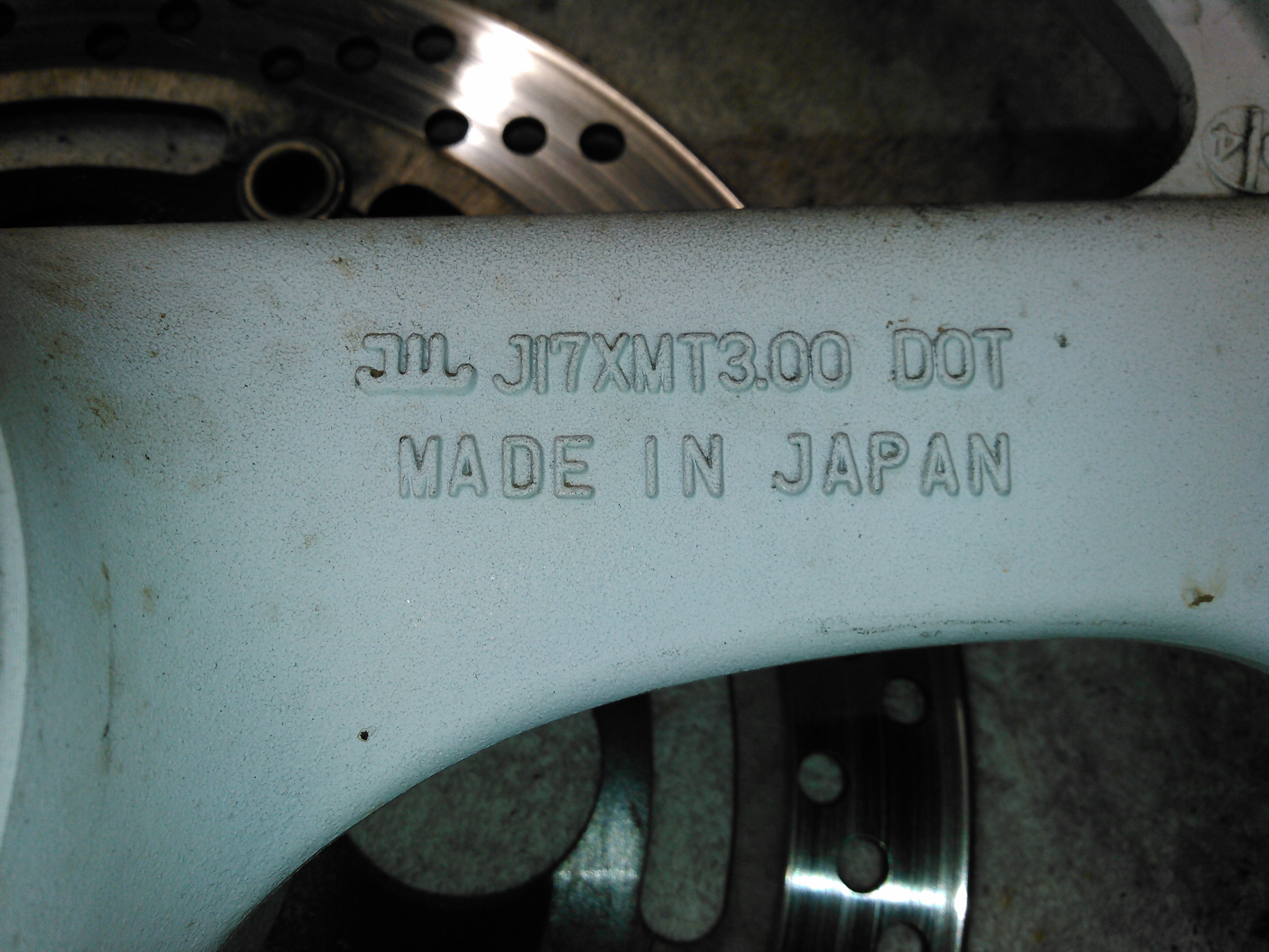

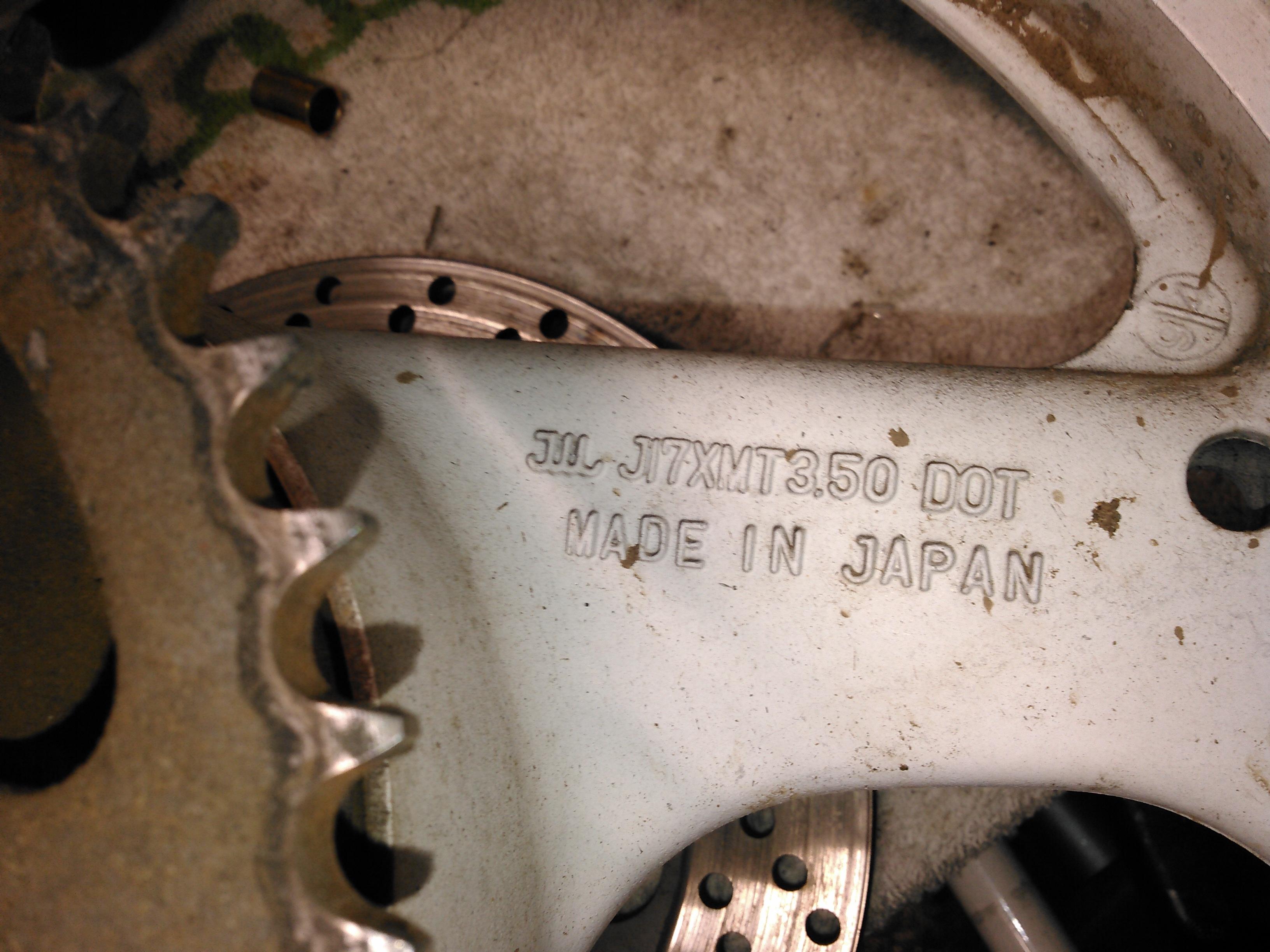

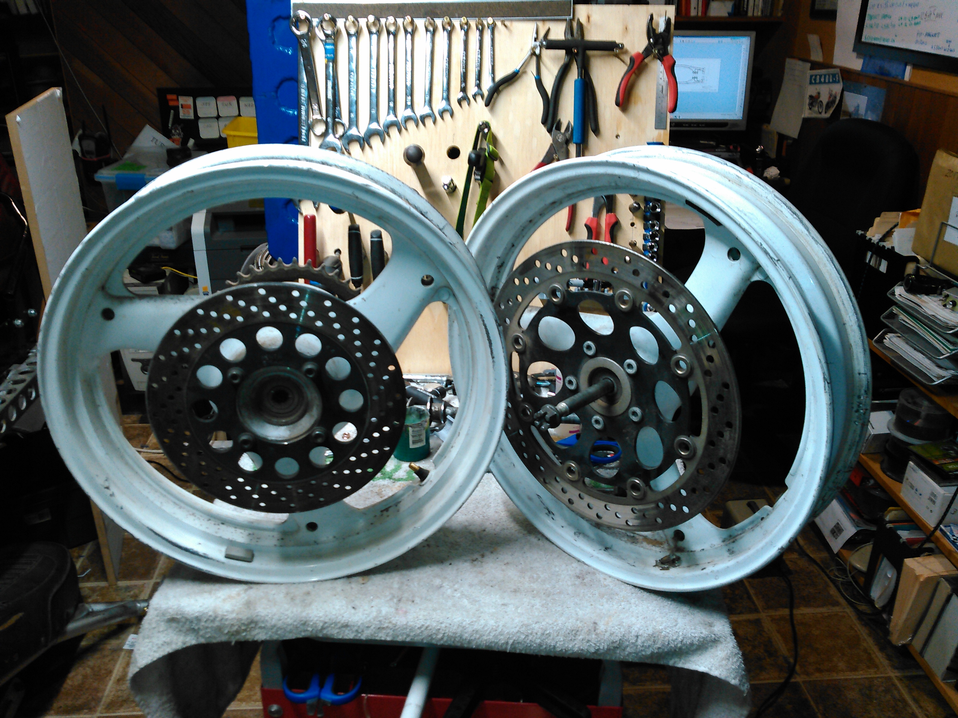

Well, looky what showed up at the door this morning. Wheels from a Suzuki GS500. I've always used wheels from the CBR600F1 when getting rid of the spoked wheels on the CB400F. The front CBR wheel is good for a 110 wide tire, and the rear is good for a 130 or 140 tire. But, they are getting harder and harder to find with good brake disks, so the nice sets that I used to find for less than $100 a set are now creeping up to $200 - $300 a set.
I thought about trying CBR250/300 wheels, but they are still pretty expensive too. Then I thought about the GS500. The stock tires are 110 front and 130 rear, and unlike the CBR that was only made for 3 years, the GS soldiered on basically unchanged from the early nineties into the mid 20-teens, so there are tons of wheel out there and they are cheap. I paid $90 USD for this set from a 1994 model. The shipping to Canada was more than the wheels.
After a quick check it looks like the rear axle for the GS will mate up with the CBR-F1 swingarm just fine. The GS front axle is a meek 15mm diameter, while the CBR-F4 forks that I have sitting here are base on a 20mm axle, so I'll have to see if I can do some bearing switcharoo to use an F4 axle, or make some sleeves to use the GS axle.

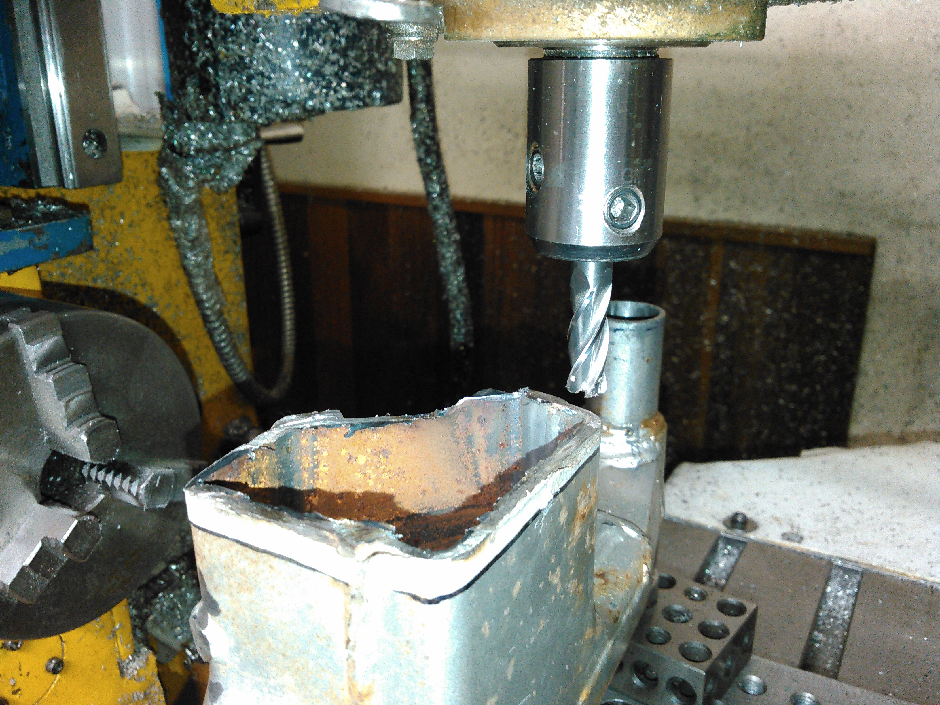

I made up a mandrel to fit into the swingarm pivot tube, and the mandrel expands as you tighten it down to grip and hold the tube. Then just some machine clamps on the arm.
I can now machine out the center section width that I need, and I end up with perfectly square surfaces for welding everything back together. (In theory anyway).

So much work, so little accomplished. I made up a dual expansion mandrel to fit into the swingarm pivot tube to align the two halves before/during welding.
Took about 3 hours of machining, then 15 minutes welding. I think I'll add some half moon sleeves on the outside of the pivot tube, but it's good enough for now to proceed with mock-up.

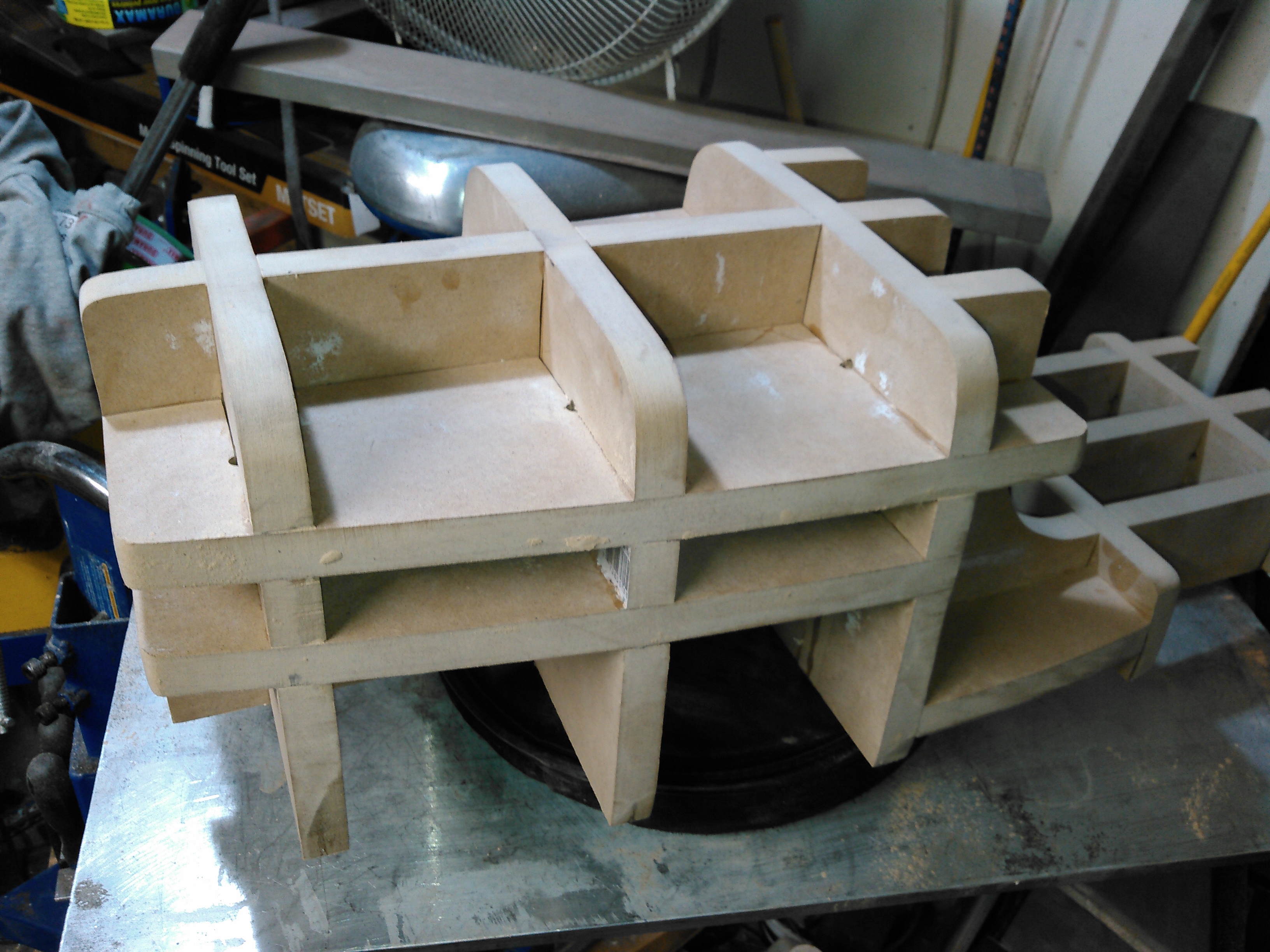

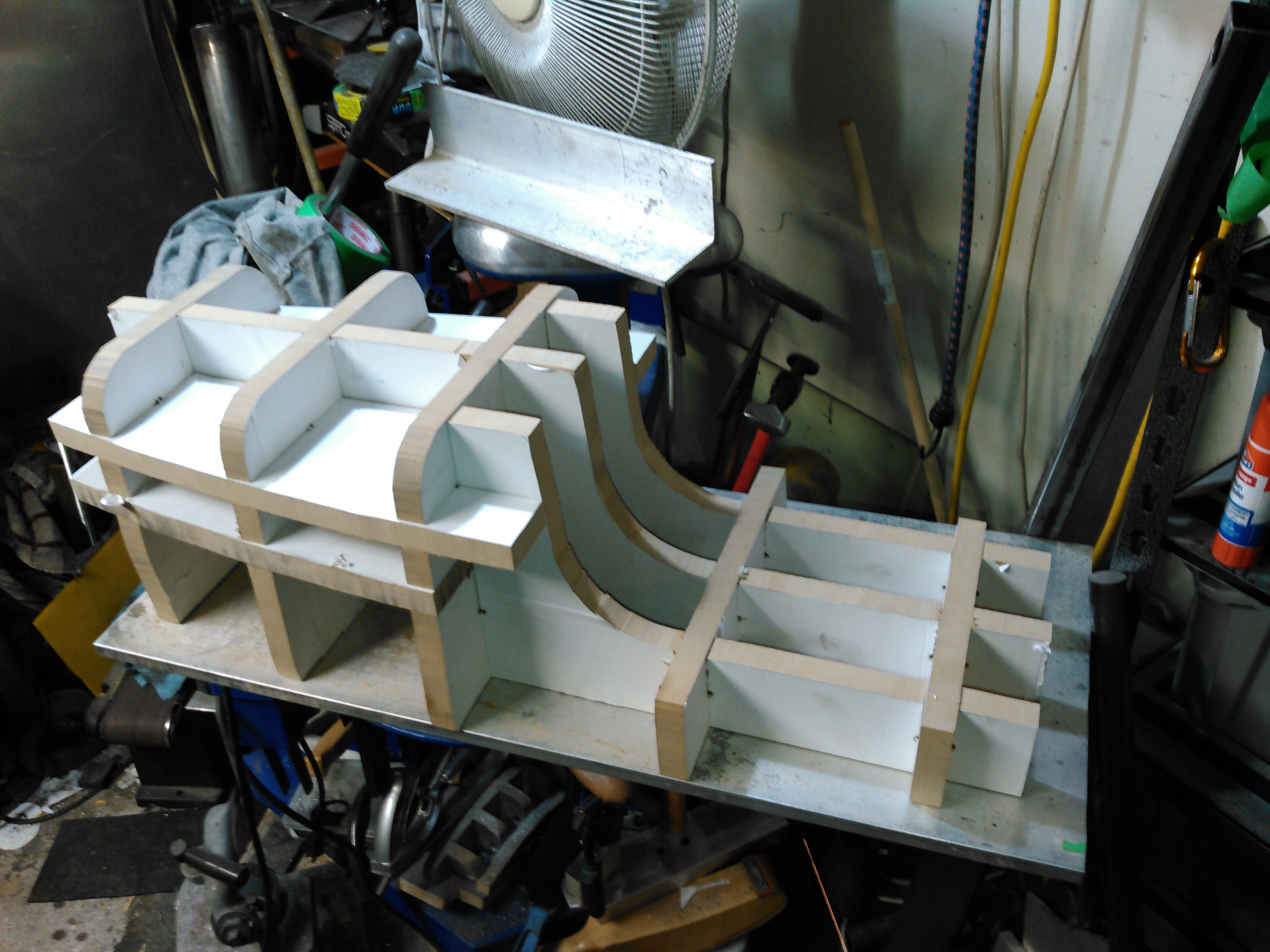

Jumping around a bit already. I'm waiting for some tooling to continue with the swingarm so I turned my attention to the tail section for a bit.
1. The pile of parts are 3/4" MDF cut up to make a buck for the tail section.
2. Dry fit all the parts to make sure they all go together.
3. Everything glued together, and all the edges and radii "faired" to each other.

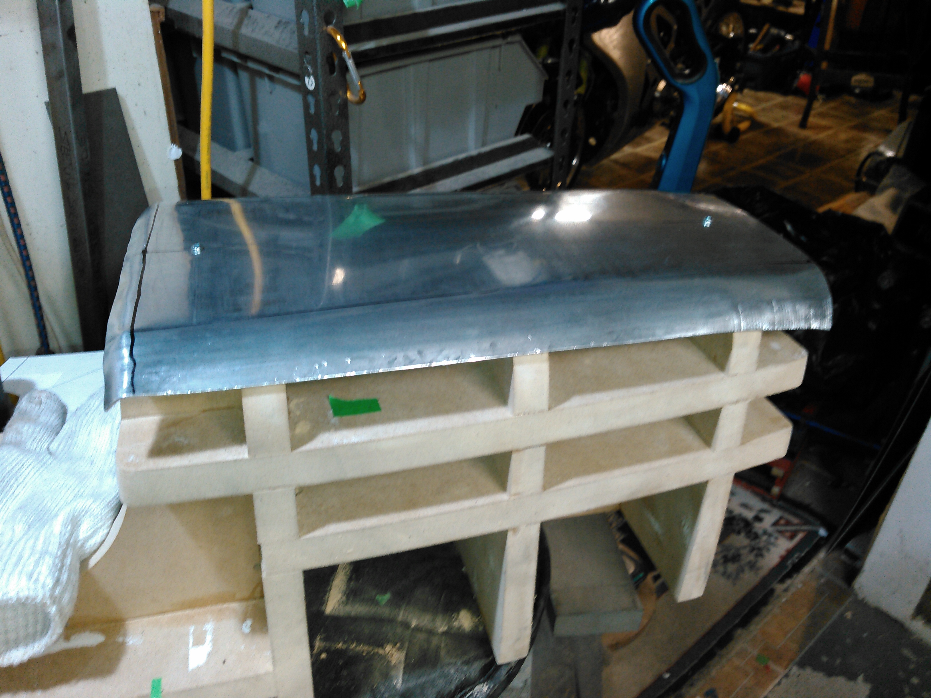

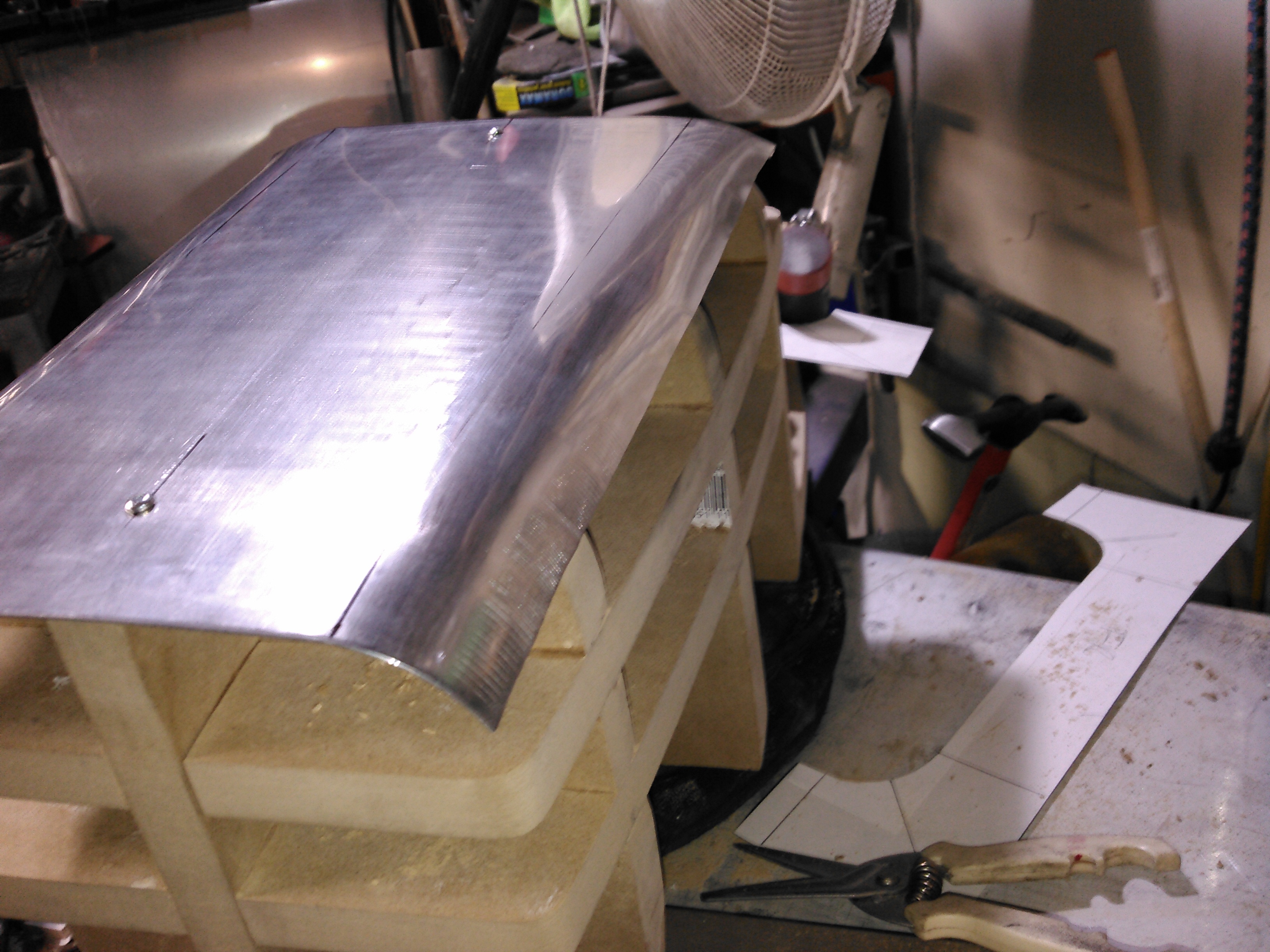

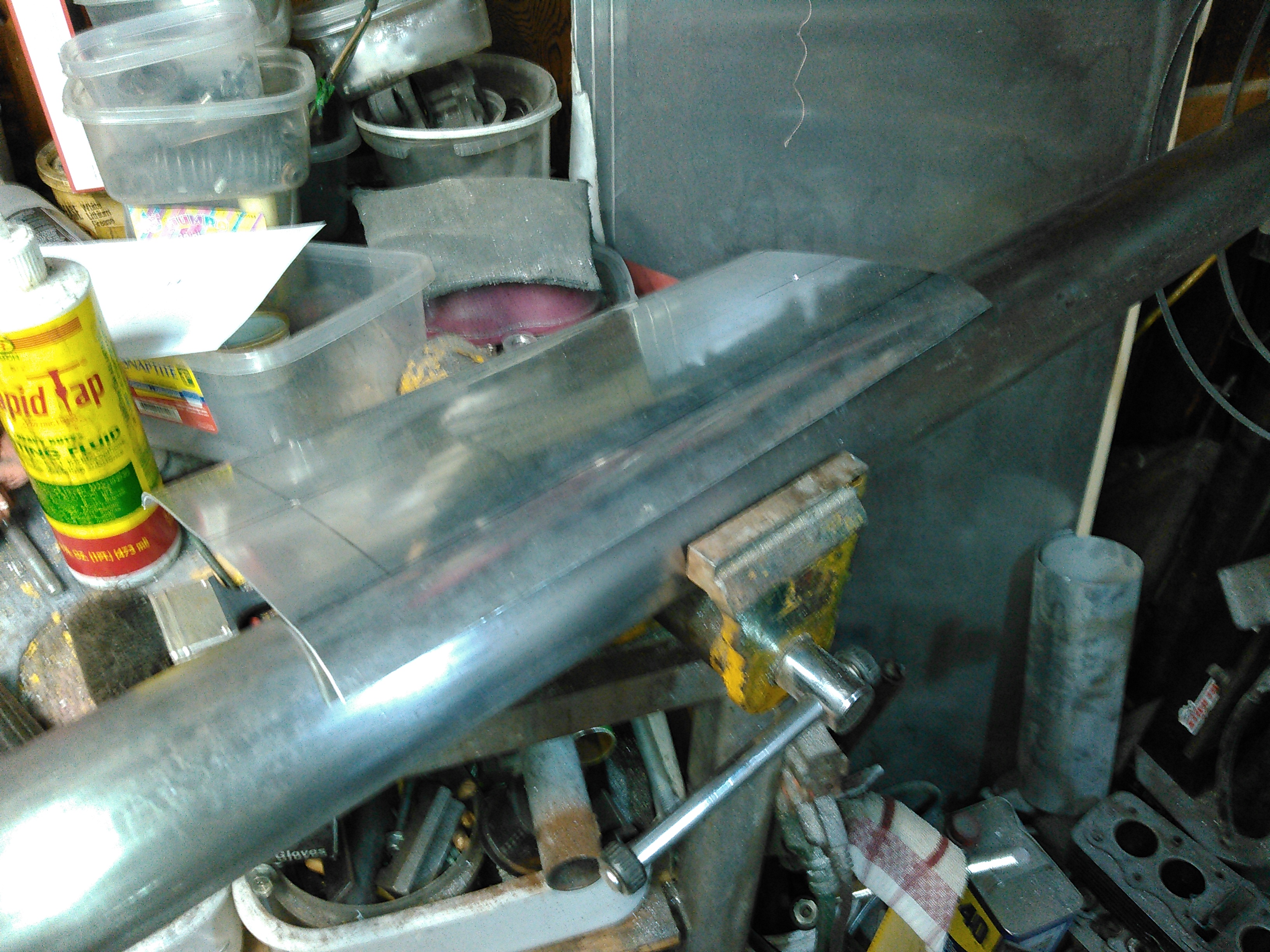

I started with the top panel of the tail section. Started forming the edges around a piece of 3" diameter tube. Got it roughed into shape. Will have to refine the edges as the other panels are mated up.
