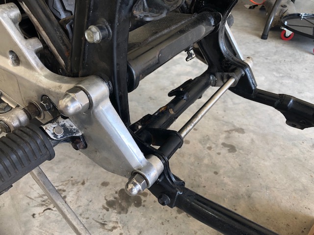

I have the rearsets from the 750f on my '79 750k.  I found a swing arm pivot bolt, just need the lower engine hanger bolt to complete it. 90157-445-000  (12x404).    Does anyone have one or can help me locate one?

If you just need a bolt that size, not a factory Honda part, call your local Fastenal or check McMaster Carr. Really any industrial fastener supplier.

I had no luck finding either one of those. I ended up buying 303ss rod threaded both ends and used cap nuts.

Yea, I ended up ordering a 1566 carbon steel rotary shaft, hoping I can get my local machine shop to add thread to either end.   Thanks
