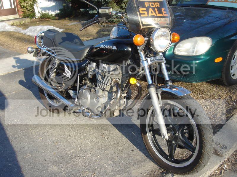

Thats how she started pre purchase, I stared at that pic while eating my home made lunches, and counting the change in my piggy bank, while contemplating a loan. I thank that fine gentlean for being patient with me.

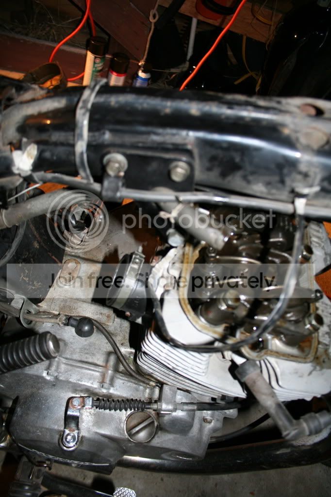

and I also wasnt sure which one was the oil drain bolt. Bigger one on the left or small stripped one in the middle?

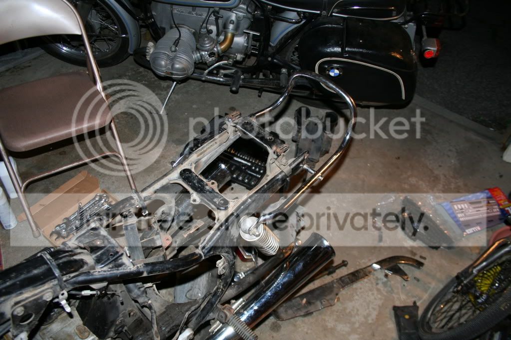

Heres some pics of the sauna garage rucus.
excuse the mess and bad pics

If you've already stripped the screws, you gotta drill them. The screws are m6, IIRC, so drill with a 1/4" bit, It will pop the heads off easy, then you can pull the cover and the remainder should turn out very easily.
As for the bolts the horizontal appears to be the drain plug, and the vertical is for the oil filter. I haven't messed with my CM400 yet, didn't even think they had oil filters.
I also had the same problem with my cm400's oil drain plug. All i did was find the BIGGEST pair of channel locks i could get my hands on, and squeeze hard and pray. It popped loose and i already had ordered a new one with a larger head.
