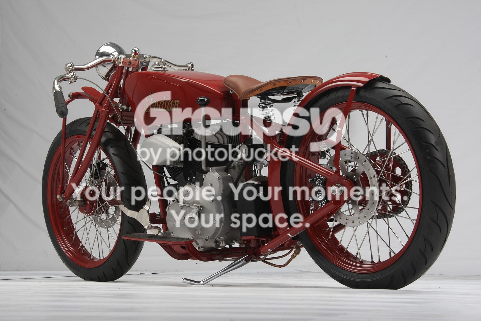

;) Where or how- could I find some guys like these.. just that low profile, swept back bar.
Could I get some from a beach cruiser, or are those too this gauge? Cuz damn. I love these.

If i'm not mistaken, that IS a harley, or a cyclone, and also if not mistaken, would've already been 1" bars, so agreeing with above, i think you'll Only find those bars, off a shelf for sale, in 1" OD size. You could make a set though probably. Or just convert to 1" bars.
yeah, '25 indian, i have 1" m styles and their just killin me tryin to adapt all the forward controls. so hmm. if any one else likes the style check outa 90's kawasaki KZ1000 police bars, their supposed to be for my lil 360 tho
For that swept back look have a peek at old board trackers. Some amazing bars, adjustable too which just makes them even more drool-worthy.

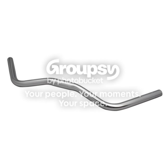

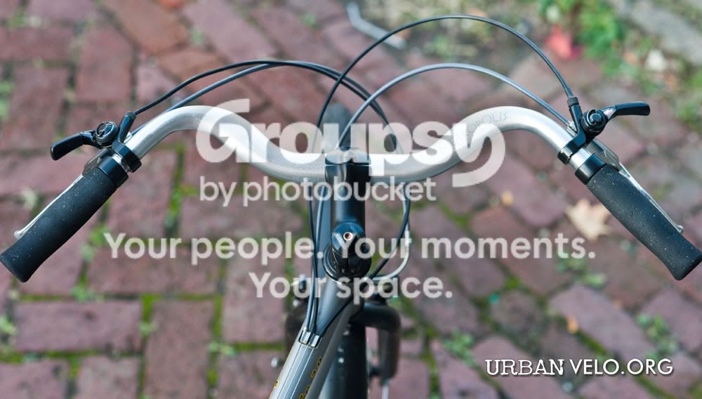

bicycle handlebars will work. I know a few guys using mustache bars and some others using cruiser bars from bicycles. I had bmx bars at one point, and went back to them (albeit an actual motocross bar set that is tall). Anyway, the steel is pretty much similar in wall thickness, though the 1inch bars will be heavier duty than the bicycle ones. I wouldn't waste time machining out risers and then overpaying for a set of 1" bars. Just get these bars and save a ton of money.

there is a whole bunch on there that pretty much replicates the look
also, though it is listed as a 1" stem mount, since risers aren't center mount you could most likely find they are in fact 7/8" mount with the use of motorcycle risers. I have a set of factory cb175 bars that are the same exact way, with a 1" center, but 7/8" mounting.
