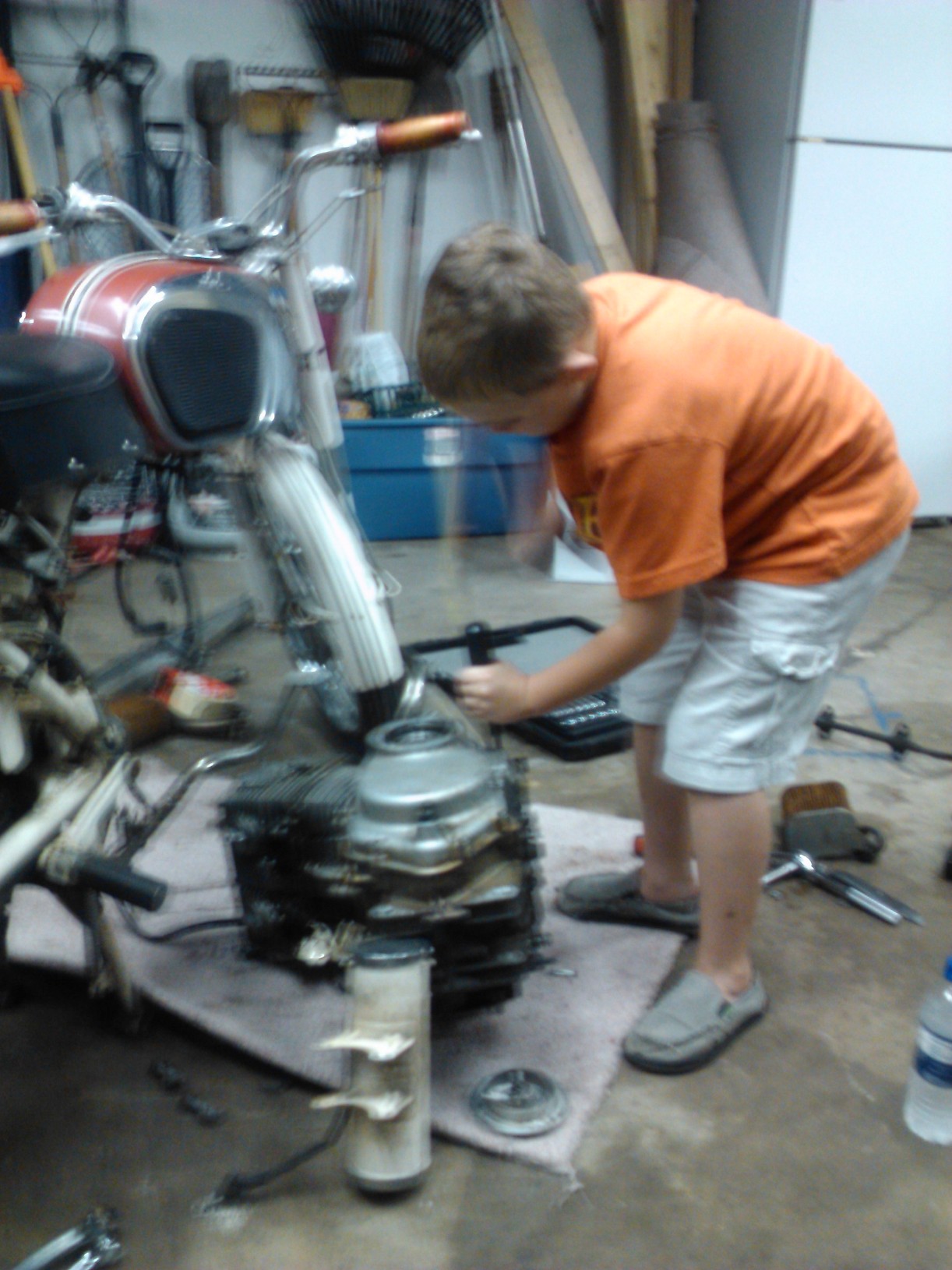

Heres my 7 year old getting some use out of the impact screwdriver :)

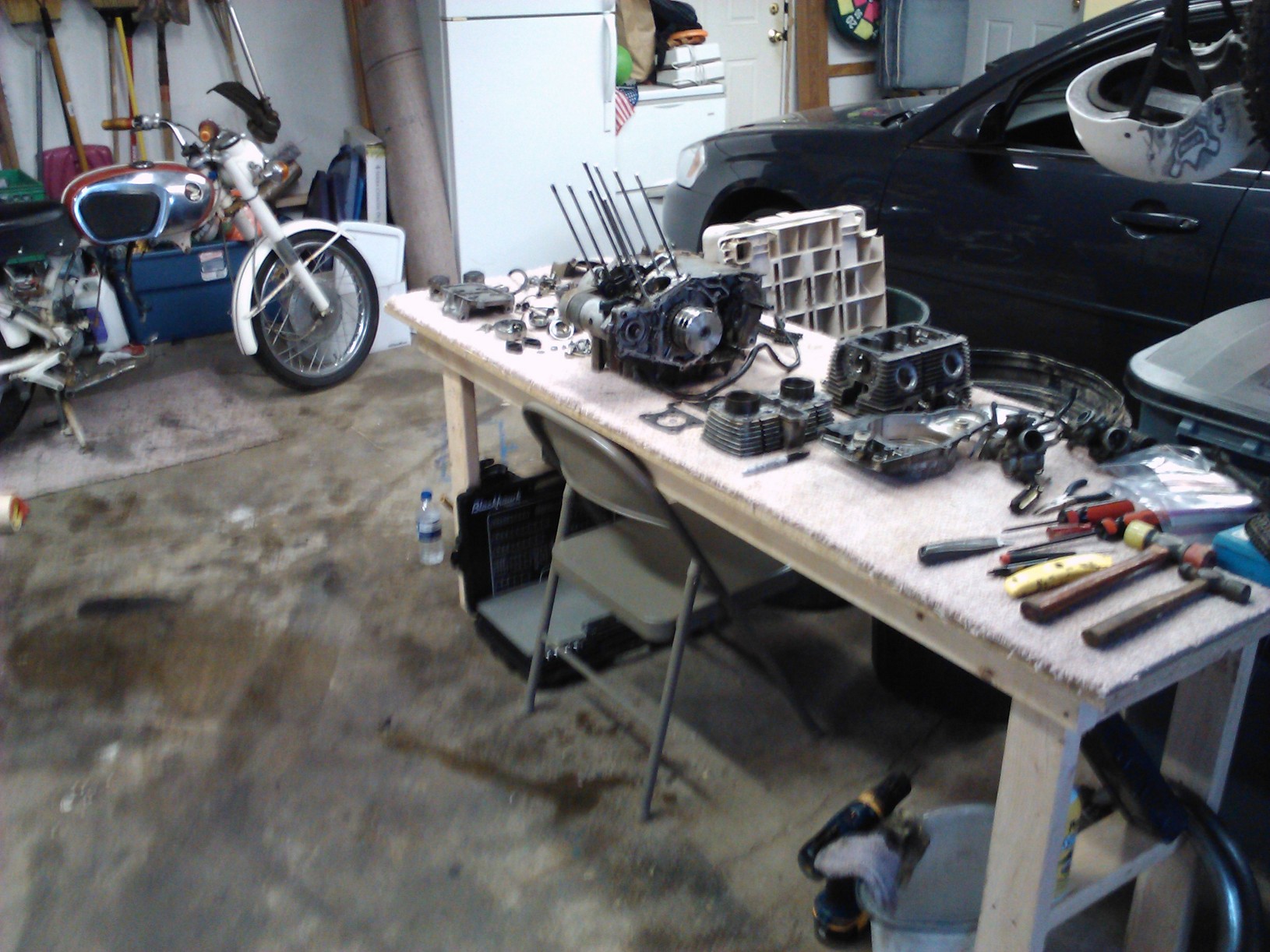

Then we built a table, and got organized. Once we got the pistons free, we pulled them out and noticed one of them was totally blown out at the bottom, hence the sticking when they went up into the cylinder...
