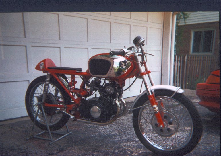

Or you could go full on race bike with all the modifications plus an RS125 fairing. Or more basic racer. You have choices.
The one with fairing has Mikuni crabs, modified kawasaki pistons, cam, and welded and reshaped combustion chamber. The naked bike had 175cc kit, mild megacycle cam, Dyna on the cam, race brake linings, stock carbs and I made 4th place at a couple of AHRMA events when I was dialing it in.

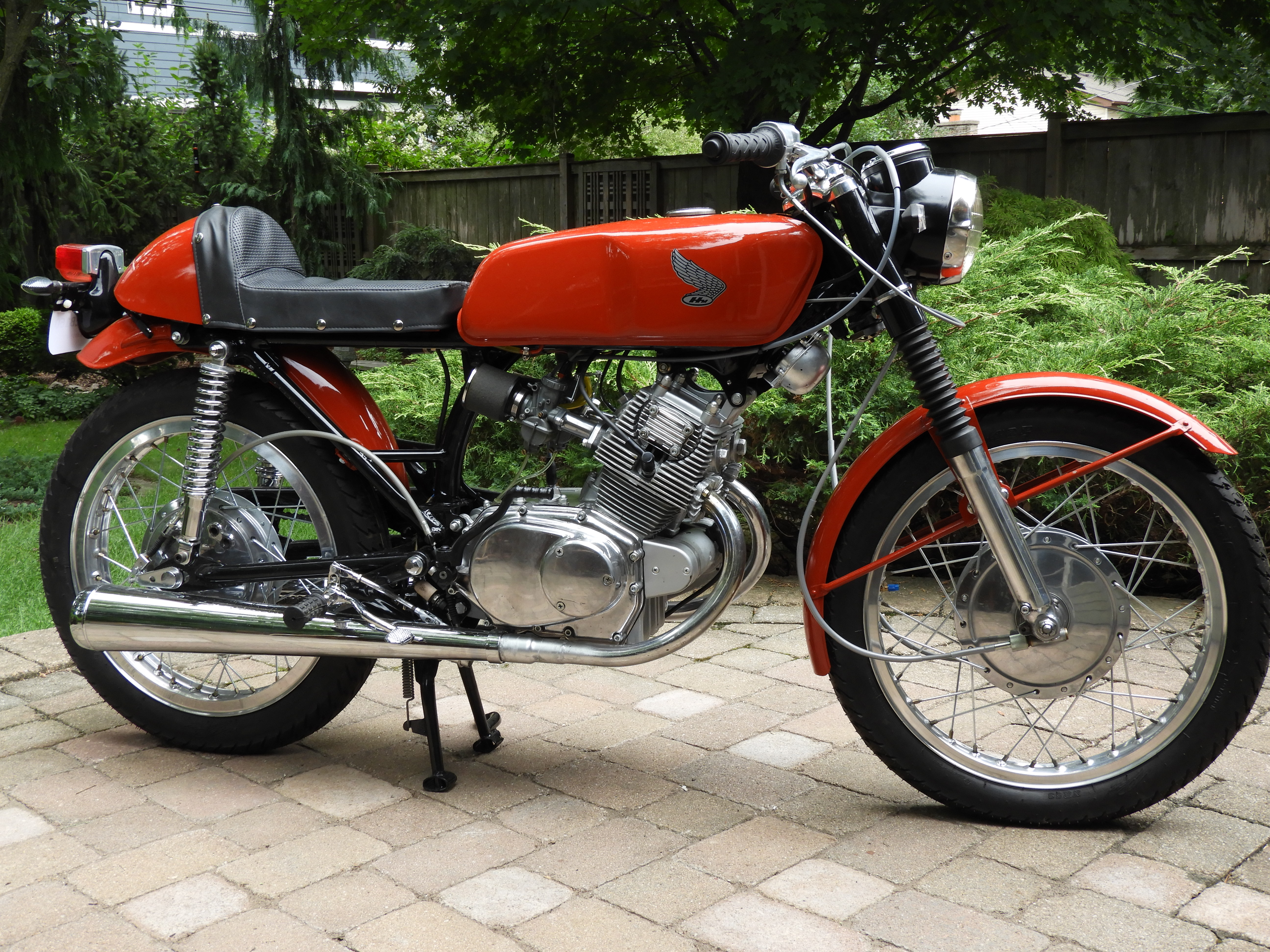

Or you can spend way too much on making it look pretty. This one had Hap Jones 2mm oversized pistons, raised compression but stock carbs and cam and could easily do burnouts. I was given the bike and wanted to do it justice, but it costs almost as much to build a little twin as a bigger one. But it went to a good home.
