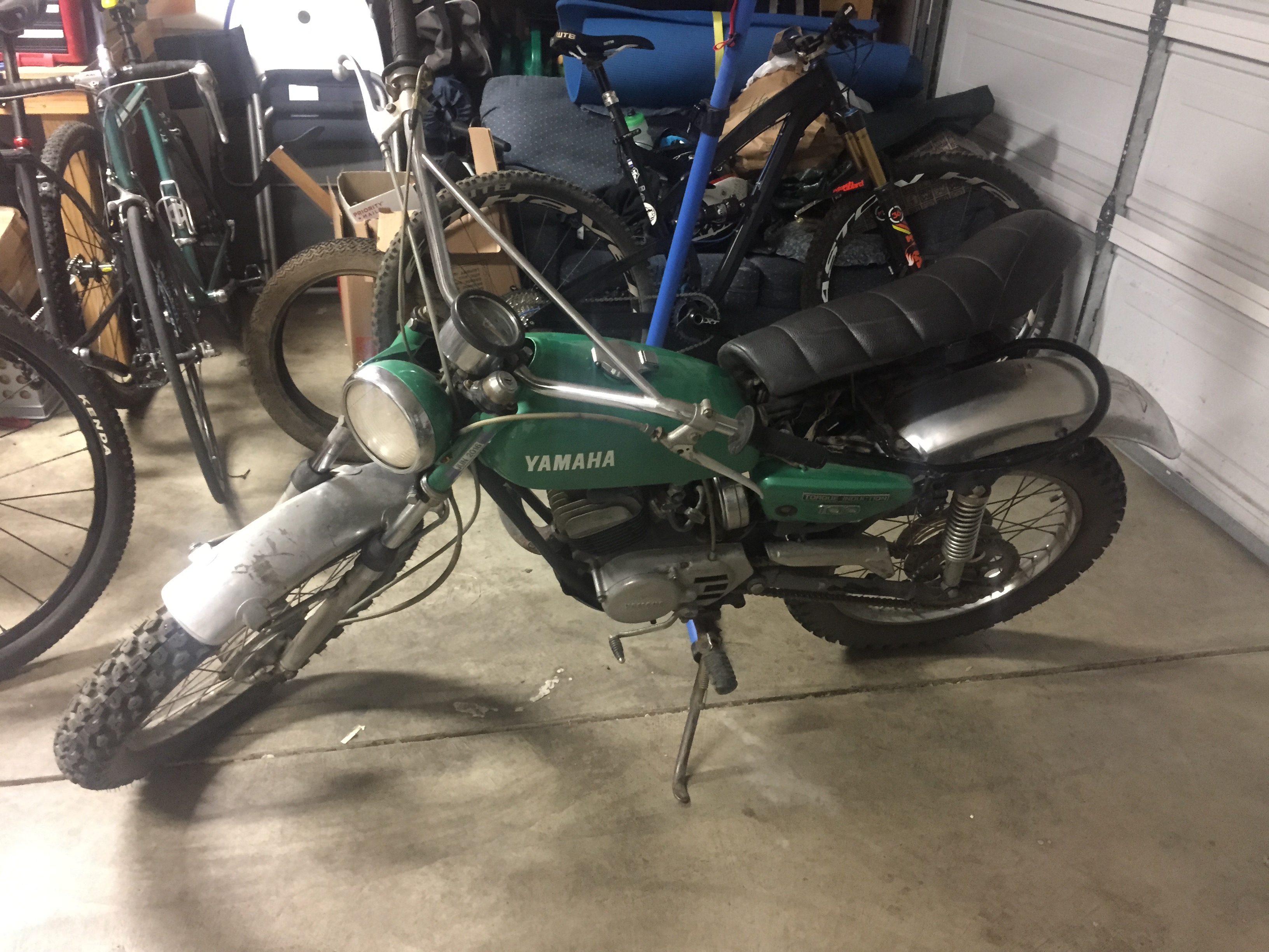

Hello all, just picked up a LT2 for dirt cheap yesterday. Currently only registered for off road (needs head light hooked up, battery, and tail light) but I am aiming to get it back on the road to use as a commuter to and from school. Starts right up on first kick and has a brand new top end and tires on it. Paint is not original (though somewhat close) but I am thinking about repainting it at some point.

Tested the stator today and it puts out 18V at idle so I will be converting to 12V :D. Now I just need to order up a battery, regulator/rectifier, and a new headlight!

I like how that Suzuki says YAMAHA on the side of the tank... weird
I didn't want to be the one to point out the obvious.
