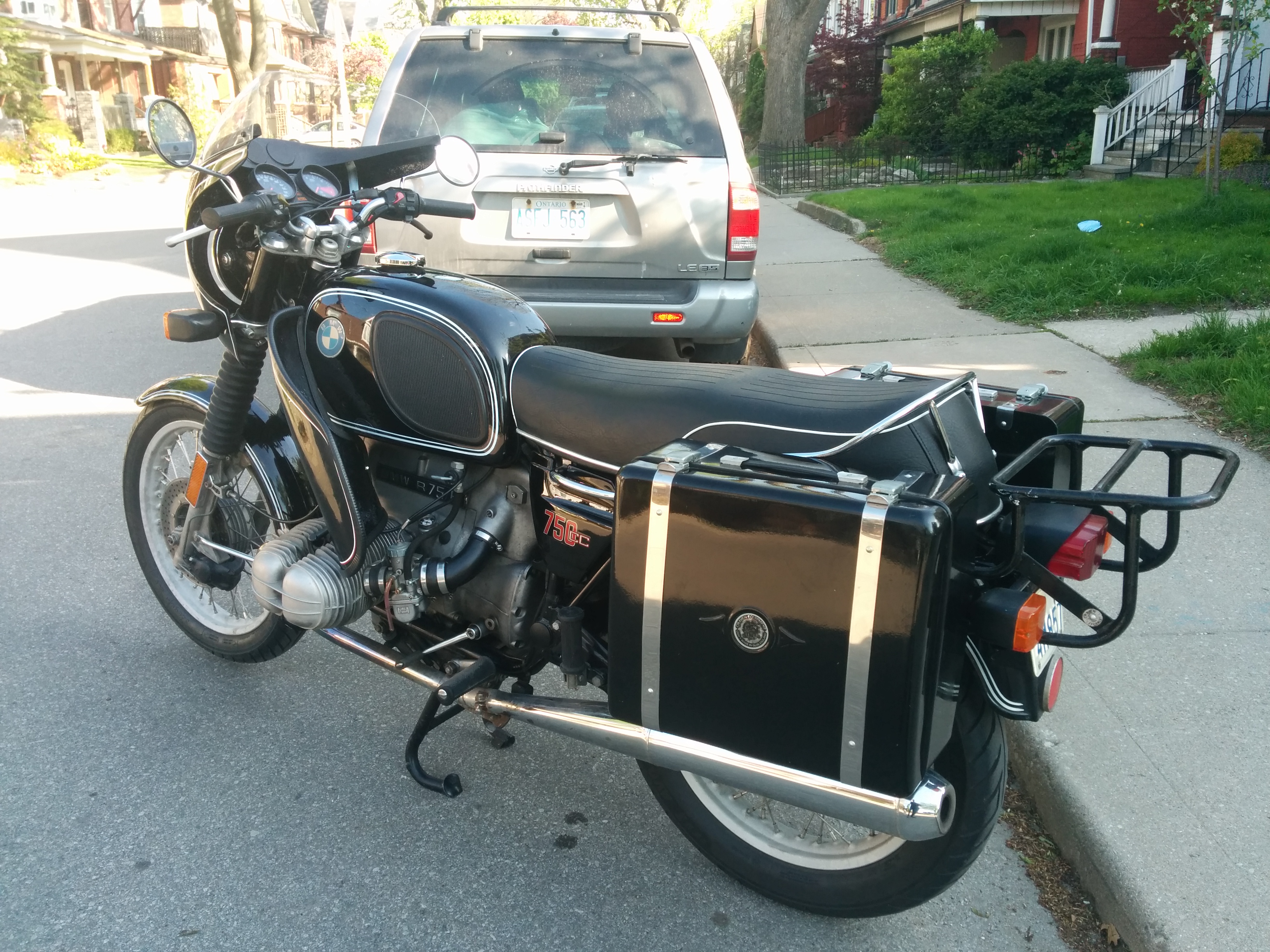

I like the dressed up look, but have stripped mine back to stock config for day to day riding.

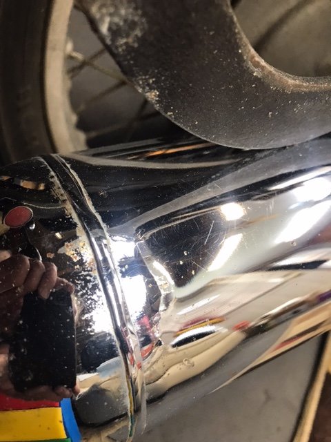

This thing is frikkin dirty! For the most part, though, when I rub and buff much/most of the schmootz and rust spots clean up. This is the left muffler along w/ some of the left side:
Here's a pix of the right muffler after a few minutes of cleaning:
It isn't perfect and needs more work, which it will get once it's removed, but jeez what a mess. Yeah, I've seen worse on machines that were "stored" outdoors, but it's pretty grody. This really reminds me of the necessity of putting a cover on any machine that's going to be stored. I've heard complaints about covers holding in humidity/moisture, but if you live in an area with higher humidity, putting DampRid under there should help... just remember to empty the water out every once in a while and replace it when the crystals are gone. I have no idea how clean or dirty this old girl was when parked 30+ years ago, but I'll bet it would be far cleaner and less rusty now if it had been under a cover. This is especially important if your storage area is also used for wood working. I'm sure @Hurco550 can tell you about the sawdust that's still on his CB350 that spent the winter in my shop. (Yeah, Levi, I should have thrown a cover over it! Sorry!)

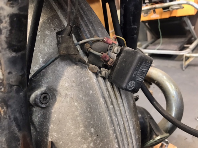

And finally... here's a better shot of the aforementioned relay for the Fiamm horns.
