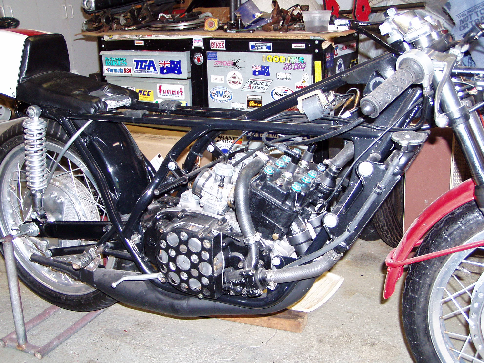

he missing part is no biggie. Ugly perhaps and not unusual. How are you planning to mount the water pump and route the hoses? LC and RZ go through the crankcases, TZ go around the outside.
This is an RD bottom end and TZ750 top end with Blaster reeds and modified side cover with a TZ water pump. You could try an LC side cover and pump and modify the cases. As you can see, the top part of that side cover is removed
We used LC radiators on our TZs because they were cheaper and more plentiful but the lower outlet had to be cut and welded. Using an LC side cover with oil and water pumps would be a clean solution.
You could also look at a Banshee side case but the kickstarter shaft is different and the water pump drive needs a boss on the crankcase. Kickstarter is easy to machine up a bush to fit a banshee shaft into RD cases. On the drag bike I may leave the water pump off, but for street or track it's crucial - you could use an electric pump though.

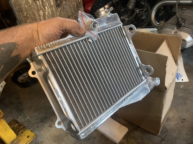

I think we'll go with an electric water pump. I have a TZ style radiator.
LC but cut and weld that lower outlet and it's almost the same as a TZ. TZ has filler cap at a different angle but the differences are small. Those are good radiators. I have one to put on my next/last TZ.

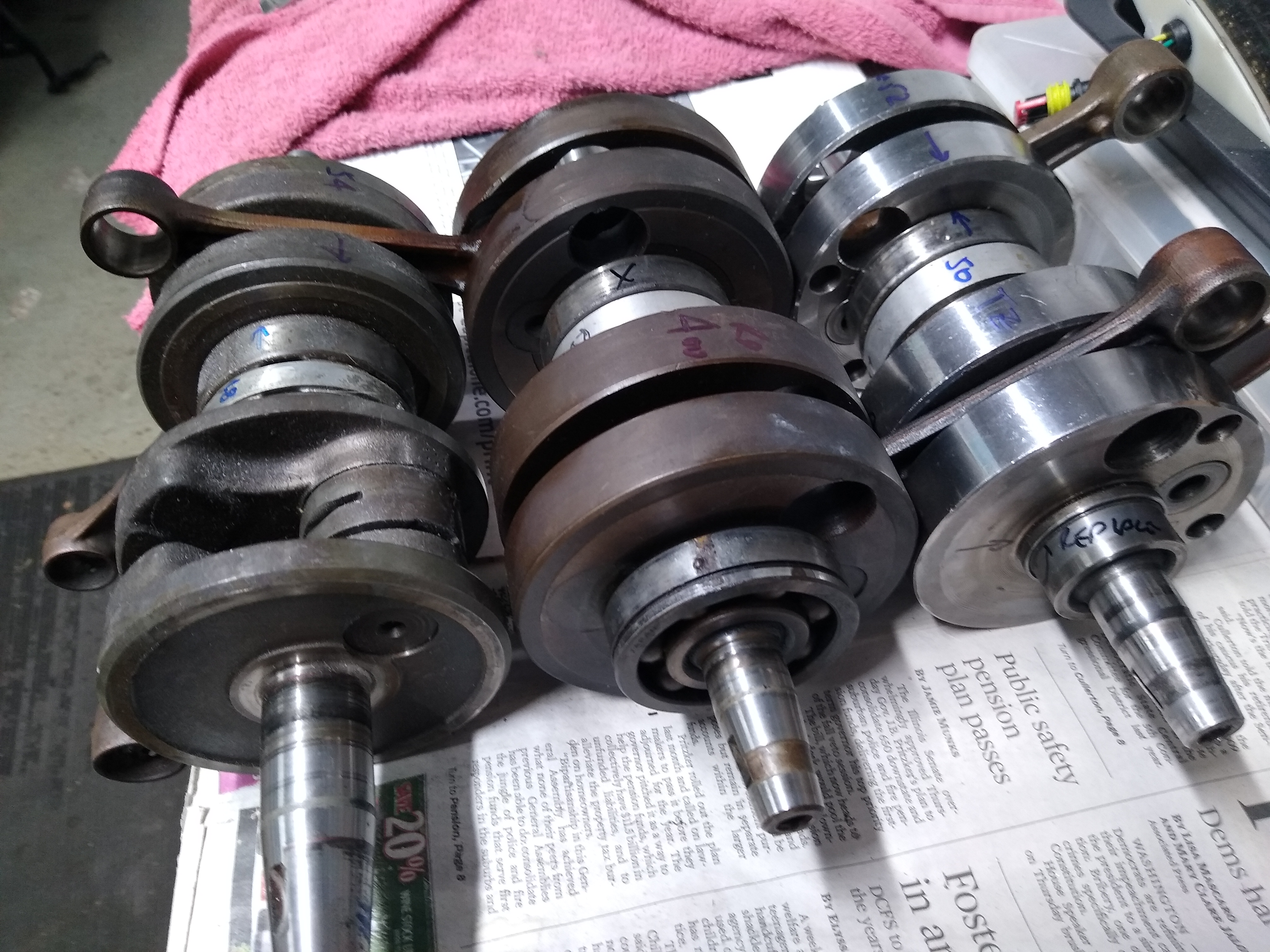

If the crank needs to be rebuilt, a Vito's crank is cheaper and all new parts. Not sure what the hybrid crank means but it may have TZ roller outer bearings which are not good for helical cut primaries because they can't take side loads. Inners bearings are the same on RD and TZ but TZ cases are grooved to take C rings to locate the center bearing. The crankwheels are actually different but the same size. Banshee are almost the same but a couple of MM wider, so the cases would have to be machined to get one in. These are left to right, Banshee (dead), RD400 and TZ350.
RD250/350 and TZ's share the same 110mm rod length but RD400 are 115mm - the so called Long Rod.
