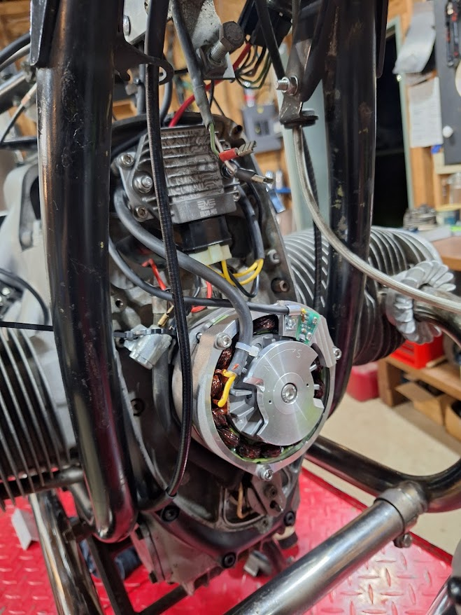

This is the picture that kind of started this whole rebuild thing. I had been having intermittent issues with this bike. After about 30-50 miles, it would lose a cylinder. After the last ride home, I opened up the seat to find a burnt up bunch of wires. What it turned out to be was this mod podge of a mess of wires going to the battery positive post. Multiple junctions, splices, auto store fuse holders etc. When I took this apart, I thought of the multiple times that I've been 300 miles from home in southern Ohio, with no cell service and nobody knowing where I was lol
I am working through the install of the updated EME charging kit and programable ignition. I opted for the kit that is lithium battery safe as well, should I ever choose to go that route down the road. I am cleaning up the wiring as I go too.

Looking good. Sorting out the wiring is a pain, but always feels good to be confident in what you have. Opting for the new harness for the Guzzi was the best choice I ever made lol.
I have definitely thought about a complete harness replacement, but for now, I'm going to stick with the basic front engine harness replacement that comes with the kit. The rest of it seems to be in pretty solid condition. I'm with ya though, I want to be able to point and go on this thing again without worrying about things breaking

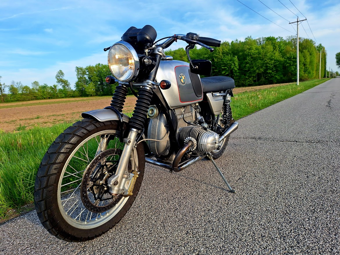

Though I'm bad at updating threads, I did get the bike running, and have put about 100 shakedown miles on it. The first "real" ride (more than around the block) was with our esteemed member, @ridesolo . Pretty cool that the bikes are the same year, make and model, yet have such a different twist on them.
I still have to do a bit of wiring to wrap up the rear turn signals, install a new inner fender that I made and rolled, but otherwise, Im very happy. I am a bit rich on the pilots, but for this early on with still breaking in rings, I am going to leave it. Though I'm keeping it in the bottom half of the throttle range for the 1st 500 or so miles of ring break in, its peppier than it was before, and I'm excited to see how it does when it can be opened up. I feel as though that is where I may see some benefit to the head porting etc.
Either way, here are some back road beauty shots.
