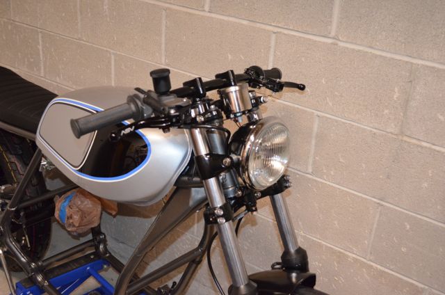

Goings been slow since my son was born 6 weeks ago. He's number two, so I've already made the life adjustment. I've still been making progress, but it's one thing at a time. My gearbox is coming back tomorrow, so that's the one missing link before I can put the whole shebang back together. My forks came back from racetech, rebuilt, gold-valved, and lowered. I also made a speedo mount, I need to get some better hardware for it, and it is going to be a tight fit with the speedo cable, but I like where it sits.

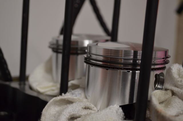

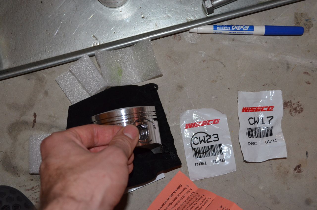

I've been making steady progress and thought I could knock out the other major engine areas this weekend. I have the left hand side all assembled. I then started on the clutch and managed to snap the wire that keeps the first steel friction plate in place. F.
I ordered it up online, but it'll be Wednesday. Well, I can get the pistons, cylinders and head on. I got the first two pistons on without a hitch, and then opened the third to find the wrong size circlips as pictured below. I ordered up the correct circlips for $2.00, but it'll be Wednesday. So much for getting the engine back in the frame this weekend. My wife will be happy.

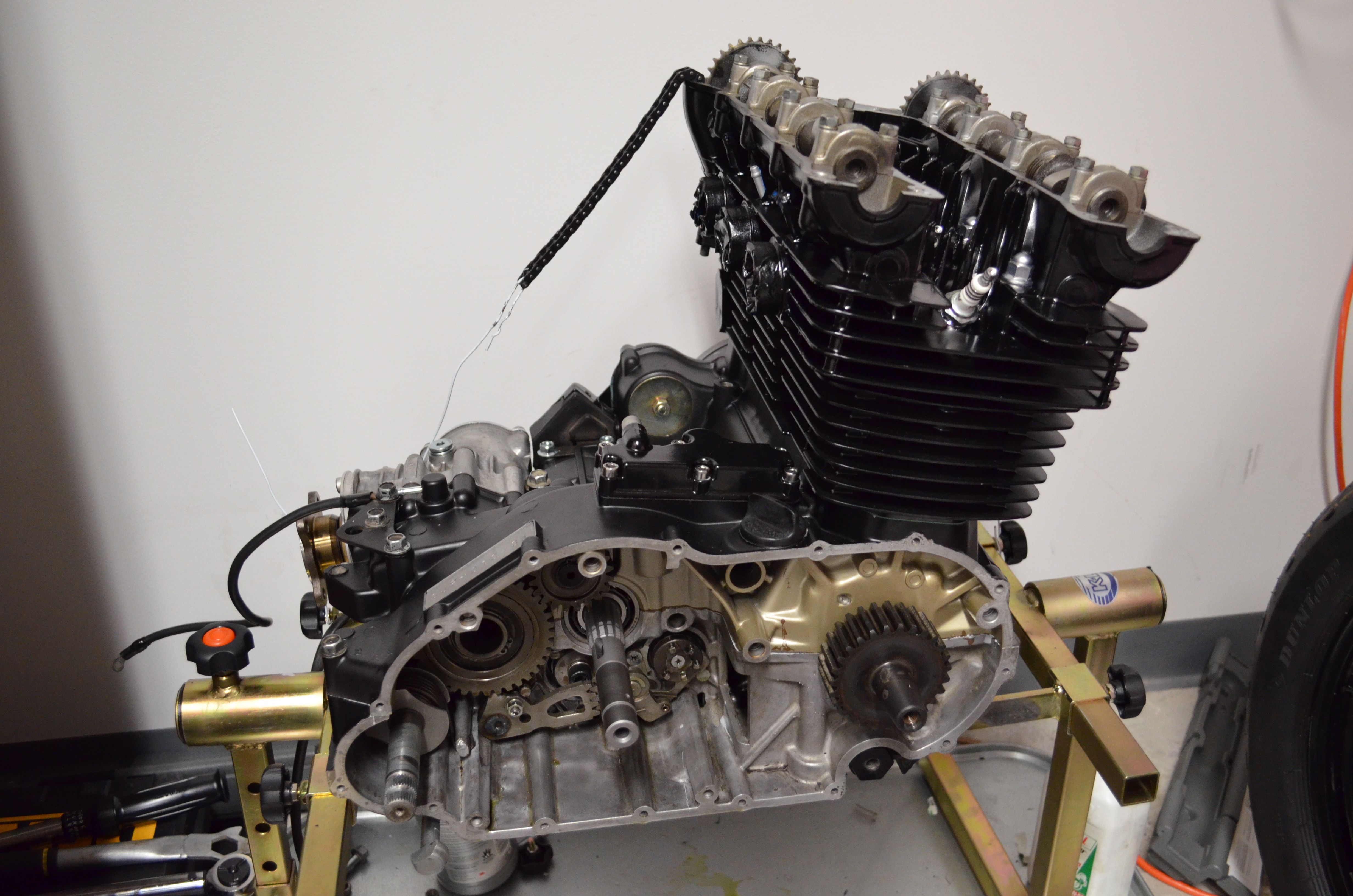

The clutch parts that I ordered back on May 26th still haven't arrived, but Wiseco comped me the circlips and got them out immediately. Two thumbs up for excellent customer service from Wiseco. I got the cylinders and head back on. It took some work to get the pistons in the cylinders. I bought the cheap ring compressor off E-Bay. It worked, but I would not recommend trying to do it all solo like I did. Keeping the cylinders aligned was the toughest part without a spare set of hands. It was not as simple a job as I'd thought it would be. I'm going to wait until the RHS cover is back on before putting the engine back in the frame. This weekend I'll get the cam chain linked and hopefully have the clutch parts so that I can finish it up.
