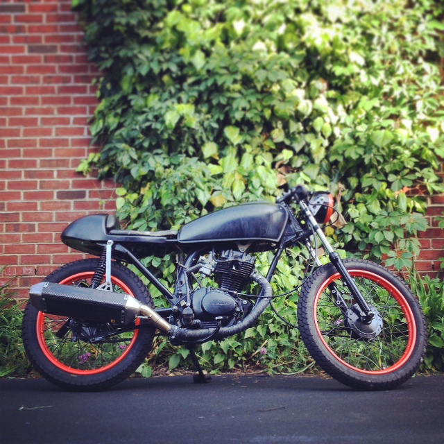

Hello,
Welcome to my thread about my recently purchased 1979 Honda CB 125 Cafe Racer! I know there will be many topics and issues arising in this thread that have already been mentioned in others, but I'm making this thread to book-keep my progress on tuning and fixing issues that arise with my bike. With all this being said, I really appreciate helpful comments and advice, even if its just a link to another thread with a similar topic.
Well here goes....
I bought a 1979 Honda CB 125 motorcycle that the previous owner had cafe'd. It has great compression, the electronics are all in order, the cosmetics are all good, and the bike is pretty slick looking! The previous owner got the bike in a trade deal so I managed to get it pretty cheap. I've attached an image of the bike, hopefully it shows up!
So the bike fires right up after one or two kicks and will run but not idle. The engine also gets a little choppy at higher RPMs...yet I can ride the bike up into 4th and 5th gear. So I've been doing my research and these are the steps I am going to take to remedy these issues:

Check slow jet, and main jet. They migh be clocked. At that point I would'nt even bother changing the fuel.
I mean change the fuel AND clean the carb.
That's some exhaust can you have there.
Are there any air filters on those carbs? I think you need something on there before tuning.
I'm actually going to end up replacing the carburetor.....after looking at the carb thats on there (a cheap Japanese knock off...not a Mikuni) I am thinking it will solve a fair amount of problems. The carb I'm getting is a Mikuni 22MM (VM22-133) Carb from AGK. I'm going to use an intake manifold off an old 80' CB 125 and pop a pod filter on the end of the carb....
I will reply with the name of the carb that is currently on the bike....I can't remember it off the top of my head.

I know! The guy who had it before me threw a carbon fiber exhaust on the thing....a little big, but it does the trick I guess. It sounds great, thats for sure.

You MUST have a filter on that bike for it to run even remotely well. Any kind will do better than an open carb, but the stock airbox is very well engineered and you are unlikely to find a better alternative.
That exhaust really is something, looks like it's off a CBR or something? Might be another thing to tackle, the stock exhaust was also quite good on these bikes.

I was thinking just a regular pod filter might work alright? Yeah, its a carbon fiber exhaust, not sure where the previous owner got it from. Might consider changing it out for another.
