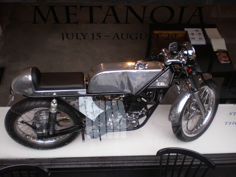

Also wanted to share this cm400 cafe, I was walking down 14th street in New York and saw it in the window of an art gallery. It's pretty heavily customized, that is clearly NOT the original frame or swingarm, among other things:
