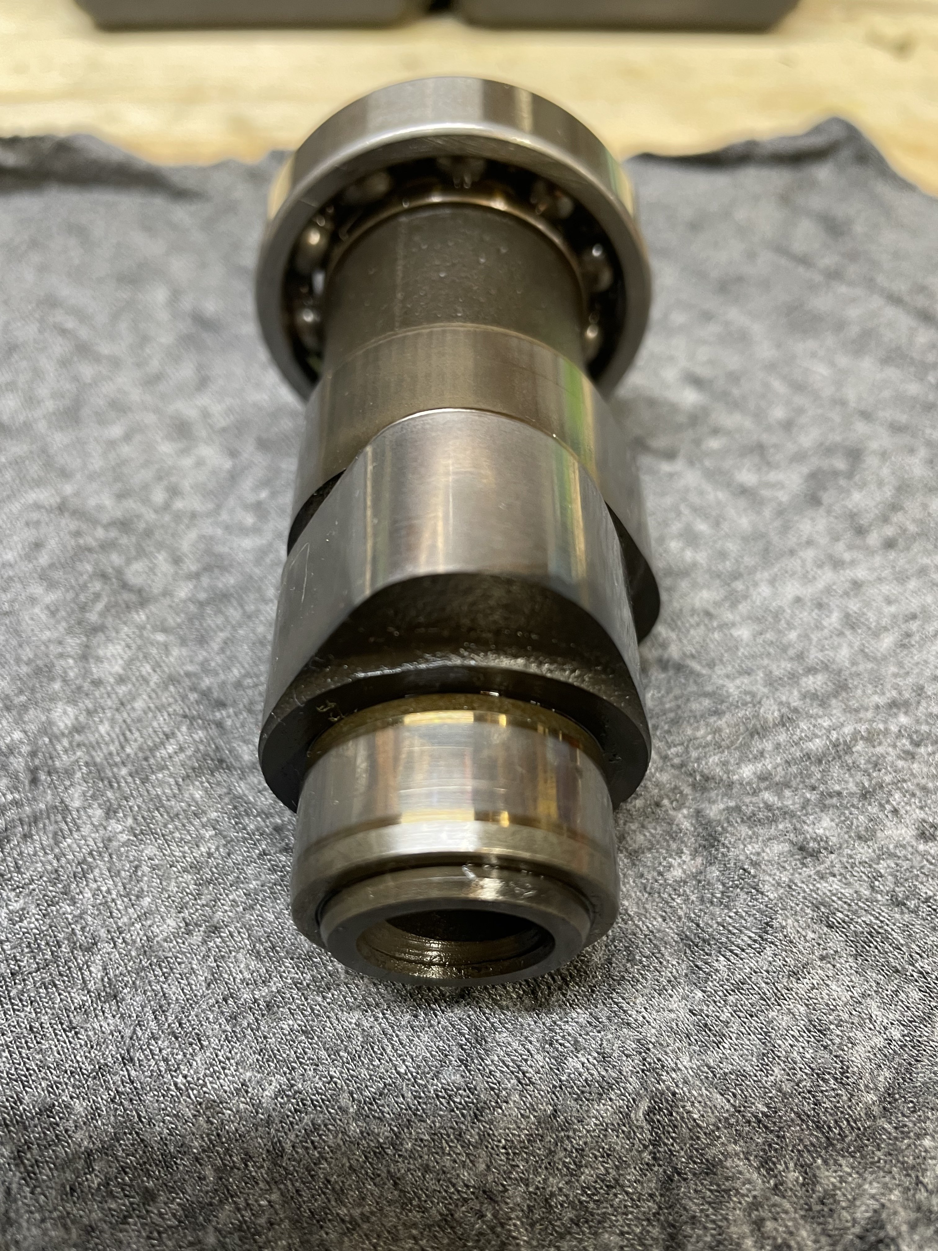

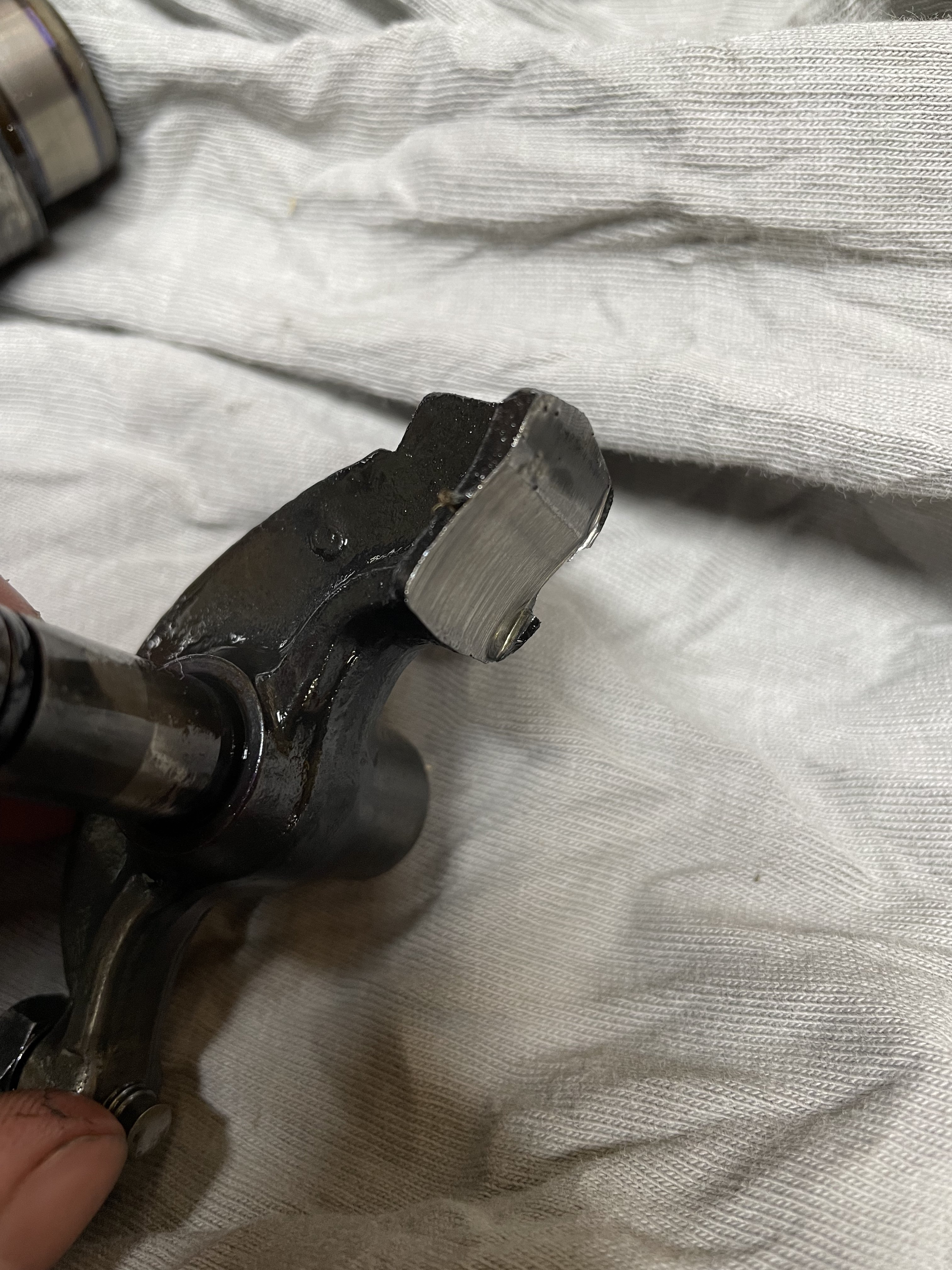

The engine with 4979 miles has a wicked knock in the head which I found to be worn a worn out camshaft and rocker pads. The engine with 20,000 miles is smooth as silk with good rocker pads and camshaft . Attached are photos of each engines rockers, one with significant wear and one in good condition.
My problem is, I want to carry my project forward with the lower mile engine and just replace the cam and rockers but have concerns about the rest of the engine due to a clear lack of lubrication in the top end. Now there was a TSB for these engines for lack of lubrication in the top end which neither of these engines received but I feel 5000 miles to wear out components that bad is crazy.

Hi MotoMike and welcome.
That rocker is well worn to be sure and that means the cam and rockers have to be replaced at least. And possibly the head if the cam has picked up on the bearing surfaces.
There are two ways you could go. One is to try to work out what went wrong on the low mile motor and then fix it. It might just need a new head, cam rockers etc but it's also possible that the crank has damage depending on the mode of failure.
Or you can just use the slightly higher mile motor which seems to be perfect. 20,000 miles is not an issue on a modern bike motor and as you have already discovered, low miles are no guarantee of a good motor.
I would use the low mile motor and strip the other in your spare time over winter.
5k is absolutely crazy to have that much wear, unless someone rode with the theory that the tighter the better on rocker timing. I would run the 20k engine while it's good and dig deeper on the 5k. TBH, I don't believe the 5k motor is actually 5k miles.

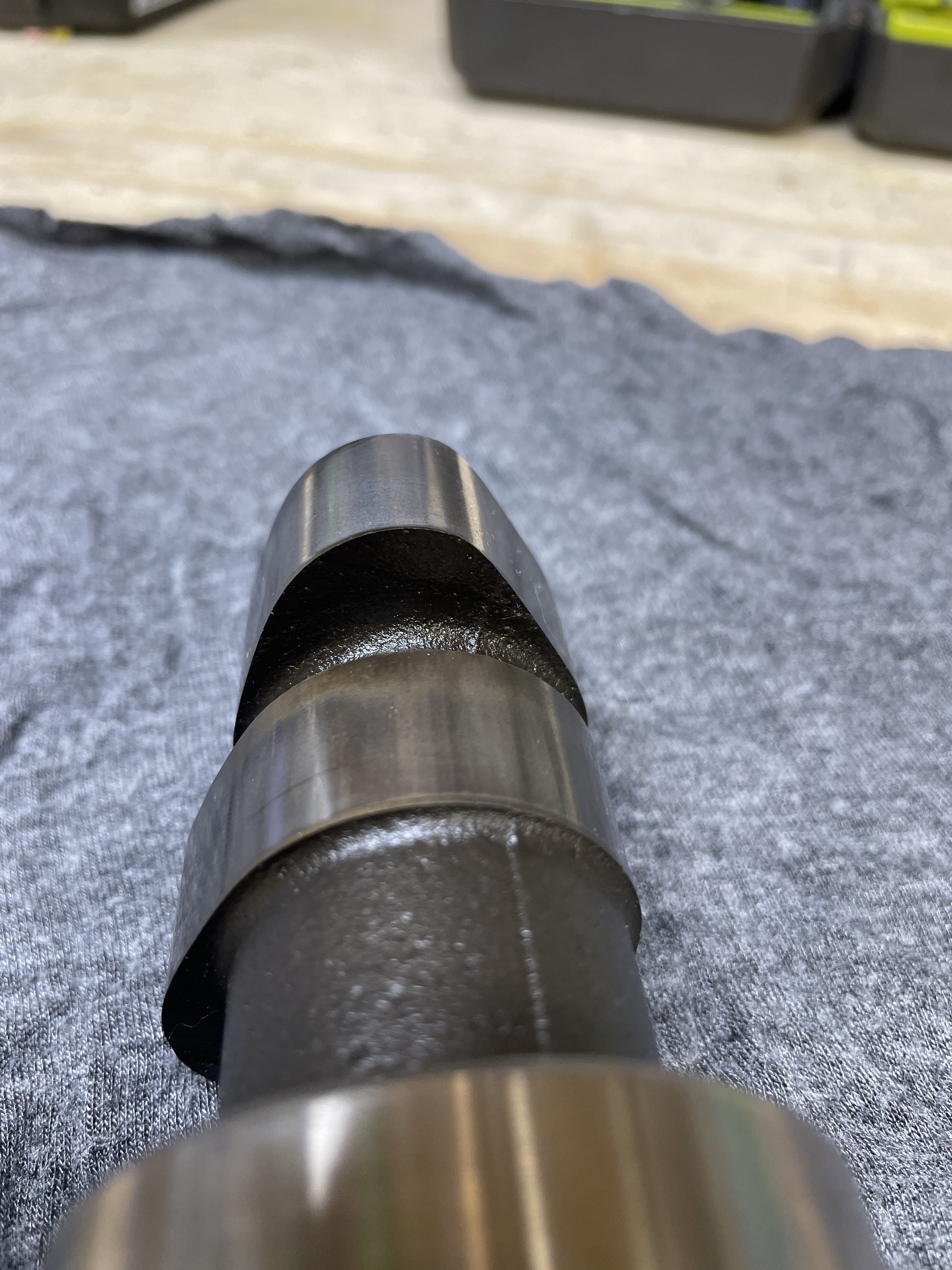

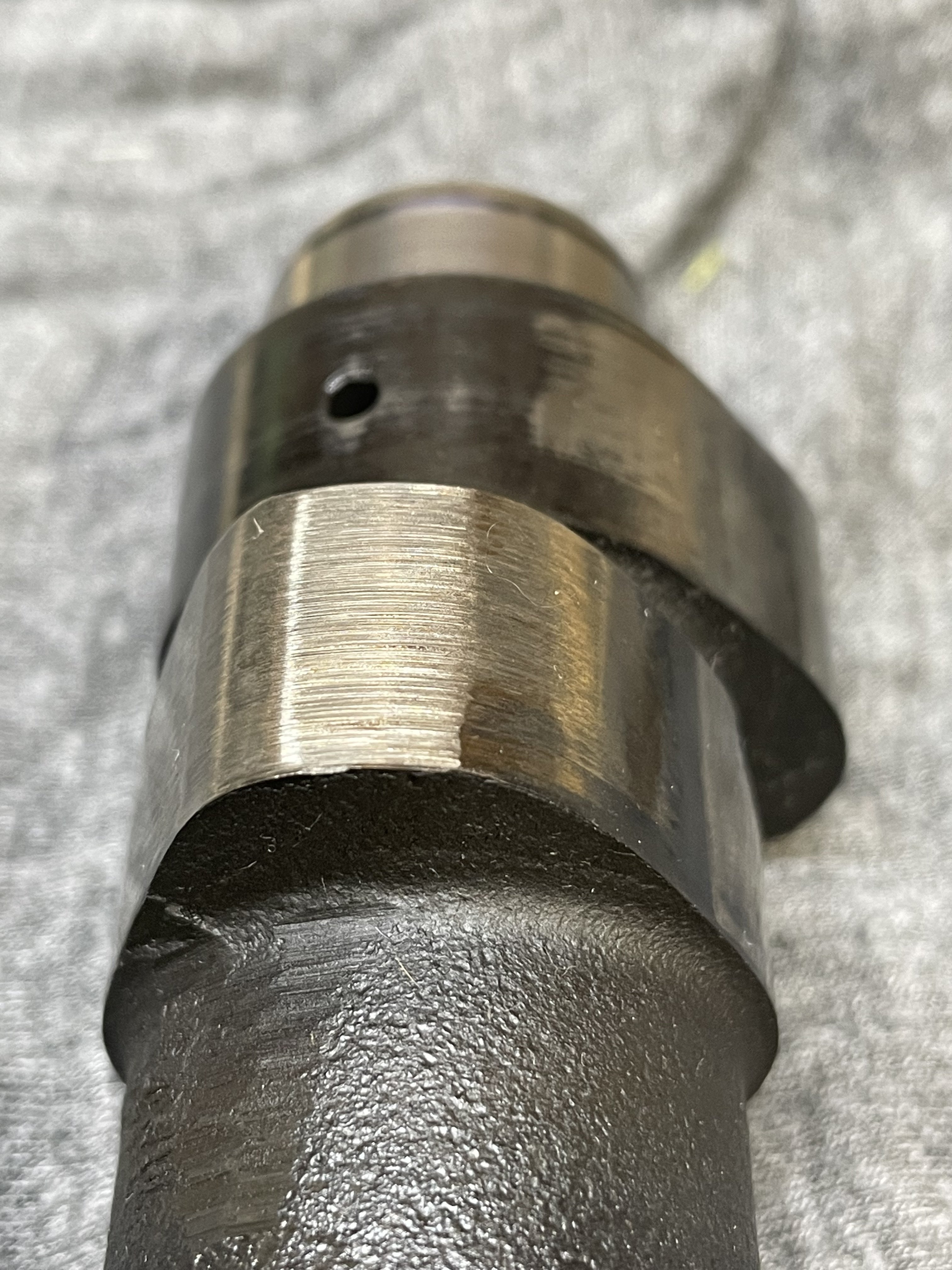

Looks like the fix was to restrict oil to the crank in order to allow more oil to flow to the top end. on the wrecked motor, what do the cam bearings and the surfaces in the head look like? Honda used to have a similar problem with some of their singles and many early 4 cylinder bikes and typically the cam bearings in the head were damaged and had to be machined out and bushed if the damage wasn't too bad.
I would recommend that you check those surfaces and also make sure there is no restriction in the head and fit a restrictor in the crank and flush the oil out and you might be OK.
Or take the top end off the higher mile motor and clean it up and fit it if it's OK.
The first three photos are the camshaft of the motor with worn out rockers and camshaft. The last two are the cams of the smooth running engine.
