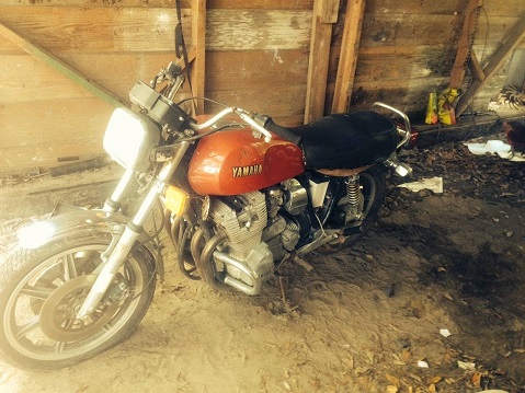

This will be my 3rd bike owned, but the first that I plan on modifying in any way. It's nothing impressive but I wanted to keep a build log somewhere, so I figured this is good.
I got this bike in a trade, I traded my broken ATV for this guy's broken, no-title motorcycle. I got it titled via the Vermont method. The bike is real roughed up, it would take a small fortune to restore it, so I figured a fun project would be nice.
The pic is from the ad, it doesn't look any different yet. So far I've cleaned out the gas tank, cleaned the carbs, got a new ignition (it didn't come with keys), and ripped the boots out of the airbox out of frustration. They're pretty much rubber velocity stacks, which are currently covered in pieces of panty hose and clamped to the carbs. The air box was extremely difficult to get onto the carbs. Just to get one boot on (after I took them all out) I laid the carbs down, sprayed silicone lube in the boot, removed the clamp, and had to use my body weight to force the boot down on the carb. Getting all 4 on at once was damn near impossible.

Plans/to-do list: new battery, new tires, tune carb, mx bars, trim seat pan/foam to brat style, recover seat, replace tail light and signals (maybe head light?) with much smaller units, ditch the gauges, wrap pipes, minimize front fender, not sure about rear fender, strip paint off tank (patch rust holes) and rattle can with clear coat.

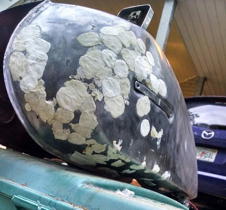

I also stripped all the paint off the tank with a wire wheel. I'm not going to try to make it look nice, it's got way too many dents for me to bother repairing it enough to make paint look good. I want to polish up the knee dent areas to make to add a bit of visual appeal, then I figured I'd clear coat it and call it good enough. It looks pretty cool all metal, but I also found a whole bunch of rust holes.
Eventually I'll repair it properly (have a shop do it, or learn to braze), but in the spirit of "just get the damn thing moving under its own power", I'm filling the holes with JB Weld WaterWeld. It's pretty much the same thing as QuikSteel, it's a 2-part putty you knead together to activate. The package specifically mentions using it on gas tanks, and that it's resistant to oil, gas, and diesel. So it should hold up for at least a while. Or until new rust holes form from the inside out.

I think I'm ready to admit I need a new tank. But I'll have to use this until it fails, or until the budget allows me to properly repair or replace this. I might line the inside, then wire-wheel off all the putty, then learn to braze over the holes. The brass would look cool. I dunno.
I've read that the only tank that will swap over (without modification) is from an xs11 special, which I don't like at all.

Damn, are all those rust holes??
Would be more worried about getting whats inside the tank into the carbs then..
Yup, most were very tiny pinholes. I've got a couple clear filters on the fuel lines. I did the electrolysis rust removal and rinsed the tank many times. I know there's still rust in there, but it's not loose for now. I don't know if it's worth lining the inside with redkote or por15.

Thanks, I hadn't heard of that. Sounds like just what I need. I might be able to keep this tank (and get rid of the putty) after all.
Wouldn't it be cheaper to just buy a good tank off eBay or a forum member than spending on all of these "fixes"?
Epoxy putty: $5
Tank sealer: $36
Rattle can of clear: $10 (I think? I don't remember, I already have it)
Tank: $140 (the last one I spotted on ebay)
edit: I searched some more, in the past they've sold anywhere between $130 and $235, depending on condition
I'm not trying to make it look good, I'm just trying to make it functional.
