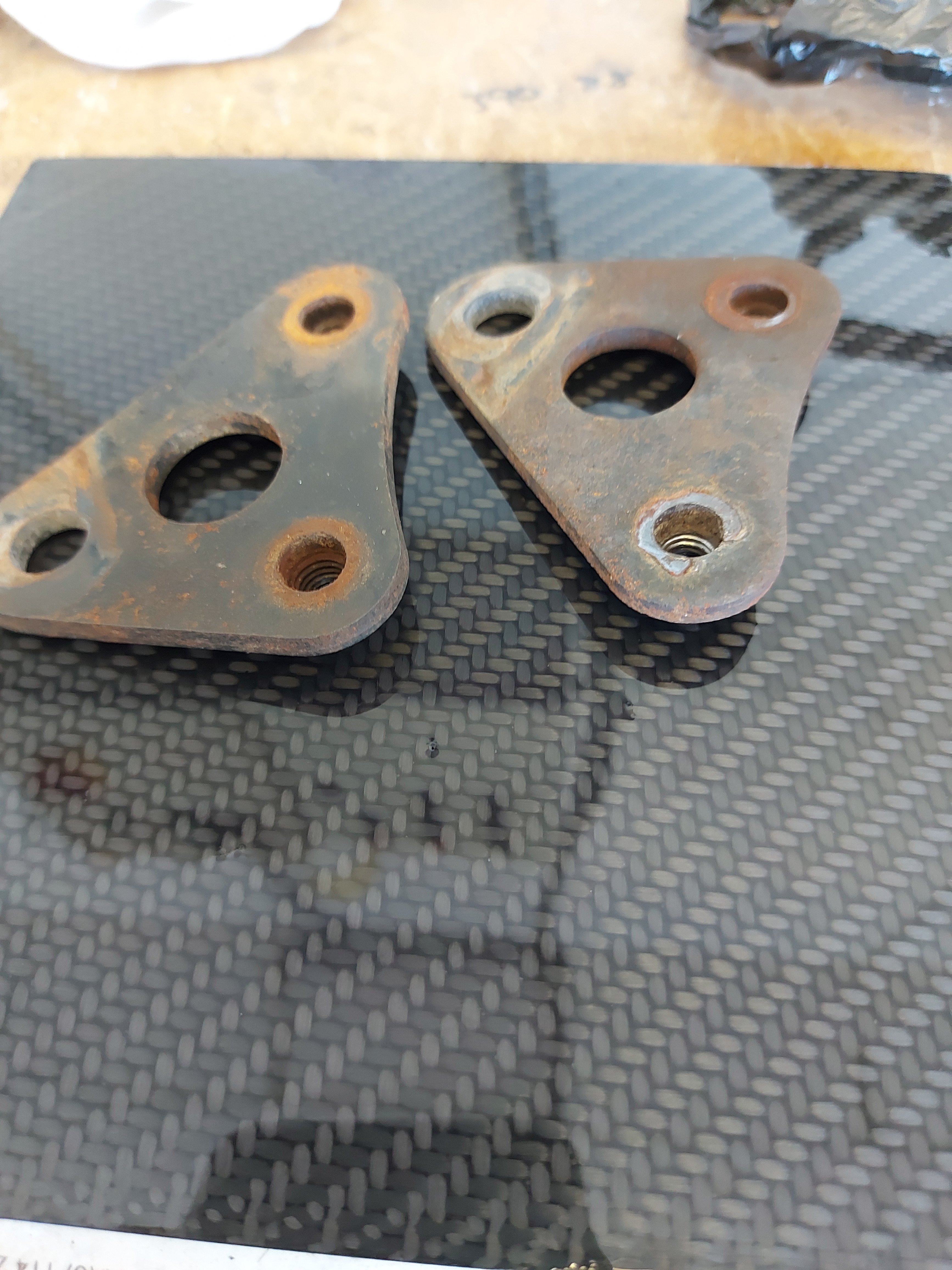

De-lugged the frame as above pics, I'll be keeping the battery where it should be, the solenoid will be mounted elsewhere etc
The seat unit is a generic tracker / cafe thing it'll have a brown leather seat.
Colour scheme will be black and gold, with black stainless fixings where there's polished surfaces, and stainless fixings where there is a black finish, brass washers on everything.

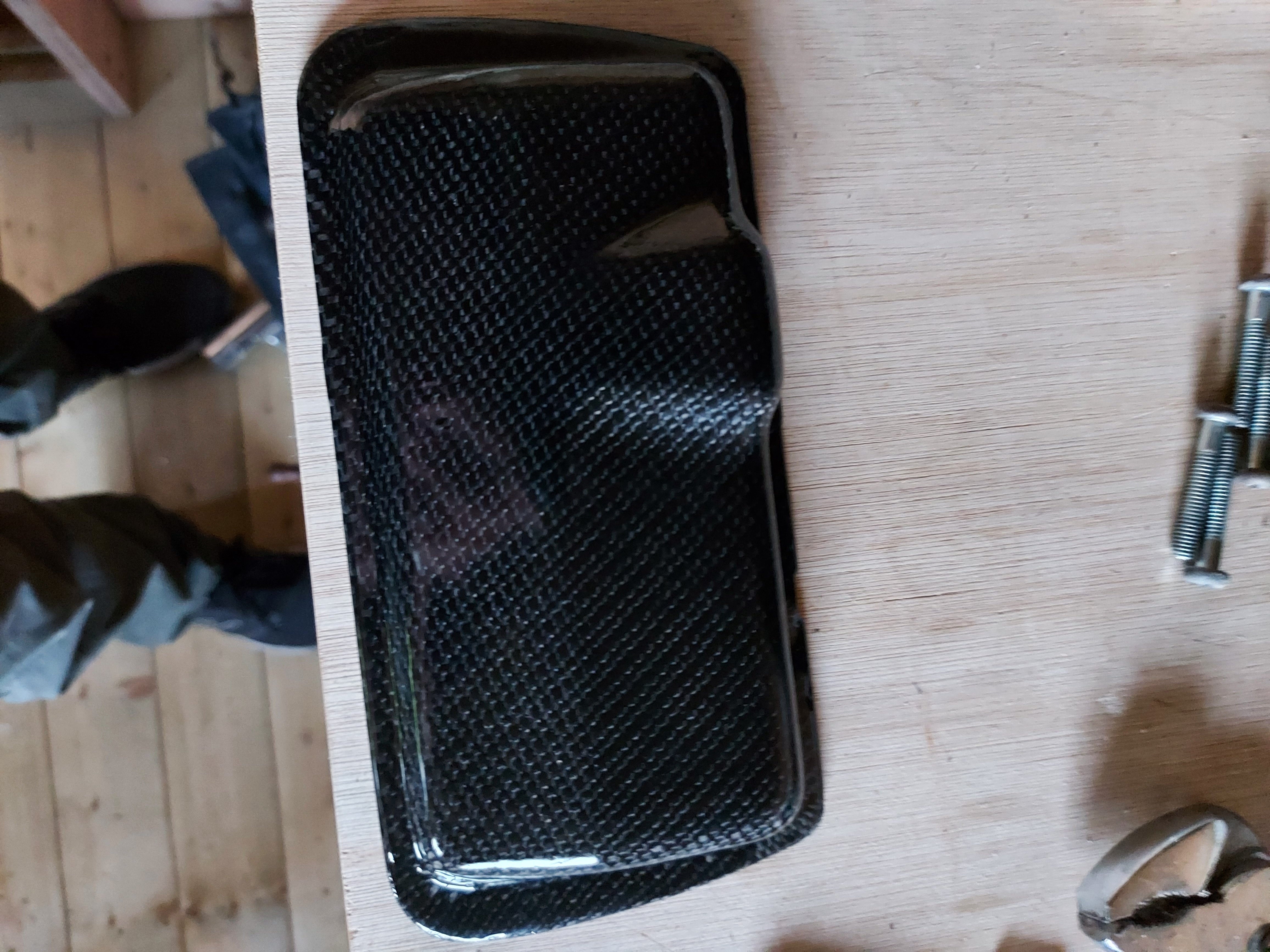

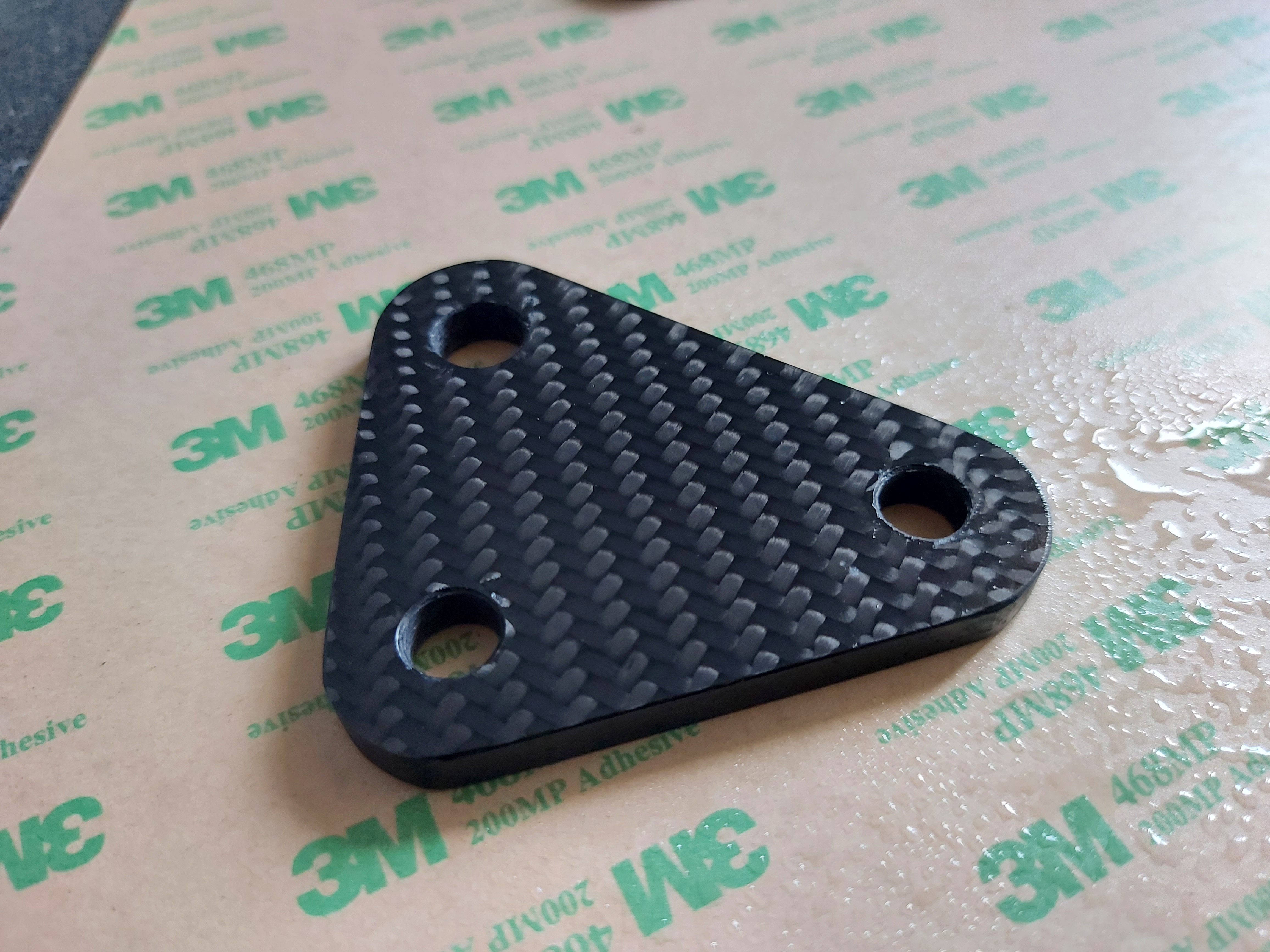

The carbon mounts have been finished today, just a little laquer and polish after final baking.
I used about half a metre of pre-preg to layer them up, 18 layers thick and cooked between 2 slabs of aluminium.
It probably looks a bit backward stripping a bike that hasn't run for so long and starting to modify it without hearing it, but it has good compression, a spark and just needs fuel, it'll run when it needs to.
The carbs have been in the ultrasonic cleaner and came out fine, just need new diaphragm rubbers as the old ones are a little stiff.
Made the starter cover in carbon too, needs a good sand and polish.

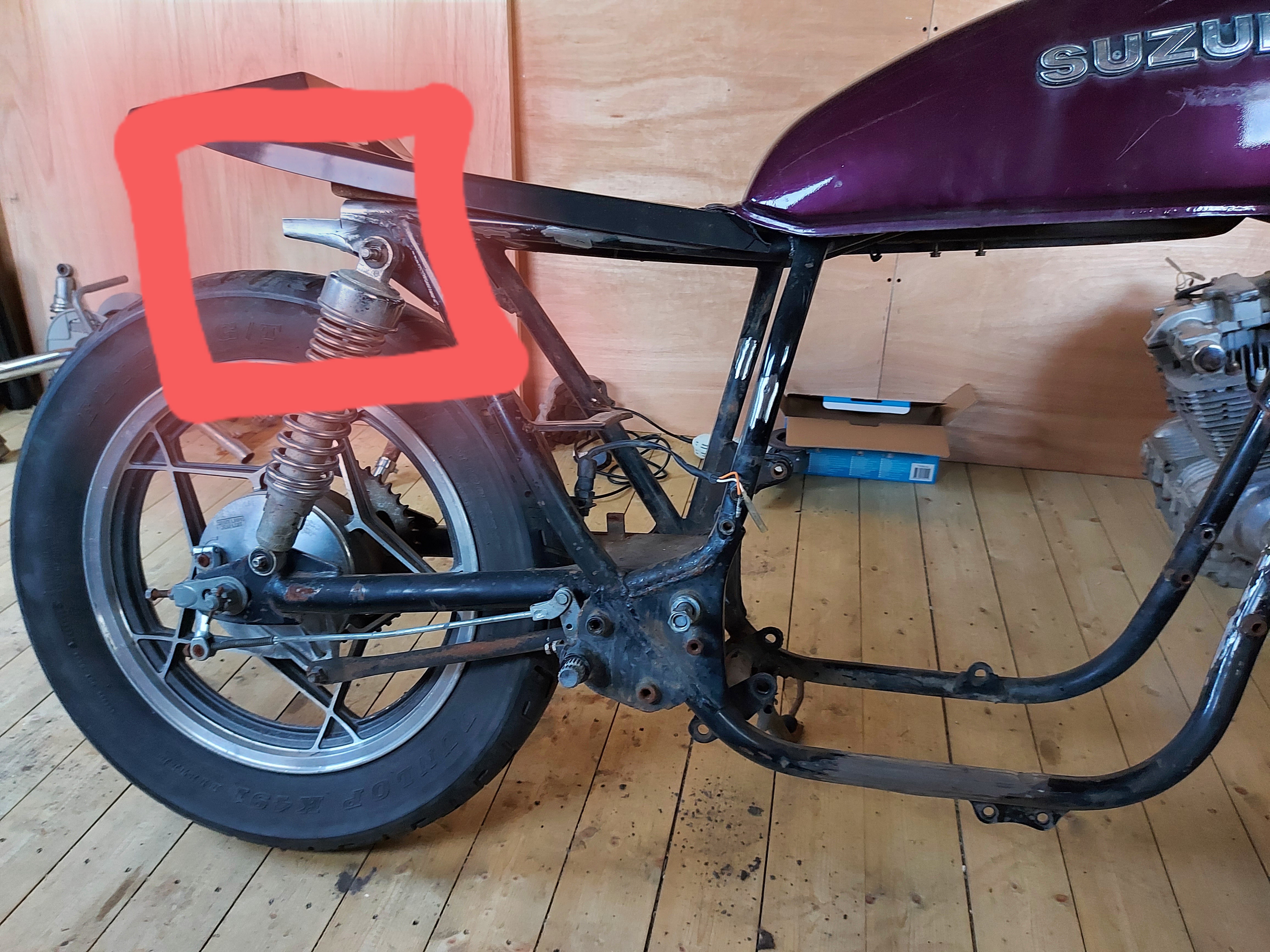

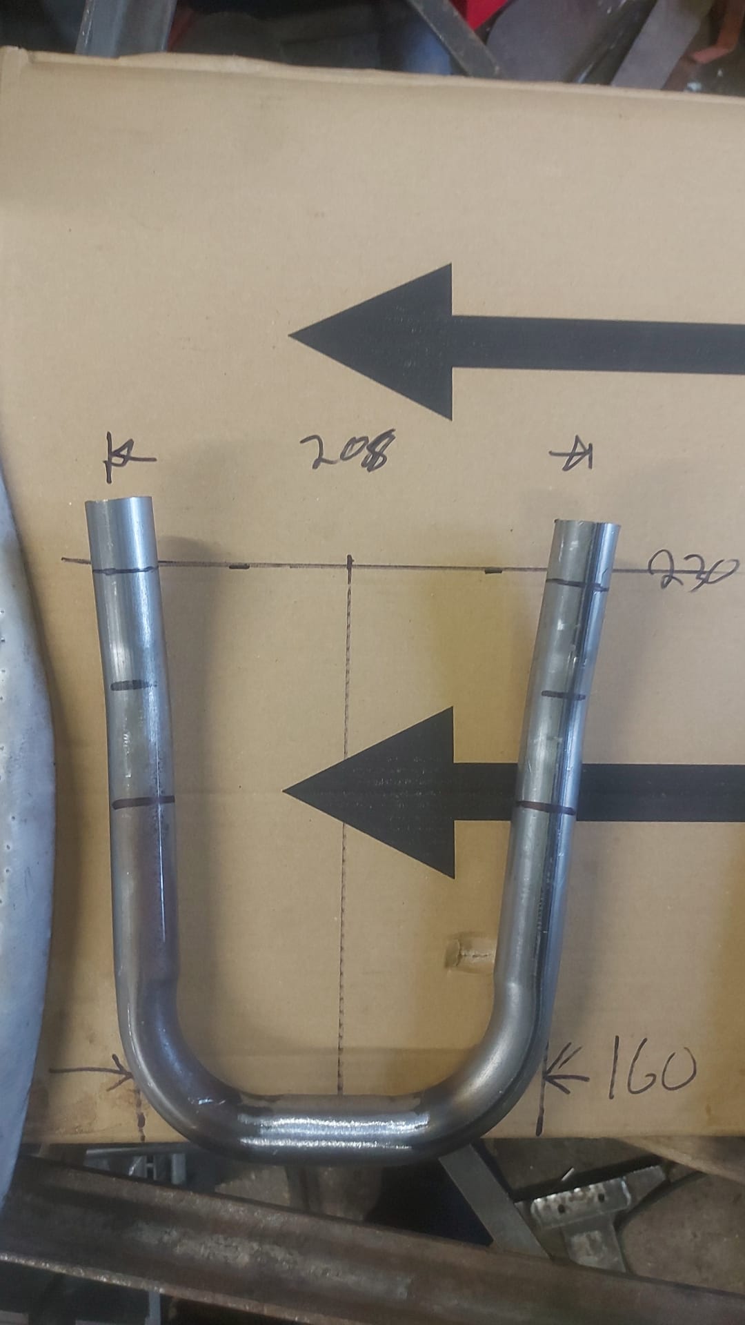

Next job is to weld in the rear frame / seat tube, it's an odd shape as it needs to be fairly square at the back and tapers narrower at the back.
So, I may have to adjust the gusset angle just behind the shock mounts.

This bit that I've channelled for the new hoop to sit in.

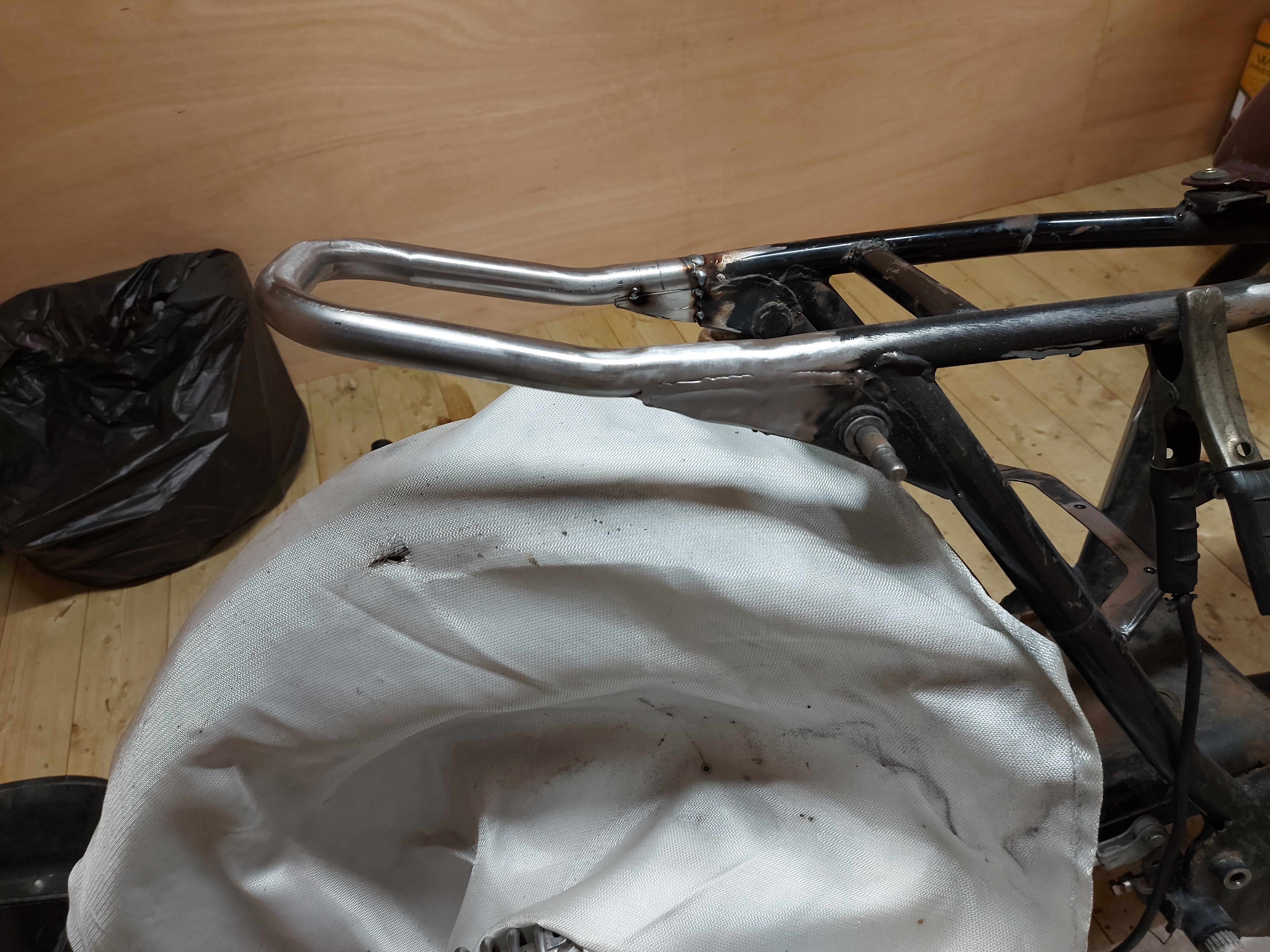

Couple of pics as an update, I finally have power to my workshop so grindy and weldy things can happen!
Managed to clean up the frame rails and offer up the seat hoop, I cut the gusset part of the frame off square, then sliced pieces from the offcut to reshape it before welding it back on.
I had to do this because my hoop is tapered narrower towards the rear and the gusset parts were straight.
So, checked things were straight and lined up with the new seat unit, I think it works well?
Yes, start welding tonight hopefully, try to run the factory weld line on the top part for continuity but rest will be smoothed.
