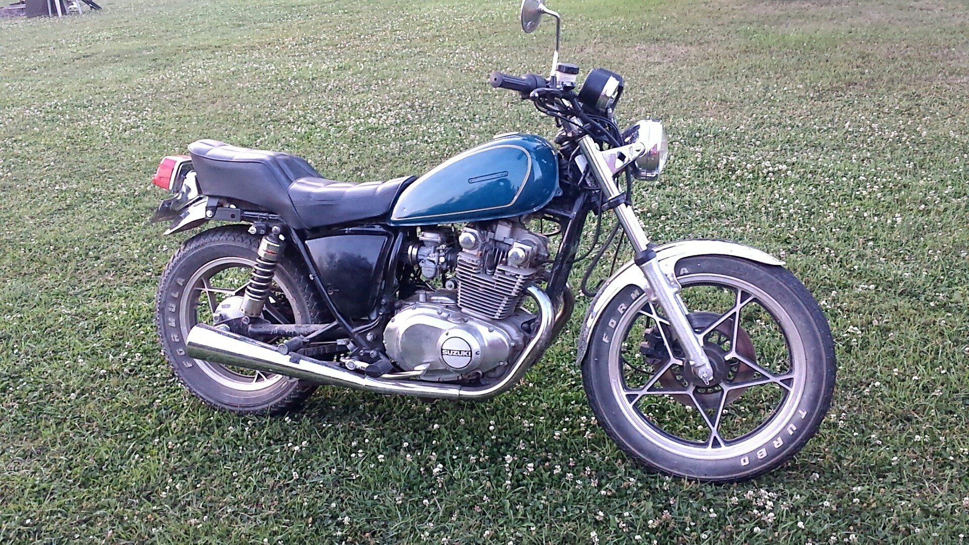

Here are a few pictures of it as received:

Being that it was handed over to me in the dead of a MN winter I had a lot of time to decide that its current state wouldn't do. I've never worked on a bike before, so I wasn't quite ready to dig into engine stuff just yet. I just knew that I wanted to build something I would feel comfortable on, whether it be on city streets or on the gravel roads to my brother's place, and a scrambler or tracker seemed to fit the bill. There are a lot of inspiring projects on this site.
So, I felt that the 16" rear and 19" front wheels were going to have to go. I was able to find an 18" front and a 17" rear wheel so I started there. I did a lot of looking for tires that I thought would do well on gravel without being to loose on pavement, so decided to get some IRC GP-110 Dual Sports. The rear is a 4.60-17 and the front is a 4.10-18. I got the wheels cleaned up and was even able to mount the tires myself, which was a new (and difficult) experience.

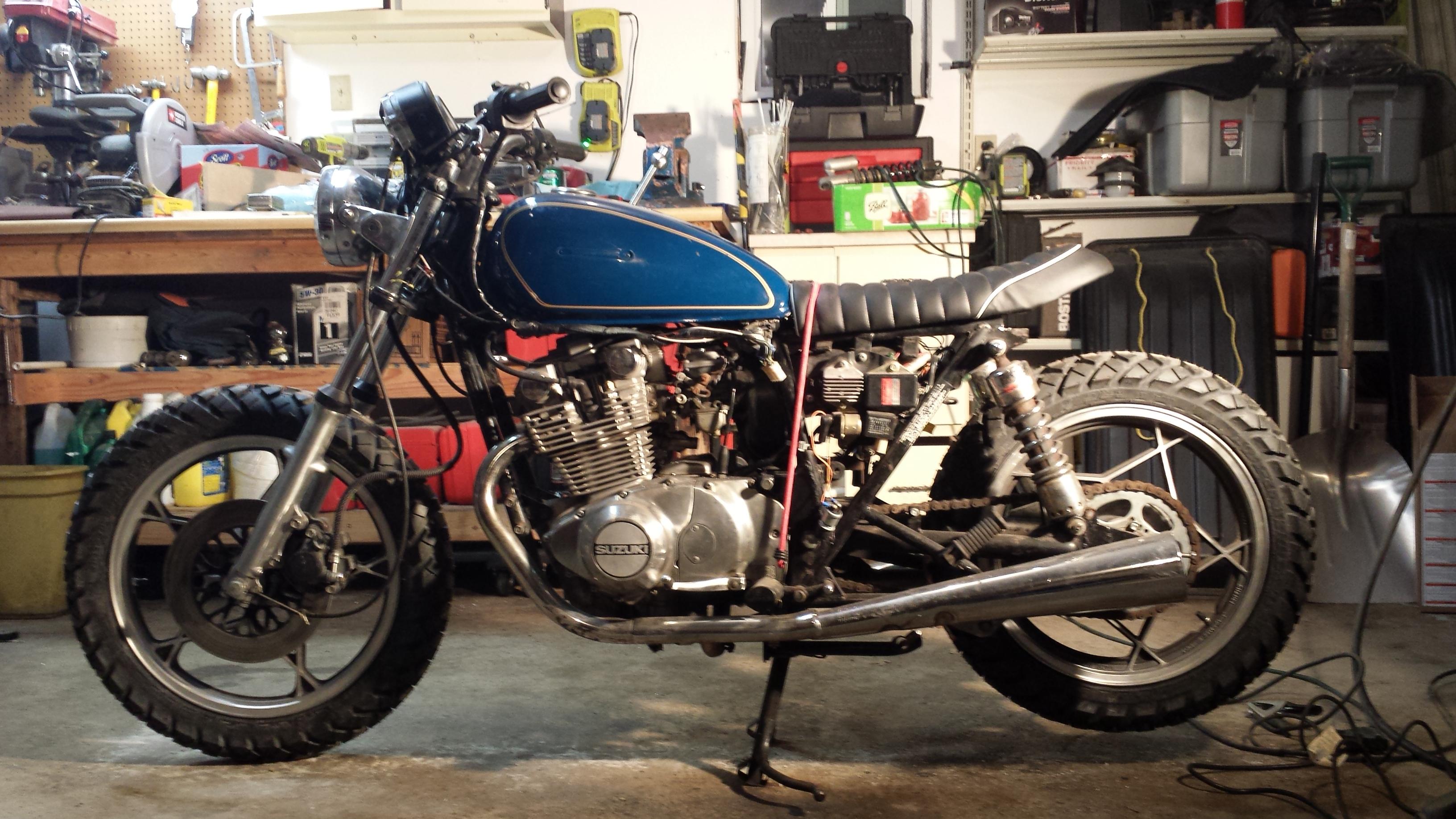

Here is a good side shot of the bike once I was able to get it to where I could start working on it. I try to use this same shot position for most future pictures so that I could make sure it was heading in the right direction. You can tell it was cold out because if you look closely at the engine you can see it is covered in frost. It was -18°F that first work day. A lot of hot coffee was consumed :)
I also included a picture of the rear frame section where it was cut and welded (I'm no expert at welding but it looked rough.) The PO had welded the rear fender in place to the angle iron and the plastic fender was just sitting in there, held down by the seat. I couldn't quite tell how it was all supposed to go together originally. They had put some Progressive shocks on it, but the bushings were gone. I measured their length at 12" tall. I think stock is supposed to be 13", but If someone knows for certain please correct me if I'm wrong on that.

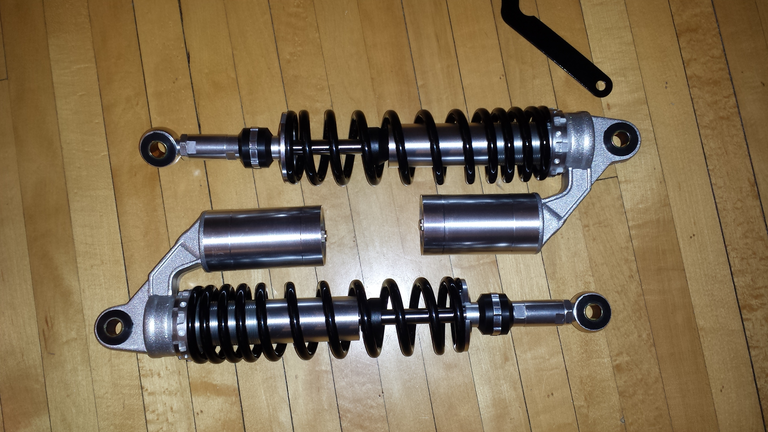

Looking at the side view of the bike I could tell that the back end definitely needed to come up some, so I set about finding some shocks. I did some researching and decided to try TEC's remote reservoir ones. They had a look that I liked, and I could afford them. Ideally, I'd buy Ohlins, but that wasn't an option on my budget. I did know that I wanted to stay away from the remote reservoir RFY versions on Ebay after reading some negative comments about them. I also appreciated this nice write-up by Chris: http://chrislivengood.net/wp/tec-alloy-reservoir-shocks-analysis/
I ended up getting the TEC's with the adjustable dampening option and at 14.6" tall to help level the bike out a bit and increase clearance a bit. They also have a ~1" spacer that one could use to raise them higer, but I think I will leave that out for now. It was in place in the picture below. I was a bit nervous about how they would look in person, but once they arrived I was pleasantly surprised. They seemed on par for the price paid so I think it was a good choice given my budget.

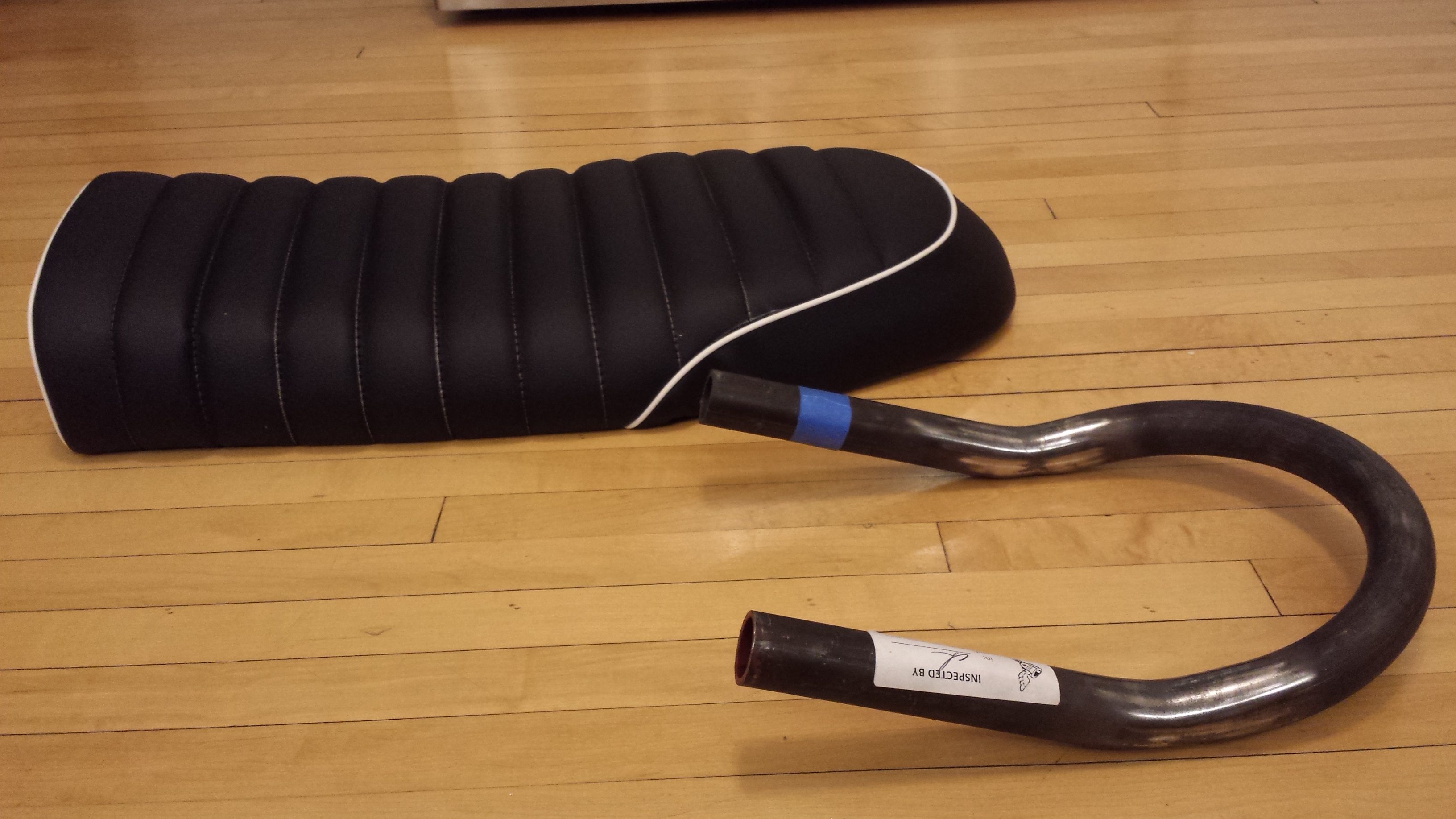

The stock seat wasn't really helping the direction I wanted to go either, so I found a seat on Ebay for a Honda CB350 that I thought I could make work without breaking the bank. If I messed it up then I wouldn't be out too much money. This project is a learning experience, after all. And my first bike so I know that I'll be making plenty of mistakes as I go.
To make the new seat work and to get rid of that questionable angle-iron at the back of the bike I got an upswept hoop section from Dime city. I like the upswept seat look, but the Ebay seat was flat. It had an ABS base to it, so I figured I could do some trimming and heat-gun work to bend it as needed.

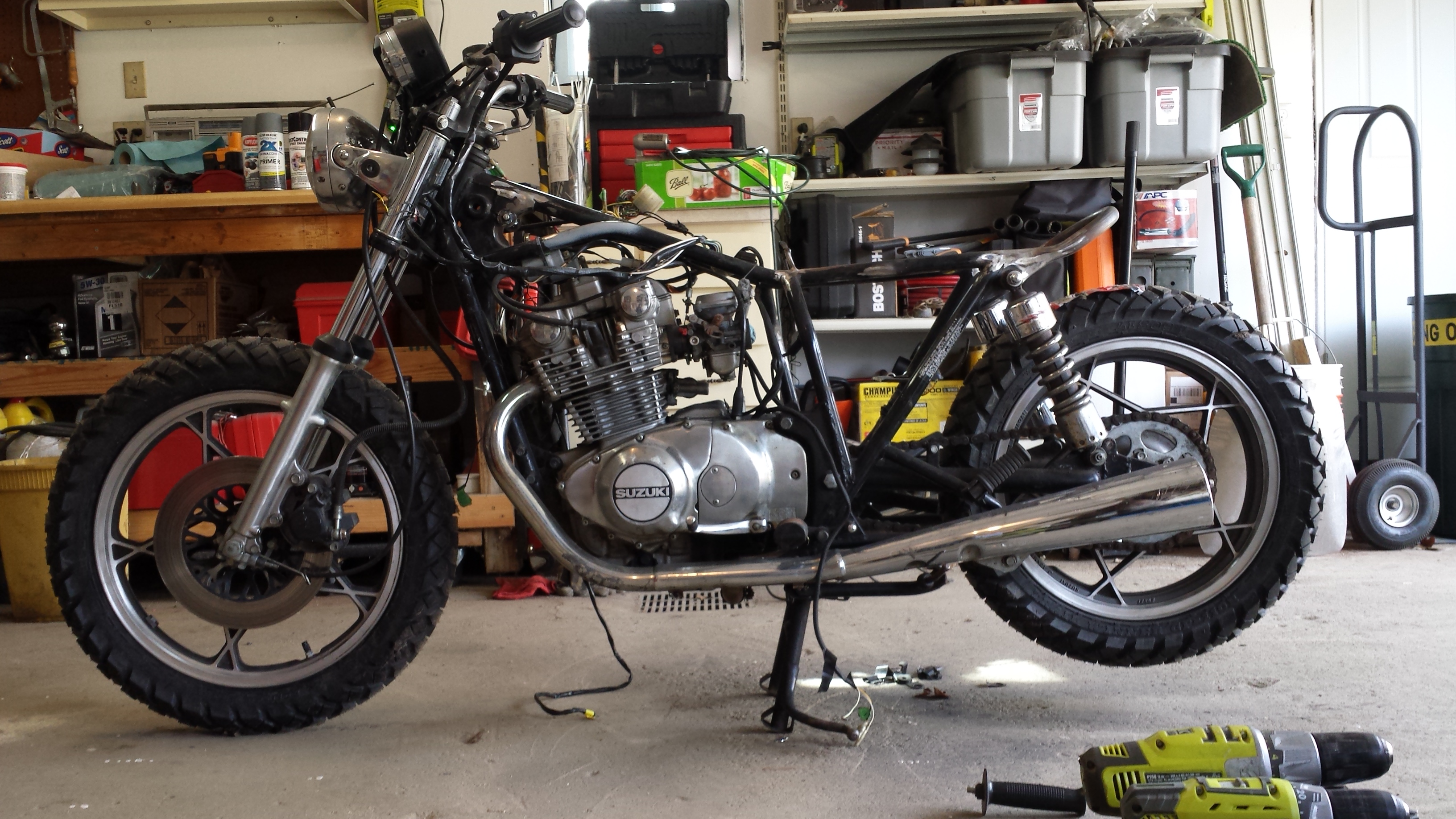

This is an exciting point for me because I was able to get the new rear shocks temporarily mounted so that I could get a look at its 'stance.' I must say I don't think it looks half bad compared to where it started. The new rear shock height seems to be right where I was hoping, and the chain doesn't rub on the swing arm so that was exciting. I'm 6'2" so it seems to fit me a little better at this height. It's also really easy to get it on the center stand now. ;D
Next steps are to weld in seat mounting points and then make a tray under the seat for all the electronics that were mounted behind the side covers.

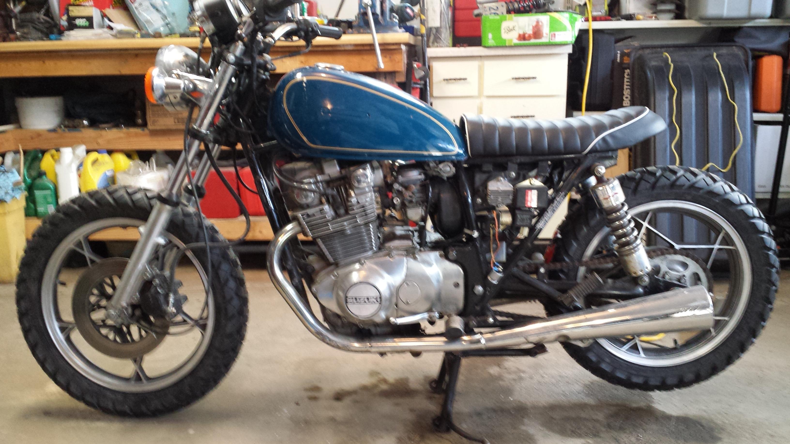

Thx NoRiders :) You posted right as I was posting an update showing the bike with the raised shocks on the center stand and you can see the back wheel is basically still touching the ground. Good call! I have since shorted the shocks a wee bit so the rear does lift off on the center now. I am thinking I might keep the center for the time being. It is sure has been handy for working on as I don't have a shop stand or anything fancy like that (yet.) I'll try to keep the updates flowing!

I'll be losing the centre stand, using the side stand only (but not cutting anything off). I picked up a new paddock stand for £19 at a local motorcycle jumble (swap meet). It lifts on the swingarm and not the spindle, should be OK for what I want. I love swap meets.
Your bike has changed radically from stock just by minor mods really....nice one.

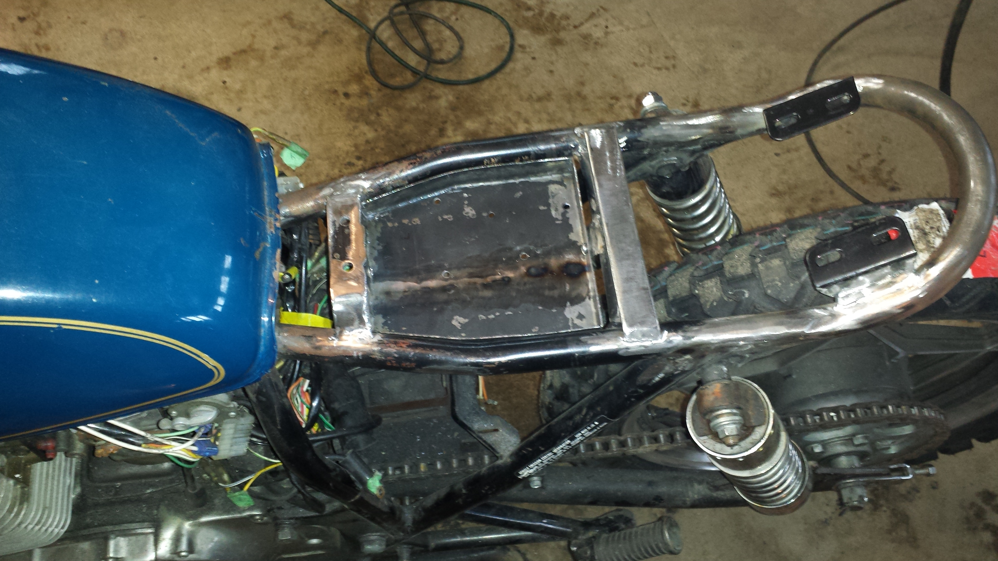

This latest update will show some of the progress made on relocating some of the electronics that were previously mounted on the side of the bike under the side covers as well as how I mounted the seat that was originally intended for a CB350.
To make the tray I found some extra sheet metal that my dad didn't need. It was only 5" wide strips, so I had to stitch them together with the wire-feed welder my dad has. Being my first motorcycle and also first build I am trying to save pennies wherever I can so my mistakes aren't too costly. I was able to get it stitched together and bent into shape without too much effort. I'm surprised it turned out as well as it did for a first go. It looks a bit rough, but I will be media blasting it clean along with the frame and other parts later on.
I've also included a shot showing the tray installed along with the new seat mounts. The front mount and mid support are made out of some bar stock. I had to heat the front mount with a torch a few times to get it bent to the right shape, but had a lot of fun doing that. It's hard work! The rear mounts came with the seat, so I cut them down a hair and welded them to the rear hoop. All in all the seat is now very secure and even uses the stock seat rubber pads on the mid support.
The bottom pic shows the seat finally in place and the electronics tray seems to be barely visible beneath it. I don't plan on hiding the battery under the seat, so was able to make the tray fairly slim. You can also see the new header in place. I decided to go with a simple MAC 2-1 in flat black to cut down on the visual mass. I am liking the way it looks, though I wouldn't mind trying my hand at making a true scrambler high-mounted exhaust some day. But alas, I have to draw the line somewhere as I'd love to finish the bike this riding season!

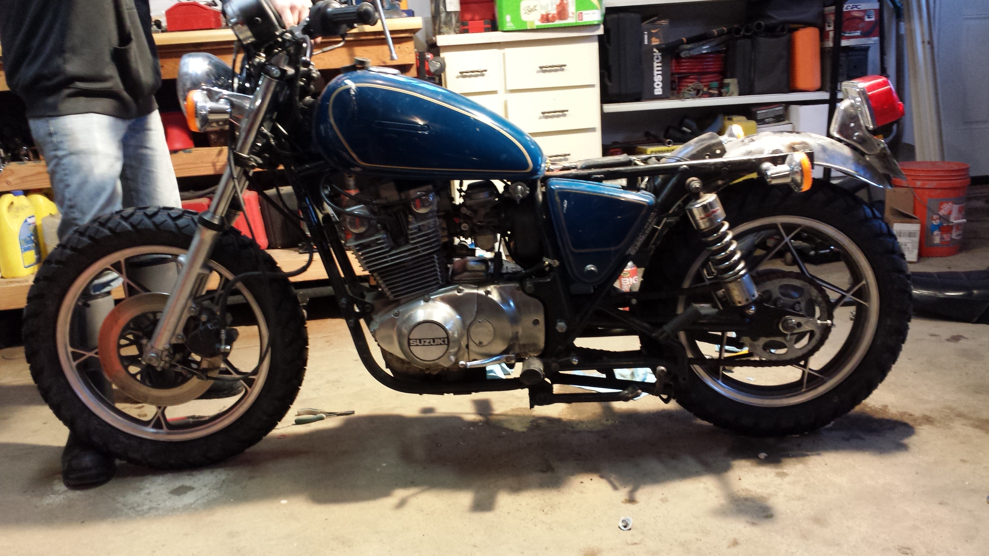

Oh, and I also decided that this would be a solo bike and chopped off the passenger foot pegs and associated tubing. Should help shave a little weight and keep things simpler.
Next area of focus will be fenders. I definitely want to keep this bike functional, so will be re-using the stock fenders and getting a little creative. Thanks for stopping by the build!
