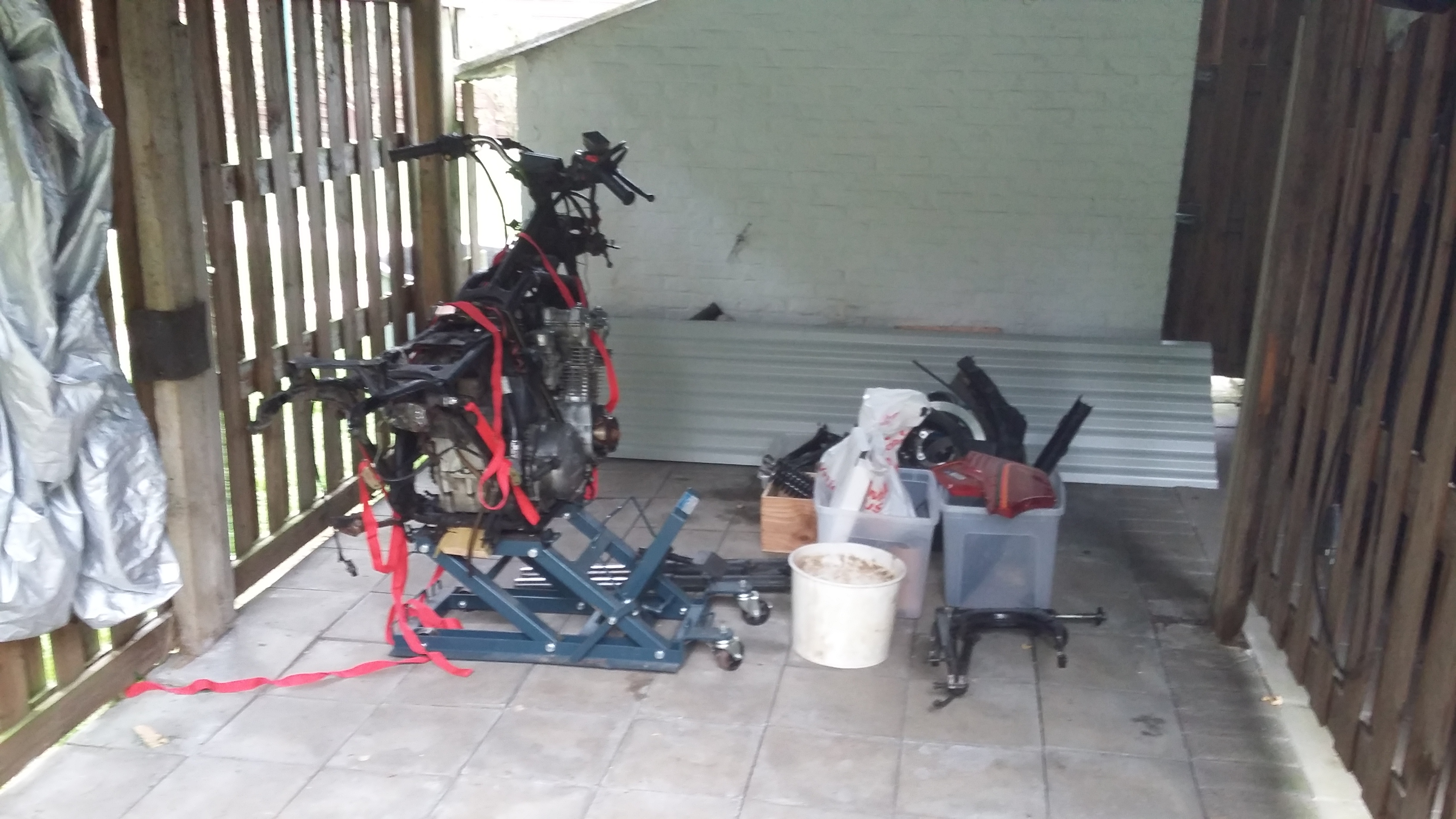

Storytime starts with a message I got of someone who knew a guy who needed to clean out his garage (his better half told him to) and had a stripped CB750 laying around. If I wouldn't get it it would be brought to the junkyard. Can't turn down a free motorbike so I went over, loaded it all up and drove it to my granddad where I had a empty storage from my oldtimer I just sold.
The engine at this point was only held in with the 330mm long front bolt which was mangled and is where the project ended for the previous owner.

As soon as the house was finished and we moved in and were settled I remembered i had this thing laying around and decided to give it a go. Got the mangled bolt out, stripped the bike further down. Took the carbs out and gave them a clean, cut out any accessories made on the wiring loom and started piecing the bike back together. I had no idea of what parts might be missing and if the bike even ran so easiest way to find out...

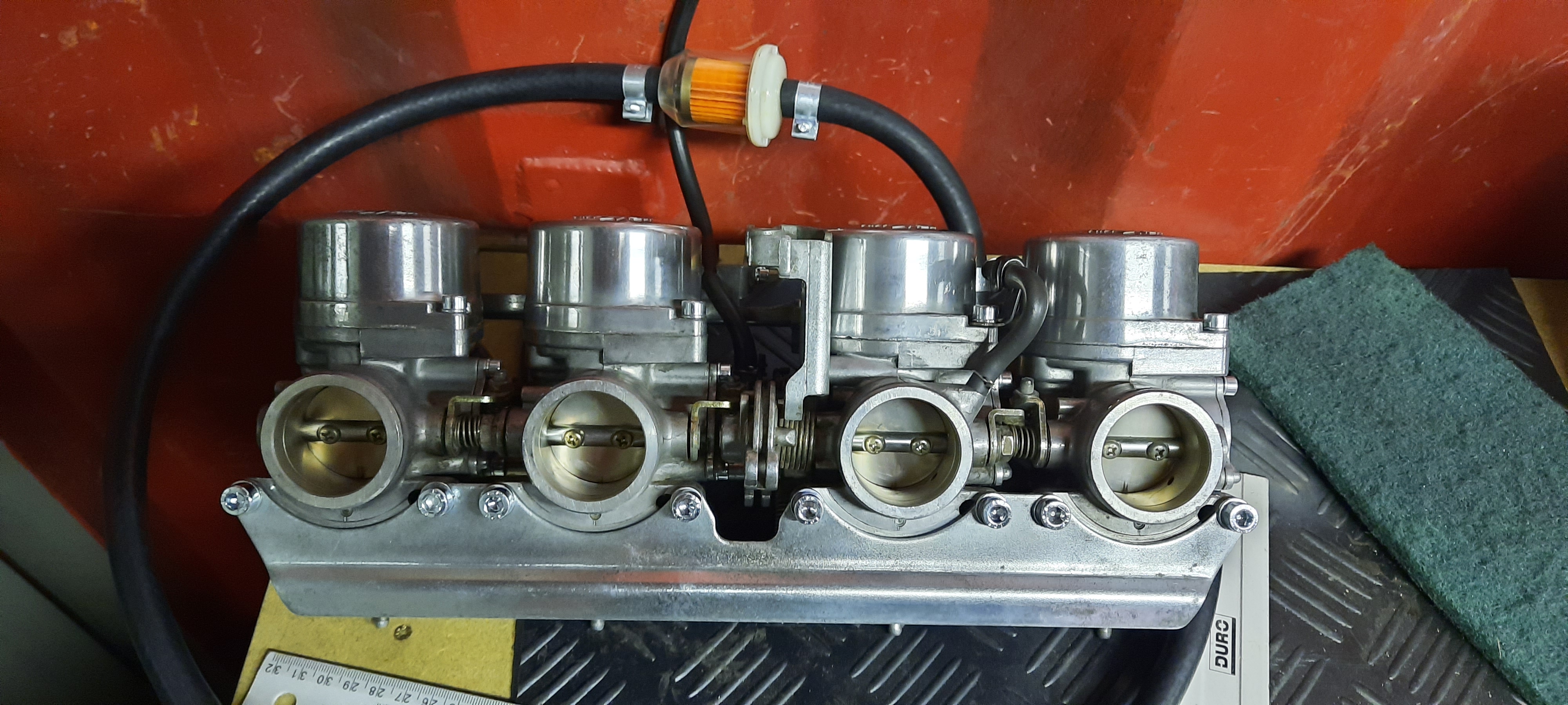

Quick clean on the carbs, float bowls and jets.
Got the bike assembled to the point where it would start up, running on 3 of the 4 cilinders, carbs were overflowing

Pulled the carbs and went for a thoroughly clean on them.
Air cutoff valves were all good as well as polished the slides
All reassembled with new allen hardware, everything working smooth and benchsynched.

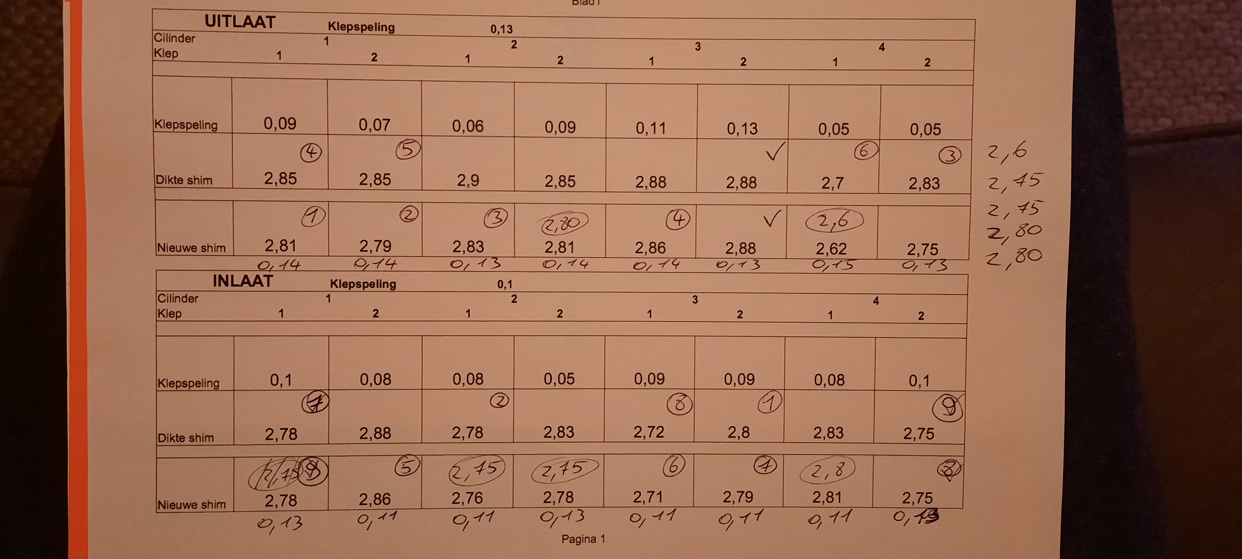

Valves were adjusted, all were a bit tight but could set them by mostly changing out the old shims. Just had to buy 6 new shims to get them on point.
went with at least 0.13mm (0.005inch) on the exhaust side and 0.10mm (0.004inch) on the intake side.
I made myself a grid: valve clearance, thickness shim, new shim thickness and worked out how i could change them out as efficient as possible.
As you can see some gaps were very tight (0.05mm or 0.002inch).
For anyone doing this themselves, you'll need the valve tool, feeler gauges, a micrometer to measure the old shims and a small screwdriver for prying as well a magnet to pick up the shim out of the shimbucket. You'll need 1 shim to be able to change out any shim as the engine may not be turned without a shim in place.

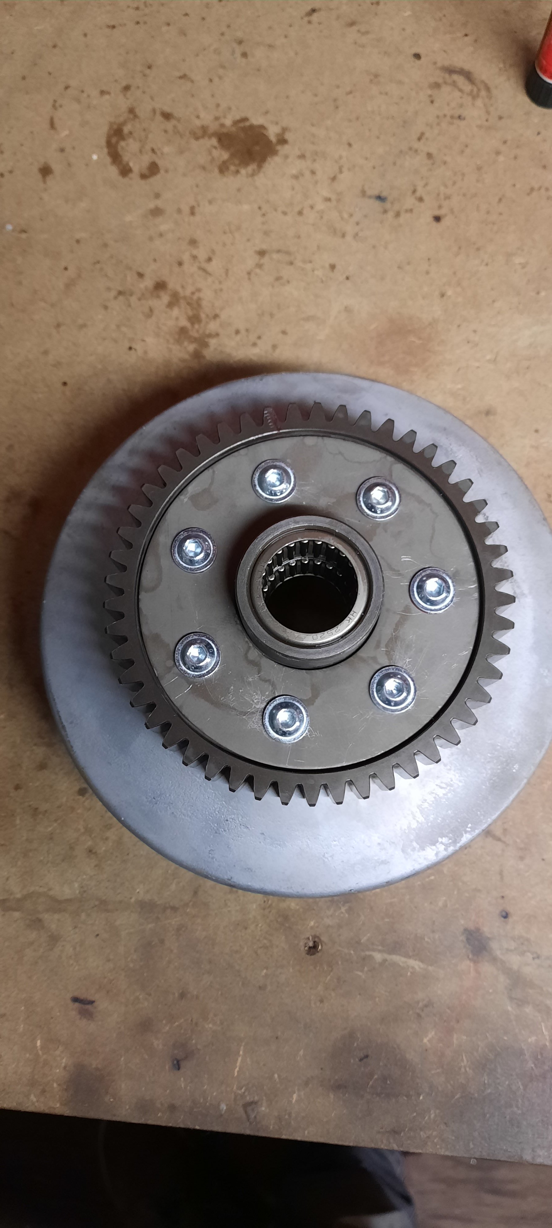

For the clutch I ordere myself a set or EBC friction plates, EBC heavy duty clutchsprings, a rebuild set to replace the old clutchdampers to get rid of the rattling clutch and a shift detent from Vince and Hyde Racing to get rid of the misshifts.
The clutch dampers I got were from Wout van Veldhuizen, you can find him on cb1100F.net, decent bit of kit.

Clutch plates marinated in oil before installation

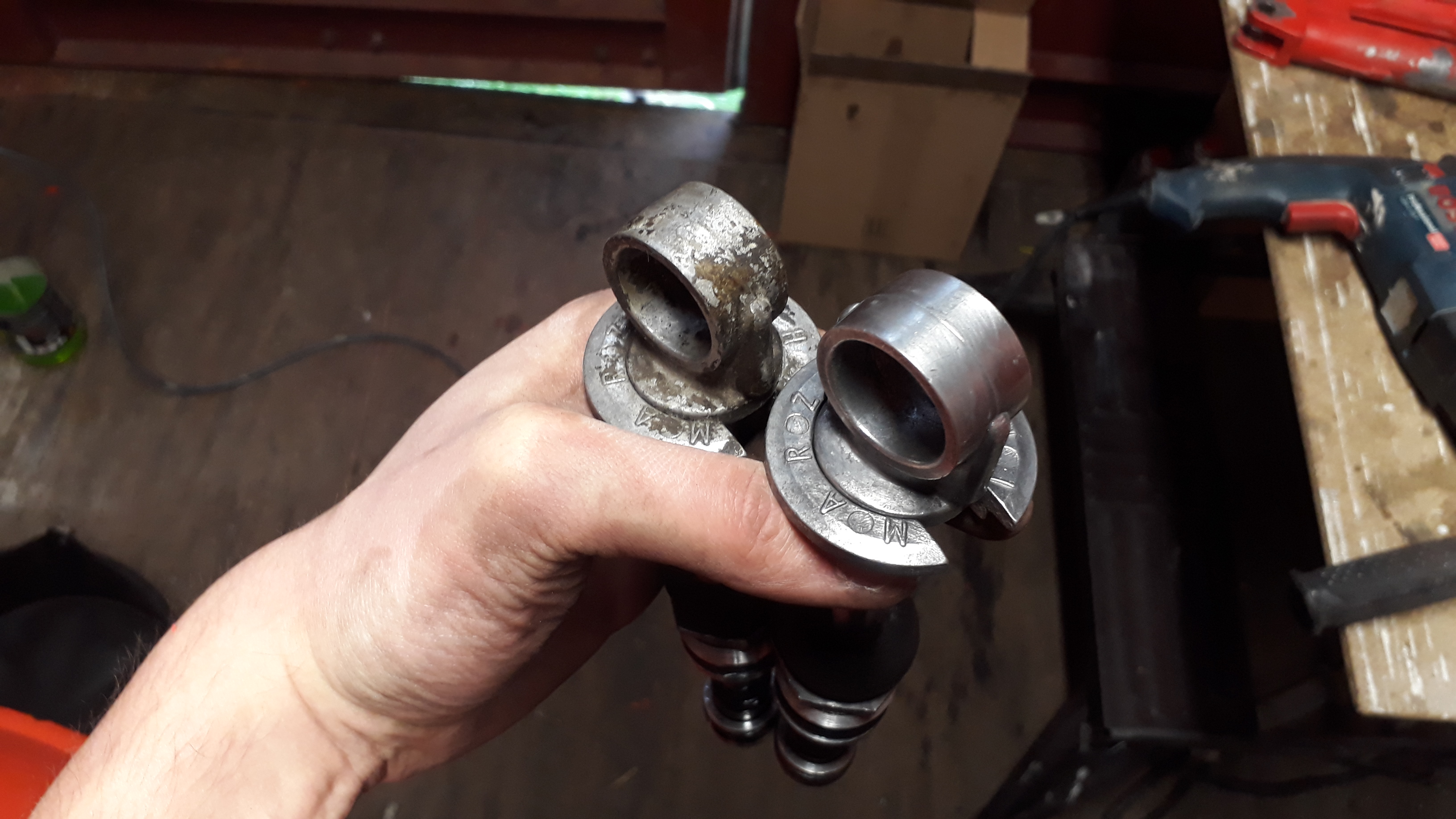

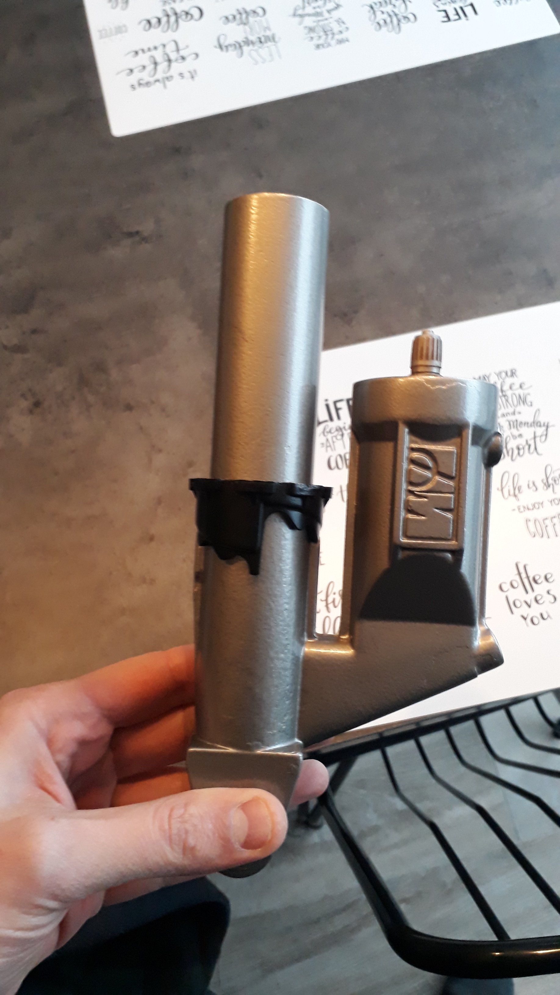

Since the front forks were leaking I took out the forklegs, stripped them down and put them back together with new seals and dustcaps. Also treated the legs on a new coat of paint. First thing to receive some paint on this bike.

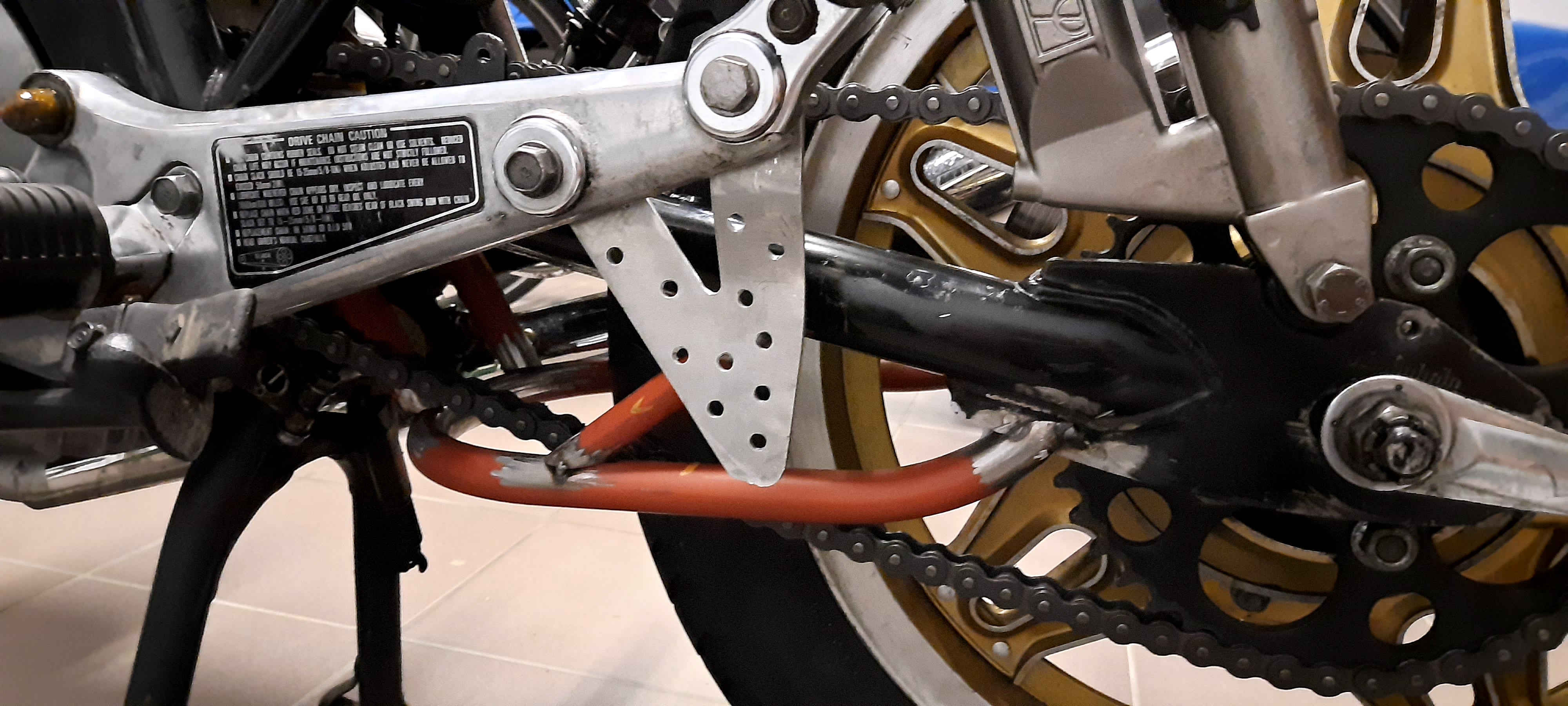

Since the new shocks were in (YSS Bravo twinshocks) I decided I wanted to do something to the wobbly swingarm...
Found a old hydraulic pipebender at work and took some leftover heating pipe laying around with me for the weekend. I'll let the pictures do the talking

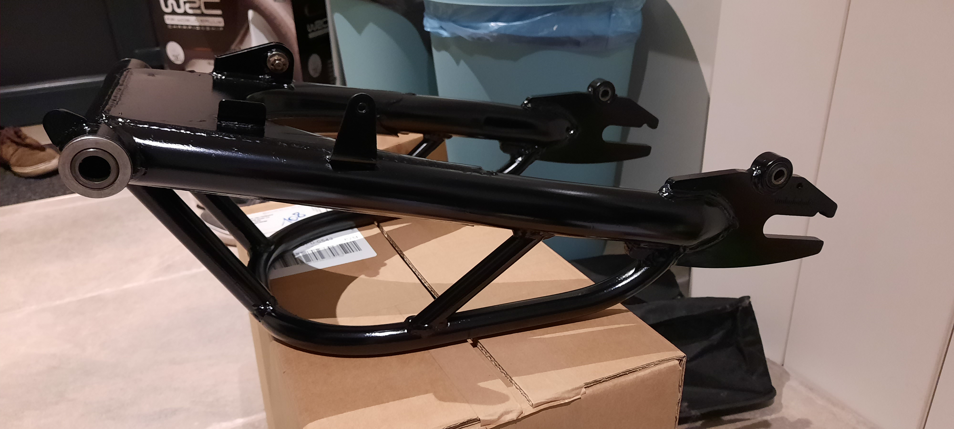

Since everything cleared time to weld her up, give it a coat of paint and voila
Swingarm looks awesome. How come it was wobbly in the first place though?
As far as I know lots of people switch them out for CB1100F swing arms but they are hard to come by. Something about the tubular design which flexes quite a bit...
Hope this will solve it kind of and otherwise it at least looks good.
Only thing is I have to ditch the centre stand, but it's easily enough put back on to do maintenance on the bike and still have my paddockstands laying around too.
