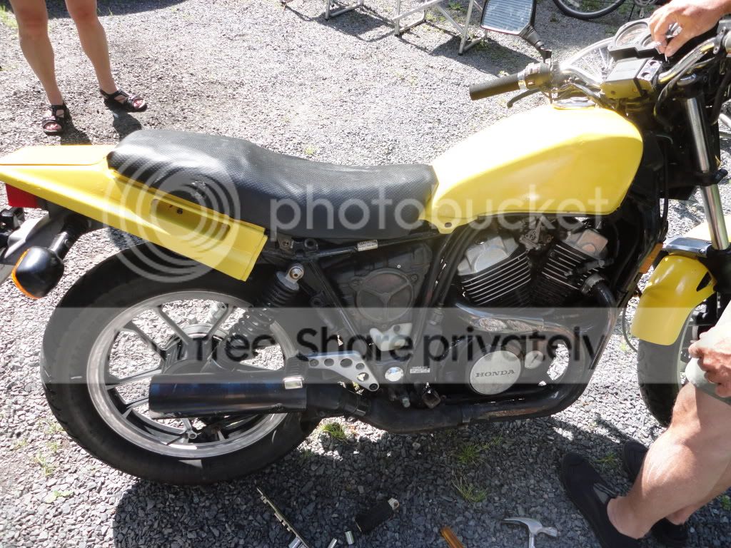

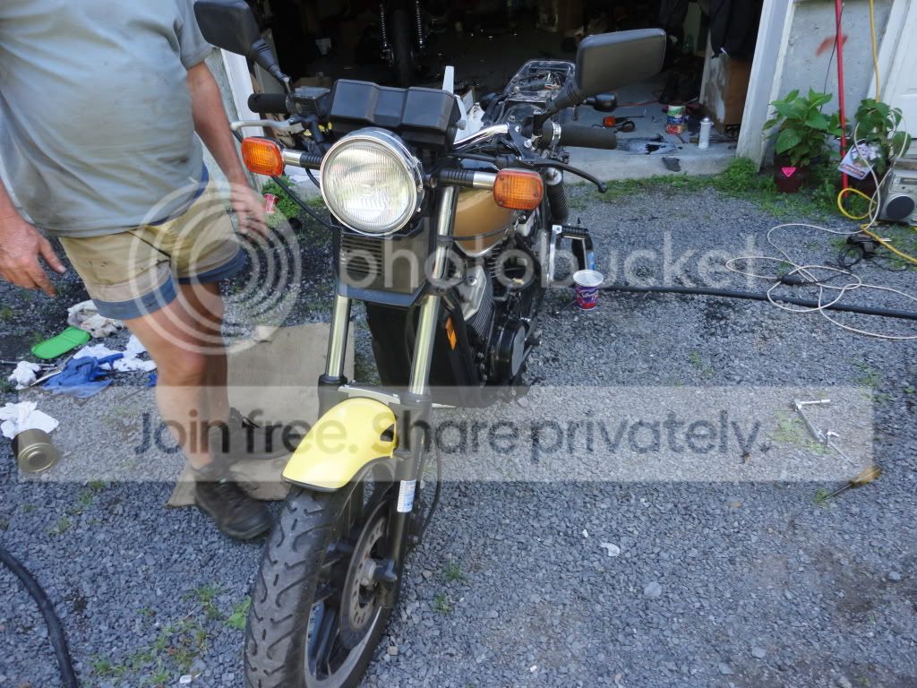

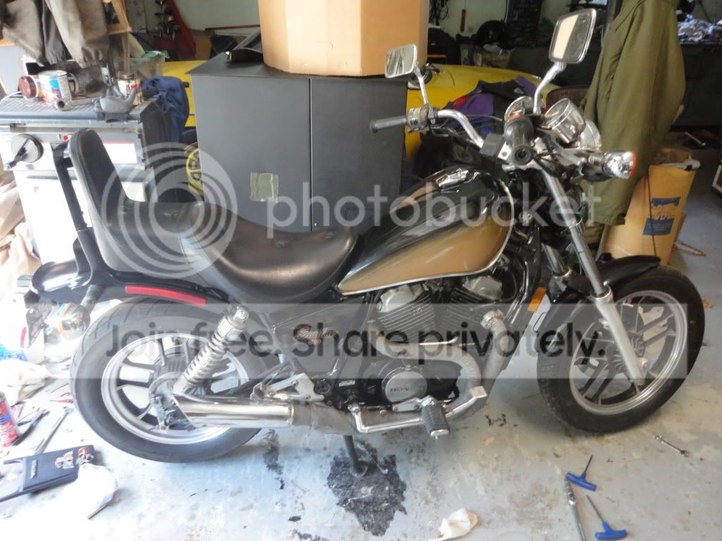

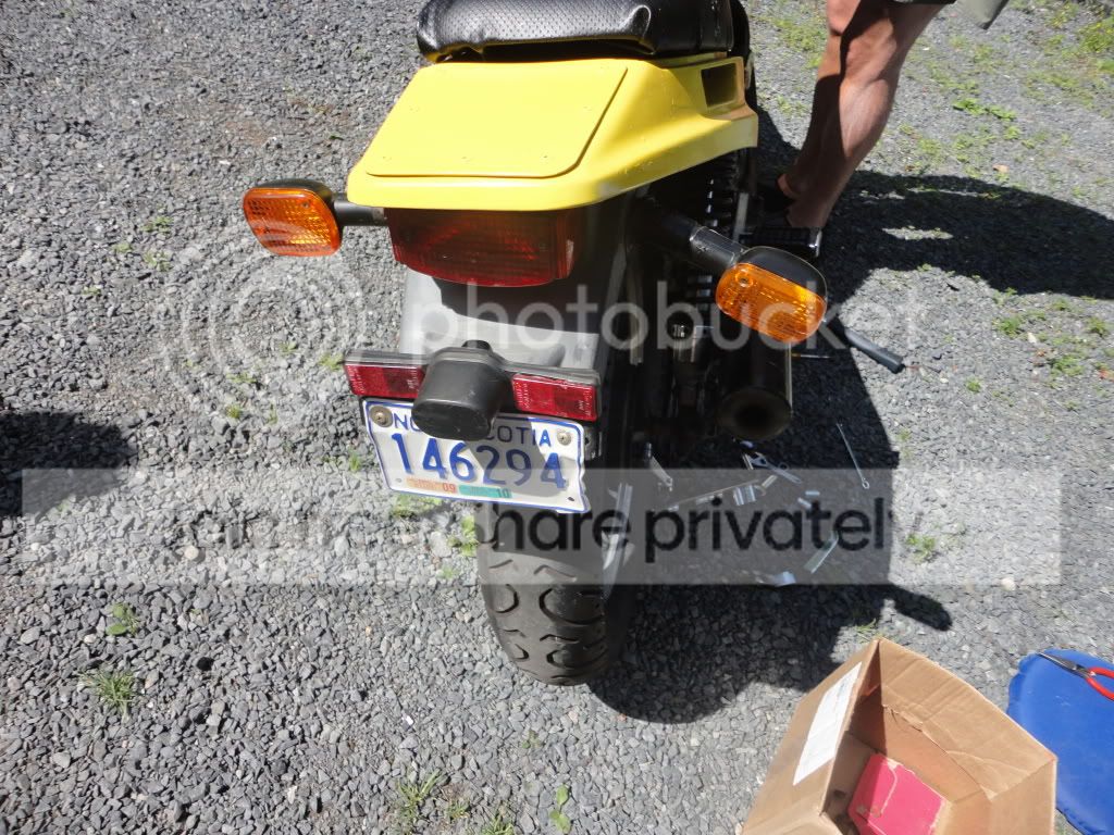

Finally got some photos.
Here is the ascot, looks better in the photos than in person.
Here is the vt500 shadow, that I transfered my parts off of.

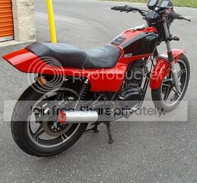

I was looking at another ascot cafe build (first thing that comes up google ascot cafe racer) and stole this photoshop picture of his (before and after) of what he is planning on doing, I was thinking of doing the same thing, and maybe getting a cateye tailight/licenseplate holder underneath what do you think(I gotta make use of what I have)? Another thing I was thinking of was doing the opposite, getting rid of the red tailend, and moving the little fender to be more or less flush with the seat, It would work better on my bike cause the fender looks more like a fender, I think this is a european ft500, and mine is a canadian vt500, has a slightly different piece there (mine looks like the rear fender in my first post). Would that look alright?
