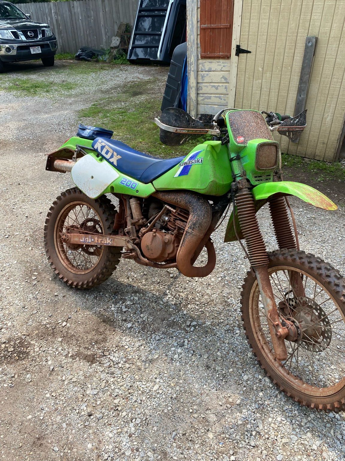

Well the FZ I got from ex119x is officially gone. And as happy as I am for him to have passed that bike to me, it’s leaving opened a door to a new-to-me bike… a 1987 KDX200. Kinda funny that it’s the same year as the FZ lol.
Anyway, I picked up this gem earlier tonight from a local guy. It’s 90% complete I’d say, and it fired right up with just a touch of fiddling.

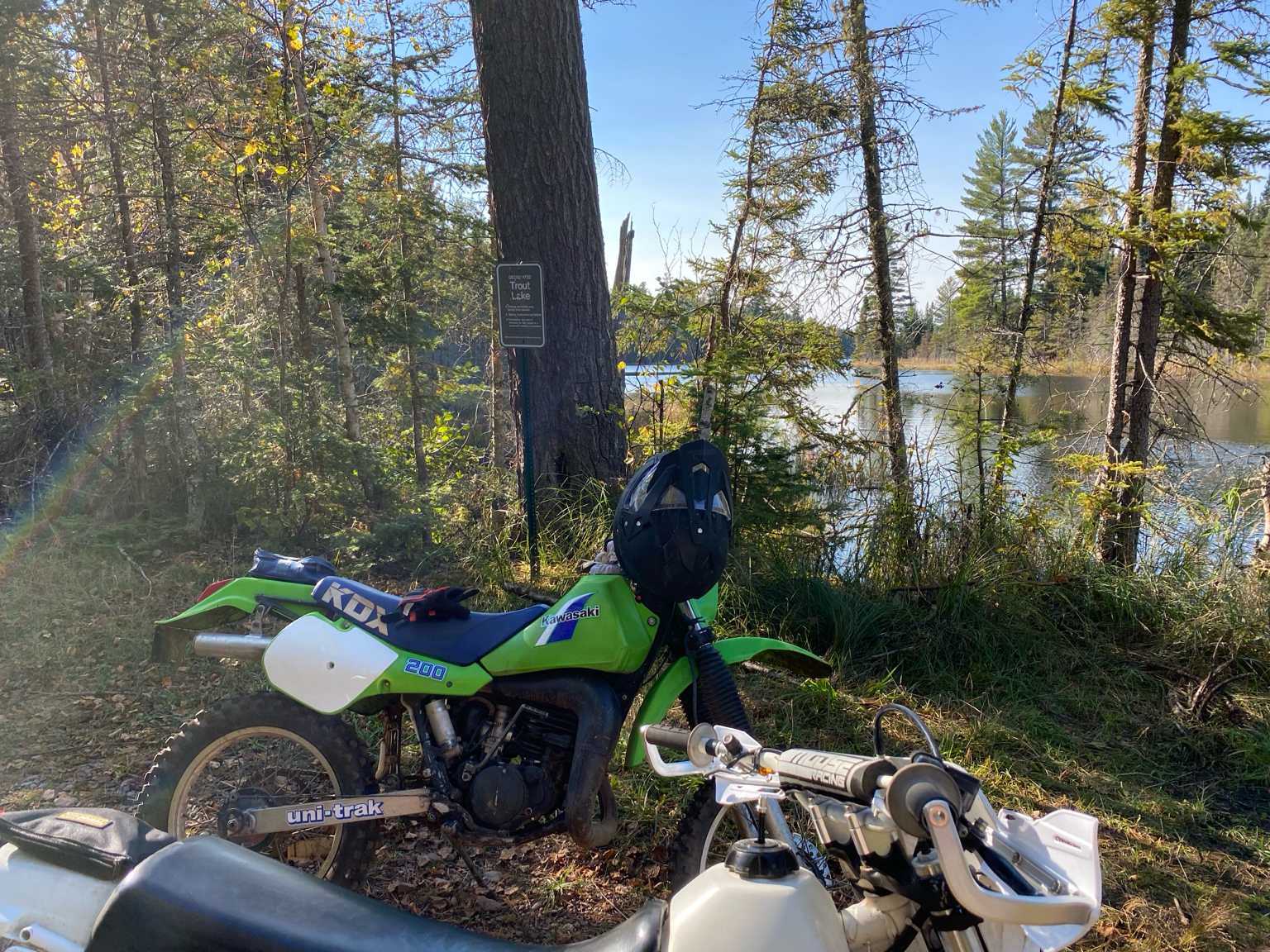

Here’s some pics of a couple of adventures the bike went on this summer. It’s a great trail rig for the northern MN woods, and I think I’ll hang on to it for a while. I may even have a KX250 USD front end set aside for it in the garage…
