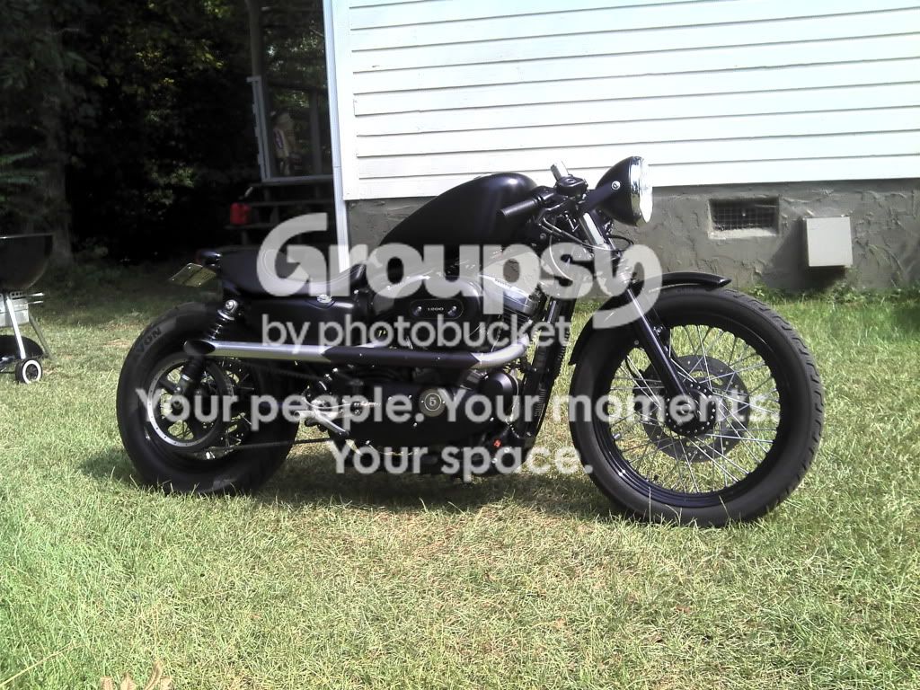

As stated... Your main issue is the in tank fuel pump for the FI. A custom alloy/steel tank is really your only good option. Junior (above link) has made at least one tank with the internal pump setup that I know of and it was badass. He's a hell of a fabricator. Unfortunatly, modifying a brand new machine is not going to be cheap or simple, but if you do it one piece at a time and stick to a plan you should be ok. I for one am interested to see what you come up with.
