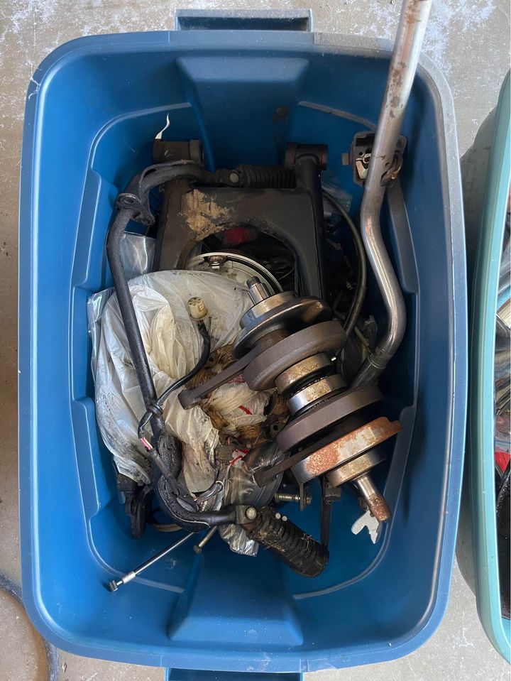

I am an older guy (born 1969) and I found a 1972 CB350 on FB marketplace. It came with a title (which I just transferred) The young man (mid-late 30's) had purchased a running cb350 and wanted to learn on it, so he took it apart and had the case bead blasted, but other projects took priority and I think it just started gathering dust. He bagged and labeled everything, but the engine is completely disassembled. I got three tubs of parts. I want to put it back together, but have never split a case. Done top ends, and lots of other mechanical work, but never put one together from scratch. There are a couple of issues that I see off the bat and wanted to ask about ( and I will search).
1.) There is a snapped off valve guide, broken at the head. - What is the best method to extract for a home mechanic or does this need to go to a machinist?
2.) There are two bolt through holes on the lower case, one has about half of the circle snapped off. Should I source a new lower case or just work with the imperfect and is it super critical. If so can it be tig welded back to health (is it worth it if I have to pay someone to do?)
This was really priced as a gift to give another enthusiast a chance to get the bike back on the road.

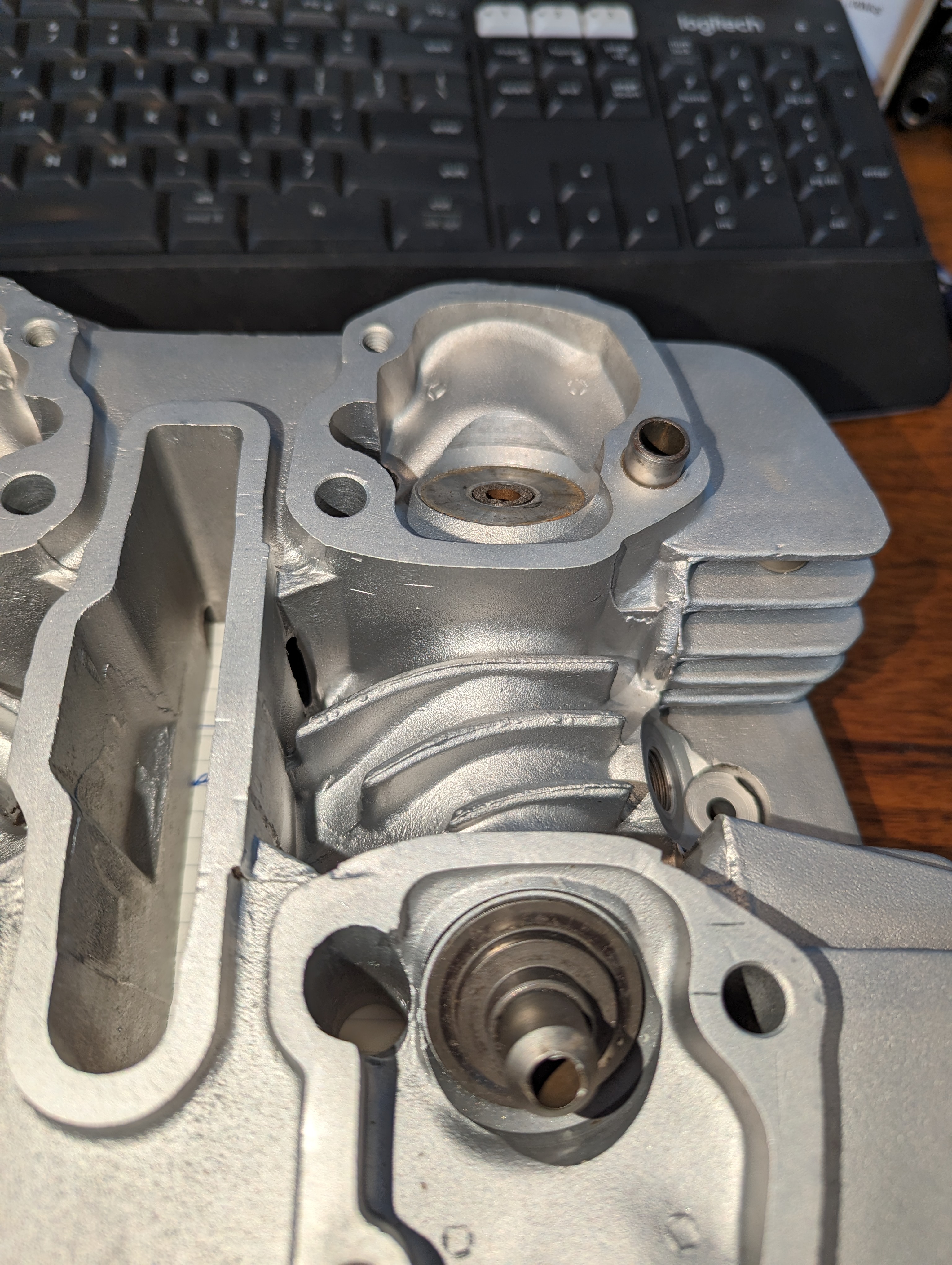

So the first problem I want to solve is the valve guide problem. Let me describe it a little better as I am not sure about the components after looking up valve guide parts for the CB at common motore. The spring seat snapped off from what I am calling the valve guide at the head, so the spring seat in no longer attached to the head and the "valve guide" remained in the head. I need to determine all the pieces that make that set of components up and determine next step. If I have to replace that I would like some machinist recommendations for CB work. I am assuming I would just replace the broken valve guide and valve seat and have the seat cut to either a new valve or the old valve. I will get some pics up as a picture is worth a 1000 words. Edit - added a couple of pics

You can DIY the guide but it's going to need reaming to size after fitting plus valve seat will need to be cut.
You use a piloted drift, slightly under diameter of guide with pilot same diameter as valve stem.
The spring seat actually slides over top of guide
Unless shop is familiar with motorcycles and old Honda's in particular, it may be difficult for them to actually do.
It's normal to heat head around 250f to remove or re-fit guides.
Putting them in too deep can make the stop ring (an external wire circlip) squeeze guide which may crack same as what you already have (I've seen it happen direct from factory, burning oil, on stripping top end, top of guide broken off).
There are special tools available but personally I've only ever seen pictures of them as Honda would prefer to fit a new head under warranty and majority of 'old' bikes' ended up scrapped after 5~10 years when repairs got this expensive (honestly, I've only ever done one complete valve guide replacement at a dealers, Suzuki GS850 as owner liked it and wanted to keep it)

Thank you for the reply. I have lots of questions.
1.) The valve guide broke, if I replace the valve guide, do I have to replace the valve and the seat? Can I reuse the old valve ( I don't think the engine was work or smoking).
2.) is there a specialty reaming tool that you use to match the size of the valve guide to the valve that you use? This seems like a machine shop type process
3.) I'm familiar with heat / cold to install bearings, seems like the same principle.
No need to replace the seats. Your old valves should be OK as long as they are in spec and aren't bent. Get good valve seals.
hard to tell in the photos, but if looks like you valve seats might have some cupping - check your valves as well. If thats the case I would pass it off to a machine shop to handle cutting new valve seats, grinding the valves, and installing a new guide. They will also be able to check it for flatness to see if you need it decked. There are lots of places to skimp in a project like this but the head is not one where I personally cut corners - it usually ends up as false economy. This is stuff that most local shops can do no problem. If you are willing to ship I have been using Shumann Motorwerks out of Milwaukie OR. He has great prices and specializes in vintage Japanese stuff.

Call the guys at AF1 racing in Austin and ask who does their head work. The head has to be heated and drive the old guide out. Then a new guide has to be fitted. It may or may not need reaming to size, then all the valve seats and valves need to be cut.
You almost always have to ream the guides. They're not hard to ream yourself. The reamers are tapered to the length of the guide, so there's really no way of getting things off center. Same goes for cutting the seats. The good tool kits are expensive, but if you do enough heads it's worth the price. You'll spend the same to a machine shop as you would for the kit.
