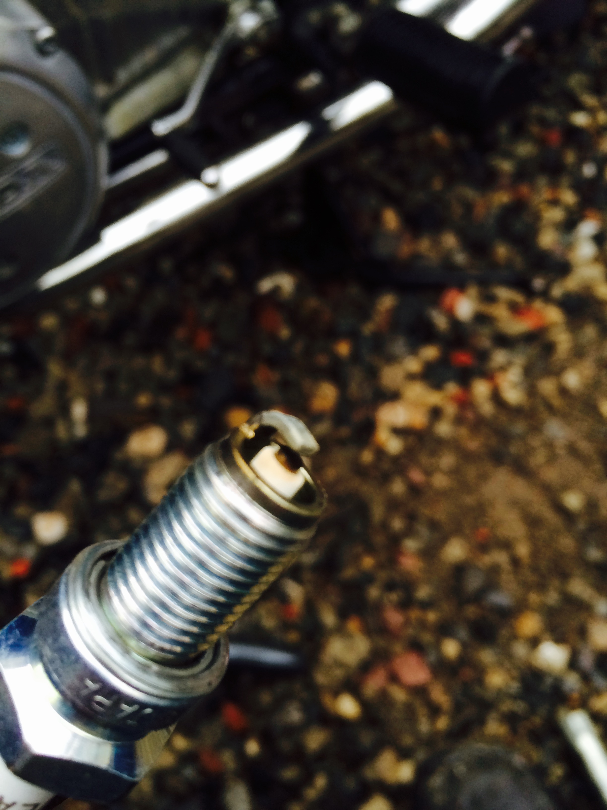

My CB550 was running well, but with a little bit of boggy acceleration for the last 6 weeks. However, after a "longer" ride the other day, it was having acceleration issues. Thought it was overheating, but I let it cool down and Cylinders 2 and 3 didn't fire. Stalled out twice from stop, and couldn't make it up hills on the way back. At first, I thought it was a carbouration problem because plugs on the bike have fouled out before. I took the carbs off and set them to stock float height (12.5mm) and the air screws to stock setting (1.5 turns). Put it back on and threw in new plugs, and cylinders 2 and 3 still weren't going. All the physical coil wires have spark without boots, but 2 and 3 may have a little bit of weaker spark with boots. Regardless the bike ran fine with the setup in the past. This is what the plugs look like. First plug is from cylinder 1. Just the contact point is black. Second picture is from the second cylinder, which doesn't look like its firing at all. Another weird thing I noticed when I looked for dirty points is that points 1 and 4 have less consistent spark between them than 2 and 3 (see last picture). I don't know if this has anything to do with it, but I feel like this problem may be electrical. I know there's like a firing order, but on my bike I have had all cylinders running as is. Curious as to what it is, maybe a shot coil? My buddy suggested something about valve clearance or something coming lose while riding. I don't know how it could be carbs. I'll also post a youtube link of it running. Just to reiterate one more time, this happen during a ride. Thanks in advanced for any advice, sorry if I said anything wrong. Never have worked on a four cylinder bike.

I would say it's definitely an electrical problem, either with the points for cylinder 2&3 (the one in the front) or with that coil, since one of the coils fires cylinder 1&4 and the other coil fires cylinder 2&3. It's really hard to test a coil since sometimes it will short out only after it gets hot, but you can at least test the primary leads for resistance. I'll see if I can post a how-top on the subject in my next post.
thanks for the quick reply. I read that 550s and 750s have this problem sometimes, i think 2 and 3 not firing but 1 and 4 going fine in addition to signs that the carbs are "okay" are pointing right at coil as well. I mean the bike was on four cylinders...and all I did to the carbs was clean them and barely touch floats/reset screws. Plugs aren't wet bowls don't leak, no wet plugs, etc. The plugs I was running were fouled out but who knows how long they were in there. Just weird that this would happen riding, or maybe it was dragged out over time.
So where would you go from here, just grab a new coil? what would problems with the points entail? the advance spring or something went? I've never done anything with a four cylinder engine before so apologizes if what I said about the points isn't right.
