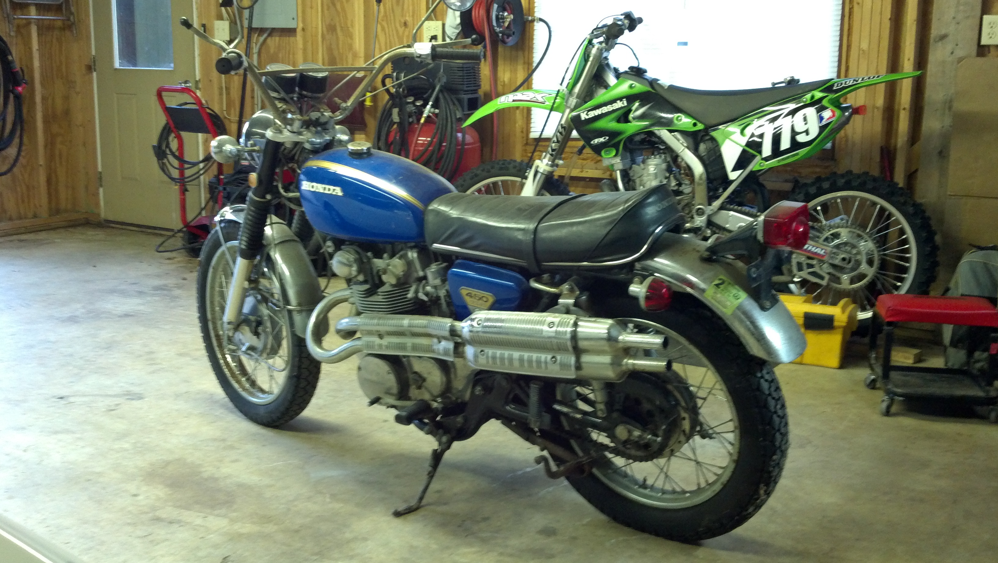

I'm Jay and I have a motorcycle problem. I've been lurking for years and have finally started my first vintage bike project - 1969 Honda CL450 Scrambler.
Background - I was given this bike over 5 years ago. From what I can gather, this bike hadn't been on the road since the late 70's, but sat in this guys garage the whole time. Once I brought it home, it sat around in the shed the past few years while I remodeled a house, raced motocross, and worked on my hot rod. I didn't have anything major lined up for the winter months, so I decided to lay into this bike. I'd love nothing more than to chop/cut this bike all up, but it's just too 'together' for me to 'get to work'
The Plan - Since 95+% of this bike is original, I'm going to restore as much of the original components as possible, while making some finish upgrades where I see fit (powder coat frame, etc). The chrome has the typical surface rust and corrosion, and much of the aluminum is hazed with oxidation. Nothing a little elbow grease can't fix. The tank has a minor dent, but I think a paintless dent removal place can handle it.

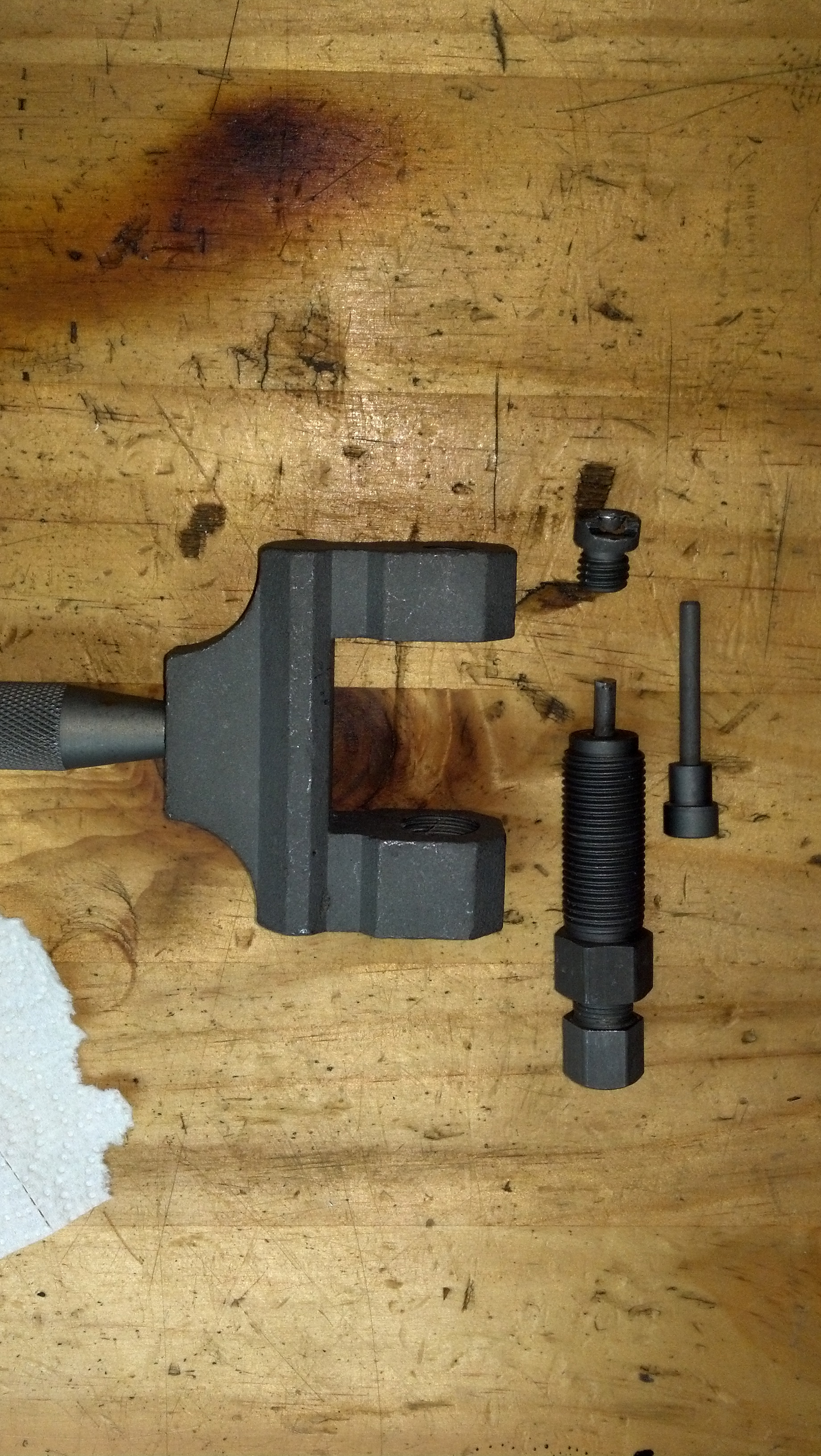

I'm at the point that the cam chain needs to be broken. After striking out at the local bike shop (out of stock), I landed a chain break tool at HF. Some quick mods and it should be able to do the job first thing tomorrow morning.

I have attached a few pics of the chain break tool I bought at Harbor Freight last night. Some simple modification with the cut off wheel and I was in business. I had to shorten the pin to get the entire tool inside the intake cam opening, as well as grind a relief in the receiving end to better encompass the chain link on the opposite side. It did damage the adjacent chain link, but it didn't matter since I'll be replacing the cam chain any way. For riveting the new master link, I plan to grind a slight taper into the pin.

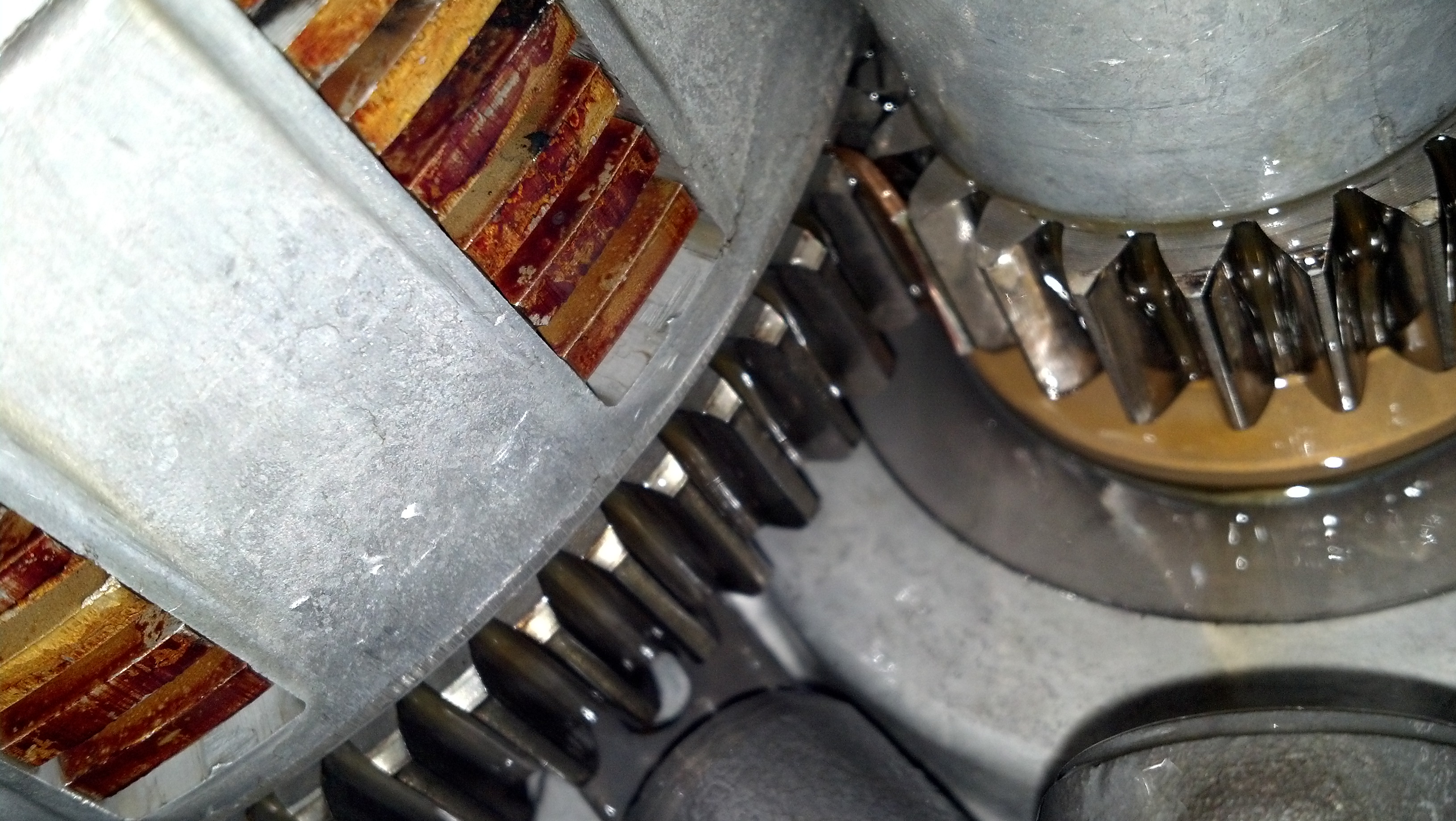

I finished tearing down the engine this morning. I have amassed a handful of special tools from all of the bikes and sleds I've worked on through the years. I have a few flywheel pullers and a 17mm socket that I milled to remove the balance shaft nut on Honda 4t MX engines. Nothing I had "in stock" would fit the bill, but I lucked out last night and was able to score the flywheel puller and oil filter nut socket at my local dealer in stock!
The rings were pretty frozen on the clutch side piston, and the circlip on the mag side piston had the opening at the install relief in the piston. This could have been a big issue had I decided to start this engine before tearing it down. In all the moto and snowmobile motors I've built, I always install the circlips with the opening facing up, that way at BDC (fastest deceleration) the circlip mass is already centralized at the bottom of the groove.
To yank the flywheel and oil filter, I used a trick that came in handy working on Honda CRF450R motocross engines - I cut the edges off a penny and slide it between the next meshing teeth of the primary and clutch gears. The copper is soft enough that it doesn't harm the gear teeth and typically wedges itself in there so that it stay pretty well put until you're ready to remove it.

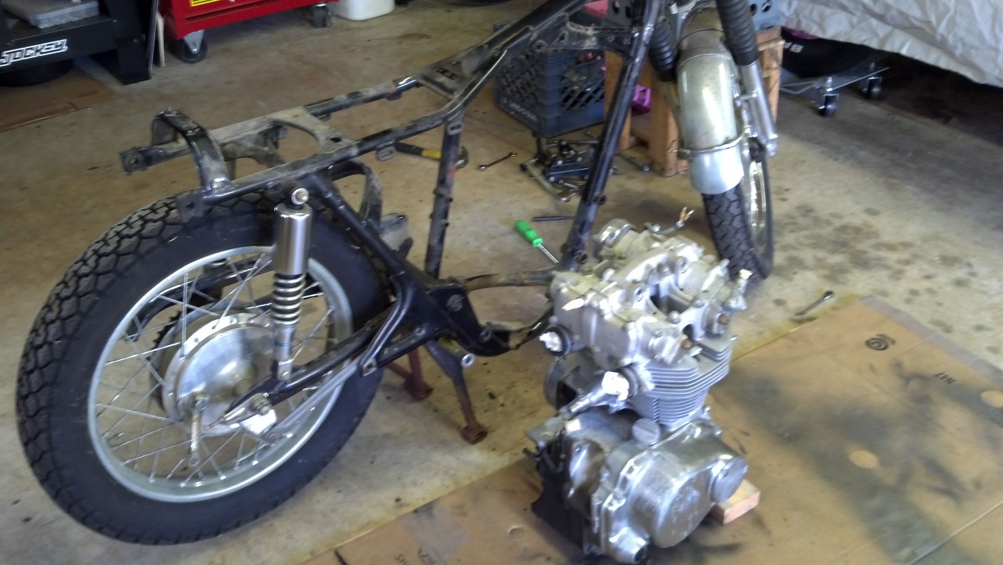

Unfortunately, I don't have a lot of progress to report. It's been pretty cold in the mornings here, so I haven't been getting out into the garage much. I brought all of my dull/corroded aluminum parts in the house and I've been wet sanding in my spare bathtub. Then I'll head out in the garage and polish/buff with my cordless drill and 3-1/2" buffing wheels. It's not ideal and by no means am I after a show shine, but they'll look good going down the street at 40mph. The attached pic makes things look a lot more dull than they really are. You couldn't check your hair in the cam caps, but they'll shine enough for you to floss your teeth.
I'm picking up my new piston circlips and rings today from my Honda dealer. That should be everything I need to get the engine back together.

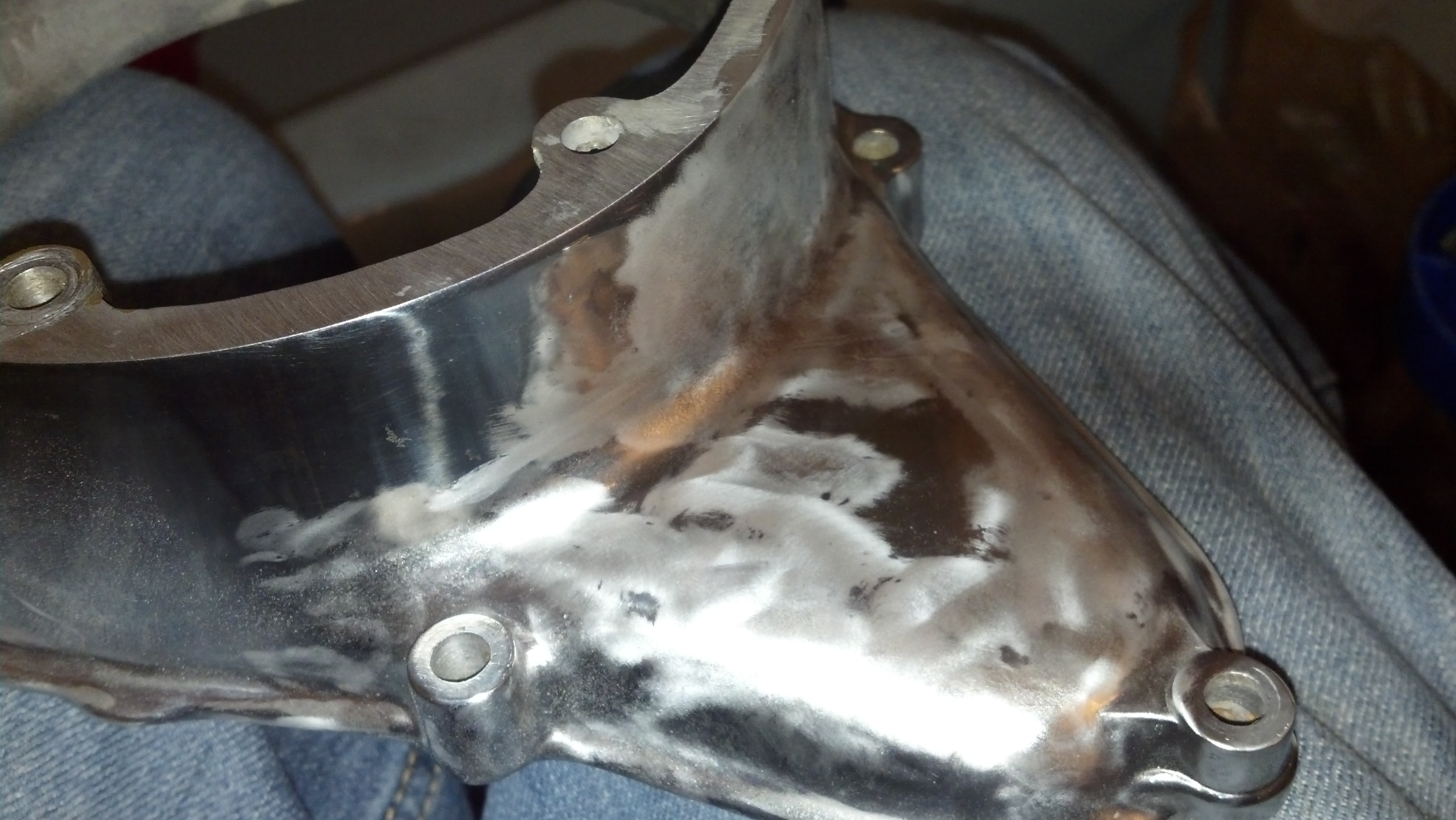

I'm not 100% sure if the surface of these covers is the clear coat coming apart, or if it's pitting from oxidation. I laid a few coats of aircraft paint stripper on these but it didn't seem to make a bit of difference. What I do know is it's a bitch to sand through. 80 grit sandpaper was a workout trying to cut through this stuff, and even then I couldn't work the sandpaper into all of the nooks and fillets in these covers and around the bolt holes. Over the past few days, I've spent just as much time trying to figure out how not to have to hand sand these parts as I have sanding them. What I found was that a carbon steel brush and a brass brush turning 40,000 RPM in a dremel makes pretty quick work of this stuff and gets in and around the bolt holes. The resulting surface finish ends up being able to clean up with 220 grit sandpaper.
Here's some things to note if you follow this technique. Wear safety glasses and a large face shield. Steel wires come flying off that brush and embed themselves in your skin. Arms, legs, face, and neck. A mess is going to be made. I'd suggest doing this outside of the garage (or in your spare bathroom where its warm this time of year like I'm doing).
Here's a before and "in-progress" shot after working the wire brush with the dremel.

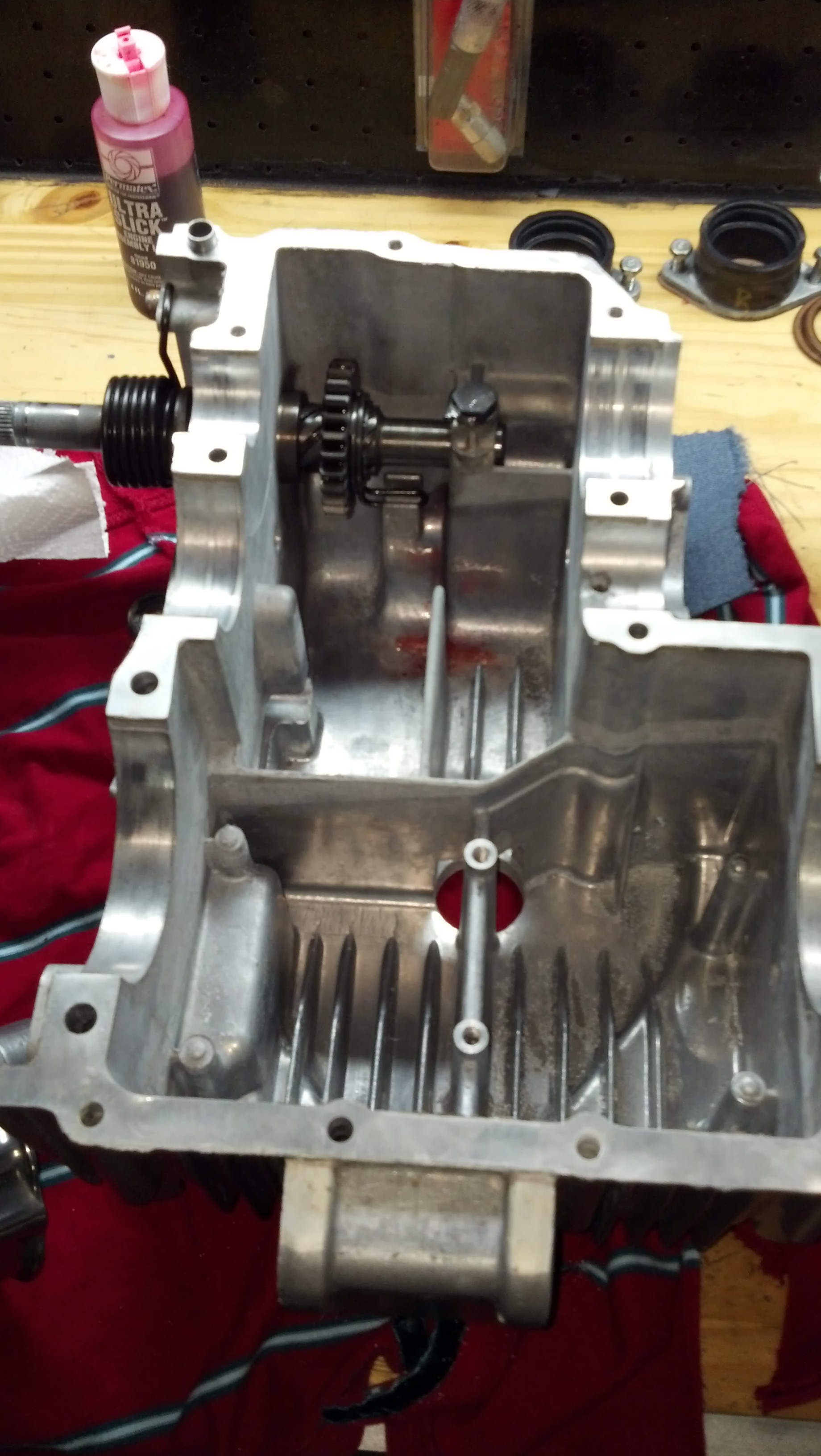

I started working on engine reassembly as well. I got the kickstarter mechanism installed, then moved on to the shift drum, tranny, and crank. My new EK 219H timing chain came to me as an endless chain...it wasn't a big deal grinding 2 pin rivets off and punching out the pins, but I was aggravated by the principle of having to cut up a chain that cost $40. I'm almost over it...
I was ready to put the case halves together last night, but realized that I was out of stock of M6 pan head bolts to keep the windage tray in place. So I quit what I was doing and went in the house to have a beer.
