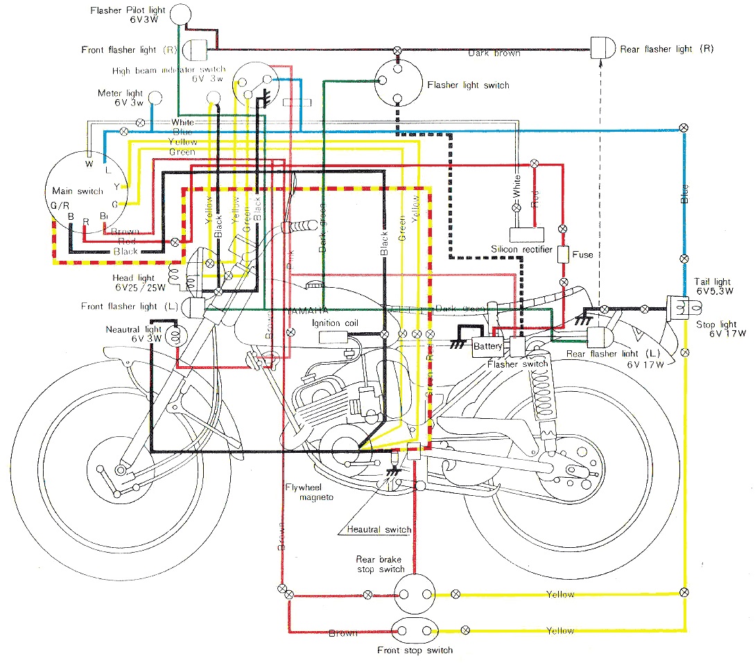

Yeah the only reason I was wanting to convert was to go to LED lights all around. As I said before the bike doesn't really have any lighting so I figured now would be the time. On average what would you say the average wattage/current requirement is for LED blinkers, headlight, and tail light. I don't have anything specific in mind so any general knowledge would help.
I also found this wiring diagram with the voltages (6V duh) and wattage requirements for the different components if that helps at all.
Very little wattage is needed for most LED lights. Headlights are always the most: Anywhere from 15W to 30W. Turn signals and brake lights are usually in the 4W-6W range and running lights about 3W.
Yeah the blinkers I ordered are 12W ones. Just to clarify, the step-up circuit I originally posted should be fine for this yes? Or should I go with a smaller unit for each system?
The unit you posted will be just fine to run the turn signals, but IIRC, some f the lights on your bike are AC, not DC. You'll need to tweak a bit before those can be converted as well.
