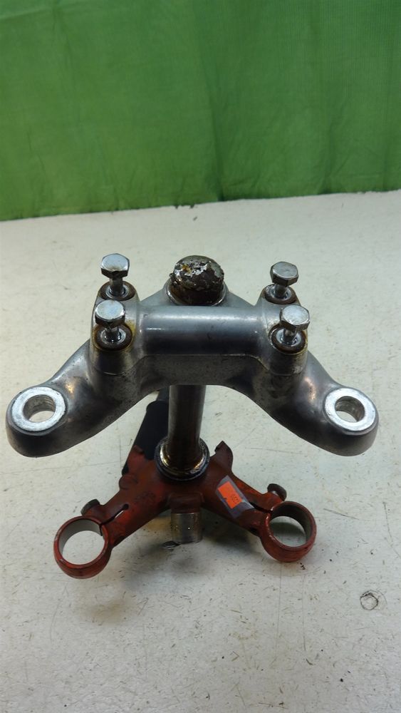

get a piece of exhaust tubing cut to size and start polishing it. Stainless would be best imo but cost more.
Hey @1fasgsxr
Here are pics of my stock upper. Slightly different from what you posted. Thoughts?
I'd prefer to find the fix for the issue, rather than just covering the gap with a piece of tube. Though it's not a bad backup.

Your stock triple clamp has a drop, by switching to a flat one you have lost that much ride height and you enlarged the distance between the top triple and the bottom triple. you will need spacers or a flat lower triple to make up the difference. if you want to keep the stock ears.
