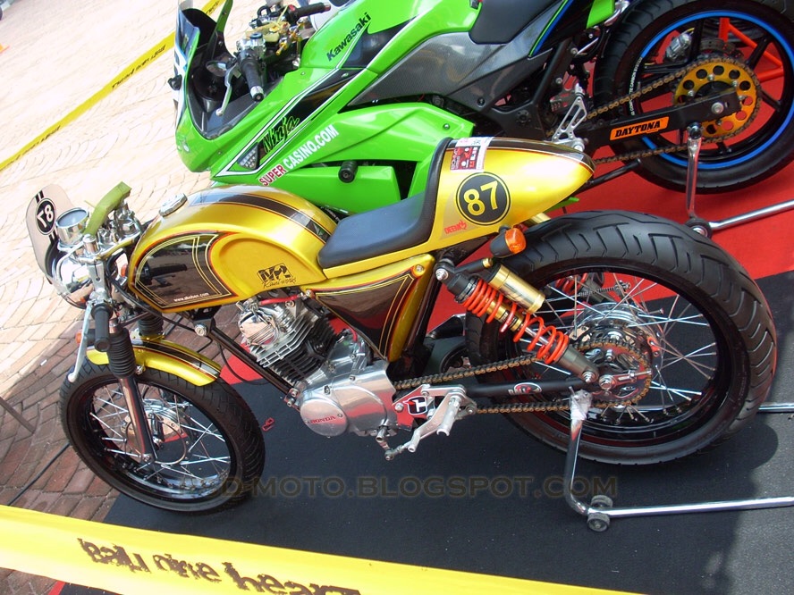

I'm trying to find a tire that both performs well and looks good. I'm hoping to find a modern sport bike style of tire. Both rims are stock and Im planning on going 90/90 18 front and 100/90 18 rear. I have a picture of a pair of tires that I really like but I know nothing about the performance. Can someone identify them? Anyone with a tire suggestion similar to what's in the pic? Thank you

how can you be concerned with performance when you are putting on oversized tires that will handle poorly ?
i have heard very good things about heidenau tires and they make the correct 3.25 front 3.50 rear for your bike
that said nothing wrong with the tires sizes you mentioned if you go up a size on rim width fr/rear

That's near stock. That bike also looks like it has wider aluminum rims. I am running 2.0 rims with.90 front 110.rear on my 360.
There has to be something with a sport bike look and still works pretty well. Just looking for some ideas. Thanks guys.
