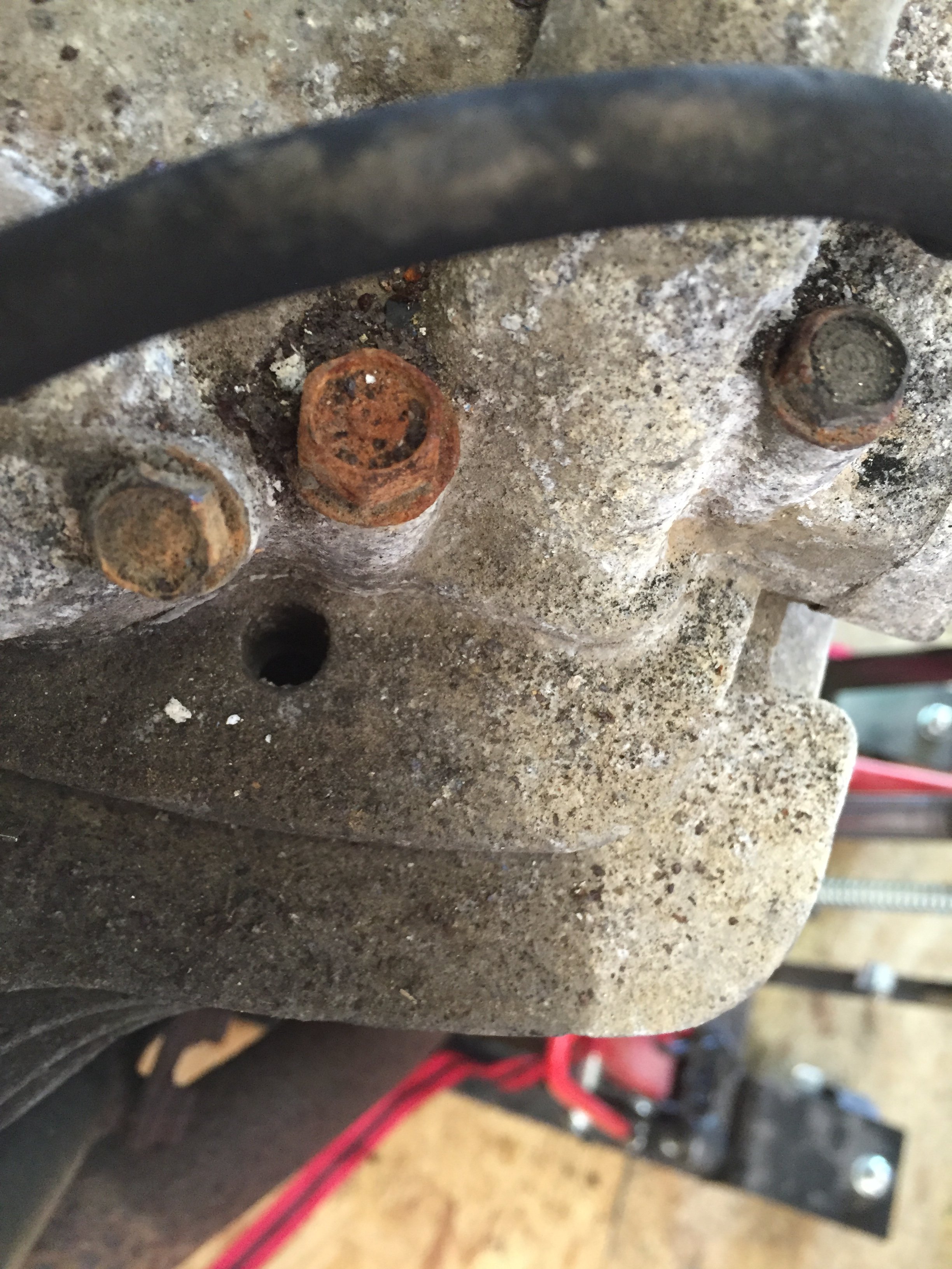

Read through the FSM on the plane yesterday, see if the motor turns when I get back tomorrow. I noticed this hole on the engine and didn't see it/a bolt in the diagrams of the head or engine overall. Located to the right of the exhaust port, looking at the motor from front.

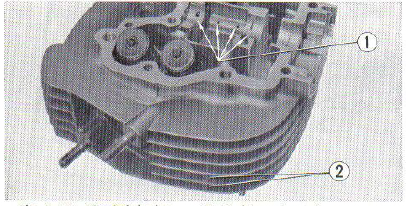

The screenshot is a 250 head.
In this pic from Calferacer's thread it shows the hole, as well. I might have something to do with the casting.
