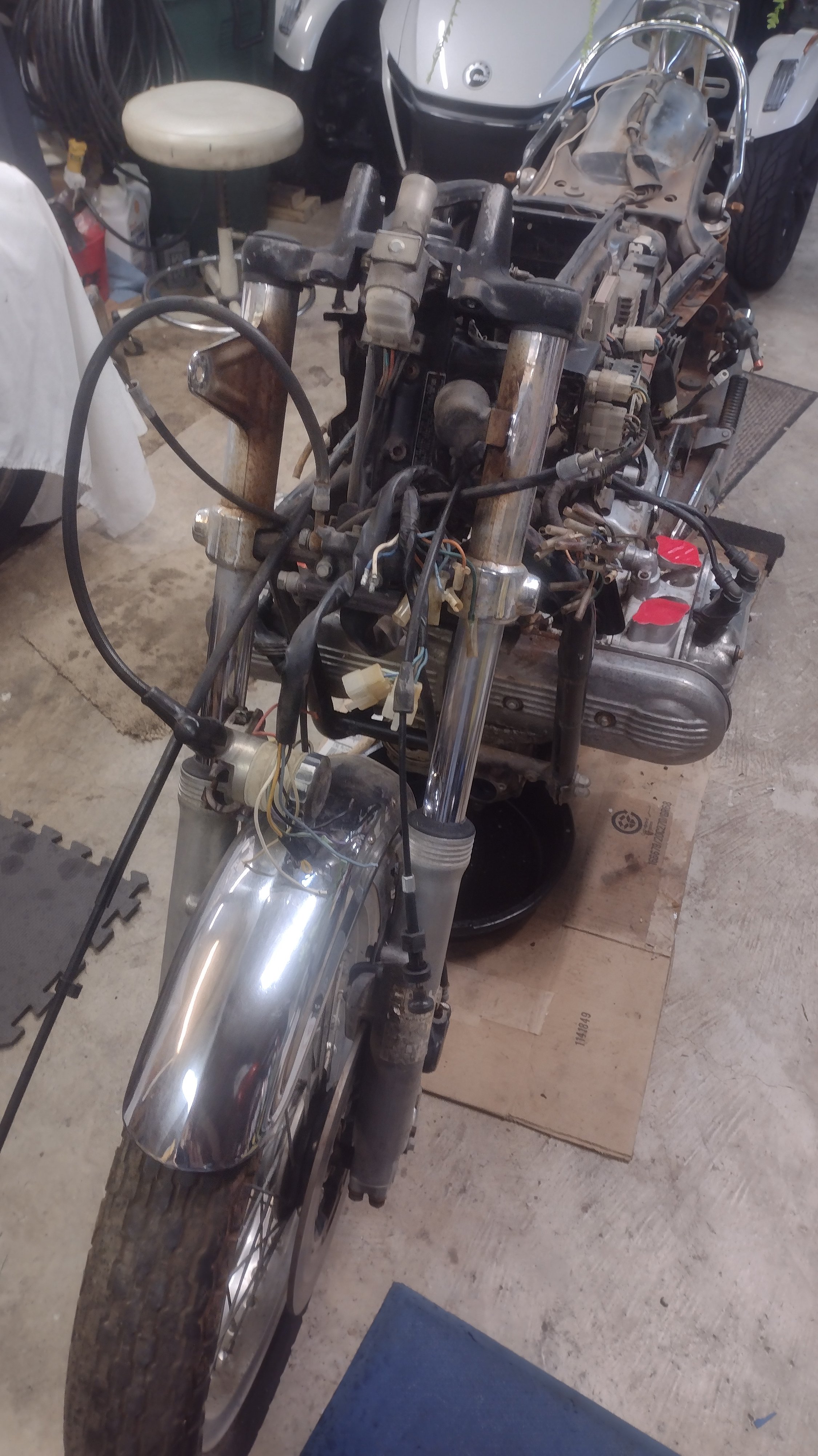

Today, the carb rack came off - my usual 1st step on these. Also, the engine guards are offand promissed to a local 'winger.
Engine guards off, carbs off, coolant and oil drained (coolant green, oil black), radiator pulled, handlebars pulled and wiring removed from them. Moving about as fast as I can (and want to) with the busted shoulder and very little space. Next will be to move it a little more out of the way so the carbs can be disassembled and go in the ultrasonic cleaner.

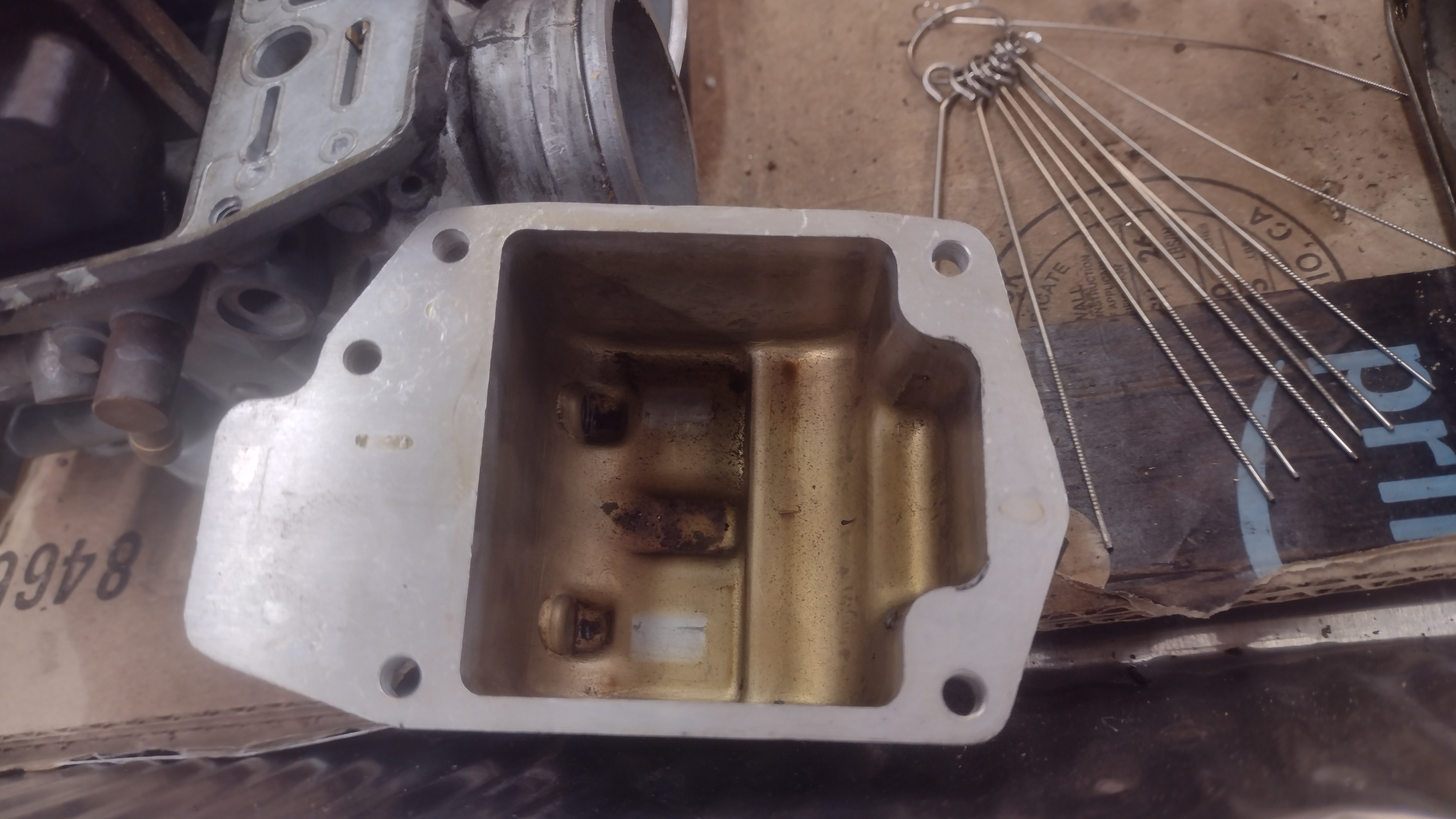

A bit more this morning (PT for the shoulder this afternoon). Plenum separated (a struggle - will need new screws) and all jets, tubes, etc. removed from #1 carb. Was surprised at how nice the float bowl looked for it. Not clean by any means, but no evidence of water like I've seen in every other set I've been through. Was even able to remove the float valve seat and filter with no damage by turning down a drift punch to just fit in it, then wriggling it out patiently. I actually enjoy working on carbs like this.

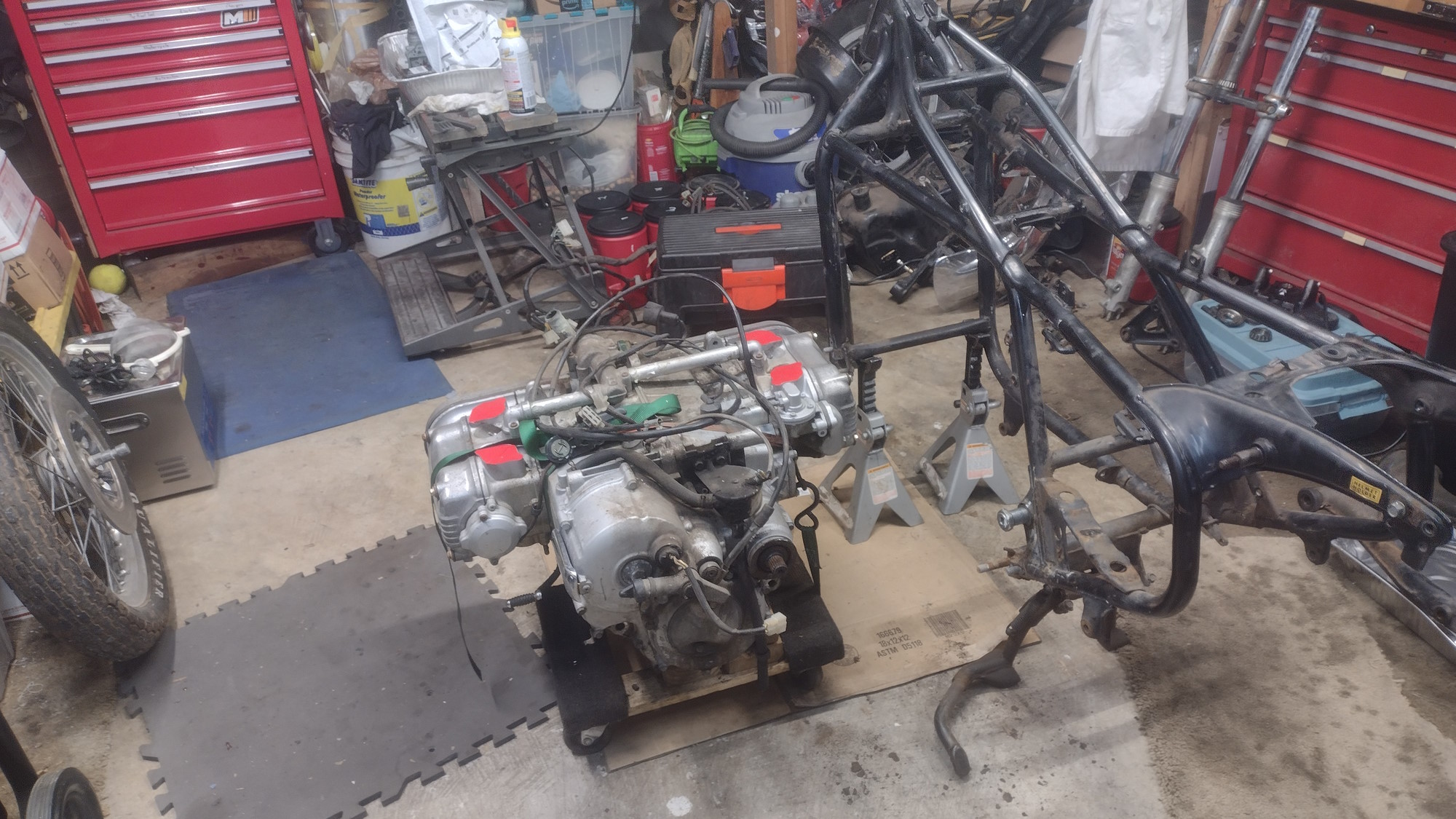

Can accomplish so much more with the Triumph out of the way. Rear wheel, brake, fender, etc. out and then tank out. Headers and muffler (shot full of holes). Next, remove the front brakes and footpegs. Rear drive came off easy after the snap ring (not too big a struggle, but went through all of my 90 degree snap ring pliers before I found one that worked). Snaked the harness out. It will be a nice winter project to clean and fix up. A couple hours more of fiddling around, and the engine will be setting by itself on the dolly.
All apart now, engine and frame strapped to dollies so they can go outside and be pressure washed. Looking at weather for near future, I should do that this afternoon. But, the shoulder says that it has had enough for today - go watch football.All apart b.jpg

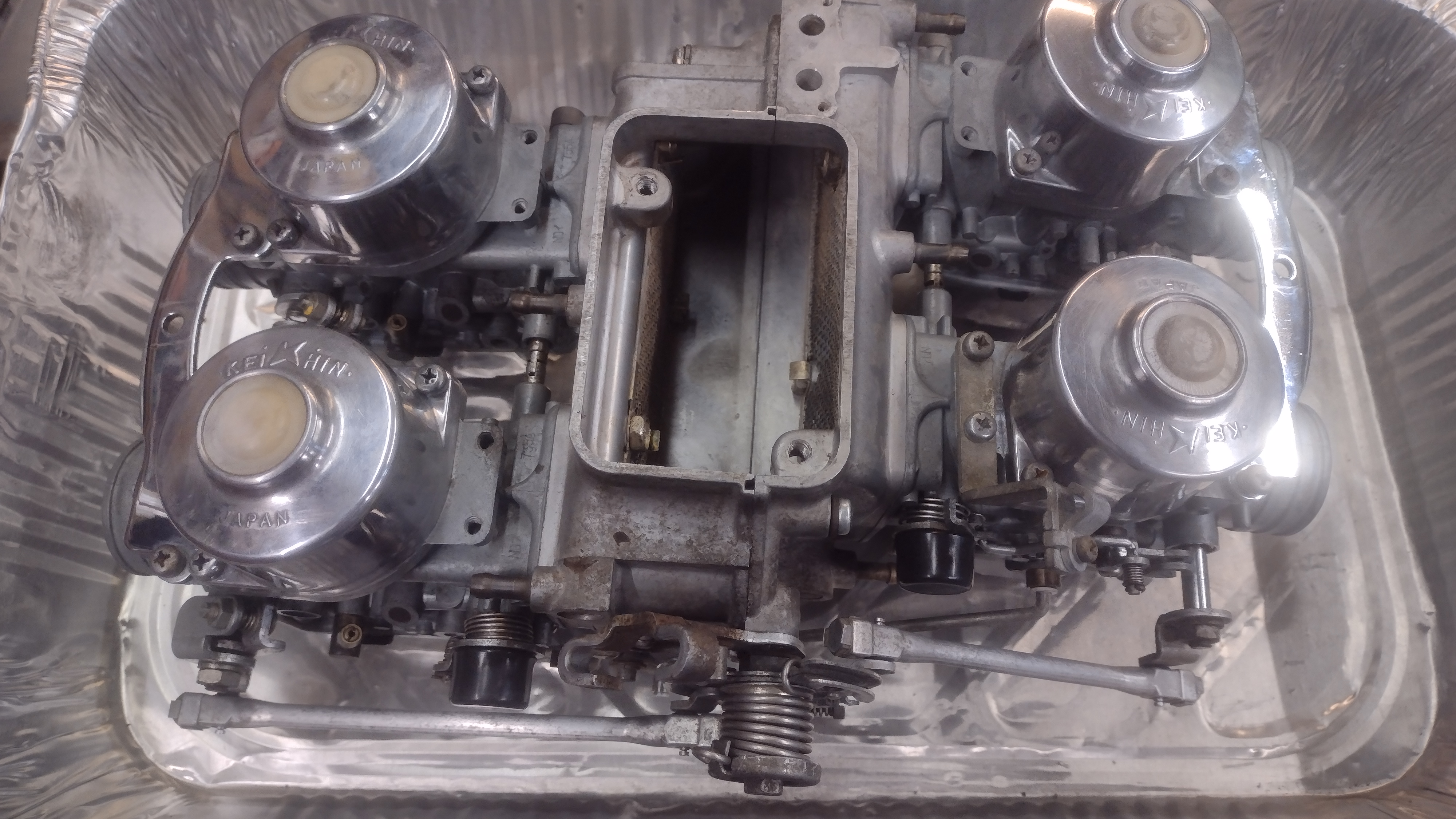

Finally back in the garage (wife got me a new Fire TV for hanging from the ceiling there). Carbs are clean, rebuilt, and leak tested. Next is cleaning the engine so it can be repainted.
