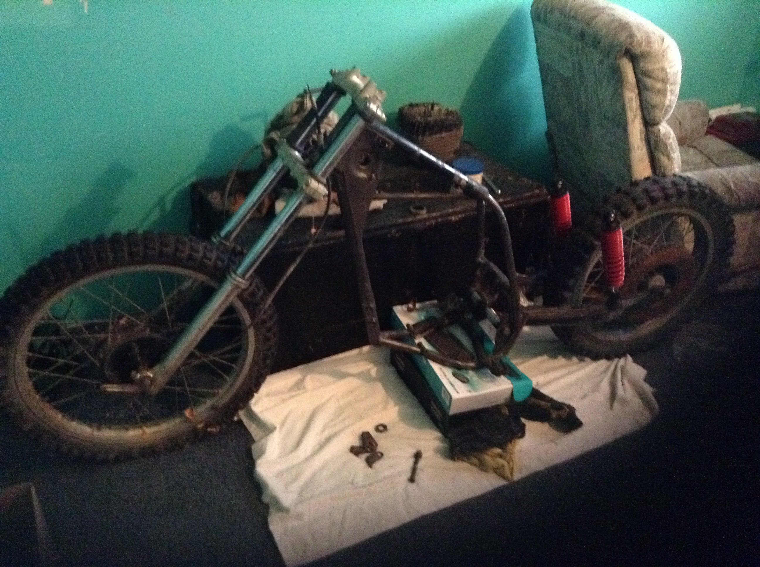

So I picked up a 1977 pe 250 b for a hundred bucks. Basically a rolling frame, has the engine but nothing else.
So far I've stripped it down, cut the back half off and started to gring all the tabs off.

So I've decided against making her a hardtail. I don't have the area or the tools yet.so I found the original swing arm, and have some brand new shocks. So now I have to find some material to make a hoop and supports. Oh and I lost one of the caps on the swing arm, a lot of digging through parts to find it. And my back will love it being a softtail.
