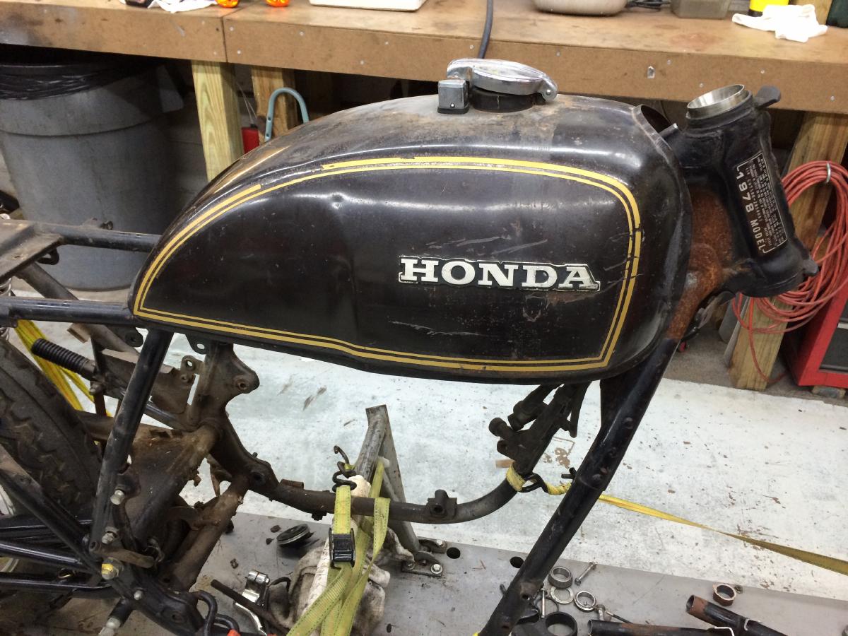

I have started another cafe build using the tried and true CB platform. Tore the bike down just to discover the frame was bent. I have located another frame that is straight and will tear everything I need off the bad frame and start mocking it all up with the good chassis. I am going to use this tank from a CB550.

That doesn't look bad at all. The tubes lying beside the frame look like top frame tubes from that frame. Please tell me that you didn't cut them out to fit the tank......
You are putting modern, stiff suspension components on a frame that is quite flexible, I would consult a frame expert, as those forces are now going to be transferred to that noodly frame.
Unfortunately the guy I got this frame from had removed the tubes attempting to do his project before he gave up. I will either weld them back or make my own to add strength to this frame. I have already put the frame on a jig to make sure it was straight before I decided to use it.

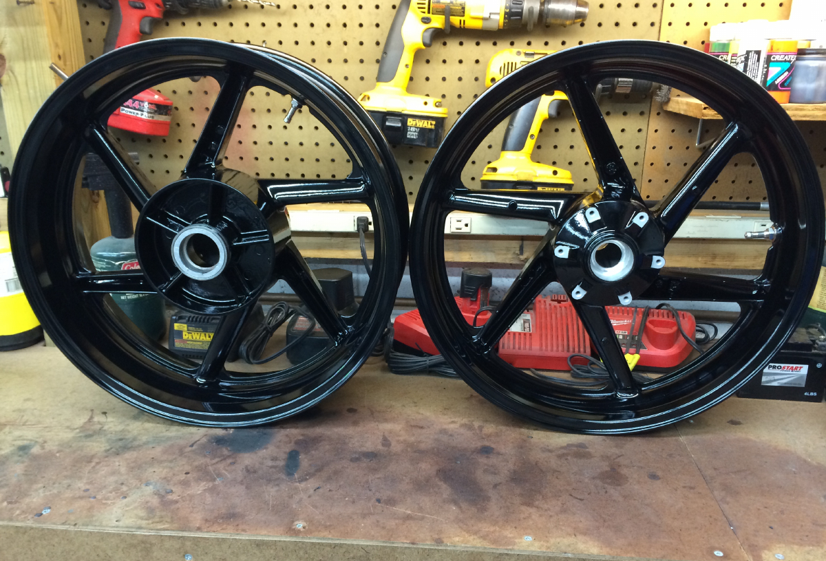

I picked up a couple of wheels, Rear is a CBR F3, Front is from a RC51. Both with the same spoke pattern. Had them both powder coated gloss black. The rear was a direct bolt on. The front needed some mods to fit the CBR954 front end, I used CBR954 wheel bearings and a modified center spacer, 2mm wider wheel spacers, and the 954 330mm rotors. Fitted them with a couple of Dunlop tires and mounted them up.

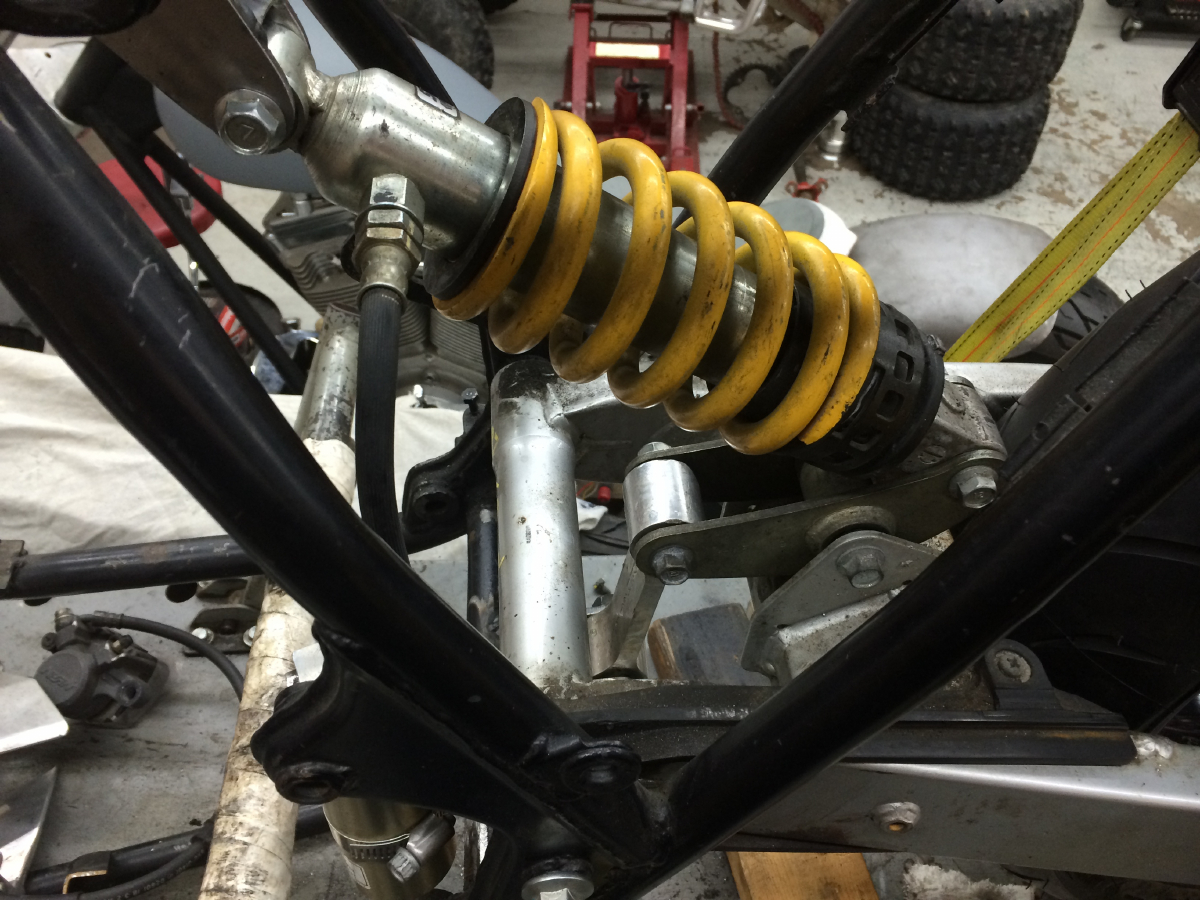

Figured out my rear suspension ratios. pivot and mounting points. Using a CBR F4 shock and CBR F3 swingarm and linkage. Made some mounts and tacked them in place. Still may add some more supports later.

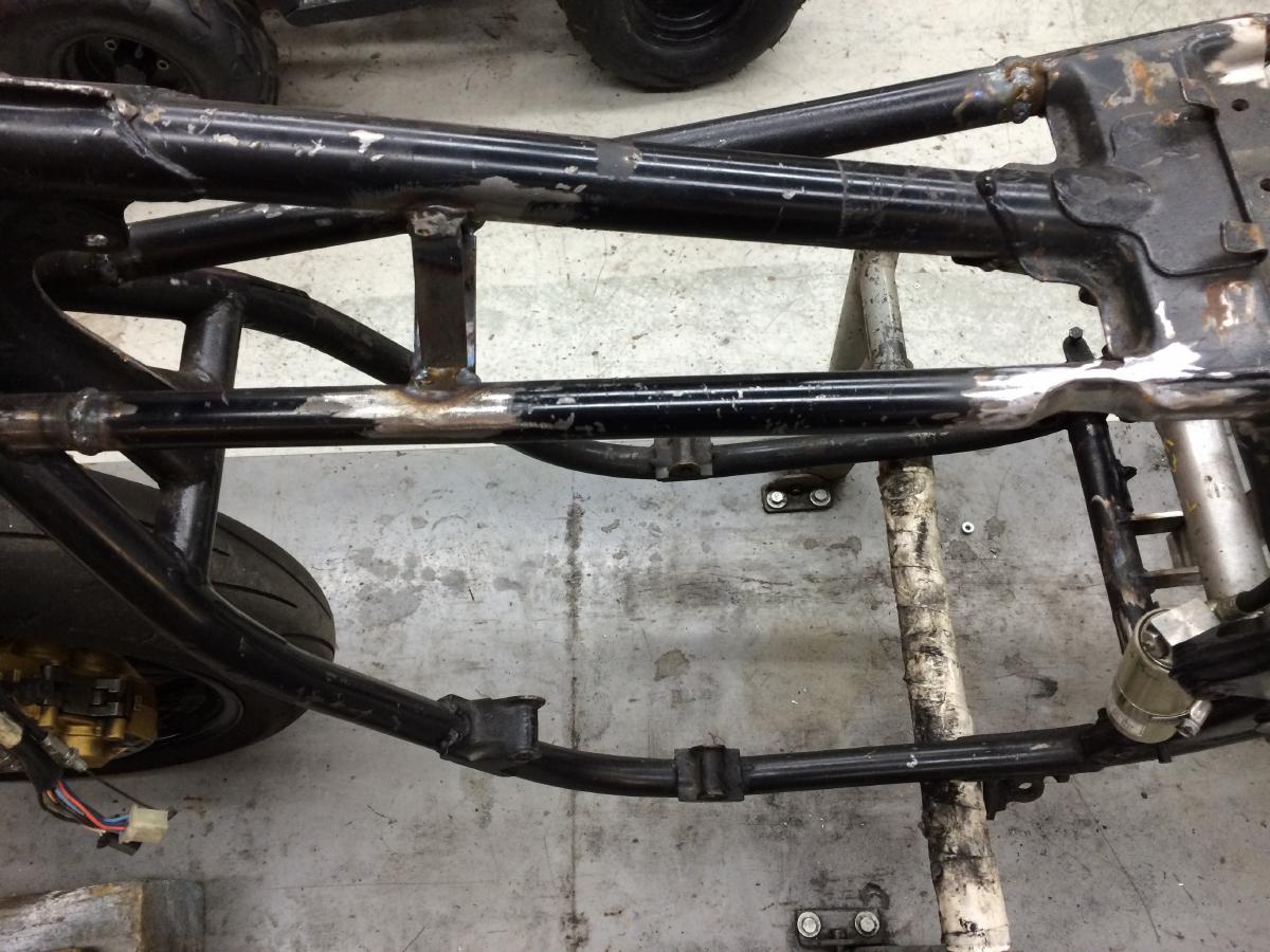

Making some more progress. I cut the rear of the frame off and bent some tubing to fit the tail section. I also welded the top tubes back into the frame where they were cut out. I had to modify one tube to clear the petcock for the 550 tank and had to rework the triangle piece that connects the 3 tubes so the tank would clear it. I will clean all this up later as well as add some more bracing.
