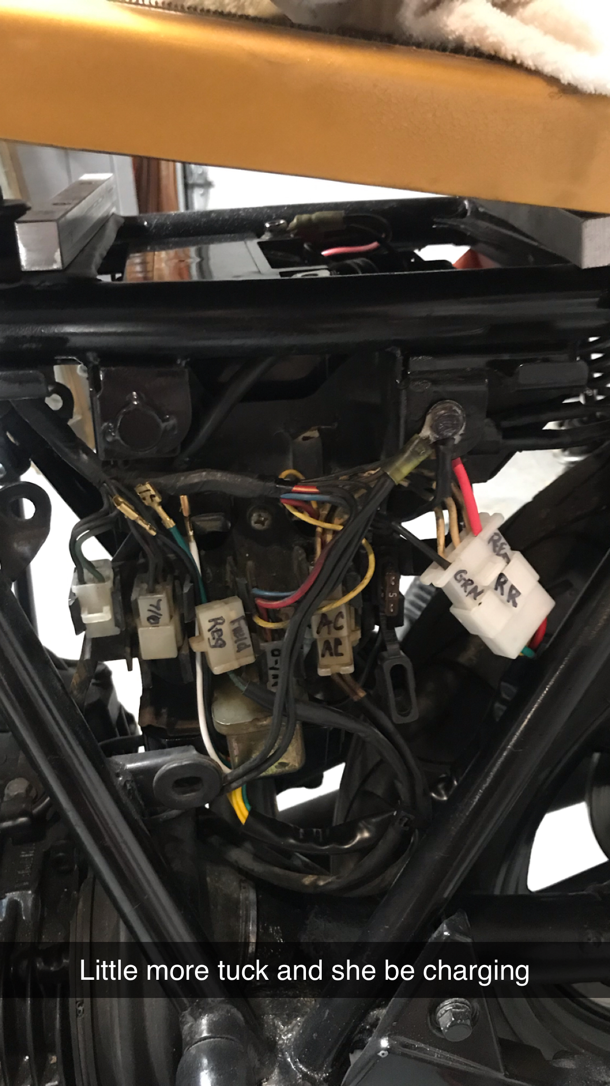

Let the battery trickle for a day and tried one last time. 8)
Only getting 12VAC at the whites with a little revving but the battery is clearly charging, drops down almost a volt at idle when removing the black signal wire. Thanks for your patience, the stator may be going but we know the R/R operates now.

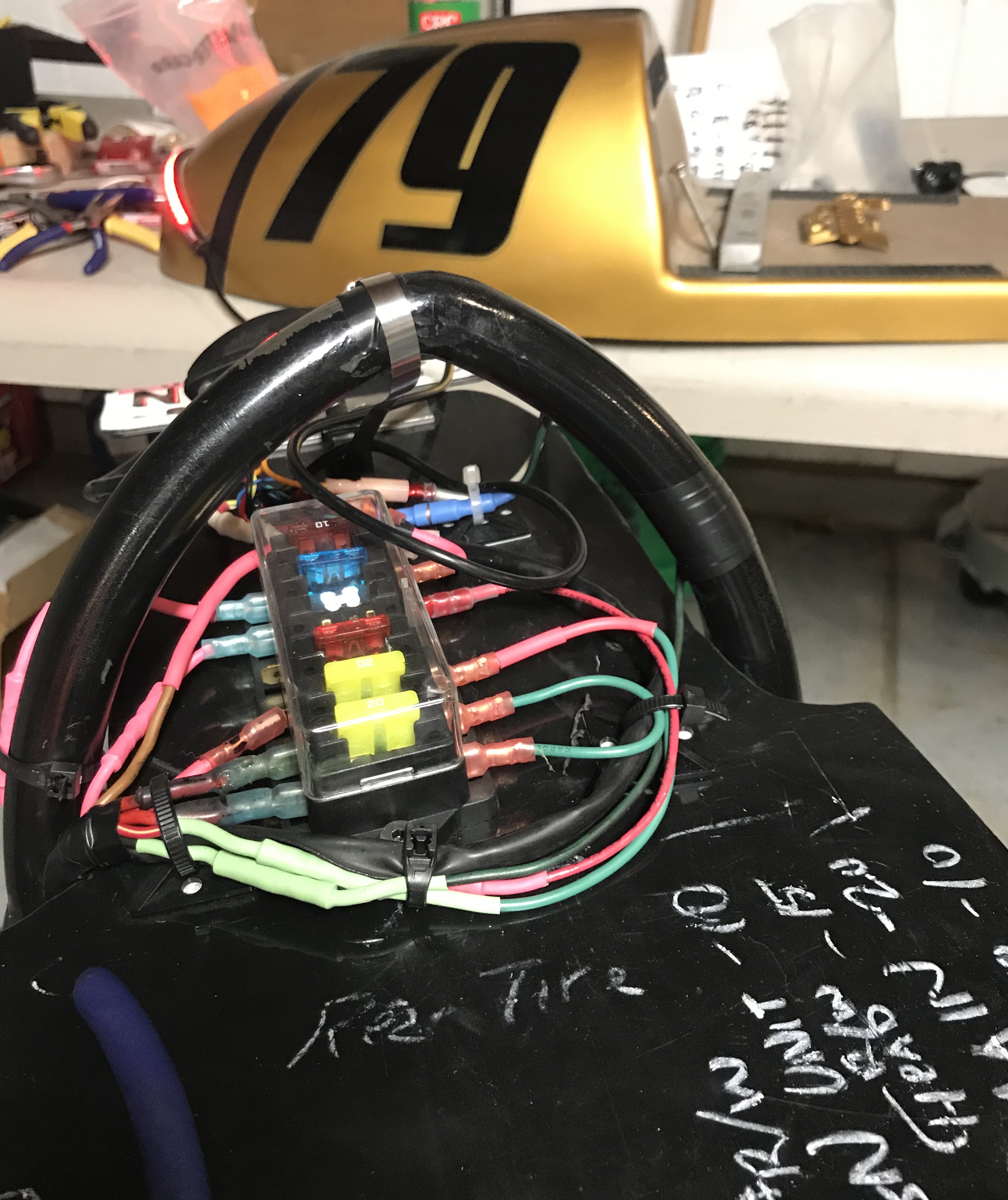

Getting rid of the factory snake’s nest of bussman fuses.

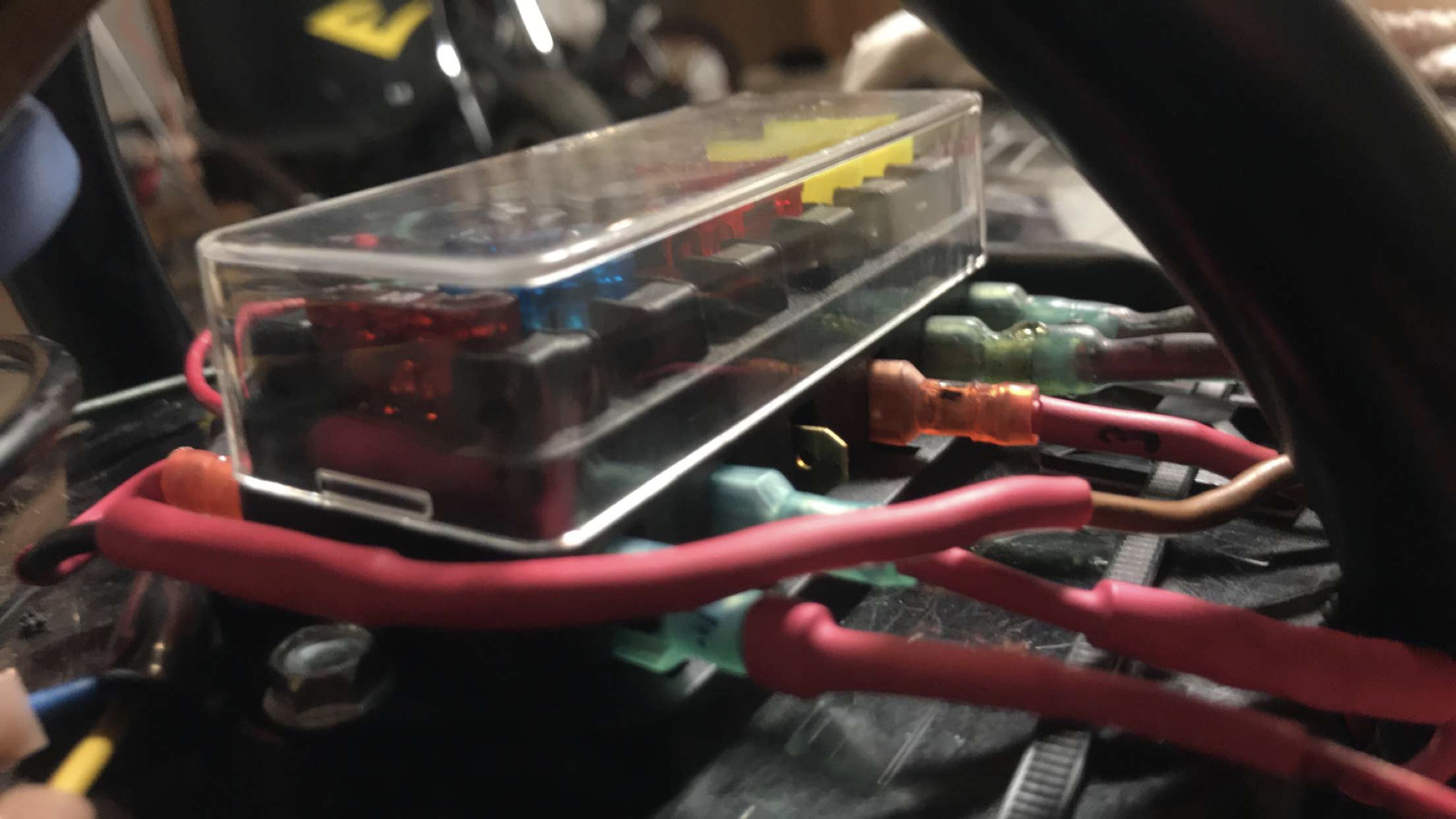

Insulated the rear LEDs.
