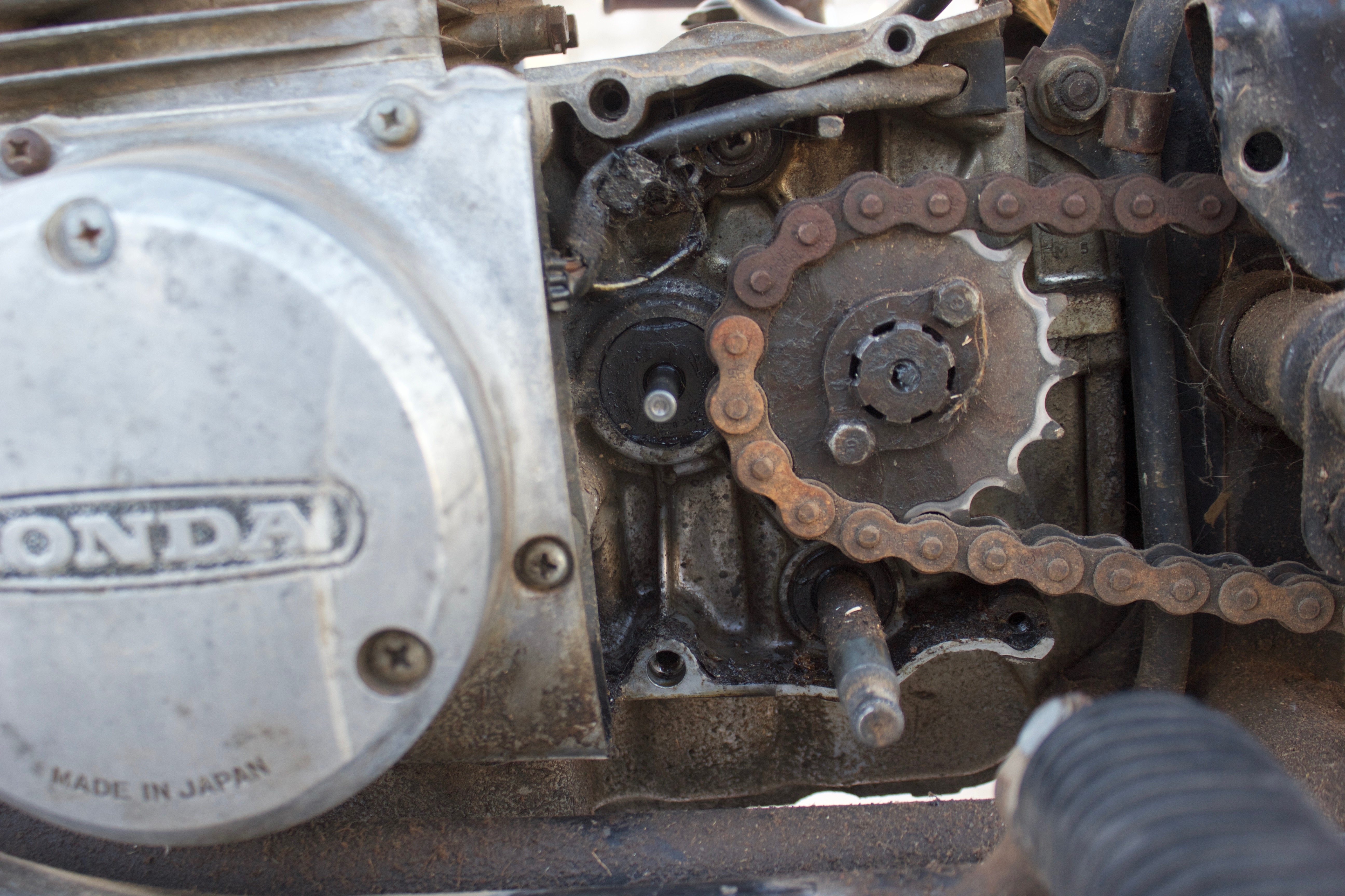

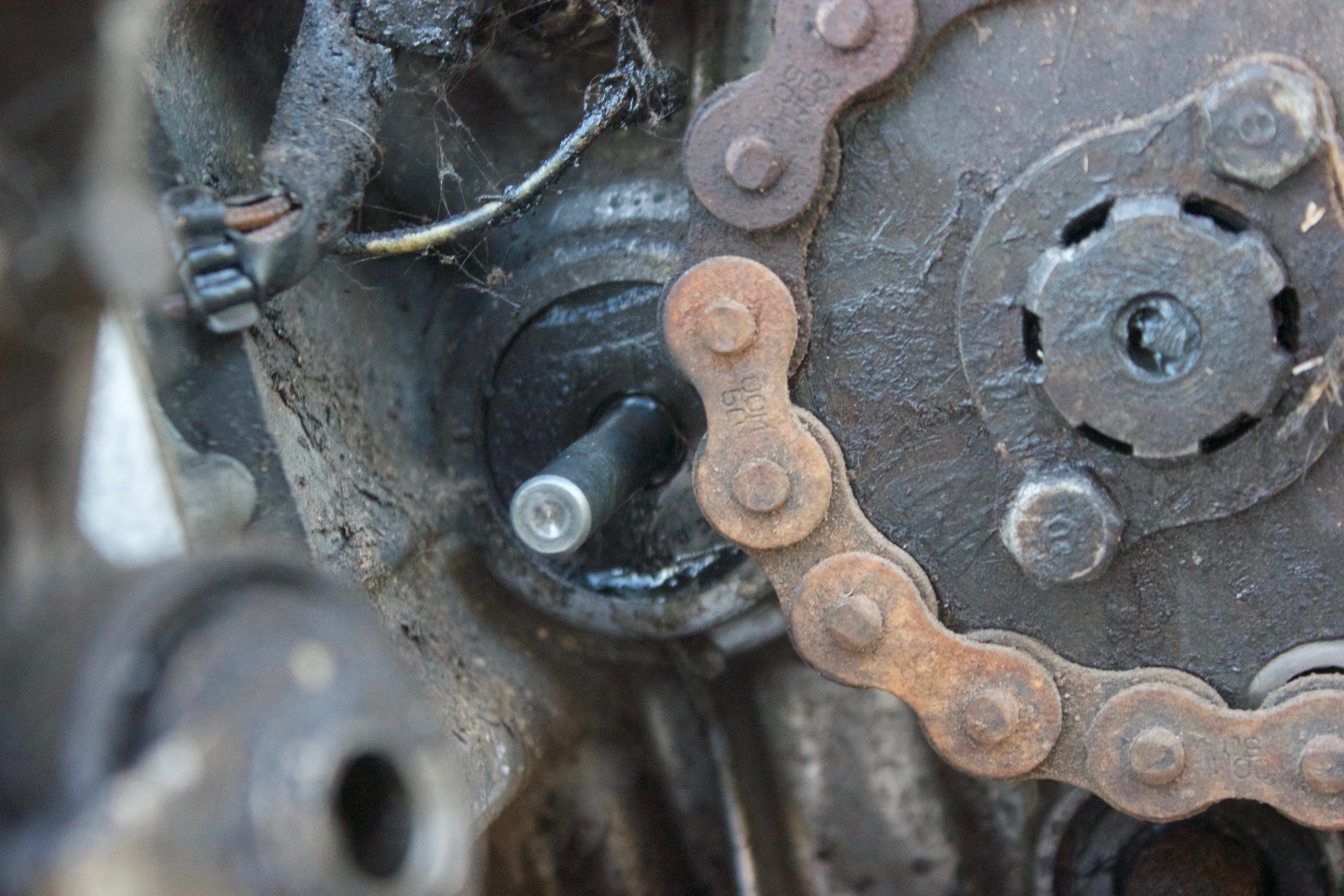

Bike started leaking and i removed the cover. Pretty sure its the push rod seal. My question is how do I remove the seal? Do I pull the rod out and try to yank the seal out?

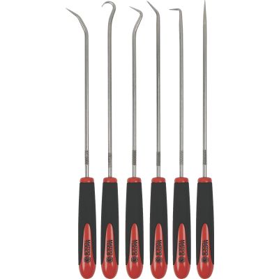

People have used picks like this (or similar):
But when did you lube that chain last time? Looks damn dry to me.
