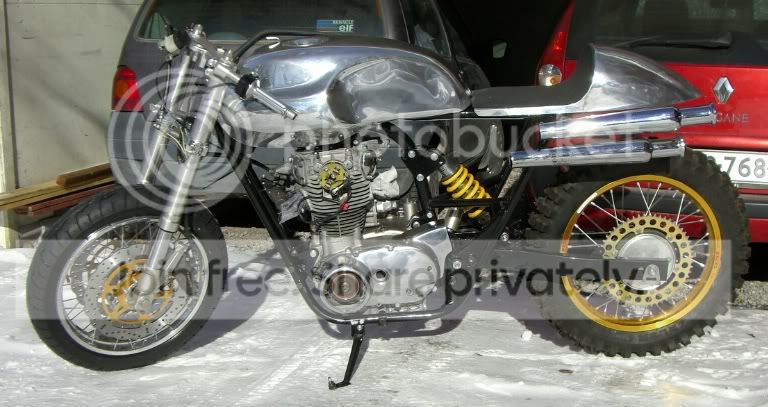

Nothing fancy. first day of Spring so I borrowed the rear wheel from my maico and rolled the yammy outside. Still working on the wiring loom (been painting the switches). Finished the seat, it flips up like a hood and is held in place by a hinge at the front and a single bolt at the back that has a counter-piece welded onto the pan. the whole thing (including the padding) weighs about 2lbs or less. I think I'll start calling the bike Superlite
Anybody know of a good way to remove paint from the rear hub? I've tried paint remover and sandblasting, neither of them worked very well.
god that bike looks sexy.
dot3 or 4 brake fluid works pretty well on paint... in my opinion a bit better then aircraft paint remover, just messier.
