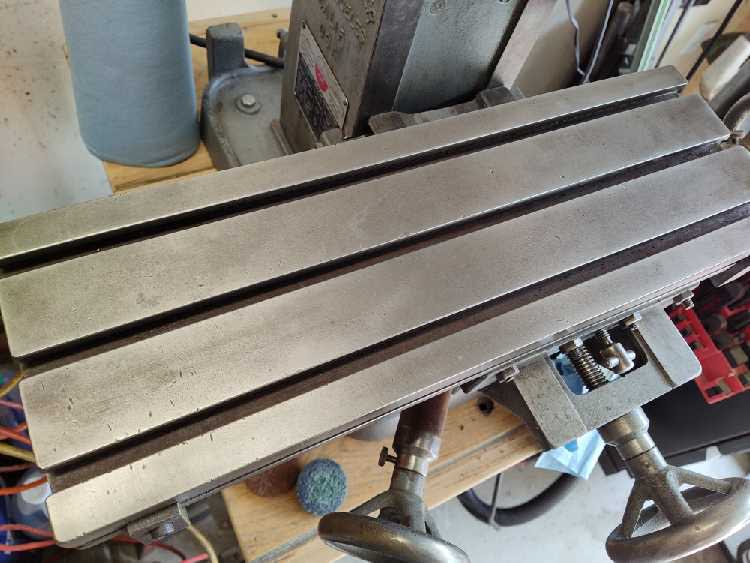

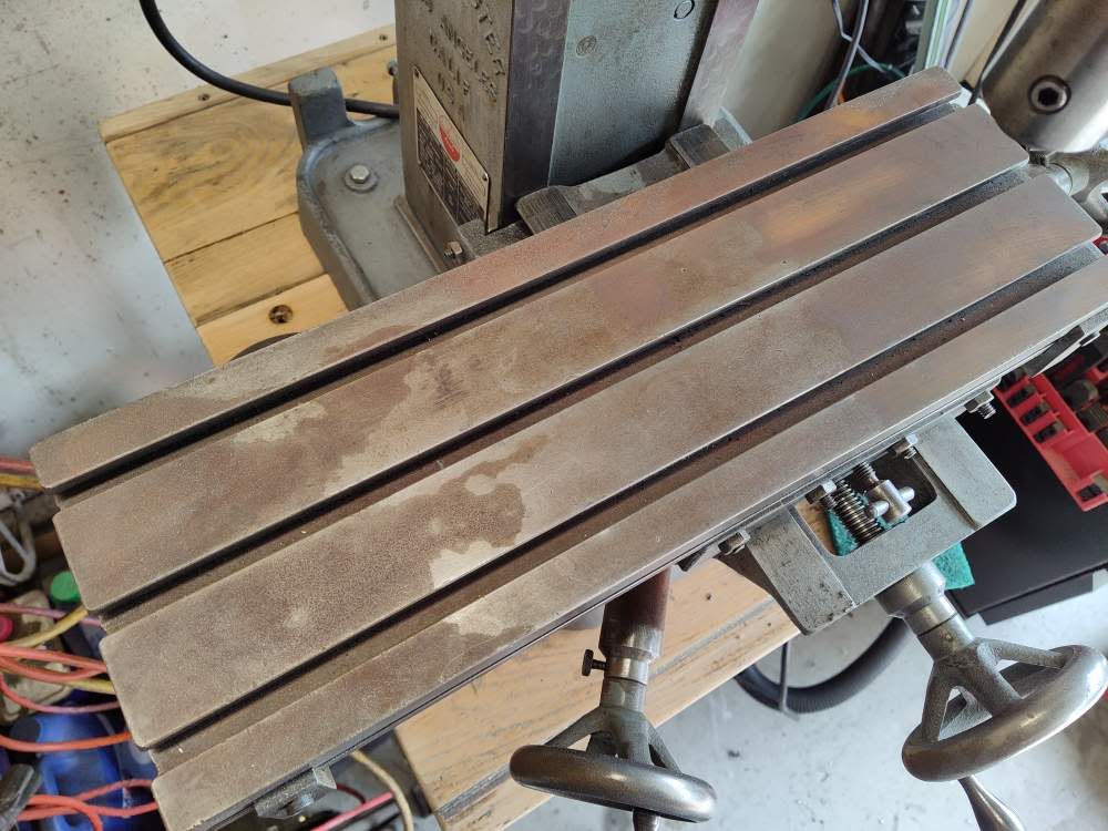

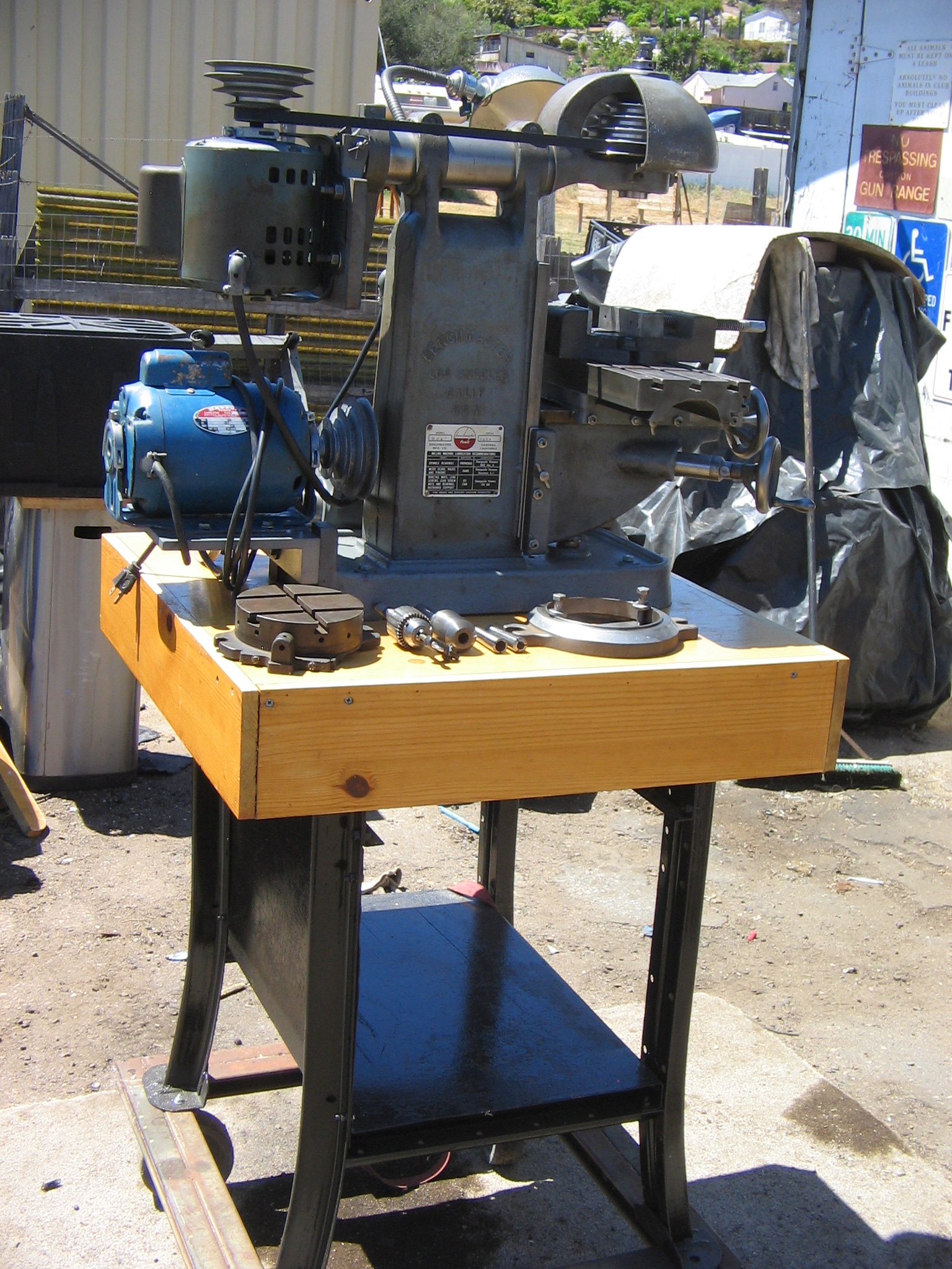

While I struggle for room in the new digs I had to leave it at brother Keith's garage.
It seems it acquired a stand. I may need to leave my tools there more often.
On further review I may need to leave my tools there longer. Keith says he was watching paint dry and got bored.

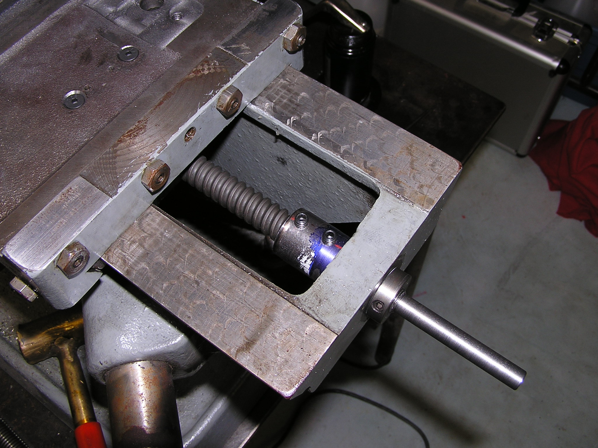

The only difference is Mike used steppers i intend to use servos and close the loop.
With the addition of purpose actuators I'll have the ability to lock all but the working axis for drilling and longer X or Y axis runs. Just a few in/Lbs on the gib locks should be all it takes. I plan on adding pneumatic stays to the Zed to take a bit of weight off that servo.

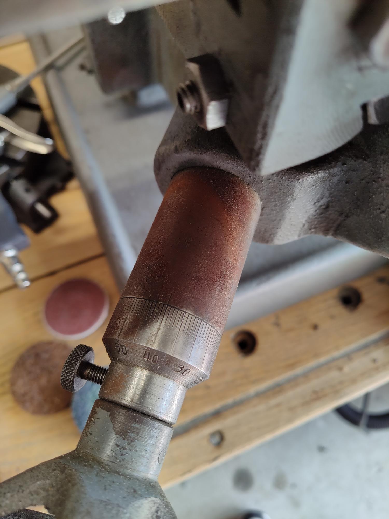

The seals are the hard part. Here's what I did, starting at the top:
Upper Inner SKF 10111 This was a felt seal sandwiched between the upper bearing race and the housing. The seal rides on the 1" OD bushing that goes under the threaded collar.
The replacement is a lip seal that presses into the top of the casting.
1" shaft x 1.98 bore x .46 thick
National 471744
Upper inner seal. This is a lip seal that rides on the smallest diameter just above the transition to the larger diameter that fits the pulley. I found no seal with the correct OD, so I used one a little larger and hand-ground the OD until it would fit the rough bore. I used a seal that was given me by another member and I was unable to find a seal number on it, but I suspect it was the SKF 7573. This was the most difficult fit. The below are my notes.
SKF 7573 needs mod (National 471567) 1.575" OD
Cast bore 1.525" 11878 oversize OD (National 471354)
TIMken 710154 1.5 OD
Lower inner seal. Original is a metal-clad felt seal sandwiched between the casting and the bearing race. The bore is rough and the horizontal outer surface is not flat.
Cast bore 2.05" x 1.180 shaft
30x52x7 metric seal would work
Nat 223035 is the cross from the SKF
I used a Timken seal which was a loose fit in the bore. I'll come back and add the number when I get back from the shop.
Lower outer seal. This is the biggest diameter seal surrounding the working end. It was the easiest to fit.
SKF 15160 was sourced on ebay and fits perfectly

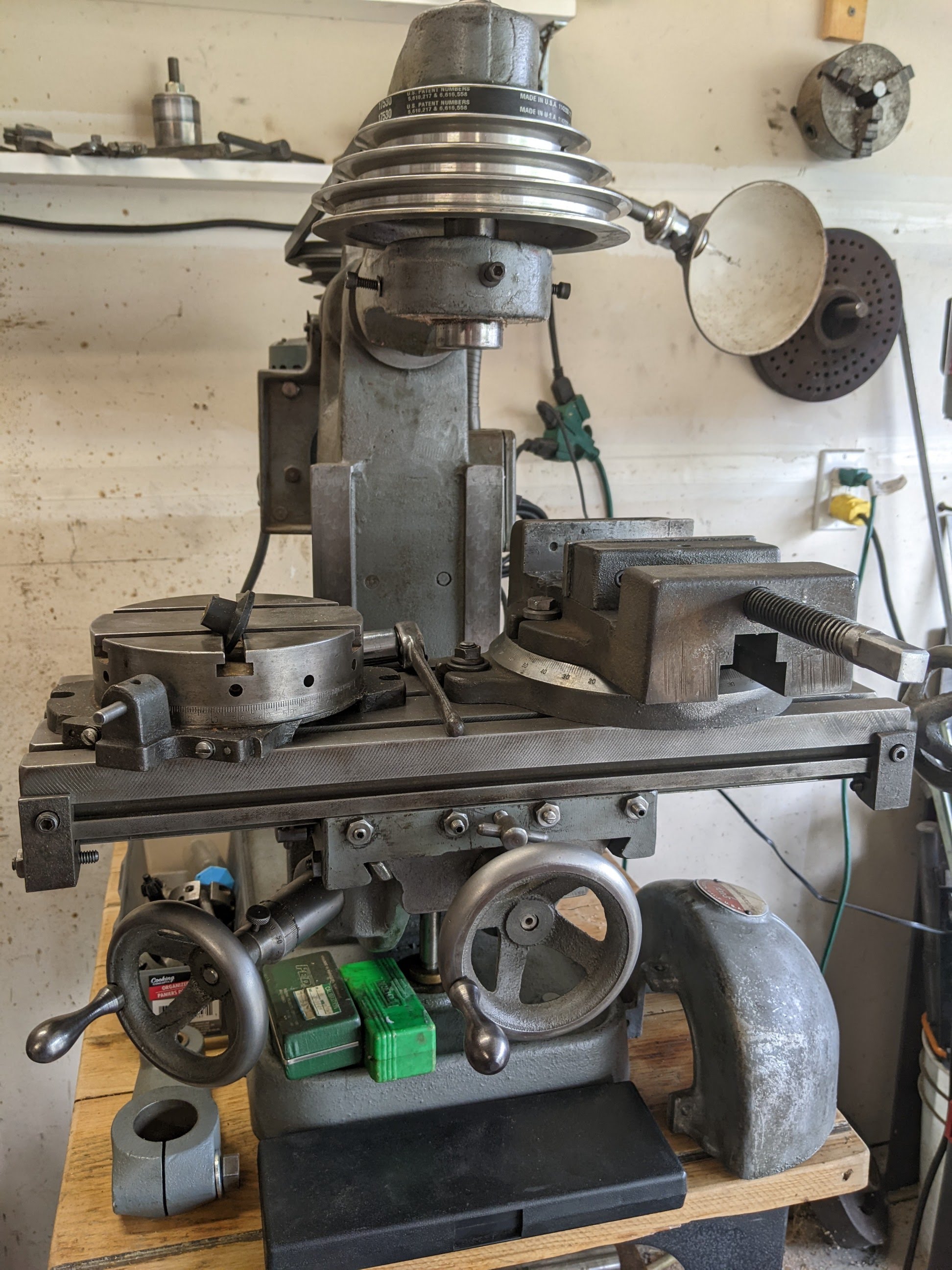

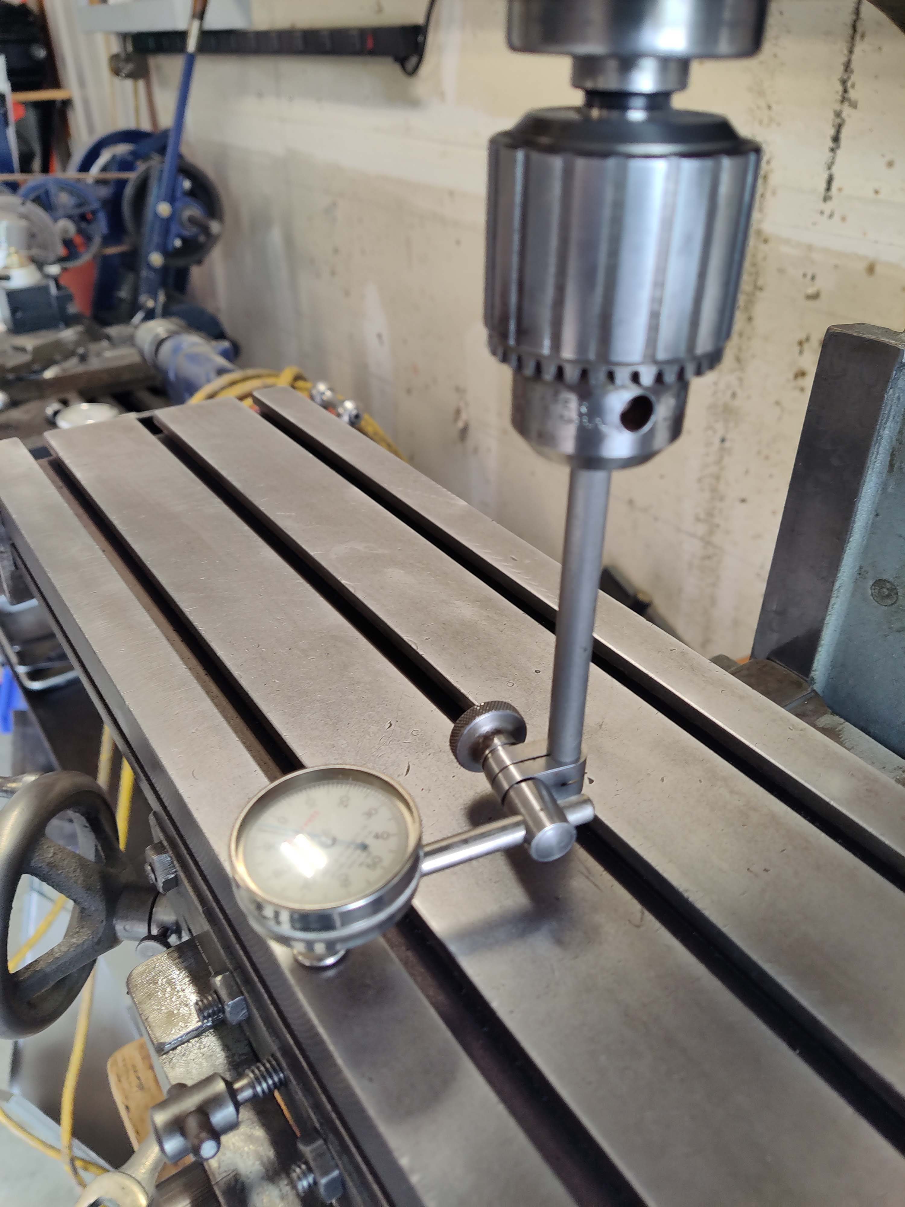

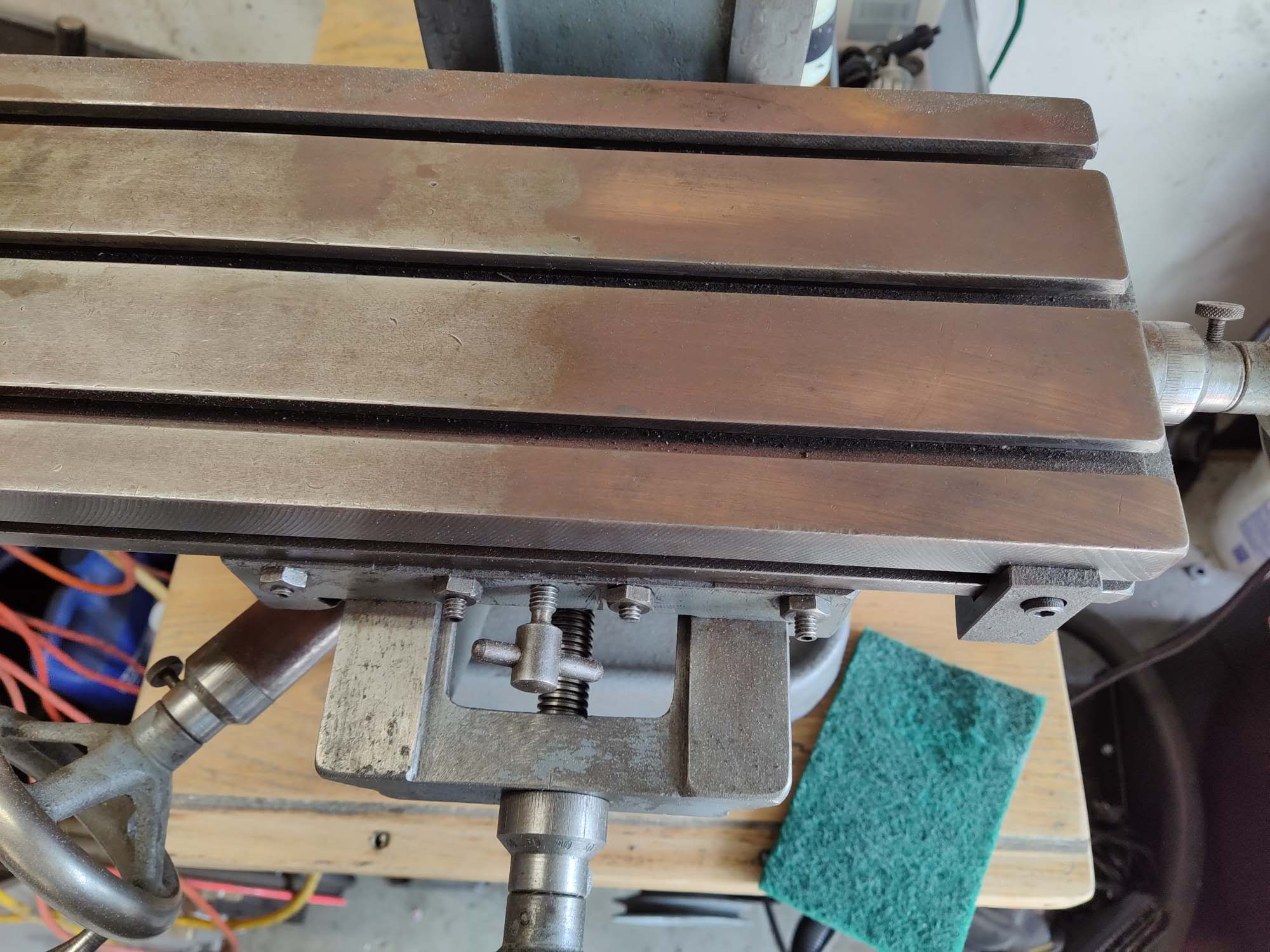

I got the mill trammed in. (not much to do it was very close) and made the usual minor adjustments. I started it up and there were a few odd noises and ...
Just how warm are these bearings supposed to get? Just a few minutes and I couldn't leave my hand on the top of the spindle. I'm getting some heat off the bottom bearing but the top bearing gets positively hot.
I'm no stranger to proper bearing preload. Am I missing something here? Is there a one lube to rule them all?
I had dial indicators on the top and bottom of the spindle. I counted down from .002" , .001" , .000-something then barely 15 degrees on the preload collar. Heat, and lots of it.

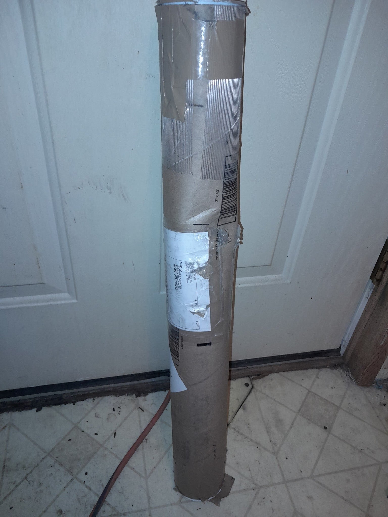

UPS tried to kill the ballscrews. Good packaging saved them.
still waiting on the ball nutz.
