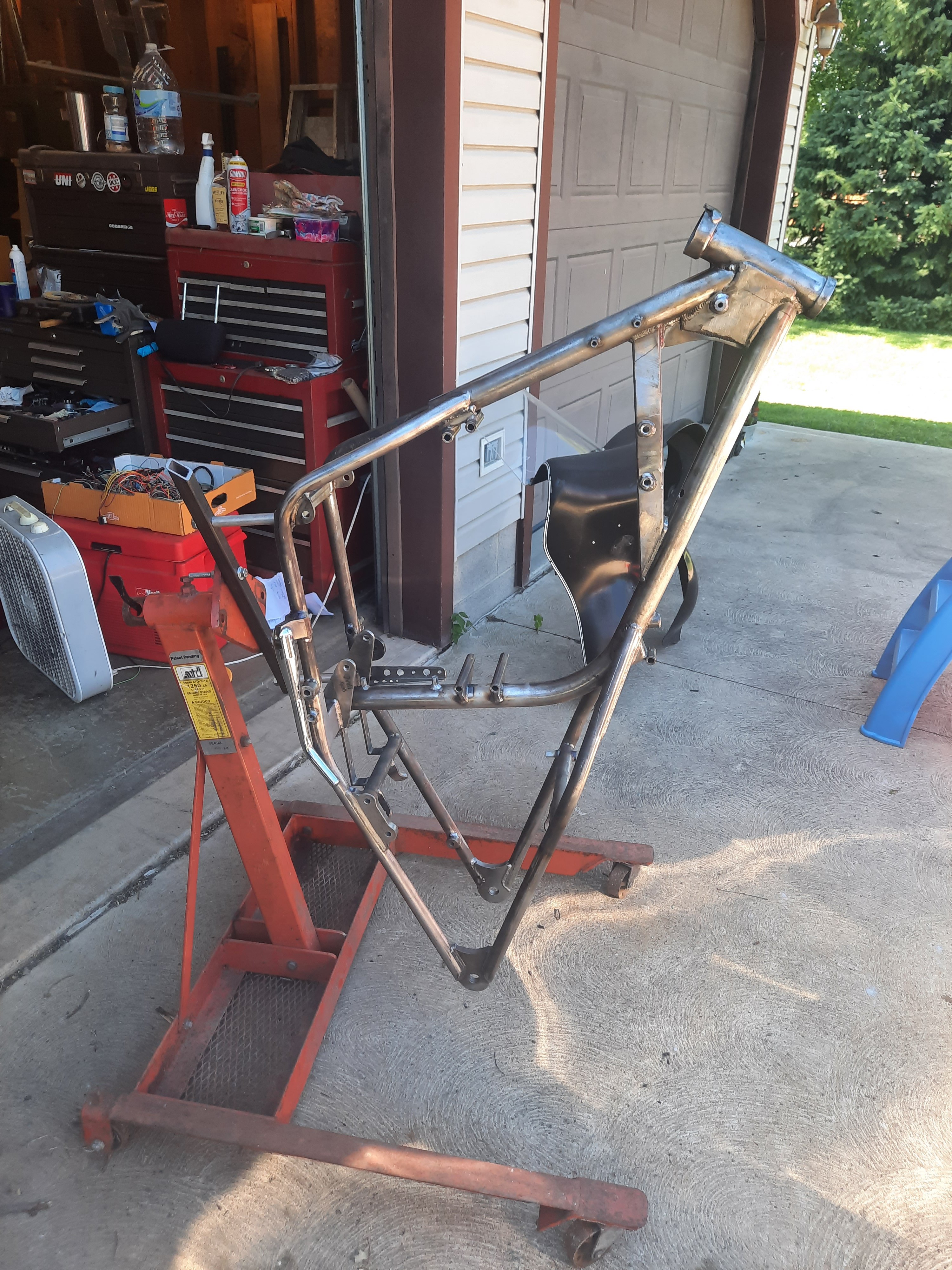

I decided to go ahead and paint the frame while everything was apart. If something needs fixed or modified, I'll Sand the paint off, fix it and spot paint it again. Used etching primer, sealer primer then duplicolor wheel coating. It's supposed to be tough as nails and they had it in the burnt orange color I wanted. Supposed to be hot for the next few days, so it'll sit in the shop and cure for a bit.
Also, a simple bracket to mount a frame to an engine stand makes all the difference when painting.
