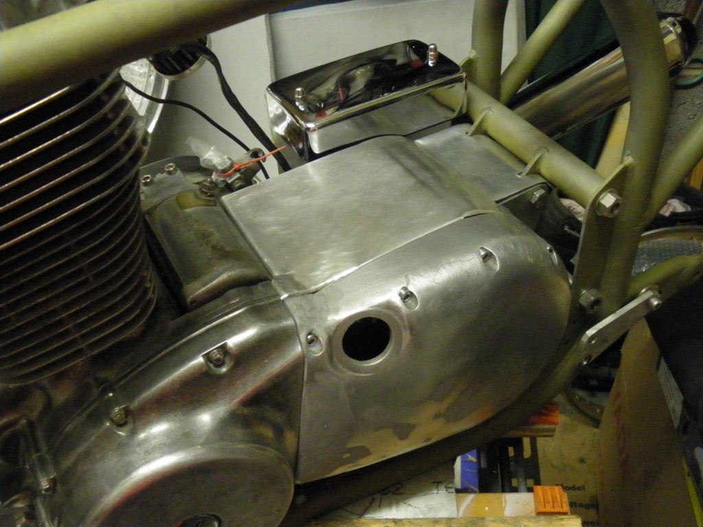

That paste-up was the original visualization for the Manki, an LS650 in a Norton Featherbed frame. The guy who built it did a great job of disguising the engine's length with a faux "primary case" enclosure on the left and strategic battery box placement on the right. Unfortunately, that's not a great solution from an engineering point of view, because the countershaft sprocket ends up so far from the swingarm pivot that maintaining proper chain tension with any sizable amount of rear suspension movement becomes rather problematic.

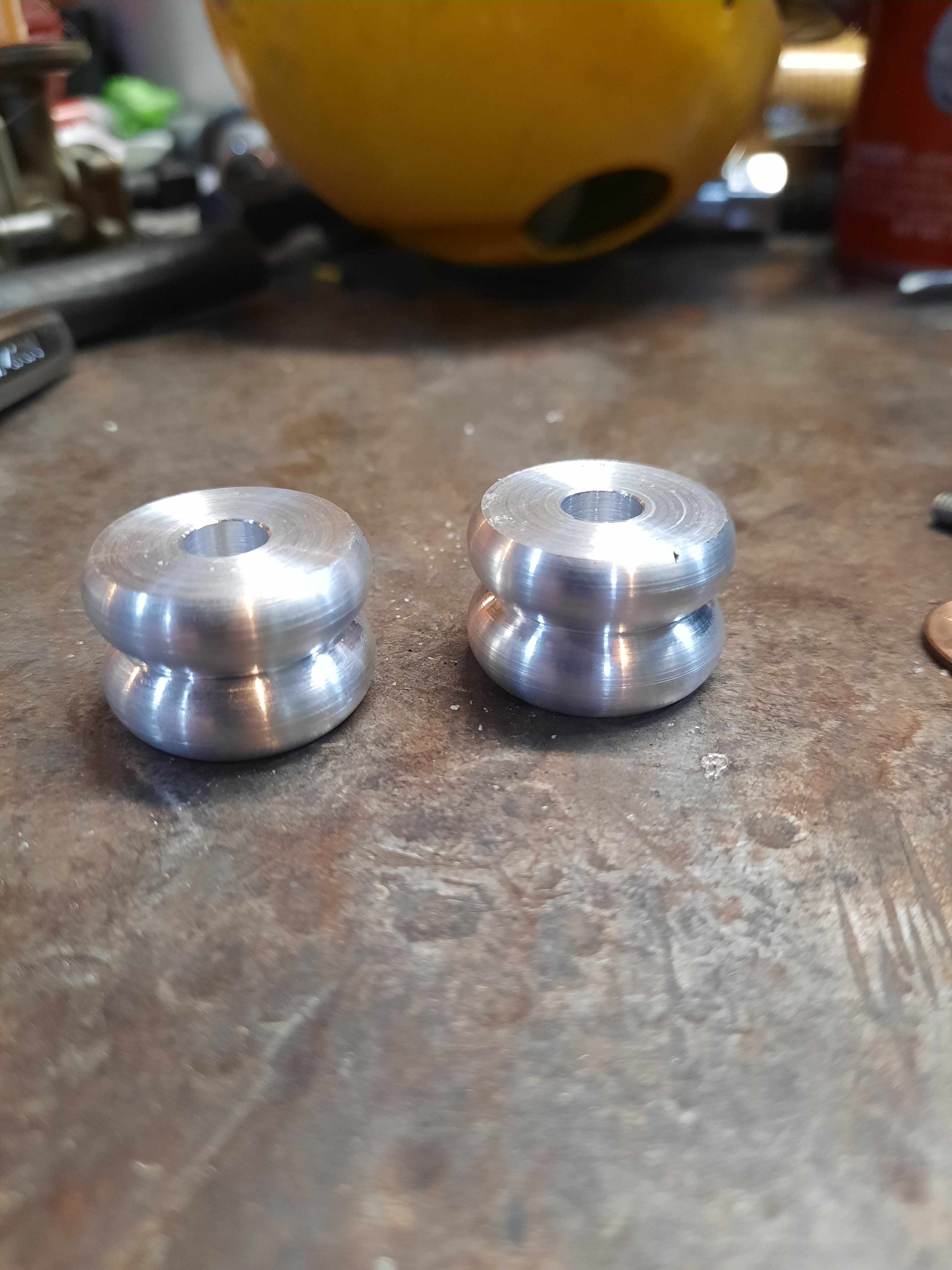

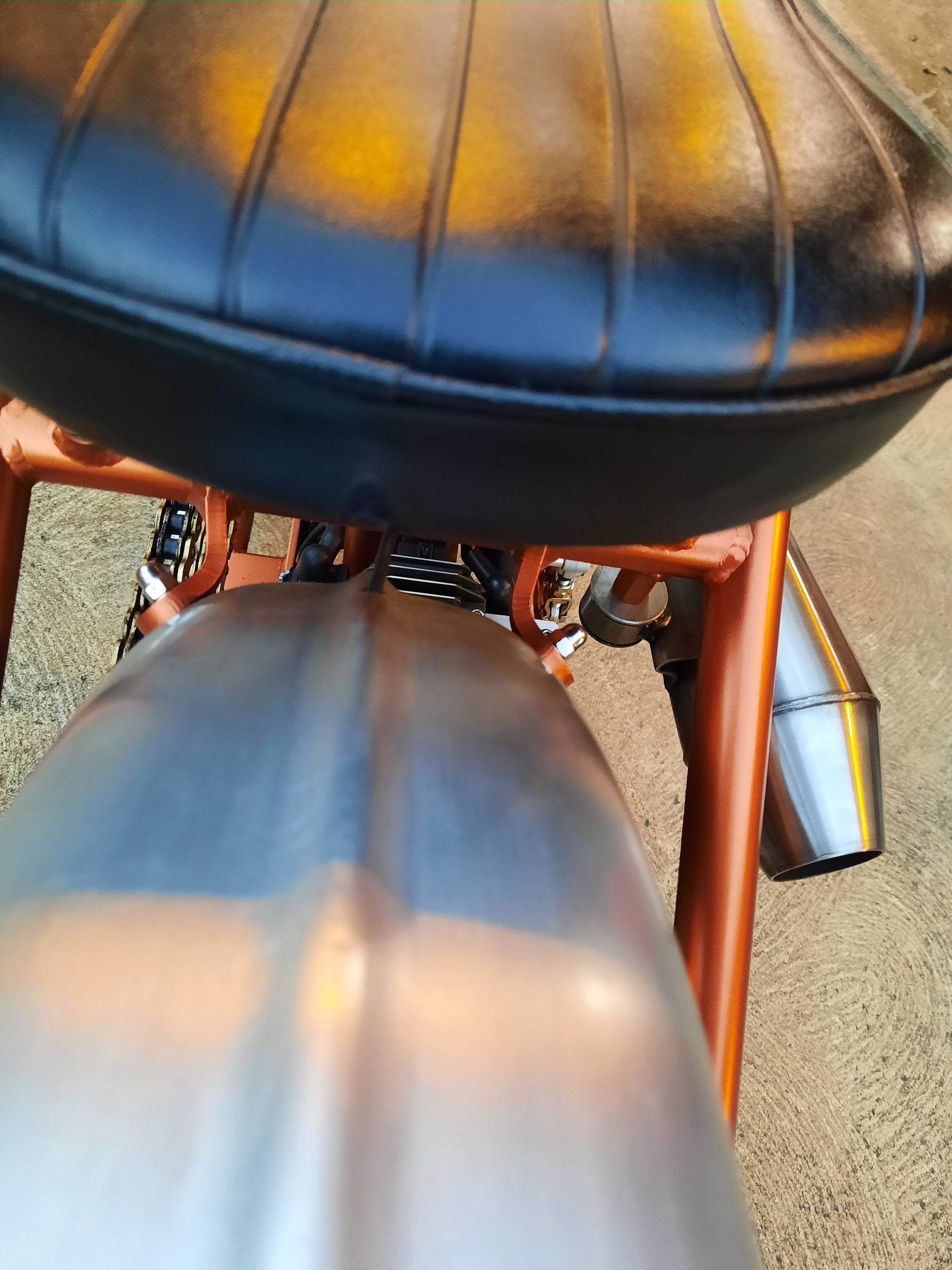

Working through a few bugs after a couple hundred shakedown miles. The seat ended up being mounted a little too low in the rear, and with my 240 lb self along with my backpack to go to work, the seat was hitting the fender rib. On top of that, without much of a lip on the back, the pumper carbed motor was pretty constantly trying to yeet you onto the fender on acceleration and my arms were getting tired from trying to hang on haha I made up a couple of quick spacers that brought the back of the seat up about an inch. It's been raining all afternoon, so I haven't gotten to do a test ride, but I think it should solve the issues.
