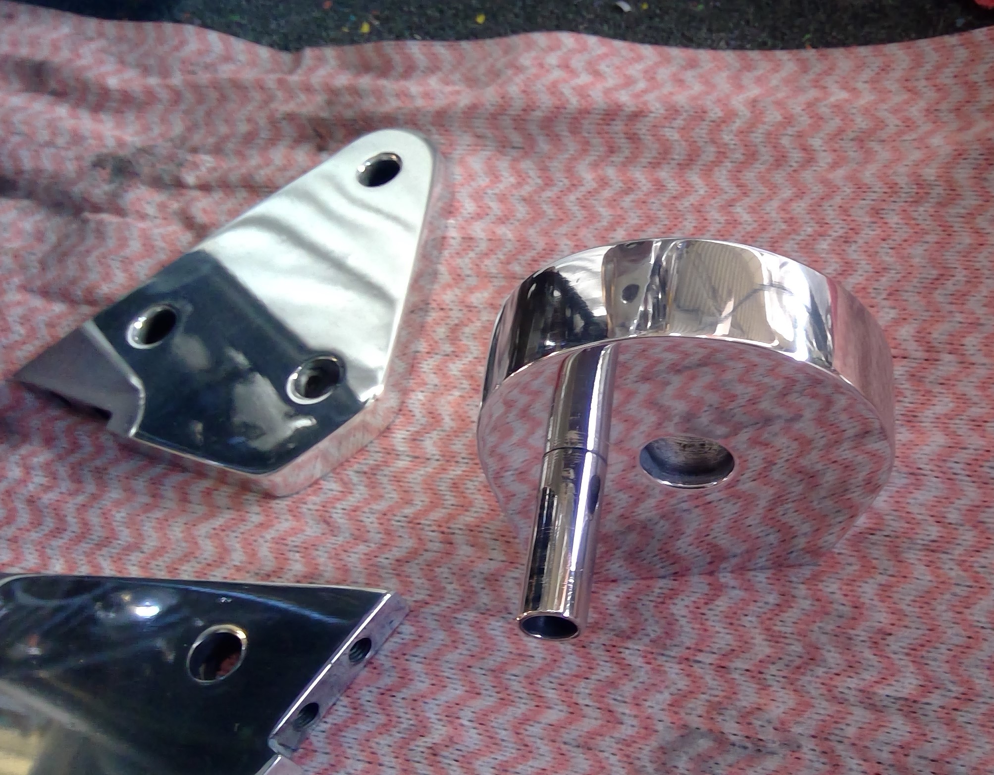

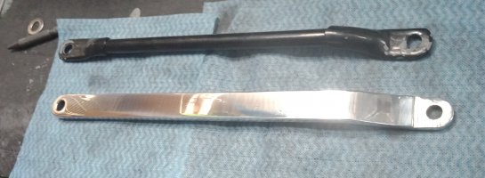

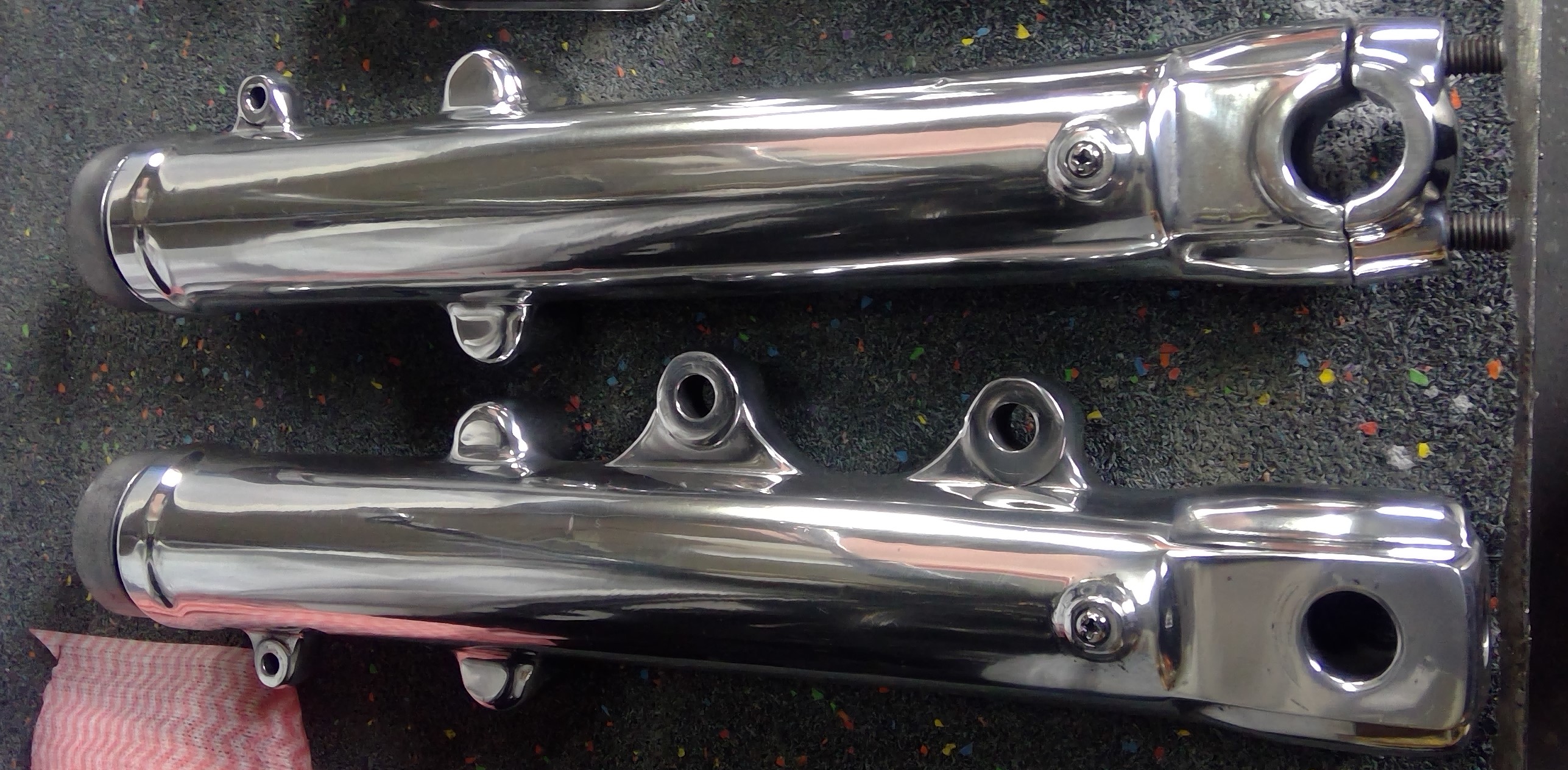

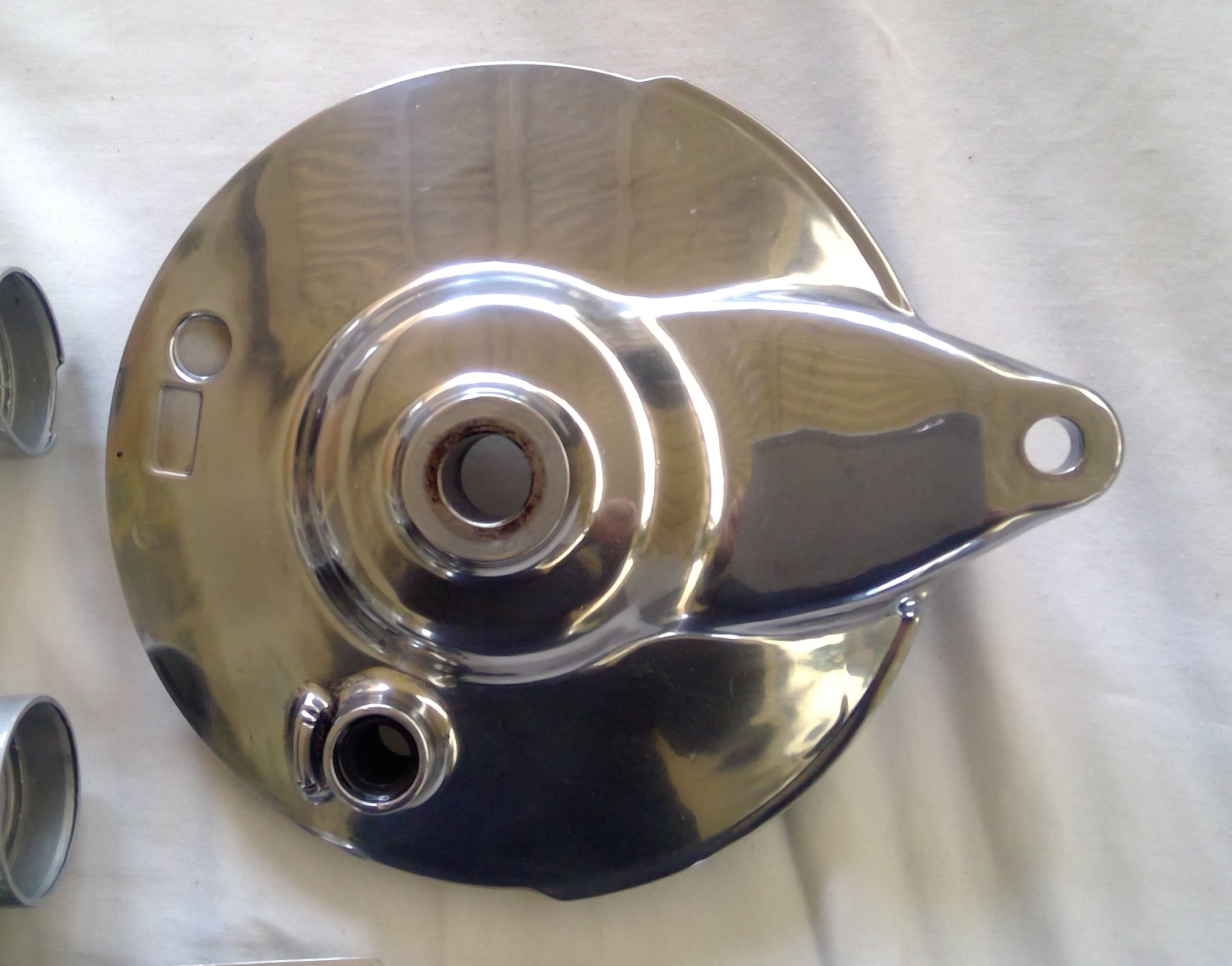

A few bits I polished. Either made in my workshop or modified for one reason or another.

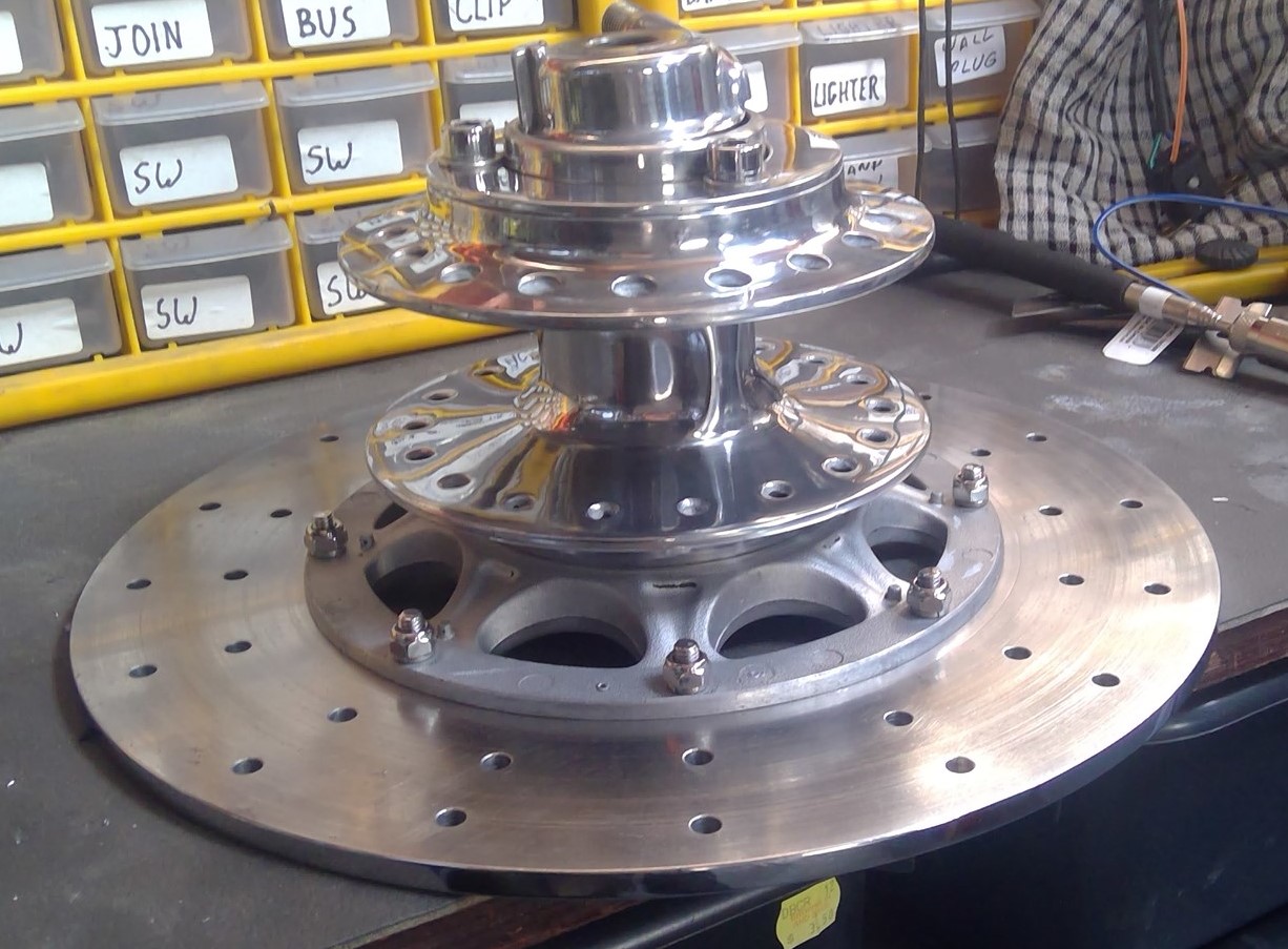

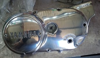

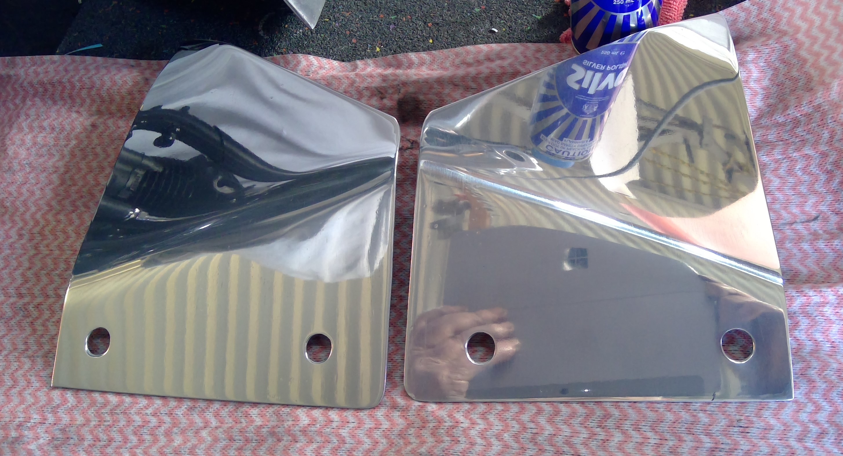

A few more bits.

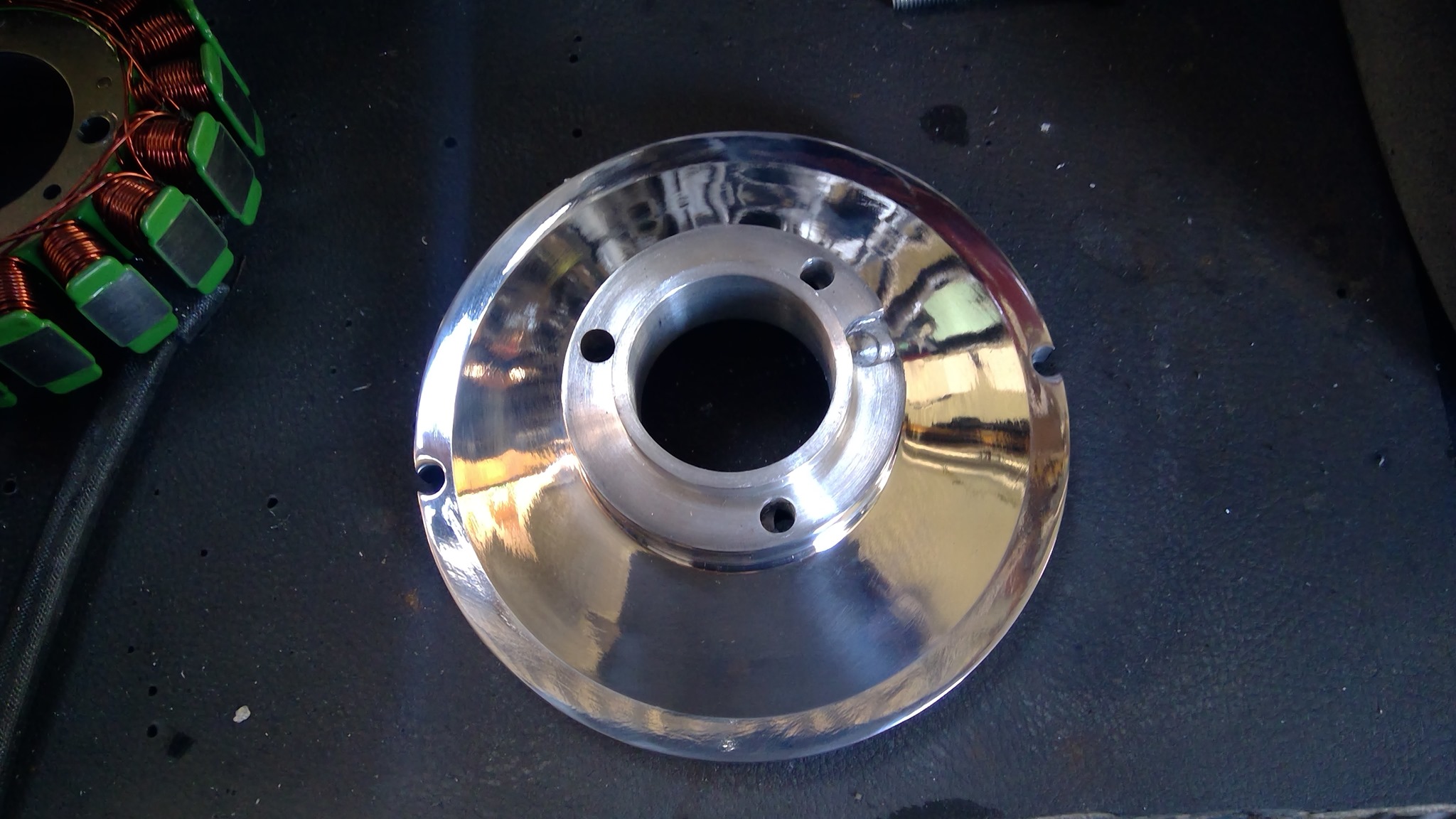

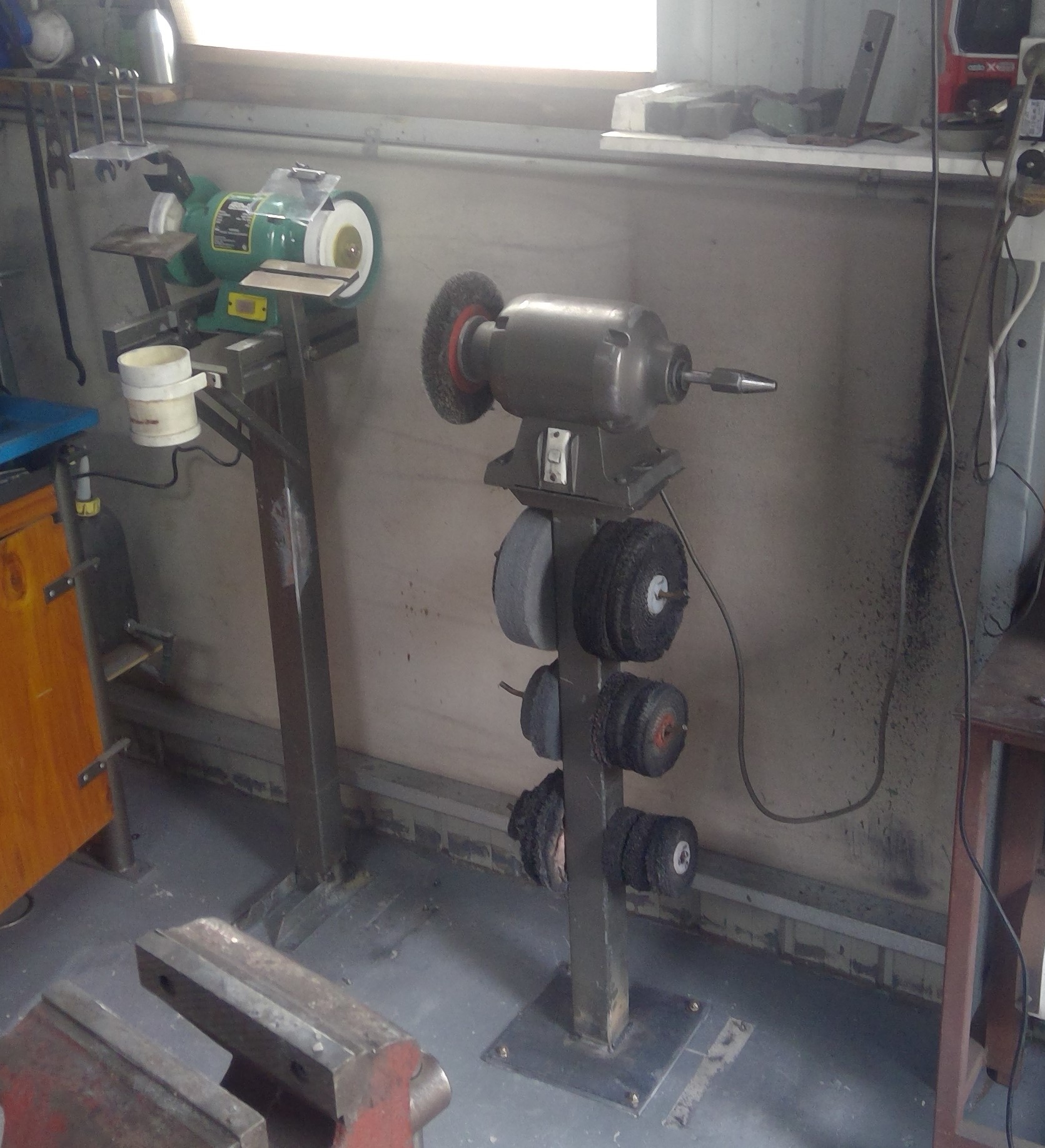

Sewn sisal, sewn cloth, loose leaf and finish off with swansdown mop. Black compound with sisal, white with cloth and green with swansdown. I use an 8" GMF grinder I bought 45 years ago, converted for polishing.

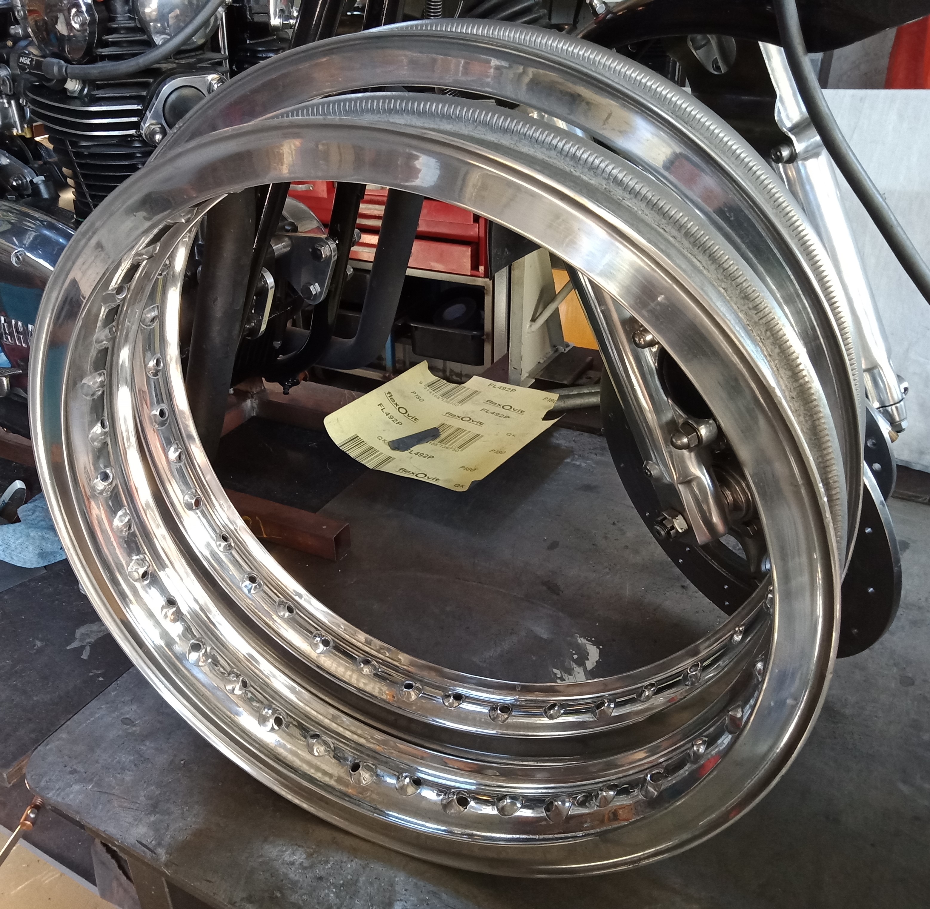

All looks good.
Wheel rims can be a real pain when they haven't been cleaned for years, left out in all weathers and the brake dust/water mix has eaten well into alloy.
Even with a proper polisher and narrow sisal wheels it takes a while.

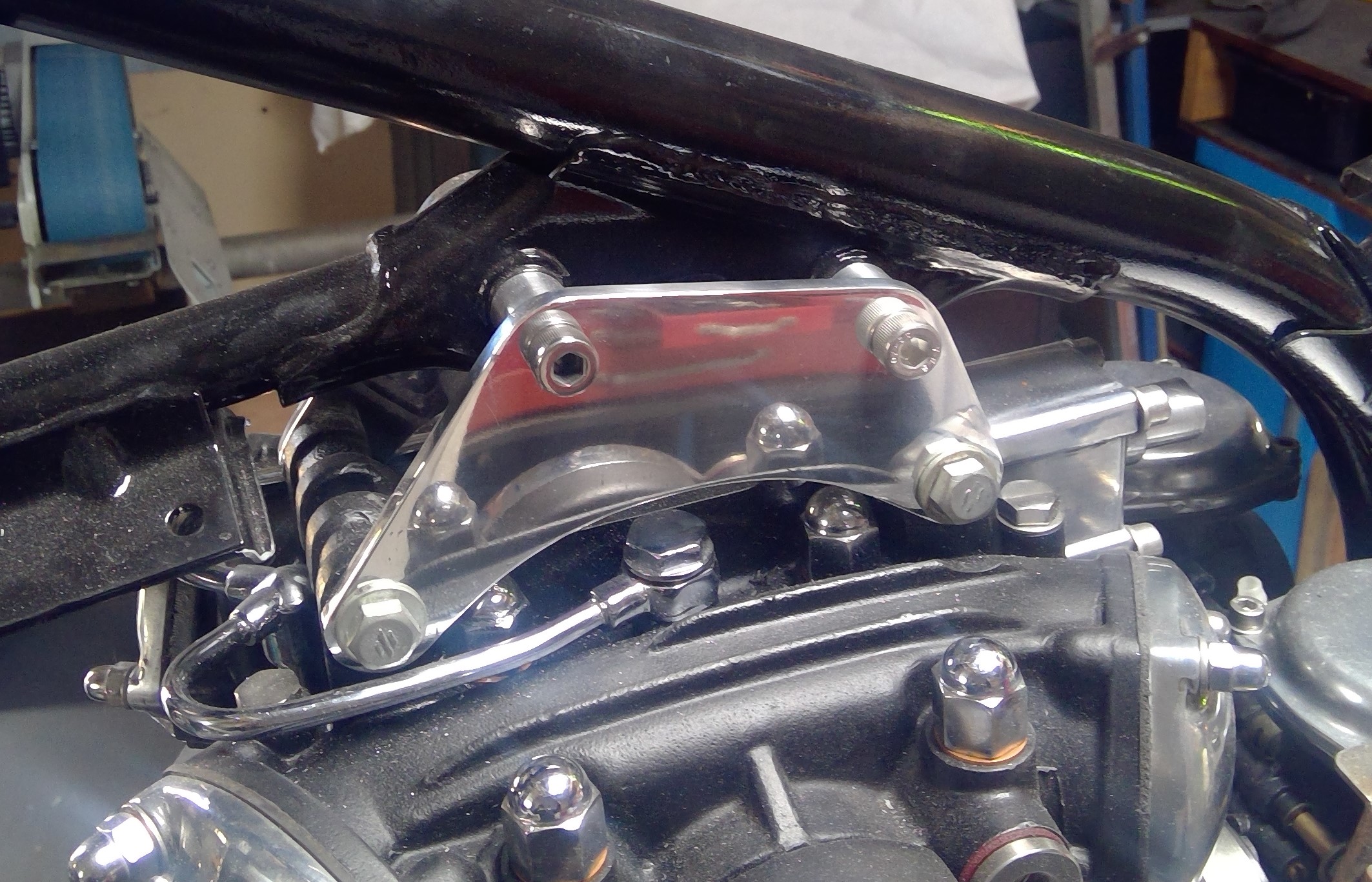

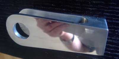

Top engine mount looks good, did you use 1/4" plate or thicker?
