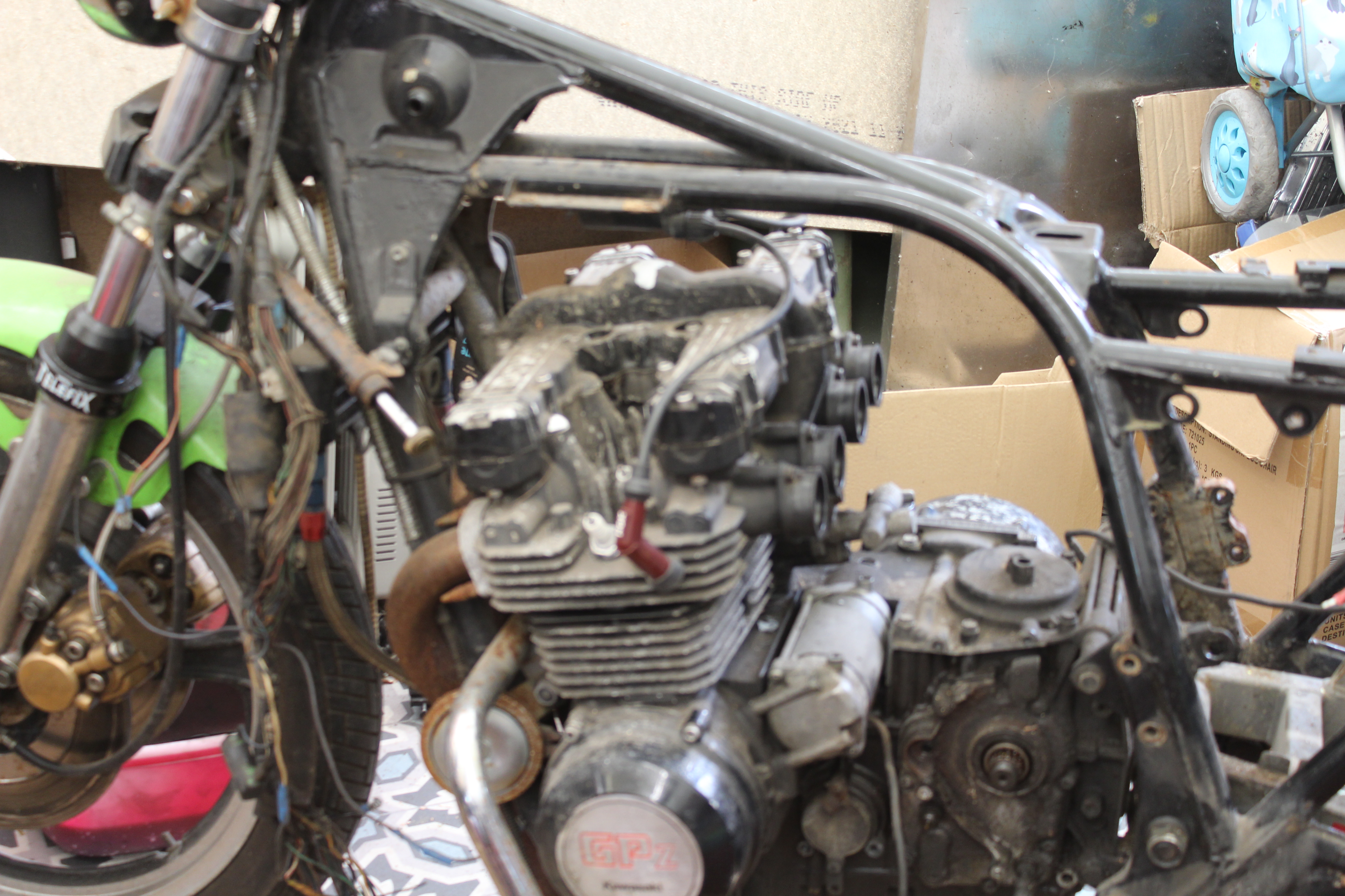

Well, the old 750 engine, which hadn't been run for more than 24 years, was bought by an idiot.. me !
As it would be needed for my own project for 2024.

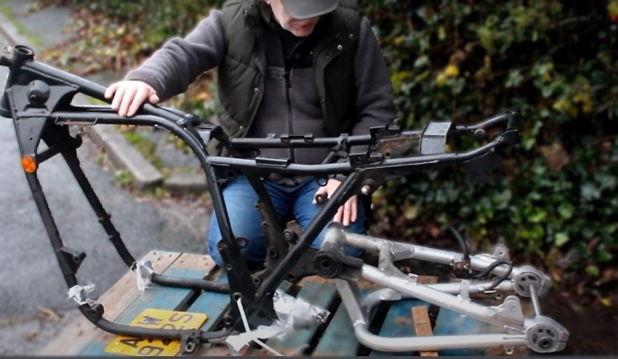

In early January, I bought a frame for a 78 Z650, which most importantly had its logbook/V5, something that's needed in the UK to allow a bike to be used on the road.
I didn't buy a complete bike, as last year I had restored a similar 650 back to (almost) standard, so this new project would be very non standard, with everything being changed, there was no point buying a complete bike. At the time the only other part I had for the project was a swing arm from a ZXR1100..

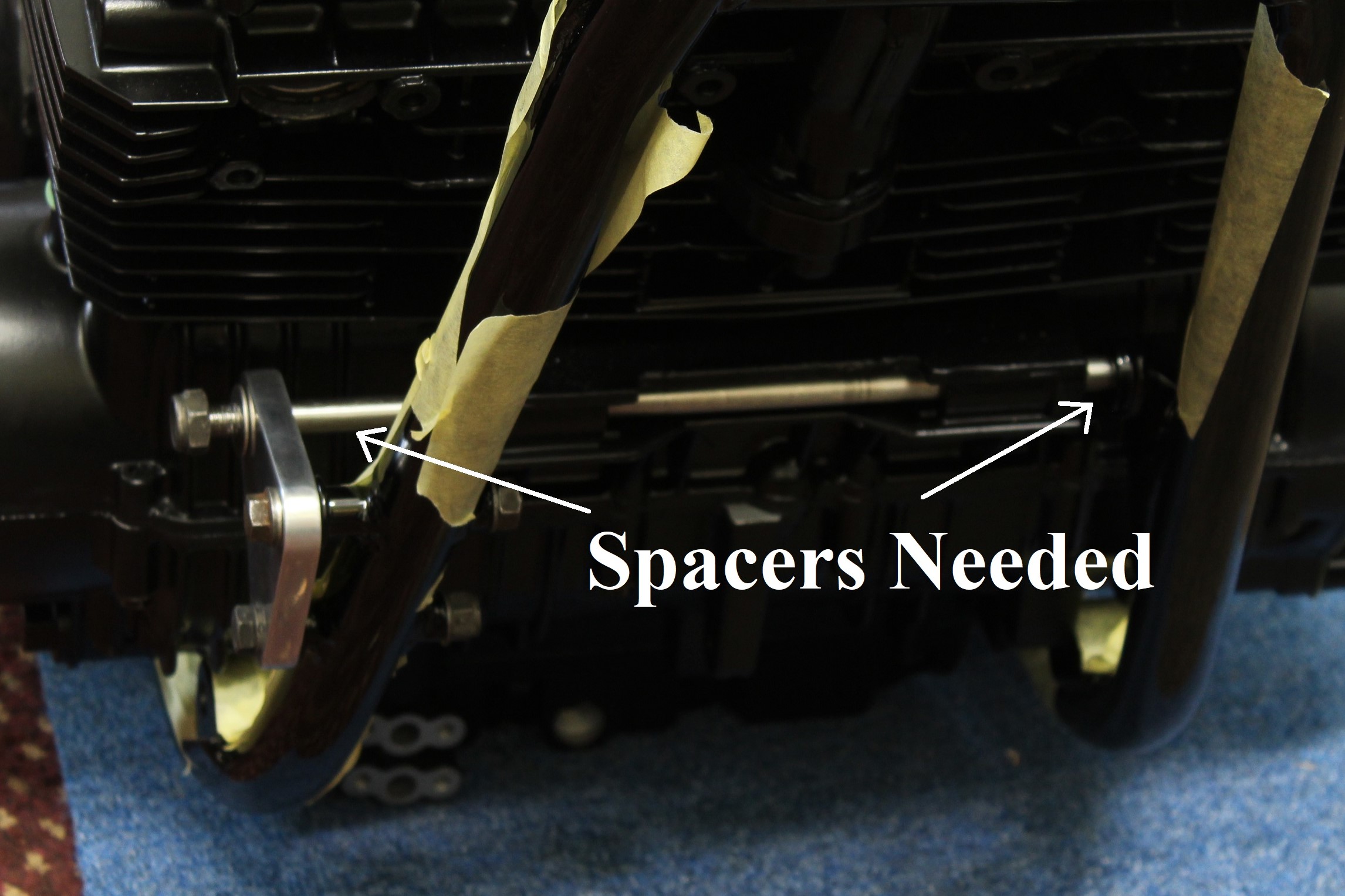

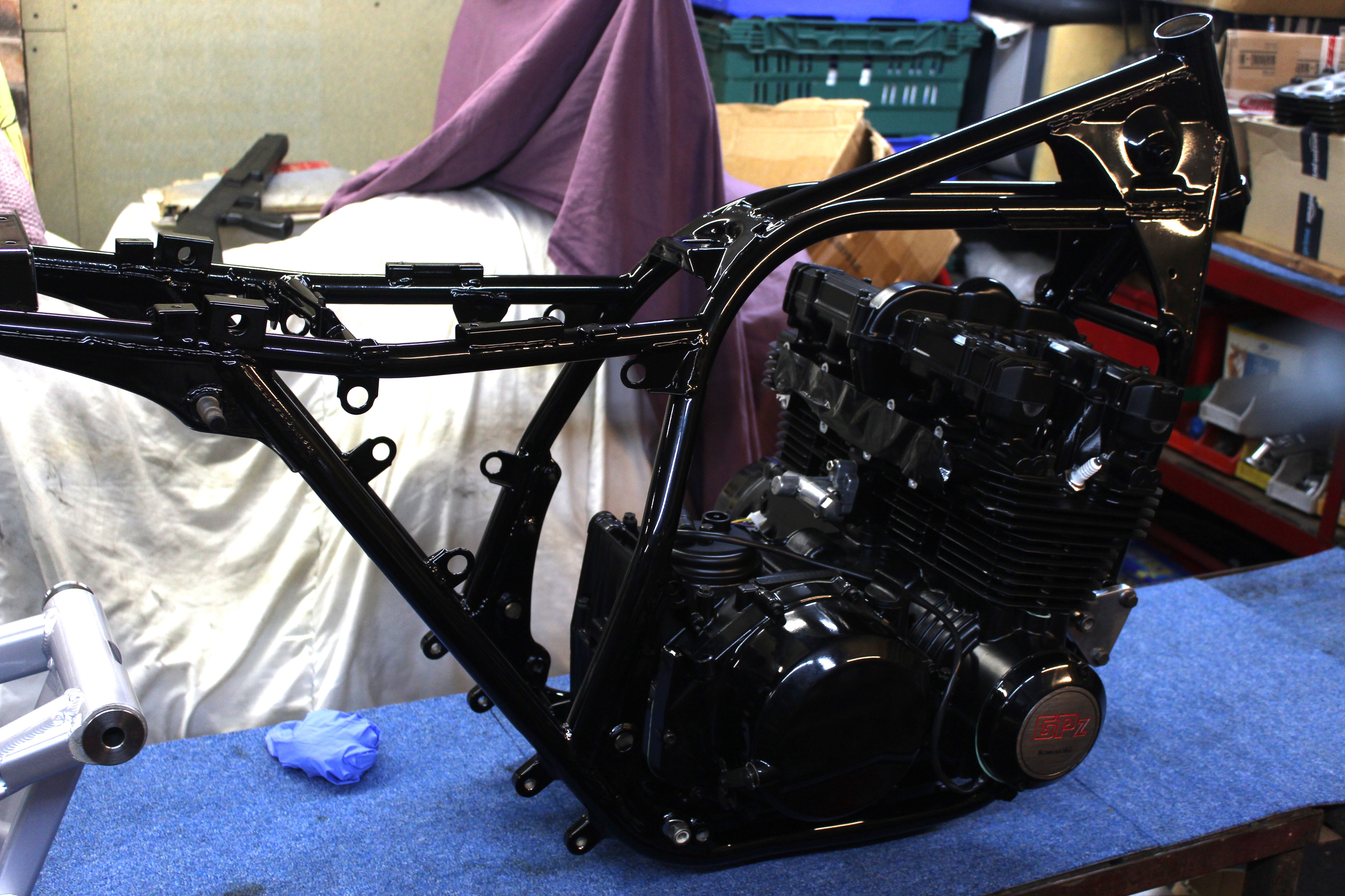

Stainless engine bolts were made for both bikes, along with thick 10mm alloy engine brackets. The GPz engines have slightly different engine mounts compared to the original 650 engine, therefore spacers were machined to make everything work as it should. The engine is solidly mounted into the frame now, with the rubber mounting on the front of the engine eliminated.
With some bracing the frame was powder coated and the new turbo engine bolted into place..

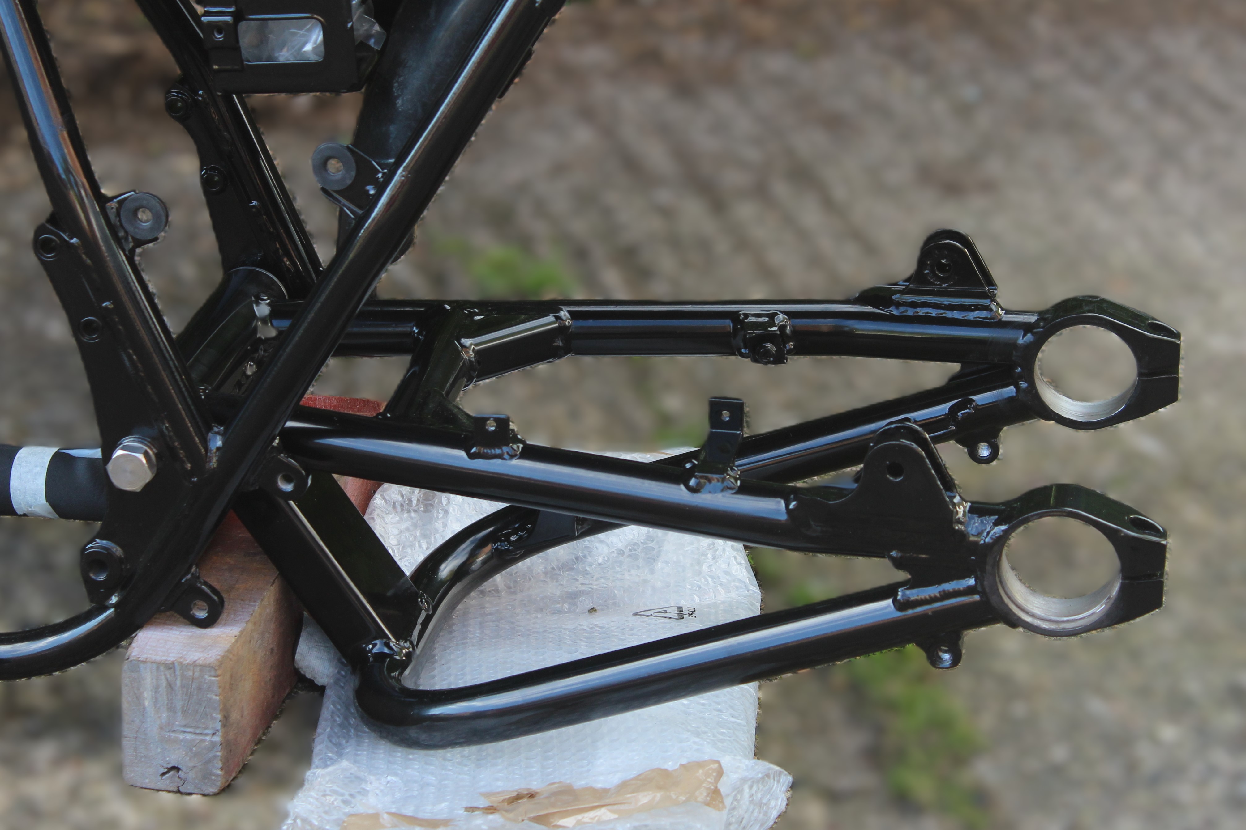

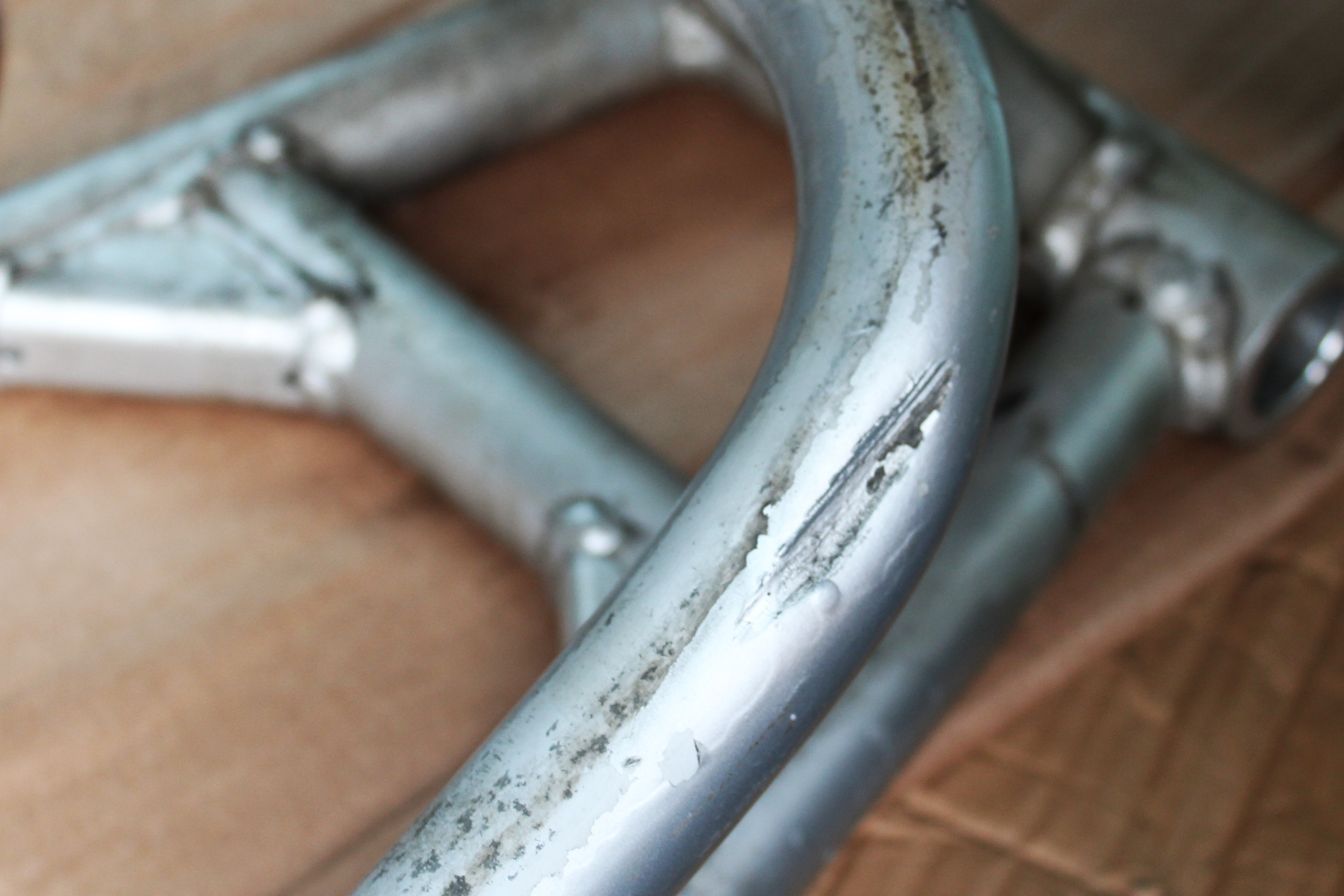

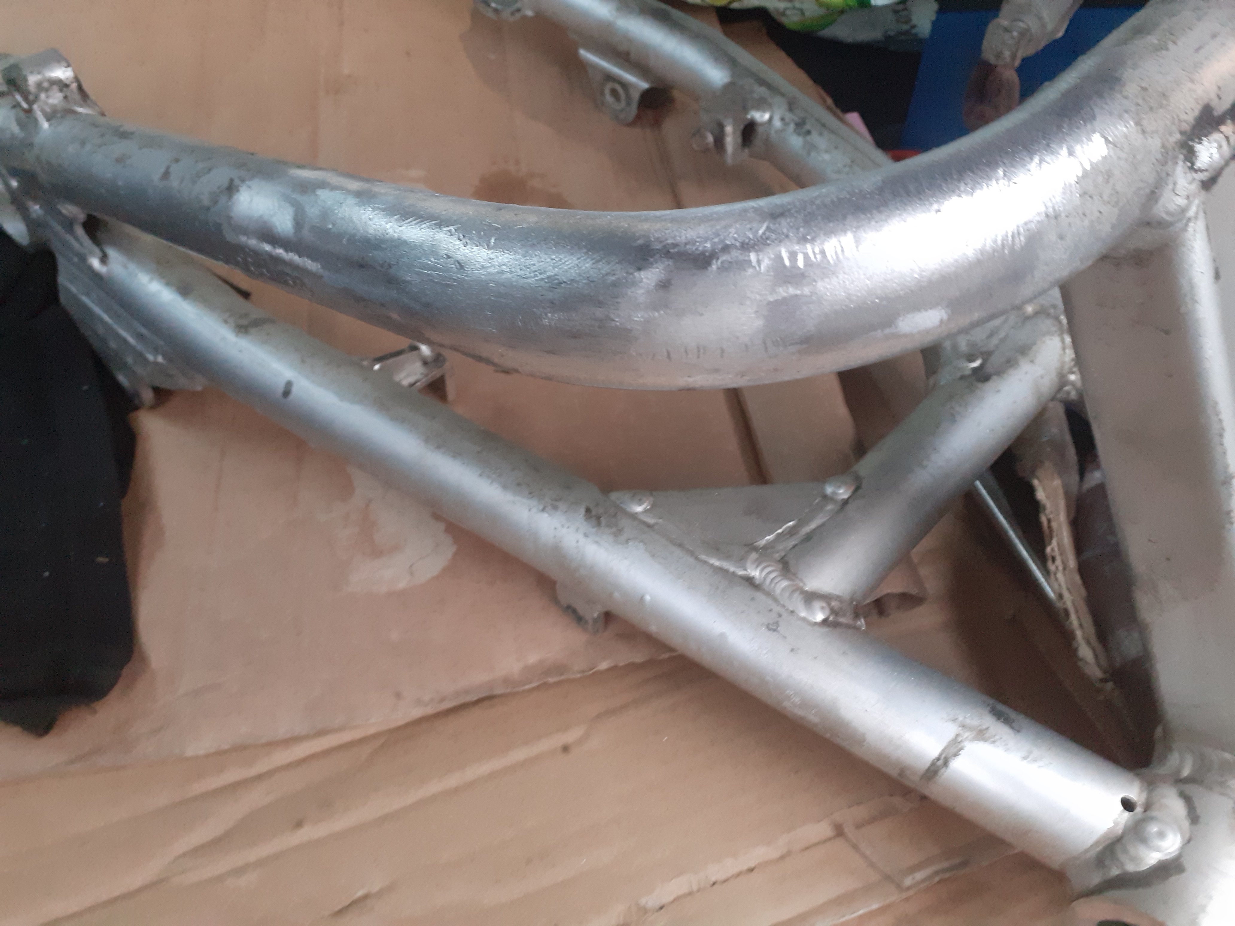

Meanwhile in January my own project got off to a slow start as I spend hours on Ebay hunting down all the many parts I'd need for my own build. With a good tank being particularly difficult to source. But some damage to the alloy ZRX1100 swing arm was repaired, and some welding was done on the frame, to add various tabs, and remove unwanted brackets etc. Then the frame and arm were sent off to be powder coated, both gloss black.

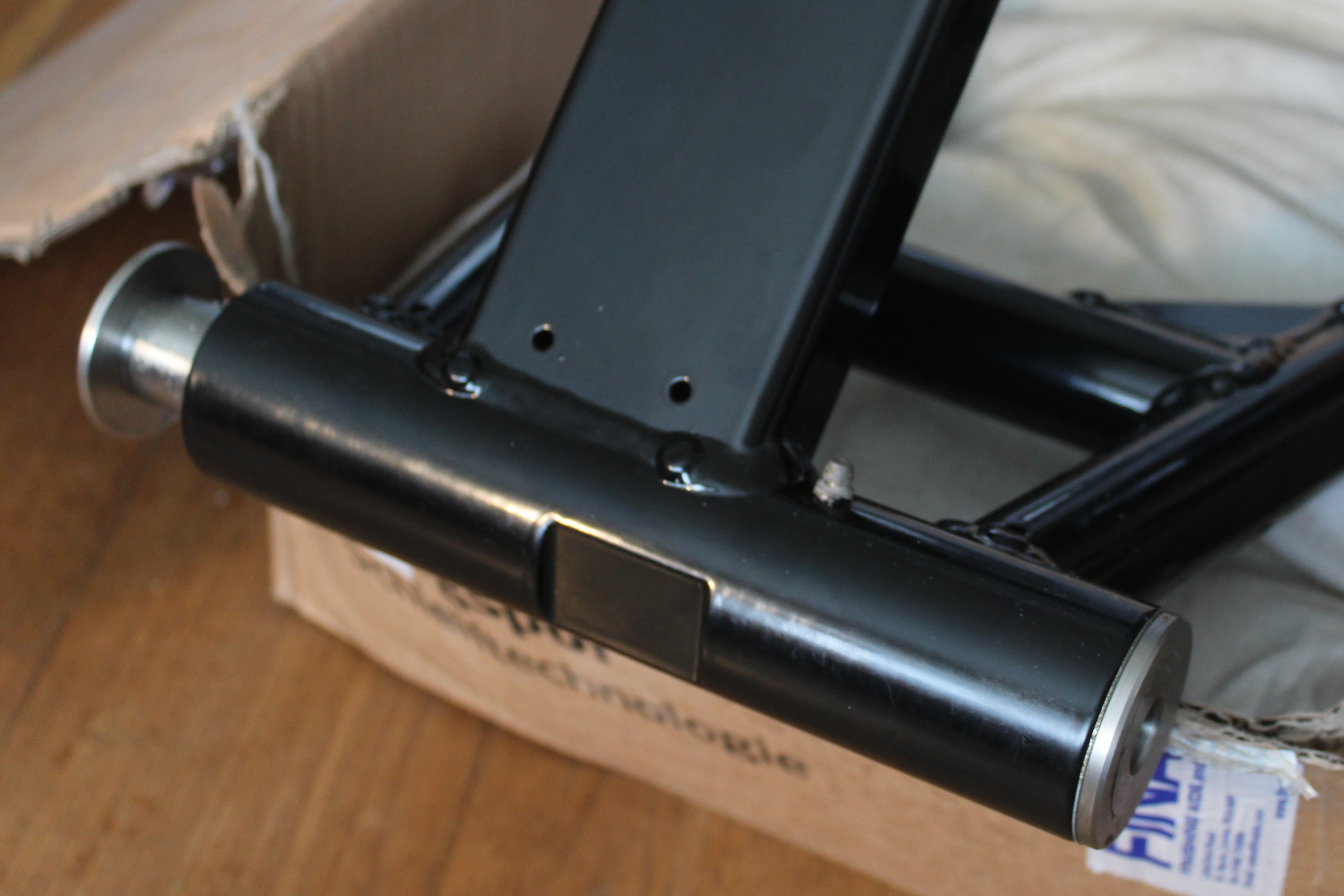

Before my ZRX swing arm went away for powder coating, stainless top hat spacers were machined, so that the bigger ZRX bearings would work with the 16mm swing arm pivot bolt. The latter was another homemade part, in stainless too.

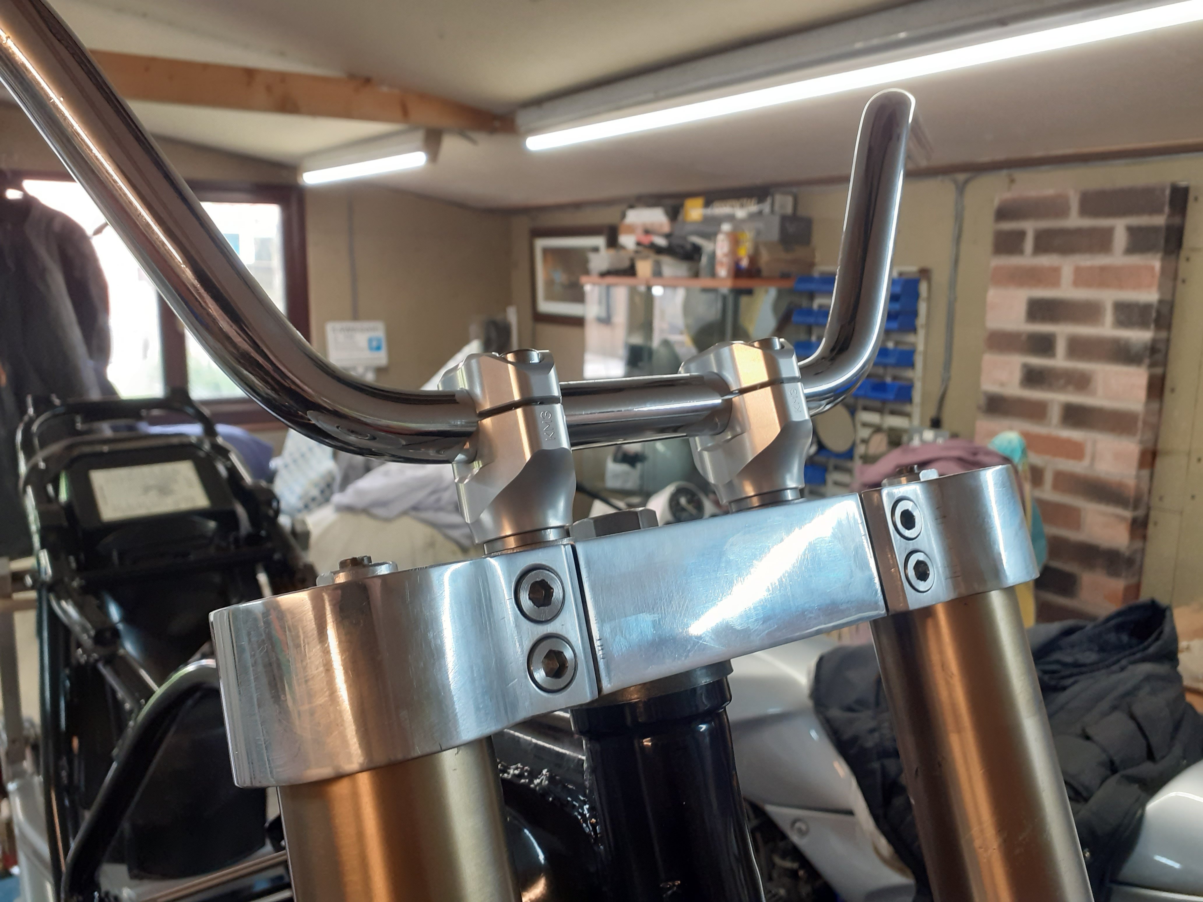

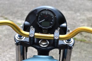

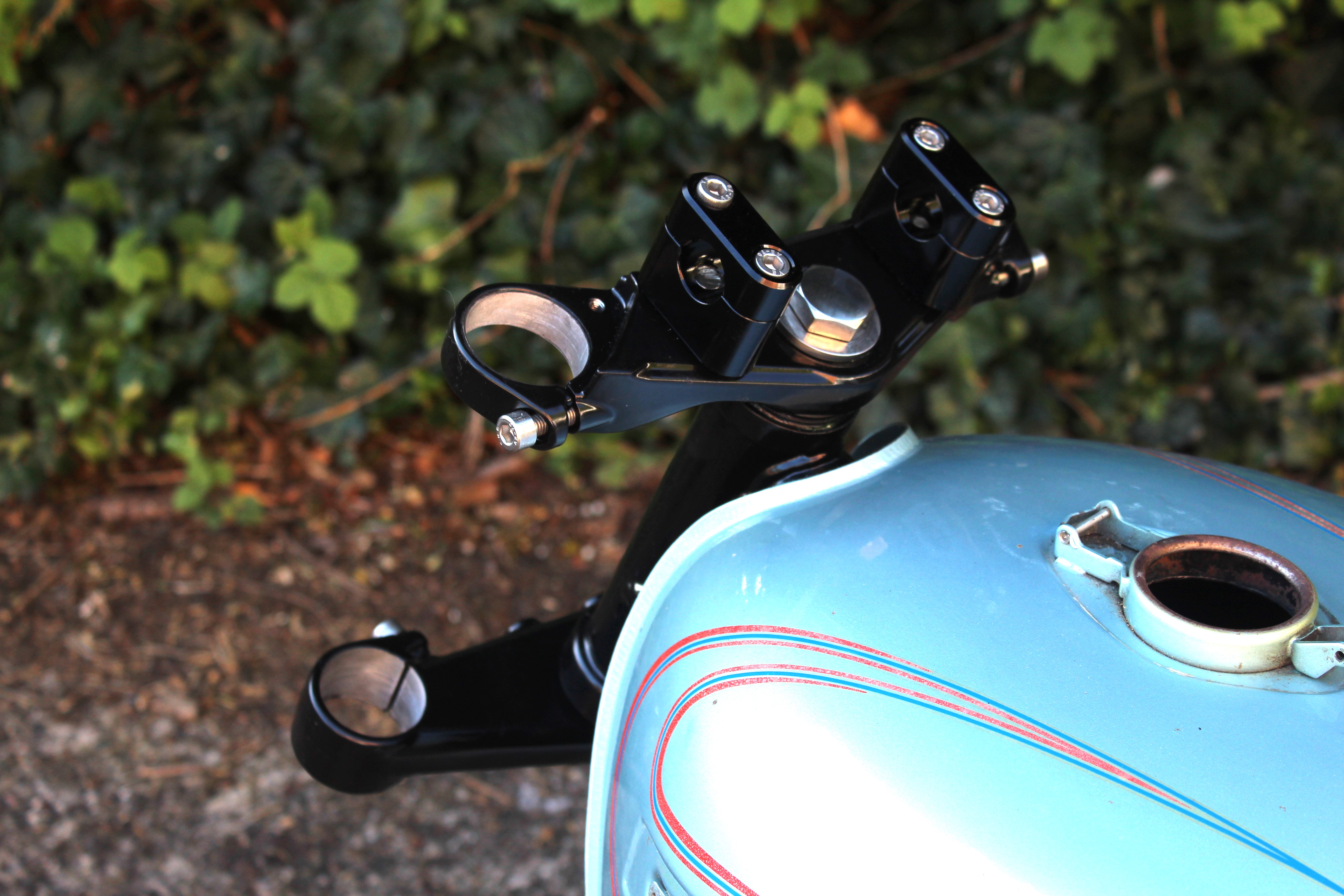

The turbo owner wanted to create the bike he'd always wanted back in the 90's, when he could never afford it. Therefore the forks, brakes and wheels are from a Kawasaki ZX7R of the era, but all rebuild and restored of course. The forks are shorter than they need to be, therefore thick billet yokes were made, which suits the look that's wanted, and also allows the forks legs to be dropped and so give more ride height. The resulting gap as you look down on the top yoke is filled with machined spacers which still allow access to the preload adjusters.

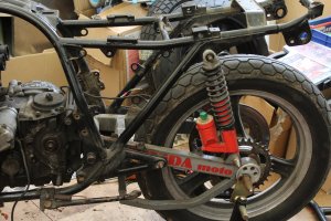

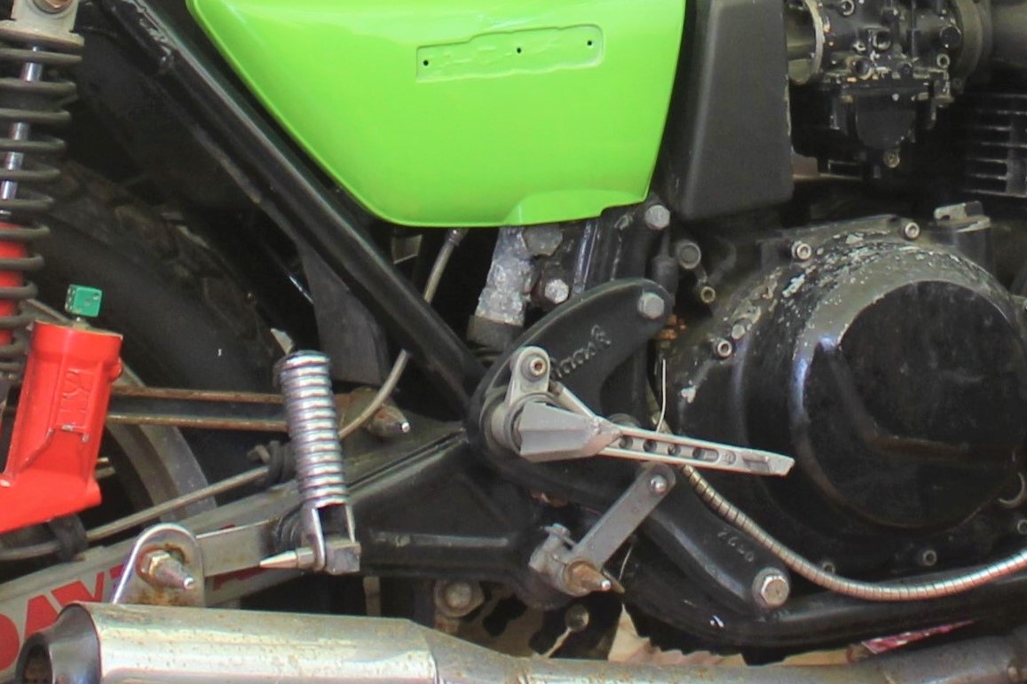

For my own bike, the goal was to make it as light as possible, while increasing power, and fitting modern suspension and brakes, all to be done on a sensible budget and completed in a year.
The original Z650 as standard made around 62 bhp at the crank, and weighed a hefty 510 lbs with mag wheels, but only 485lbs when fitted with the lighter wire wheels and drum rear brake. My target is to up the power to over 80bhp and to reduce the weight down to 400lbs dry. This will make it considerably faster than Kawasaki's own new model the Z650RS.

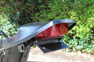

The lighter alloy ZRX swing arm is a good start, as is removing the heavy centre stand and its mounts on the frame. Next the heavy chrome rear fender and rear lamp (which I didn't have anyway) were replaced by a simple stainless splash guard and mounting a ZX6R rear lamp tucked under the tail piece. The latter being an excellent aftermarket part in ABS.

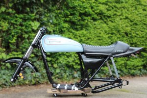

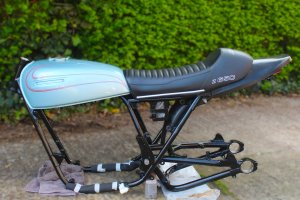

Having finally found a decent tank, though it does have a couple of small dents, the bikes bodywork is slowly coming to together, while a rare Giuliari seat was fitted, swapped from my other 650.

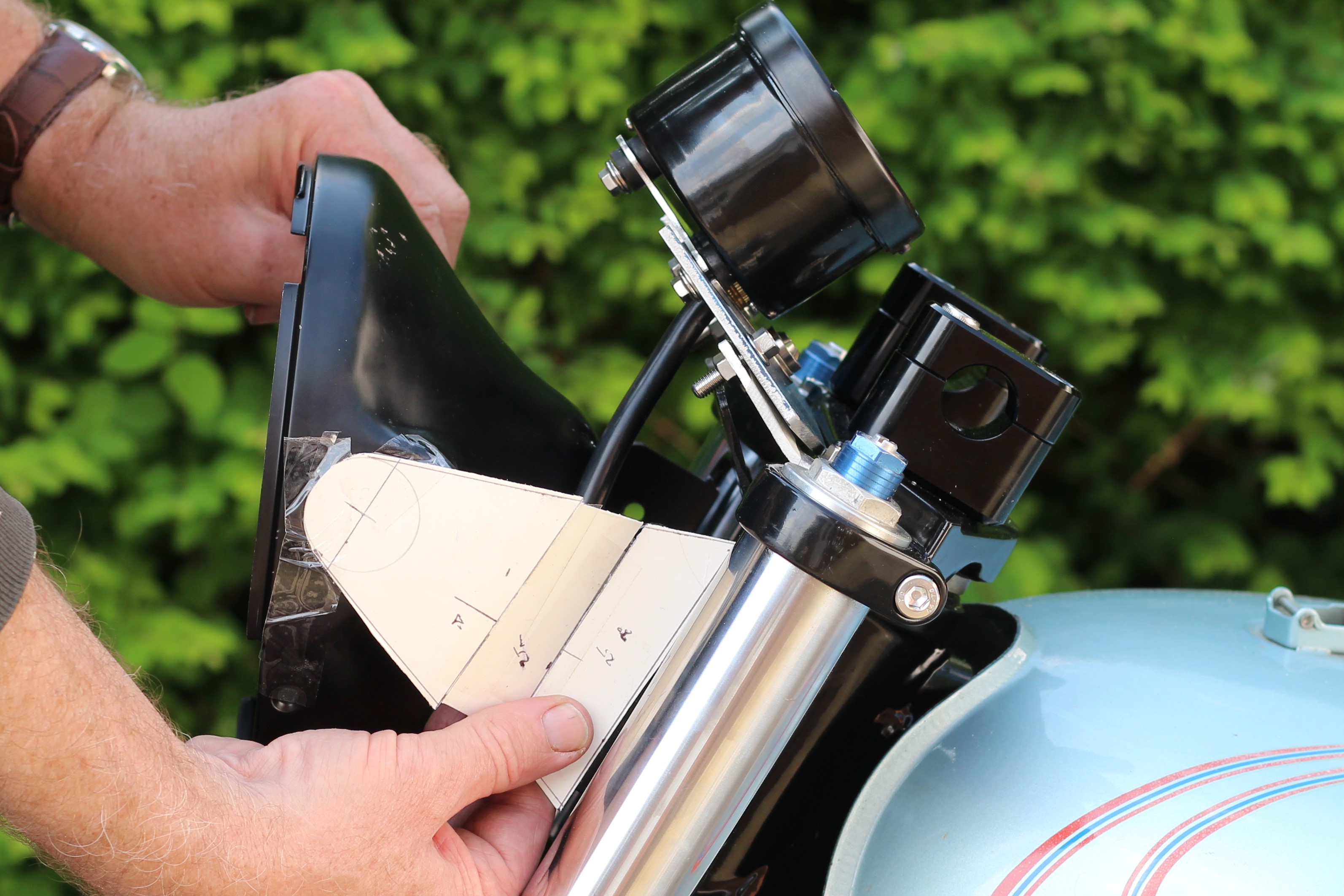

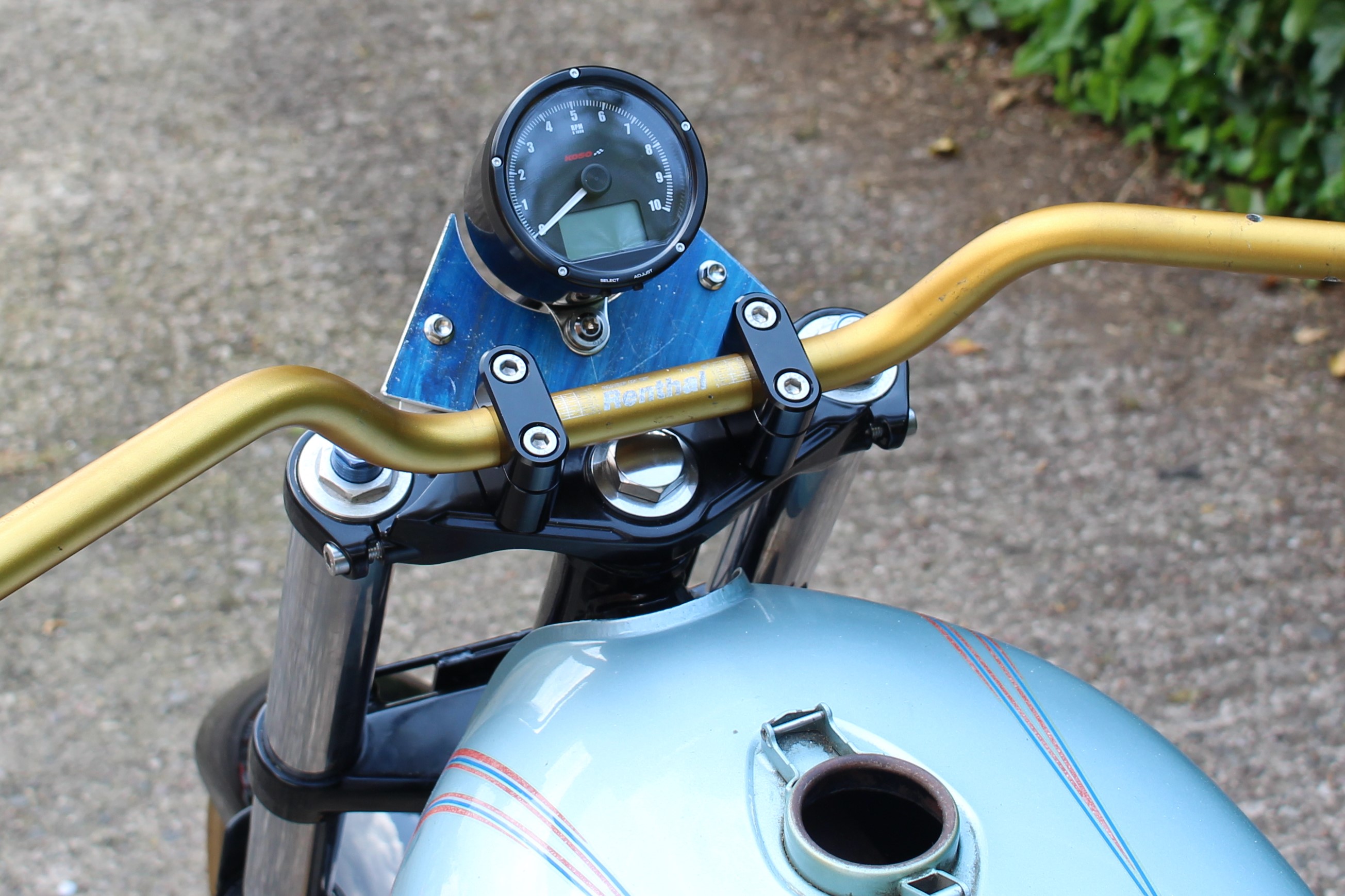

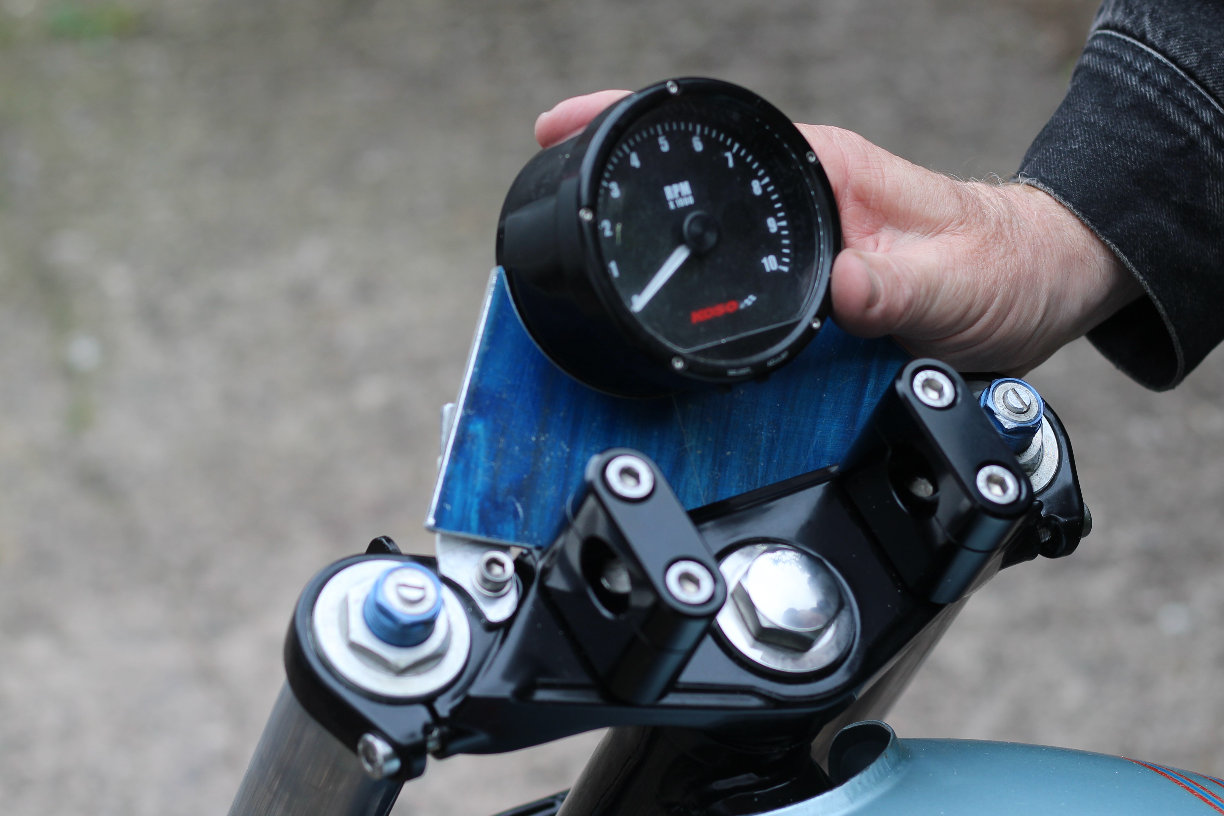

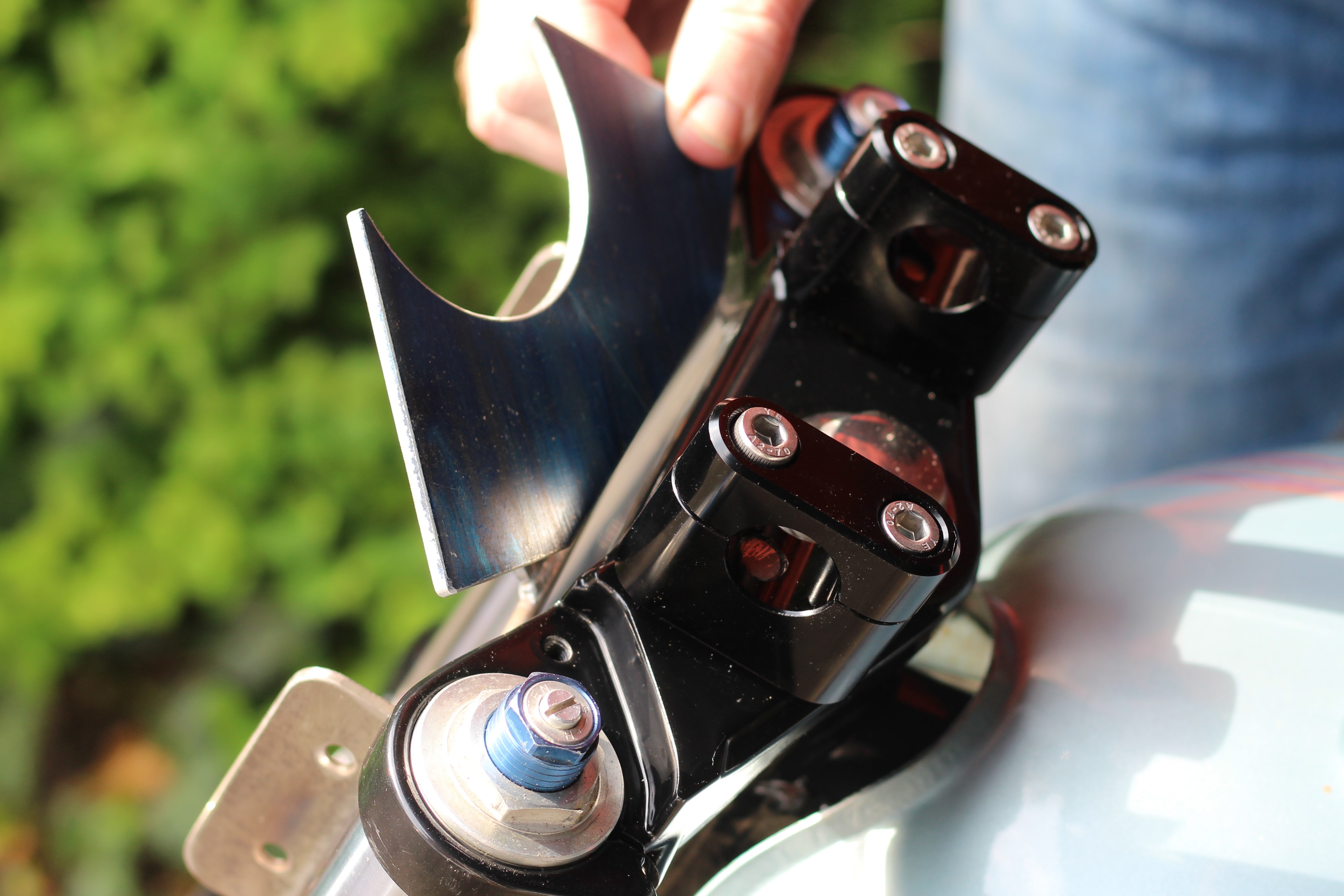

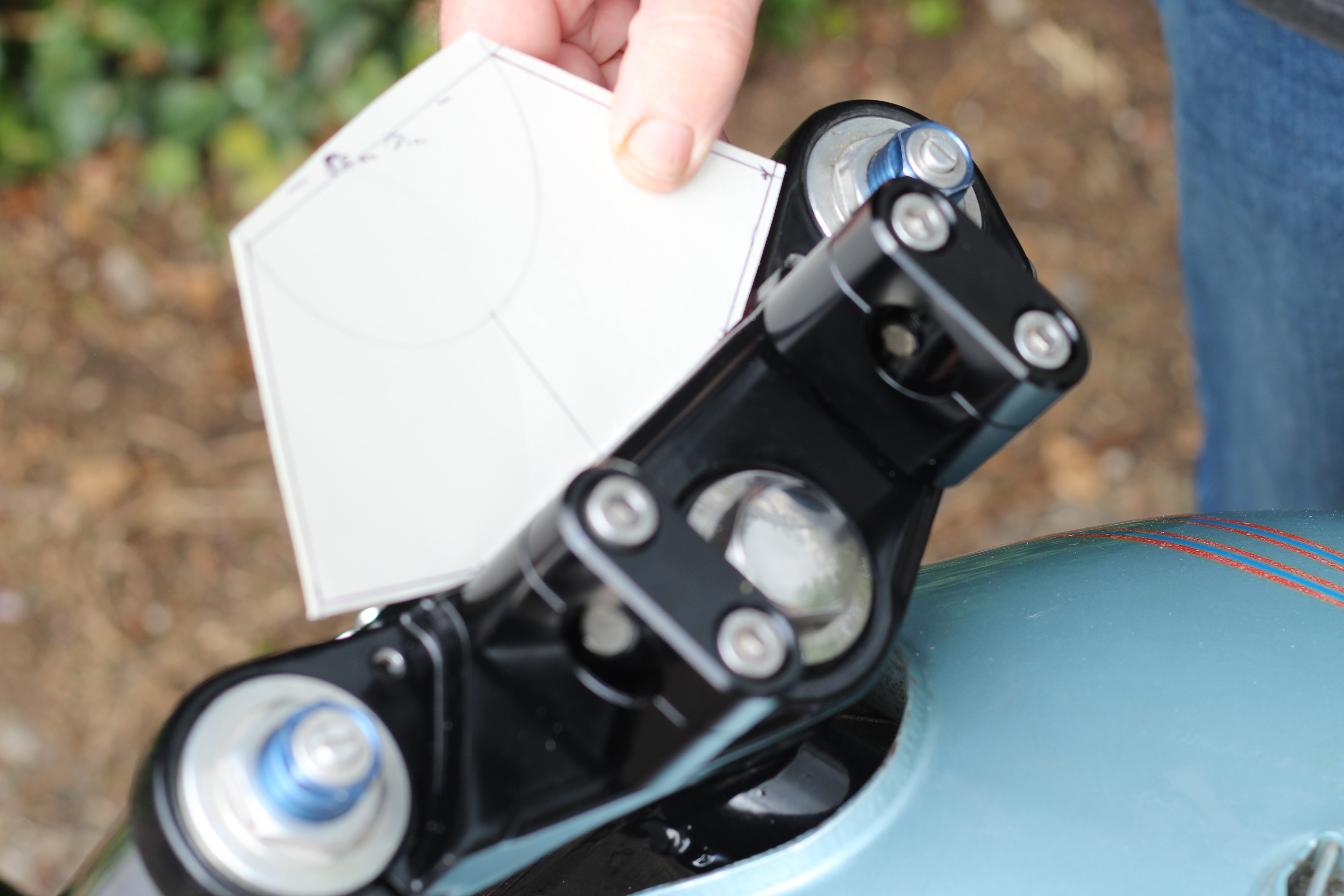

Made a start on the headlight. indicator and dash mount. Started by making a template.. then making it in 5mm stainless bar..

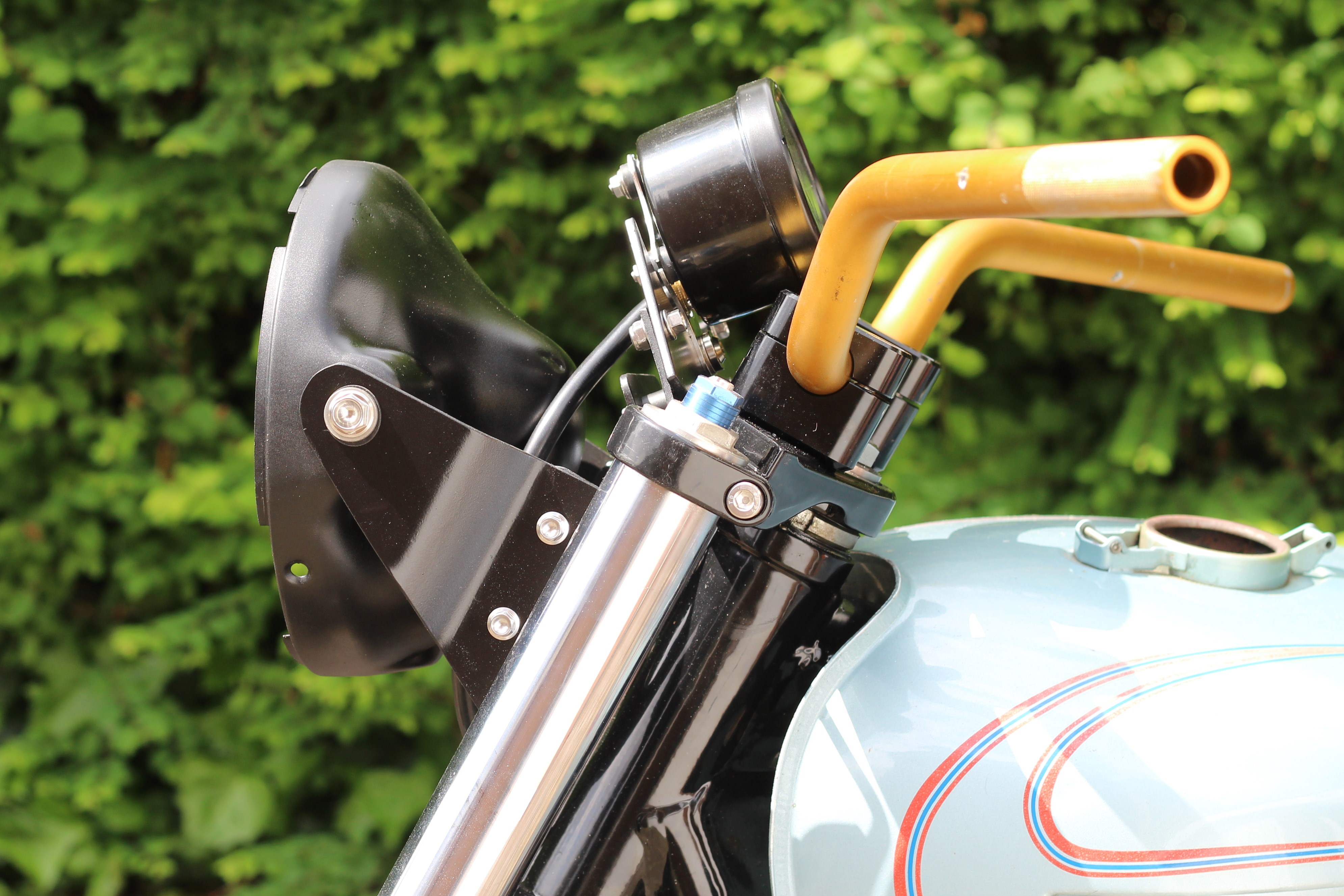

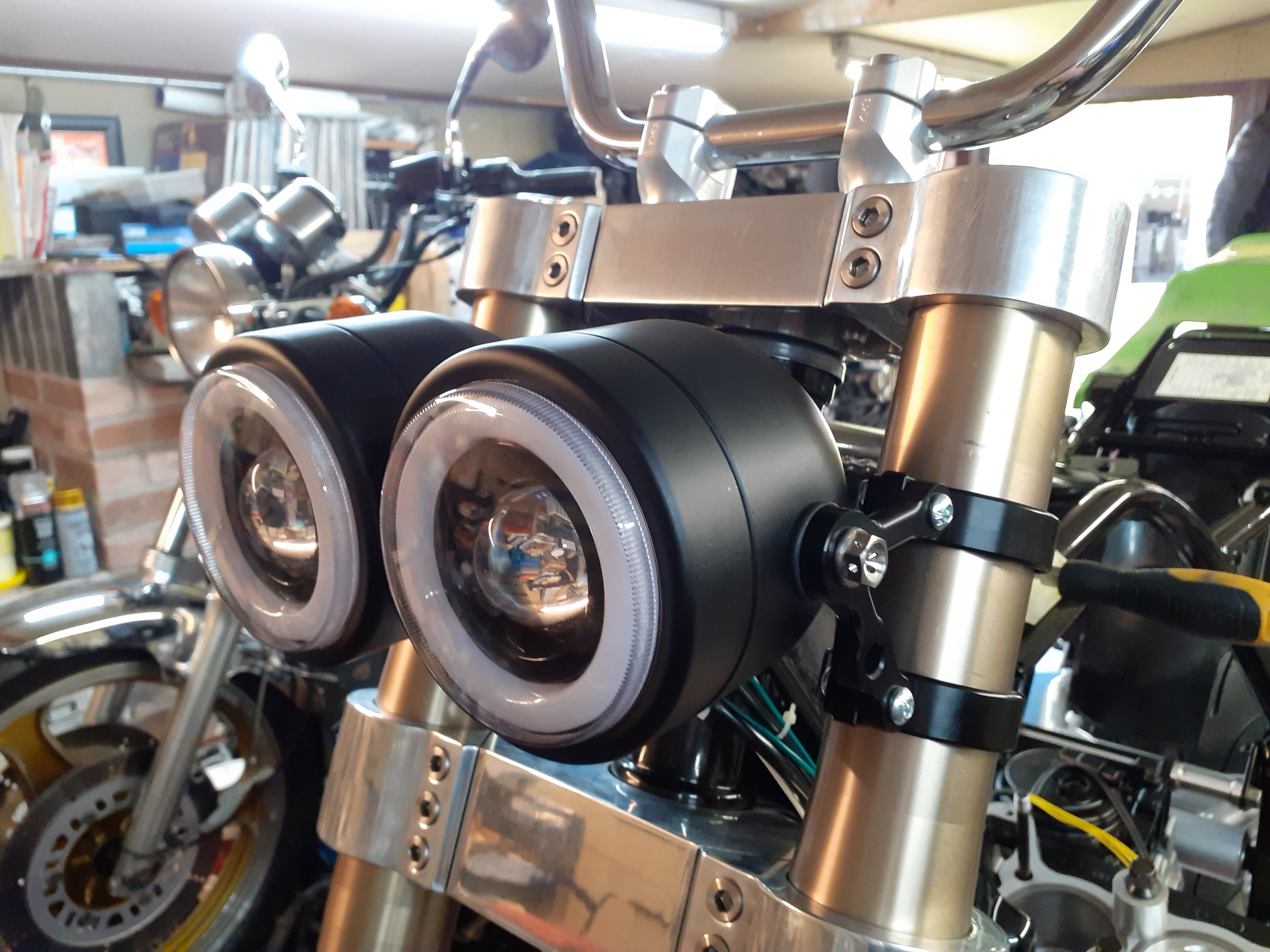

Headlight brackets are now made in steel, painted and on the bike. Haven't fitted the the sealed unit yet as there are a couple of fasteners that need to be replaced, as they are the wrong size. The gold bars are just for setting up, they won't be used in the final build.

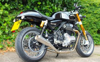

Progress may slow a bit this summer, as I've just bought my first new bike since 1999...
Norton is great, better brakes and suspension than I'm used to, and much quicker steering. Only sold in the UK so it doesn't have to meet euro regs on noise and emissions.. so the fueling is spot on and it sounds good. Looking forward to seeing the brand new Nortons which will be revealing in Novemeber, for sale in the Spring worldwide.
