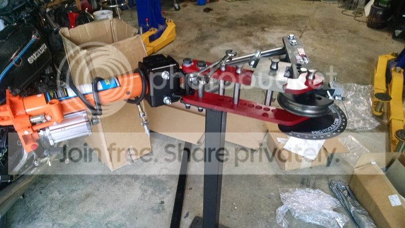

Been waiting on this guy to come in so I can really get some things in motion. Its a pro tools MB-105HD with a swag offroad air/hydraulic conversion. I finally got all the pieces in and powdercoated the swag brackets.
Gave it a test run this morning and it is working beautifully.

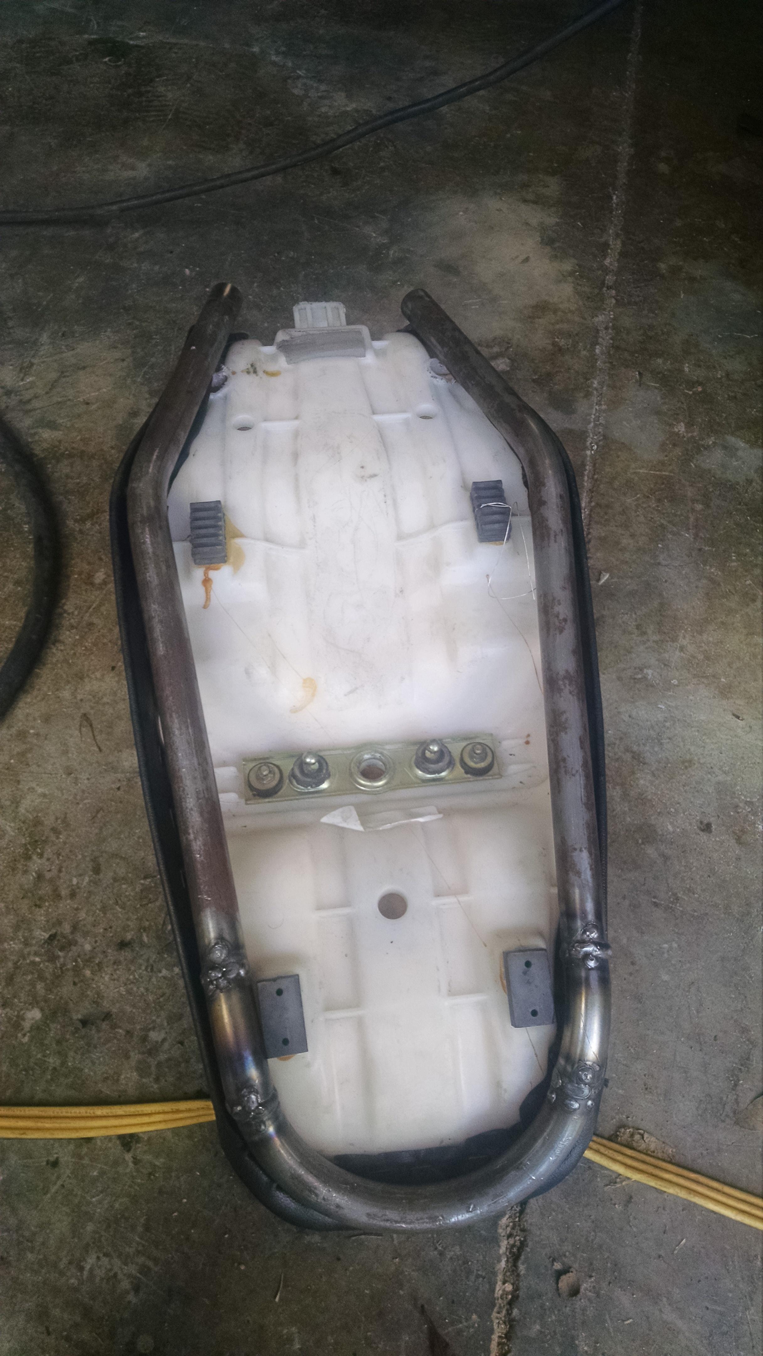

Test piece mocked up for the tail section and it is going to work perfect there.
Looking cool man. Awesome start. Which company did you get the tube bender from and how many different die radius's came with it? Such a good idea if you're remaking entire tail sections/subframes like you. Now you've got me jealous and on the lookout for one!

Well I got the frame done for the most part. Still need to add some bracing between the rails. There are some things I would do differently but for my first tube bending project, I am happy so far.

The frame looks good to me. Any plans on carrying a passenger? I'd be concerned about that much weight outside of the upright support.

No plans on carrying passengers. It's stout though. I can nearly pick up the bike from the back with some help. So it may happen but it will probably be a rare circumstance.

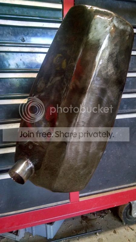

I had my buddy come over this morning. He is going to be painting my tank for me and I couldn't decide between bare metal or a translucent black. I've got a translucent black powder so I had an idea what it could look like so we mixed a little bit of black in with the clear and sprayed a 10 minute tank i had lying around. It came out just like I hoped. This is probably the color we will go with.
