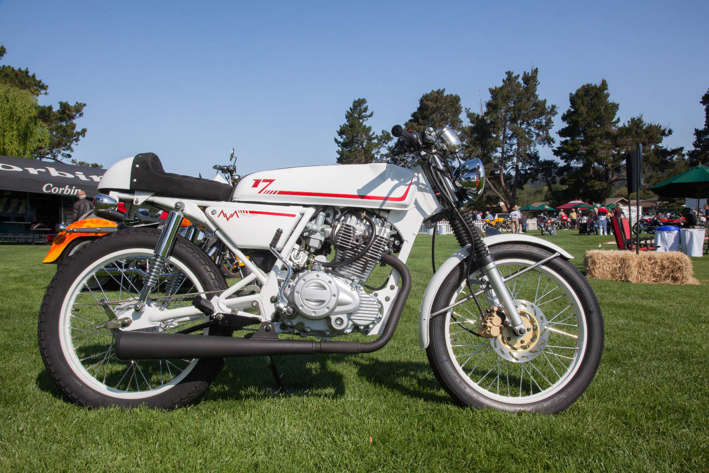

I was considering doing to 150 upgrade, but after reading about the guy who dropped the thrust washer into the engine and damaged it I am not so sure. That has me written all over it. Does anyone have actual engine model, availability, source on the 250cc engine that is going into the AVA Swift 250? I believe it is a Loncin engine but I cannot match it exactly to any on Ali Baba. It has no branding on the crankcase covers and there is no big CDI stamped on the side up the top of the cylinder. Also, from the photo it appears to fit with no extra engine mounting brackets. It is hard to find out too much about the AVA Swift as I don't think they are on the market as yet. I would be interested in that engine in particular. Maybe some others might like to "Ali Baba" a few to get the costs down?
No probs. 150 mod is good . I have done it. Would go nicely with what you have done so far and keeps engine number a match if you get picked on by the peelers. Go up a cog in the front now with what you have for top end gain . 15 is standard 16 will get you well over the speed limit. I'm hitting 130- 135 k ( on dyno of course) :P
