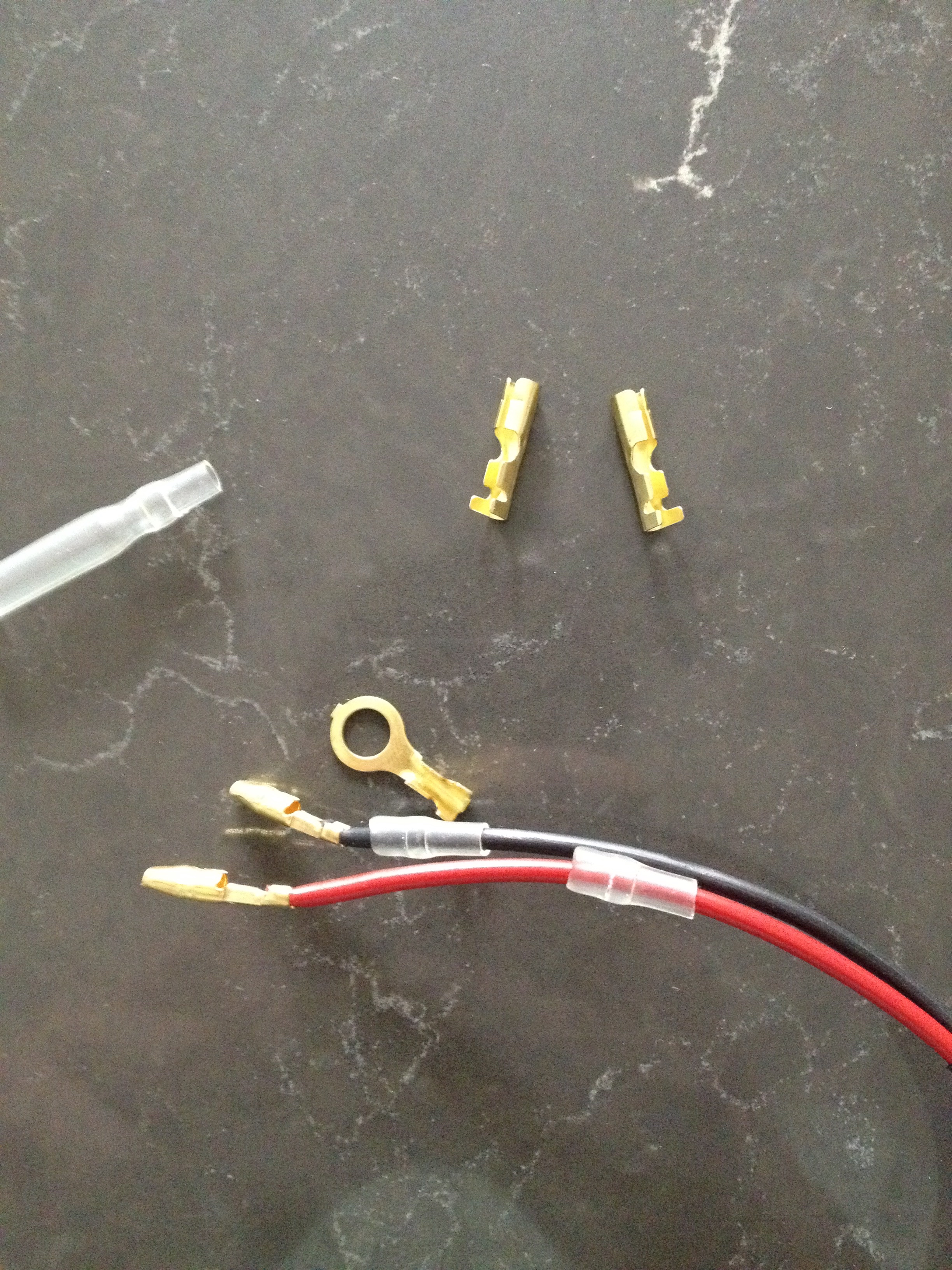

Okay so I am trying to figure out the best way to hook up this battery eliminator to my 1972 honda cb350. The issue is the ground wire to the frame seems to be too thick to fit into the bullet connection. Have any of guys done this/ any idea what to do? Thanks

Anway... old (thick) ground strap isn't necessary anymore. You can remove it. New ground is the black wire from the BE. Remove that bullet connector and use the brass hoop terminal. Bolt it to bare metal and you're good.
Red wire will need to connect up to the output from the rectifier and spliced together before heading off to the main fuse.
