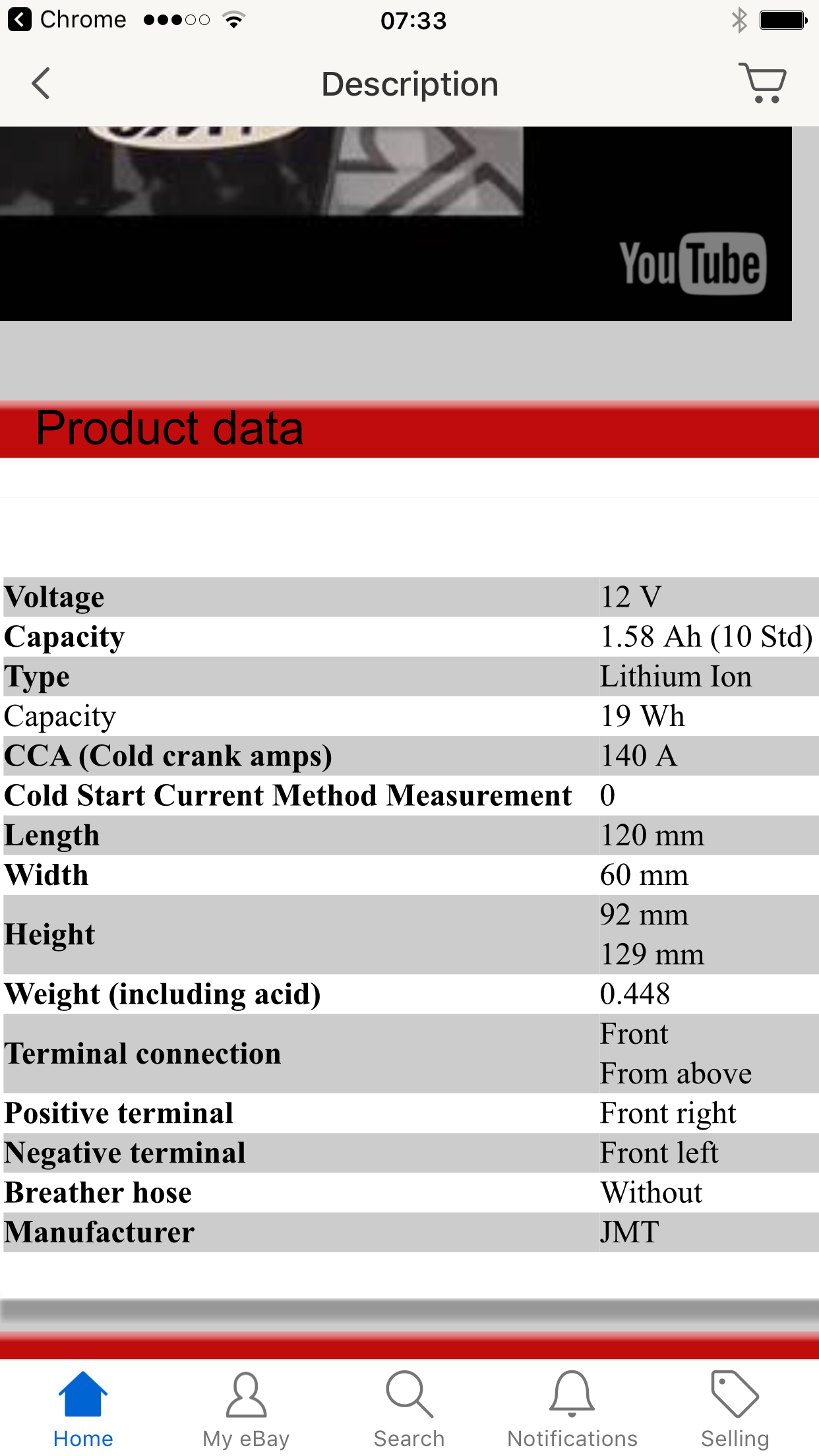

Hi does anyone no what's the smallest battery I can use on my gs550 scrambler build I need the battery to be as small as possible size wise . Thanks
Seen this one would it be ok ??
I went through something similar with my little CD175 twin - got a smaller battery but was concerned the relatively primitive charging system needed a fairly large battery to absorb voltage output spikes, so, went back to a lithium battery with the same ampere-hours. Didn't save any room to speak of and it was a really tight squeeze to fit it in, but at least no acid leaks.
Anyway, might be best to check that the Suzuki doesn't have a similar issue with its charging system and I gather you've deleted the electric starter - that little battery isn't going to turn it?
