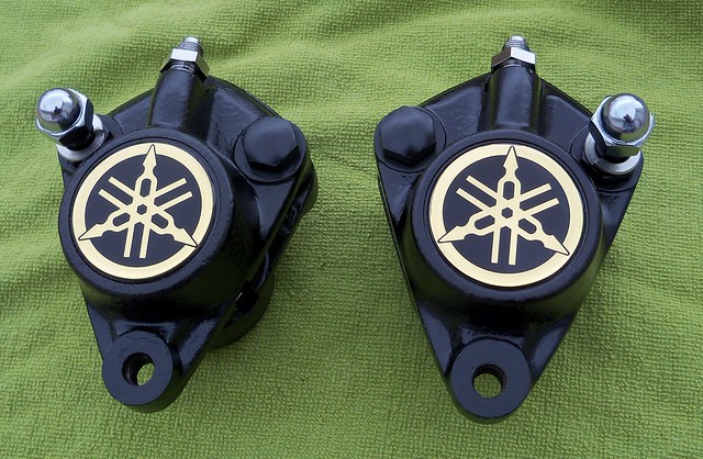

This is VHT 'satin black' caliper paint from the auto parts store. I didn't spill any fluid on them, so can't say how resistant it is.
