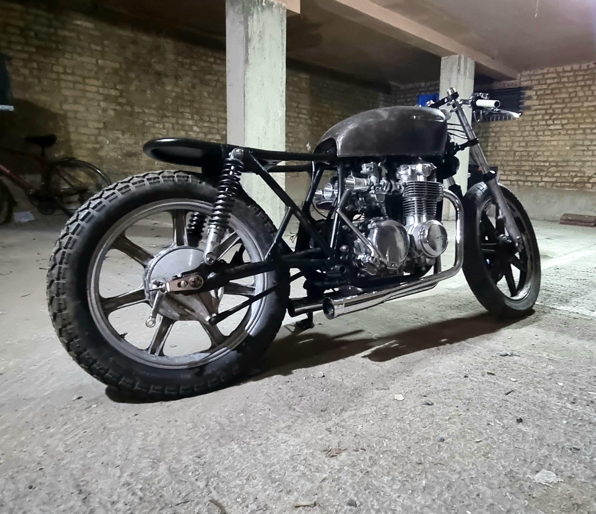

Hi All,
I'm in the process of building my CB550 wiring loom for a cafe racer build (photo below for attention!). I'm running a modern reg/rec with a higher output voltage than required for the Lithium battery, which I understand could damage it. I'm also using a Motogadget system.
Is there a way that the stator can provide power to the bike's systems (headlights, gauges, etc) but bypass the battery so it doesn't charge? i.e- the battery is only used to start the bike and run the ignition pre-start up. I've heard this referred to as a 'dead loss' system? The bike will live on a trickle charger, and I have a kickstart as a backup- so I'm not too worried about it discharging during rides.
As far as I can tell there is no way to do so as they will all be connected via the starter solenoid and integrated main fuse- that feeds the motogadget?
In terms of technical detail I'm running a Shorai LFX14A2-BS12 Battery ( 14ah Pb Eq, 210CCA, LiFePO4 compostion) with a max recommended charge voltage of 14.8v. My Reg Rec is from DavidSilverSpares and is from Century Ignition parts, with an aprox output voltage of 15V, tested ranges between 14.7 and 15.1v
Other solutions would be welcome, but I'm loathe to spend more on another brand new reg/rec!
